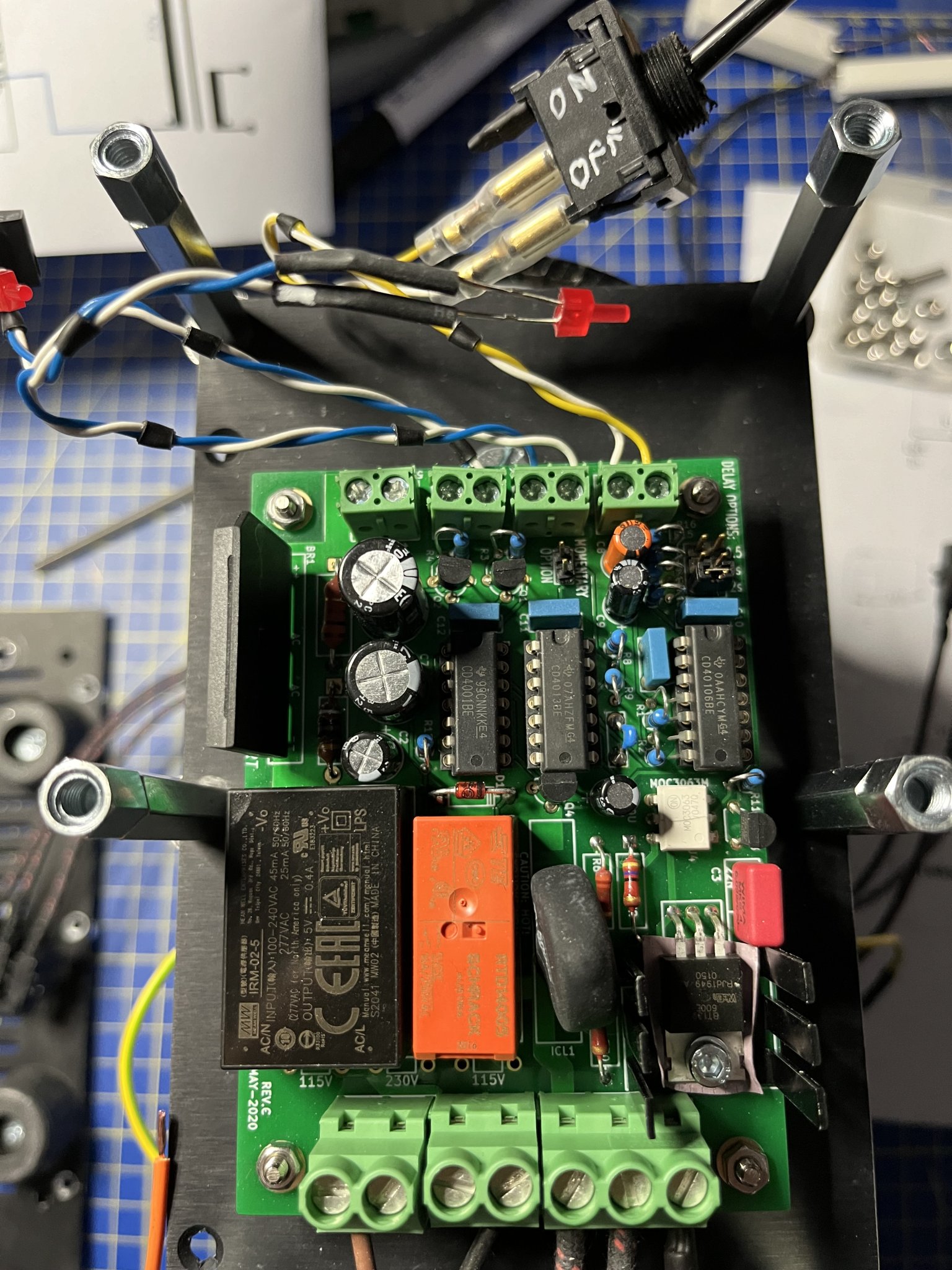

Thanks, @RickRay , but this/my board seems to be malfuncioning, the bulb is fully lit from the moment on I plug it in, and the led-on is on regardless of the switche‘s position. Led-off does not light up…
I believe I‘m in for a fiddling (debugging) session, probably starting with
  • a general inspection for lousy soldering
  • misplaced parts
  • broken parts according to @Mark Johnson ‘s list mentioned recently, this (#699)
The thing that baffles me is that the board consistently behaved like this and that there is some functionality (there’s a relay clicking when a power-cut occurs/the rear switch is activated…

The picture of the assembled board you posted in #746 reveals that the CD40106 is not correctly inserted in her socket. Pins 1 to 7 are bend outside of the socket.
Reactions: bhjazz
I got a bit help. Rereading #766 my attention was caught by the 6 word sentence "H9KPXG never showed me an off state", this made the 40106 first in the chain of suspects. It was under active investigation when I spotted the problem. If it proofs anything it's the importance of factual fault reporting and the emergent power rising from a joint effort. Thank you all.
I would like to confirm the board is working.
Haven’t yet put any load on it, just switched it on and it instantly turned on the OFF-led. (With the switch obviously in the open position)
On is on as well, and the relay‘s clicking just as expected…
This was one of my more ridiculous (not hazardous) bungles. (The most idiotic one I keep secret
Again many thanks for all the help and encouraging and support and this project to Mark, OmeEd, RickRay, IAIMH, and the community!
