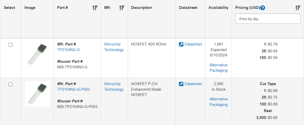

Just bought parts for a build. Currently Mouser (as usual) is out of some of the resistors, but those are fairly easy to find replacements for. I had to head out to Digikey to find the 40V 6 Ohm MOSFETs (Q1 Q2 Q3) , though. A typical day in the life of a DIY builder, I guess.

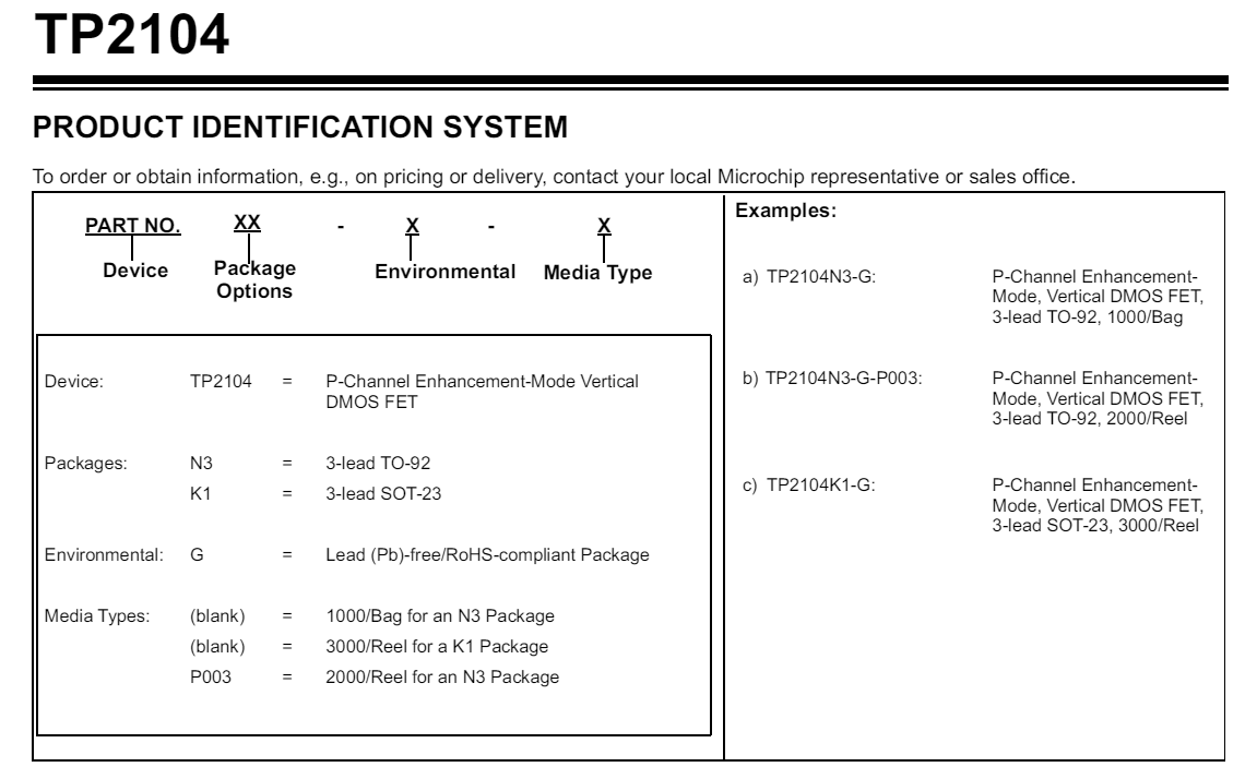

So sorry, I should have posted more specifics. Here is what I'm seeing.
Granted, I had to go to another provider to get the datasheet to download, but with a VERY brief scan... with my untrained eye... here is what I saw in the data sheet for "P003". Right side, comparing example a to example b.
https://ww1.microchip.com/downloads...de-Vertical-DMOS-FET-Data-Sheet-20005958A.pdf
Again... I am TOTALLY not the guy to try and choose substitute parts. If it were just for me... I'd take the risk. Advising others... I'm not there yet.
The only difference is that the ones with P003 in the part number are shipped to you on a paper tape that can be wound onto a reel, with the ones without P003 are shipped to you as loose individual TO-92's in a plastic bag. For the circuits used in this PCB, either one will be perfect. Buy what's cheapest or buy what's most easily available or buy what you find sexy.

No worries, IAIMH. I actually went for the exact part outside of Mouser, but you and Mark did teach me that the other part would have been available. As always, the education (of me) was worth your combined efforts. Many thanks.
