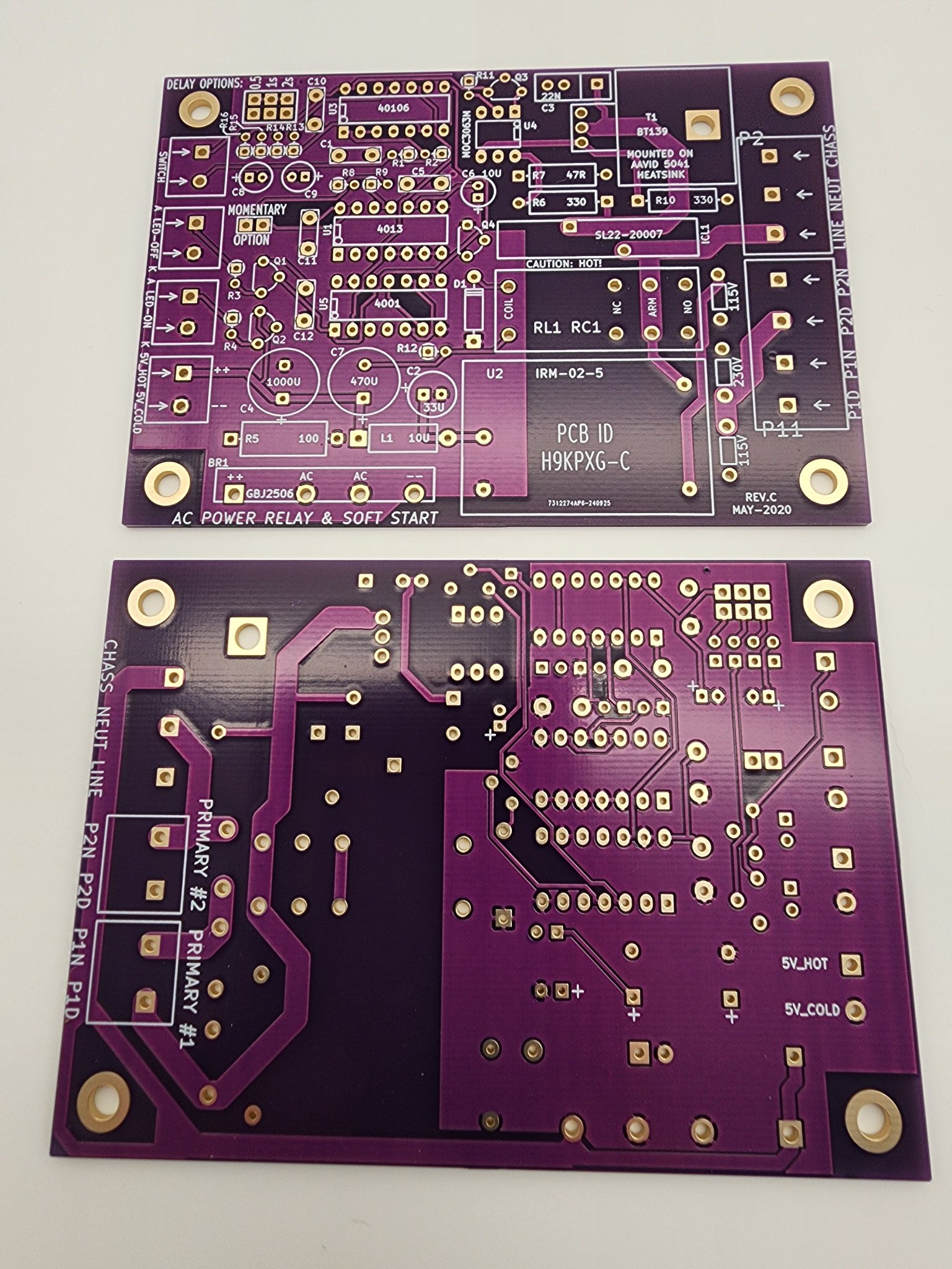

As part of a crazy large JLCPCB order, I purchased over 100 of Mark's H9KPXG boards and got a really good price break. I'm sharing the savings with boards for sale in the swap meet.
H9KPXG Soft Start On/Off Switch
  • Purple board color
  • EING Finish
  • 2oz outer copper
  • 1.6mm thickness
Thank you Mark for sharing such a wonderful design for all of us diy-ers!

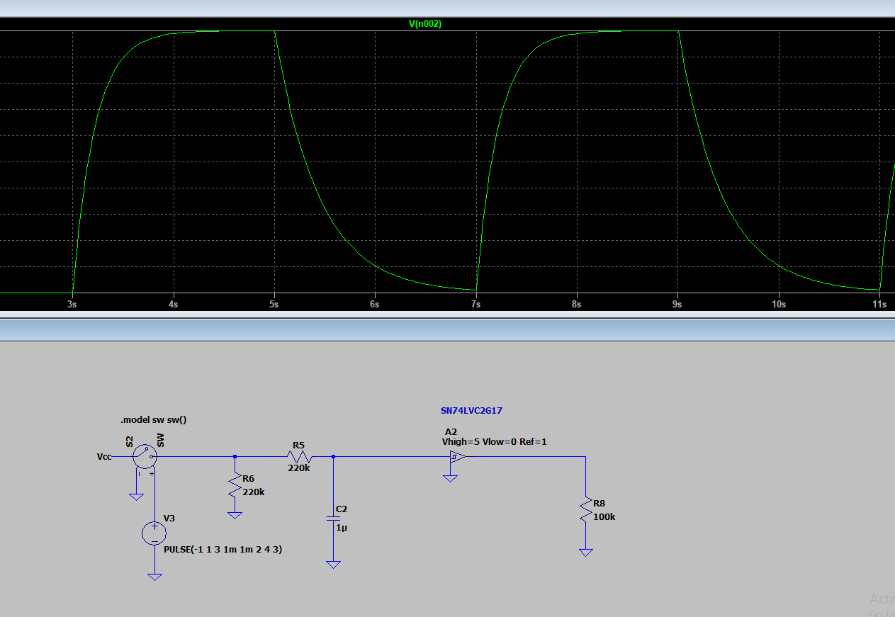

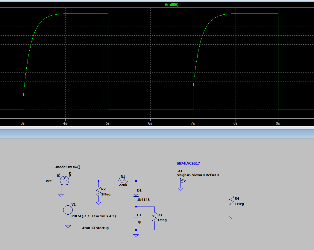

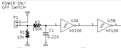

After power button released, debounce cap is discharged creating delay time for the release. Is that on purpose?
Played in sim and found solution to keep debounce delay on button push and no delay upon button release.
Voltage probed before Schmitt trigger.
