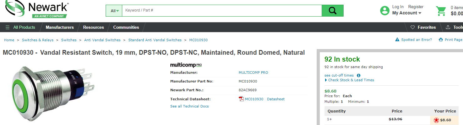

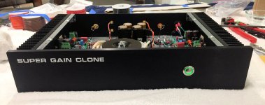

I got fed up with DIY power amps whose AC mains On-Off switch is on the rear panel. This choice does reduce the amount of metal working required; just buy an all-in-one plastic molded unit containing IEC inlet jack, fuse holder, and AC mains rated switch. Cut one rectangular hole in the rear panel (where small mistakes in drilling or filing are not visible!), drop in the unit, done! But reaching through the equipment rack to operate a switch on the back panel is clumsy to watch, and awkward to do. I wanted something a little more refined.
Front panel switches with a circular pushbutton and colored illumination looked promising; the type called "Anti-Vandal" appealed to me. Figure 1 shows a few examples of them. UNFORTUNATELY, most of these switches are rated for low current DC applications like soda vending machines; very few are rated for AC mains switching at the high currents needed by power amplifiers. Worse yet, the inrush current that flows through the On-Off switch at the instant when the gear is turned on, can be enormous. Far too high for a switch rated 2A @ 24VDC. Figure 2 shows the measured AC mains current which flows, when a rather modest chipamp-based power amp (photo) is turned on. The inrush current peak is 24 amperes: (2.4 vertical div X 10 Amps per div). That's quite a stress for everything in the AC mains current path, including the On-Off switch's contacts. And remember, this is not some super-amp behemoth from Krell; it's just an Antek 200VA toroid, two LM3886 amp channel boards, and a diyAudio Universal Power Supply PCB. Yet its inrush current is frighteningly large.
It seemed to me the only way to use the Anti-Vandal On-Off switches I liked, was to use them at low current & low voltage. They wouldn't directly switch the mains; instead they would merely control a separate big, robust, high-current and high-AC-voltage switch. Perhaps such as a mains rated relay or triac.
Regrettably, more than half of these Anti-Vandal switches are momentary pushbuttons; they don't have latch-in-position action like rocker switches or toggle switches. To use them on the front panel of a power amp, an electronic latch or flipflop would be needed, giving "push on, push off" behavior.

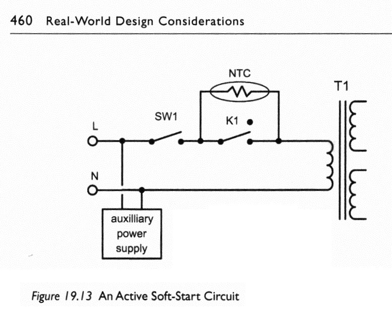

The basic idea of inrush current limiting with bypass is sketched in Figure 3. Switch "SW1" turns the amplifier On and Off. Series resistor "NTC" performs the function of inrush current limiting. It guarantees that mains current cannot possibly exceed (Vmains / R_NTC) even if the rest of the primary circuit is an ideal short circuit. Switch "K1" bypasses the inrush current limiter after the inrush event has completed and mains current is down to its normal levels.
Inrush limiters have been successfully deployed using (a) ordinary wirewound resistors [Self], and also (b) specialized Inrush Current Limiter components [Cordell]. I decided to use option (b), the special ICL components. They offer a degree of extra safety in case the bypass mechanism fails open-circuit: an ICL can withstand the full primary current indefinitely. Whereas (a) wirewound resistors would self-destruct in less than one minute.
In construction, ICLs are enormous Negative Temperature Coefficient thermistors; a famous example is the CL-60, whose very part number includes CL for Current Limiter. I prefer not to refer to these as thermistors, to avoid confusion with the tiny little temperature sensors that also happen to have a negative temperature coefficient. So I will make an effort to always say "Inrush Current Limiter". Oh by the way, that happens to be the name that both Digikey and Mouser give to the section of their website where these components are sold. Forget Thermistor, remember Inrush Current Limiter.

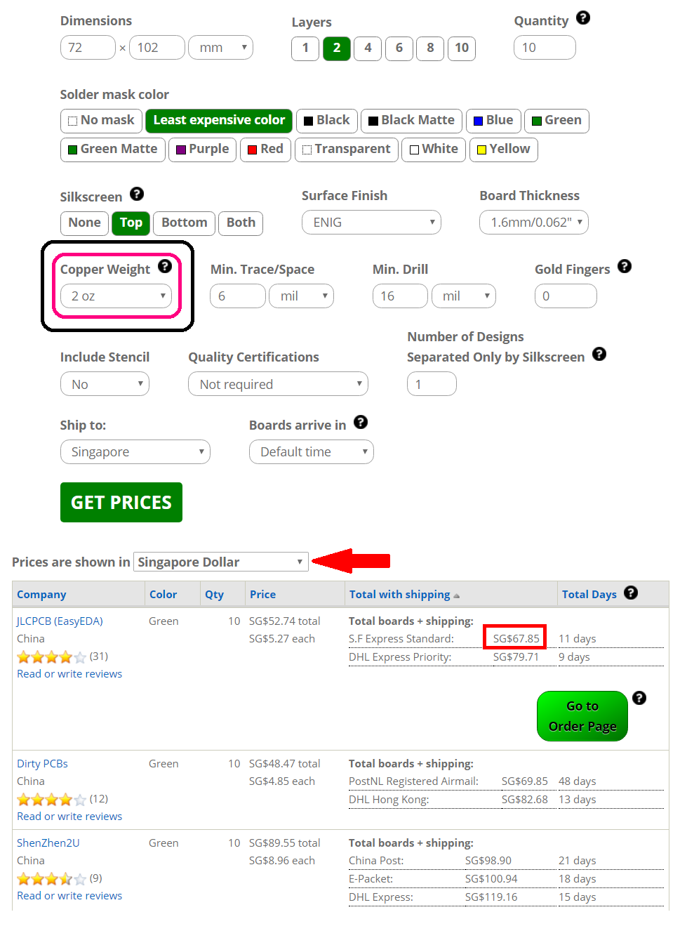

I strongly recommend that you have these built using BOTH 2-ounce-copper {double thick} traces, and also ENIG {gold} finish on the pads. An example is shown in Figure 8.

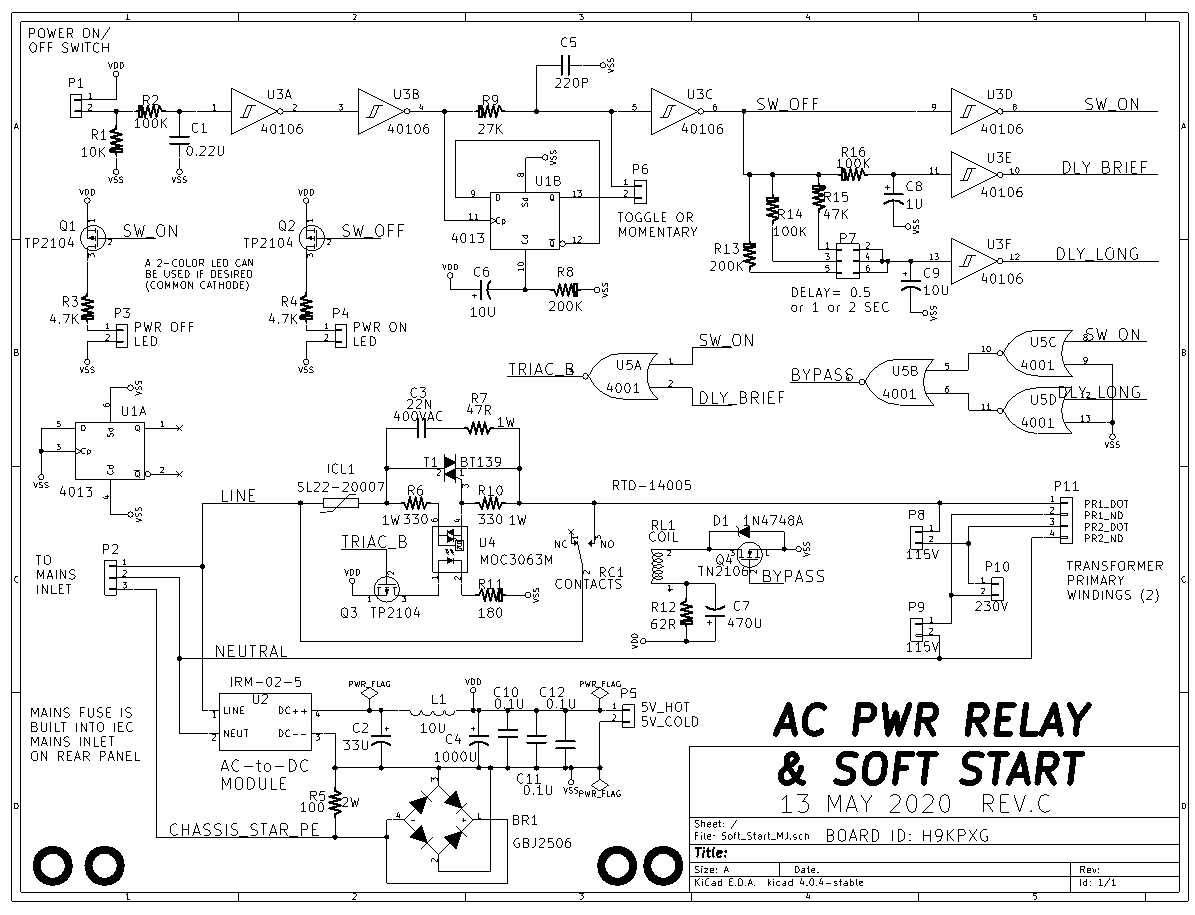

CIRCUIT SCHEMATIC DIAGRAM
Figure 4 is the schematic of this PCB. The power handling "business end" of the circuit in on the bottom half of the page; the top half is merely timing and LED management.
The actual front panel switch connects at top left; it switches only 5V DC at 0.5 milliamperes. This ripples through some digital logic gates and produces a digital signal "TRIAC_B", which turns on triac T1 through opto isolator U4. When T1 turns on, it applies mains power to the transformer primary windings. Notice that triac T1 is series connected with an Inrush Current Limiter device, "ICL1".
Component ICL1 a 22mm diameter device made by Ametherm, whose surge energy rating is 125 Joules. For 115V applications I recommend part number SL22-20007, whose cold resistance is 20 ohms and whose max continuous current is 7 amps. Thus the inrush current when the ICL is at room temperature, cannot exceed (115 / 20) = 5.8 amps, and that assumes the transformer primary, mains fuse, and AC wiring all add up to 0.00 ohms of additional resistance. [For 230V applications I recommend the SL22-50004, whose cold resistance is 50 ohms and whose max continuous current is 4 amps.]
After a user-selected delay time (chosen by setting a jumper across one of 3 sets of pins on header P7), the inrush current limiting is bypassed. Digital logic signal BYPASS turns on MOSFET Q4, which energizes the relay RL1 and shorts out the (triac + ICL) devices. Now there is no extra resistance inserted; the transformer primary is connected directly to the AC mains.
The relay, the indicator LEDs, and all of the digital logic are powered from a tiny AC-to-DC converter module, U2. Today these are available which meet the sub-0.5W international requirements for standby power, and they are delightfully small and cheap. The big electronics distributors carry modules made by RECOM, Mean Well, CUI, and TDK-Lambda. However the TDK modules are quite expensive (3X!), and the CUI modules are in stock at DigiKey but not Mouser. Since Mean Well appears to have by far the greatest number units in stock and on the shelf at Mouser, that's the one I selected. Eventually I settled upon a 5V model, after realizing (a) 12V relay coils don't consume any less power than 5V relay coils; and (b) LED circuits actually do consume more power when operated from a 12V supply than from 5V. It's only obvious in retrospect. And that's why the board uses CD4000 logic chips -- they work at 12V (and 5V, and 3V, and 18V)
The AC/DC module output is made available at connector P5, in case other circuits within the chassis may need a low voltage housekeeping supply. For example, a "breathing" style LED. I strongly urge you not to connect either of the housekeeping supply terminals (5V_HOT, 5V_COLD) to the ground pin of other circuits. Treat it as its own, self-contained, floating 5V supply. If interfaces are required, use optoisolators between circuits connected to the housekeeping supply, and audio circuits connected to audio ground. That way you cannot pollute audio ground with noise or garbage from the AC-to-DC module. The module is rated for 400mA but I recommend drawing less than 300mA from the P5 connector, to avoid overload.
To soothe my paranoia about electric shock, I've included a 25 ampere bridge rectifier "BR1" between 5V_COLD and chassis protective earth. Now in the very unlikely event that the (class 2!!) AC/DC module develops a short between AC mains LINE and DC output Minus, the mains voltage is shunted straight to protective earth through a very high current pathway: BR1. Even if somebody had connected 5V_COLD to circuit ground, against my recommendations, it still gets clamped to a non-dangerous voltage through BR1.
A couple more details about the circuits connected to the front panel switch. Firstly, a very long debouncing time is conservatively applied (using resistor R2 and capacitor C1), compared to the measured timings of typical switch-bounce events, as reported in The Ganssle Group's debouncing article. After that, a Schmitt trigger (U3A) adds hysteresis. These two mechanisms filter out and remove switch bounces very effectively, and present clean square waves to the downstream logic. Secondly, flipflop U1B is a memory element which remembers the current logical state (am I on, or am I off?) when the front panel switch is a momentary contact device. The PCB user installs a shorting bar across pin header P6 when using a momentary switch on the front panel; this enables U1B. If there is no shorting bar across P6, U1B is disconnected and the non-momentary front panel switch controls On-Off behavior and timing.

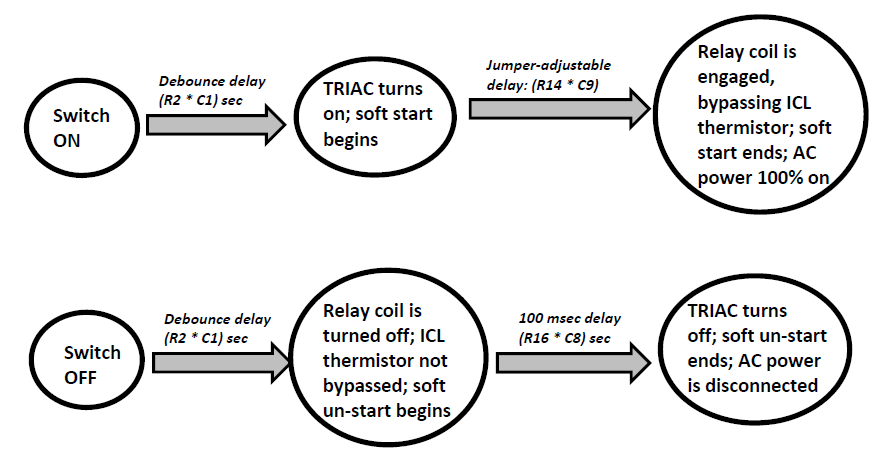

STATE TRANSITION DIAGRAM \ TIMING DIAGRAM
Figure 5 illustrates the sequence of events that occur when the equipment is turned On, and when the equipment is turned Off. As you can see, all delays are set by RC timeconstants on the PCB. Ambitious, self-confident DIY builders can modify these timeconstants, if desired, simply by changing component values.

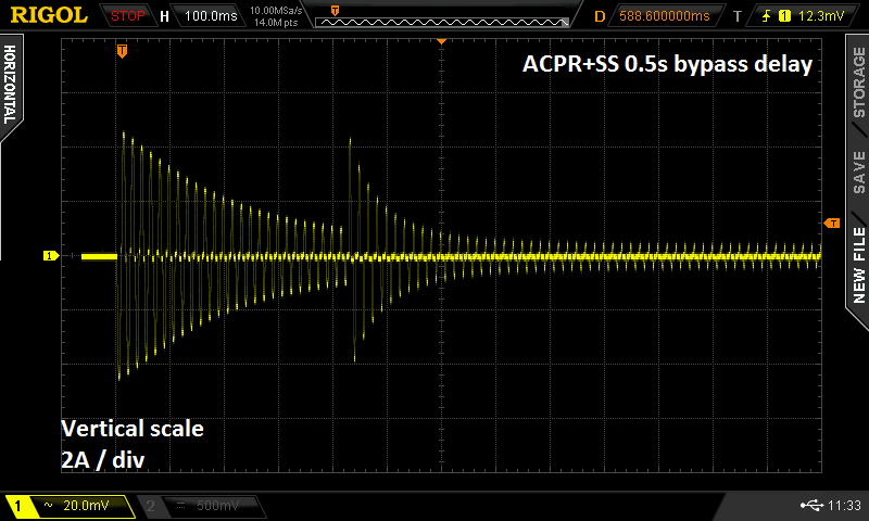

INRUSH CURRENT: BEFORE AND AFTER INSTALLING SOFT START
Figure 2 is the "before" measurement; it shows a stereo chip amp's power on event with no soft start applied. Figures 6 and 7 show the same amplifier, but with this PCB installed between the transformer primary and the AC mains.
In both Figure 6 and Figure 7, the inrush current has been reduced quite dramatically. "Before", with no soft start (Figure 2), inrush current peak was 24 amps. "After", with this PCB installed, inrush current peak was only 4.4 amps (2.2 vertical divisions X 2 Amps / div). (The horizontal scale is 100 msec / div as reported at top left in the Figures.)
In Figure 6, a shorting bar has been connected on header P7 from pin 1 to pin 2. This selects the "0.5 second delay" option for ICL bypass. You can see that when the ICL is bypassed, AC mains current jumps up. Because there is suddenly less total resistance in the transformer primary circuit.
In Figure 7, the shorting bar has been moved to pins 3 and 4 of header P7, which selects the "1.0 second delay" option for ICL bypass. Now the bypass comes later, and the up-jump of AC mains current is smaller.
These figures suggest, at least to me, that a setting of 1.0 second delay before bypass is desirable. And that's what I'll be using in my equipment. But other DIYers have the freedom to choose other settings, as they see fit. Thank goodness the jumper select options permit this easily.

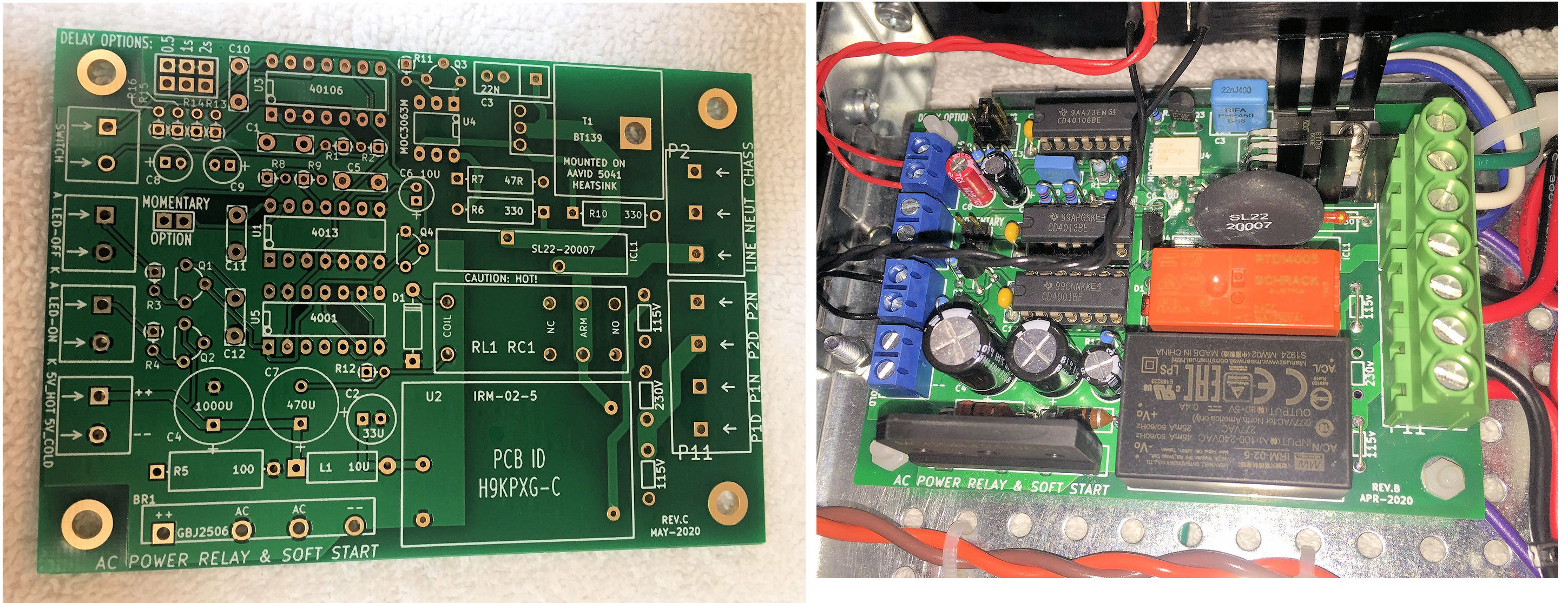

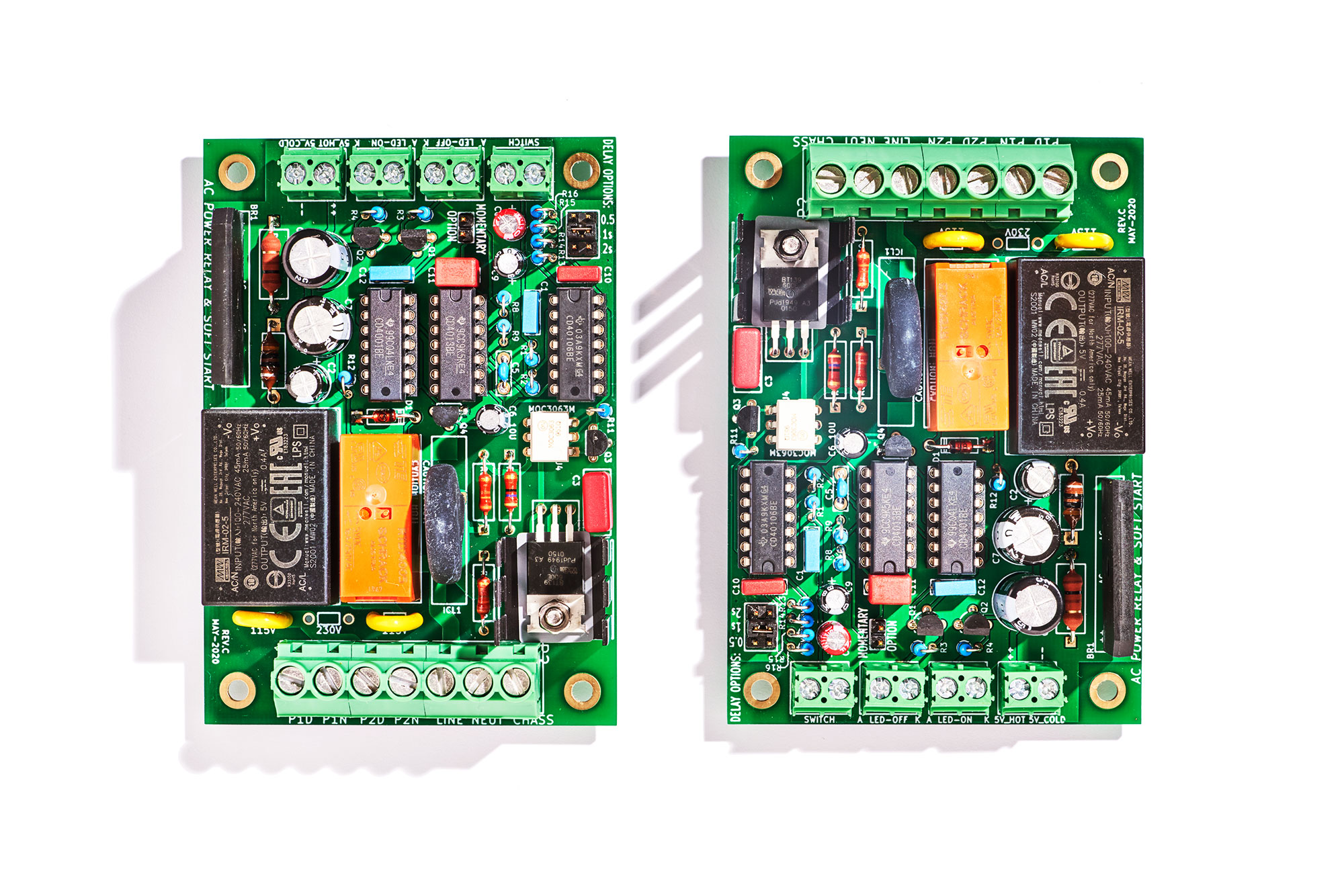

AVAILABILITY
I have attached the Gerber CAD manufacturing files for this PCB; its unique identifier is H9KPXG . The suffix "-C" indicates revision C of the layout. Anyone can send the .zip archive of these Gerber files to a PCB fab and have boards made; the design is public domain and uncopyrighted. Use them however you wish. I hope if you end up with extra PCBs, you will consider giving them away for free, or selling them at low cost, to other diyAudio members.
As of today, 23 May 2020, I have about twenty extra boards (2oz, ENIG) which I am willing to sell at my cost: USD 3.50 plus postage. One board per customer. In the present conditions I will be shipping to US addresses only. The required US Customs paperwork and face-to-face handoff for international shipments is, I regret to say, unacceptable to me. If you live outside the US and want a PCB, send these Gerber files to a PCB fab and have them ship boards straight to you. Give away or sell any extras.

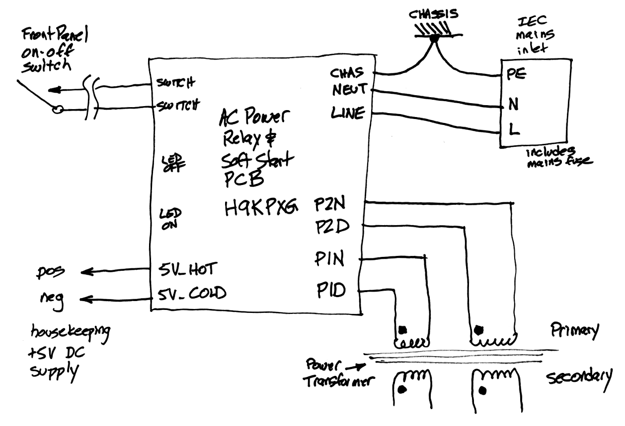

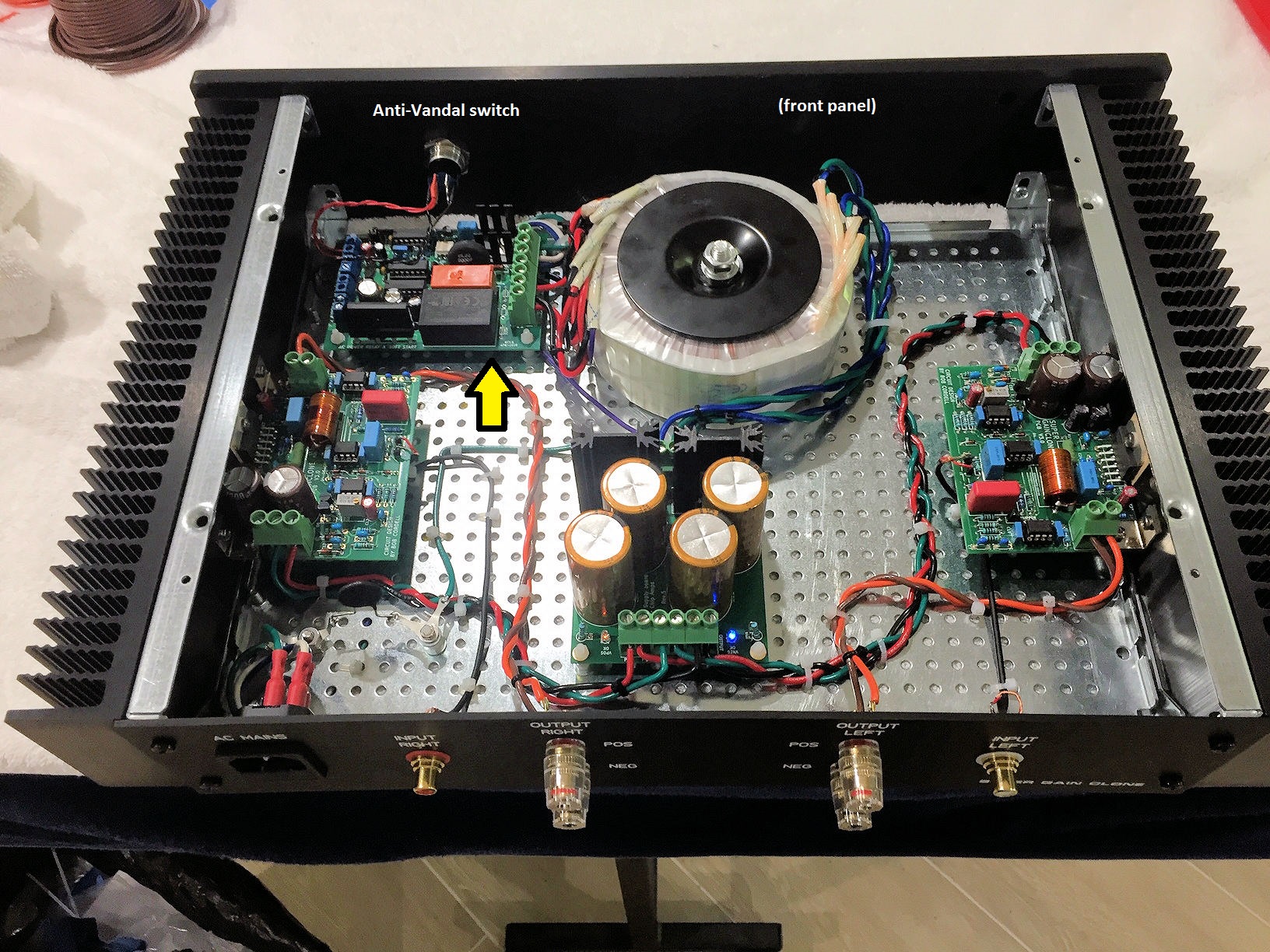

Couldn't quite attach all relevant figures to post #1. This last figure shows how to connect the AC mains relay & soft start board within a power amp.
This board assumes the amplifier's mains wiring includes a fuse, most likely incorporated into an IEC mains inlet module. One of these is drawn at upper right. The three output terminals of the IEC module are Earth (center), Neutral (left), and Line (right). Neutral and Line are wired to the AC Power Relay & Soft Start board (abbreviated ACPR&SS from now on). Earth is wired to the equipment chassis. On the same chassis bolt, another wire connects to the "Chas" terminal of the ACPR&SS.
The power transformer has two primaries. Primary number one is labeled P1 and primary number two is labeled P2.
The two wires of primary number one are further distinguished; one of them has a Phase Dot (check the transformer manufacturer's documentation) and the other does not. The primary one wire WITH the phase dot is named "P1D" and its name is spoken "Primary One Dot". The primary one wire WITHOUT the phase dot is named "P1N" and its name is spoken "Primary One NoDot". Same for primary number two.
On the Antek AS-2222, for example, P1D is a red wire and P1N is a black wire. Similarly, P2D is a red wire and P2N is a black wire. Check your transformer documentation to find out which wires do, and do not, have phase dots. Make careful notes of their colors.
The On-Off switch connects to the ACPR&SS at upper left. Since this is a low voltage, low current circuit, just about any wire type will suffice. 26 AWG stranded wire, for example, is perfectly acceptable. The connections to the PCB are unchanged, whether you use a momentary pushbutton switch or a rocker-toggle action switch. (That is handled by an electrical jumper "P6" on the board).

I ordered some boards from a PCB fab, first time doing that—we shall see—I need more than your limit of 1—M2X mono blocks. My mounting options are limited—hopefully the amps stay quiet... I'll try one and see.
I would ONLY use 1 oz copper (35 micron thickness) on the PCB, if I was absolutely certain that the mains transformer's Volt-Ampere rating was less than 201 VA. If the transformer was any bigger than that, I'd insist upon 2 oz copper.
Besides, the price difference between 1 ounce and 2 ounce copper, isn't very big. Here is what PCBShopper – A Price Comparison Site for Printed Circuit Boards has to say:

I will propably have three extra PCBs in Denmark, if anyone is interested.
I am listening to Roon via an always on raspberry pi. What i am working towards, is using a GPIO from the rPi to trigger the DAC, and then the rest of the chain. A while back i started designing a PCB which, apart from the functionality on your PCB, has trigger in/out (with apropriate trigger out delay) and loss of AC detection (for speaker relays). However i have way to many projects, and with your well engineered PCBs, i am one step closer to finishing my F6 🙂

By the way, if anyone wants to make before-and-after photos of inrush current, with and without countermeasures (this board, a different board, etc.), maybe the little homebrew test fixture I built a couple years ago might be a useful starting point. A circuit schematic and photo of working fixture are in post #41 here. If that link isn't working the post date was 16th Dec 2018.
I used the MOC3063M optocoupler and the BT139 triac back then; they worked well for me and the cost was low. So I used the same parts again, in this AC power relay board; they're known good.
Notice the double dose of conservatism in post #41: galvanically isolated, battery powered switch, AND gloves. With good result: many tests but zero electric shocks to the operator (me).
Here is an example of the AC power relay board, mounted on the 10 x 10mm grid of a Modushop chassis baseplate. This PCB is the one indicated by a yellow arrow on the photograph.
For the front panel switch, I used a 19mm diameter, illuminated pushbutton that I bought from Newark (link)

If you're thinking of doing your own board, please also have a look at the design by member Bensen (links in post #8) for additional ideas. Plus of course, the original sources linked in post #1: Pass, Elliott, Cordell, Self, jhofland, T.I., Bryston, Ganssle et. al. Between all of them you'll get a bunch of ideas and a bunch of already-proven subcircuit blocks, which you can mix and match and tweak and fiddle, however you please.

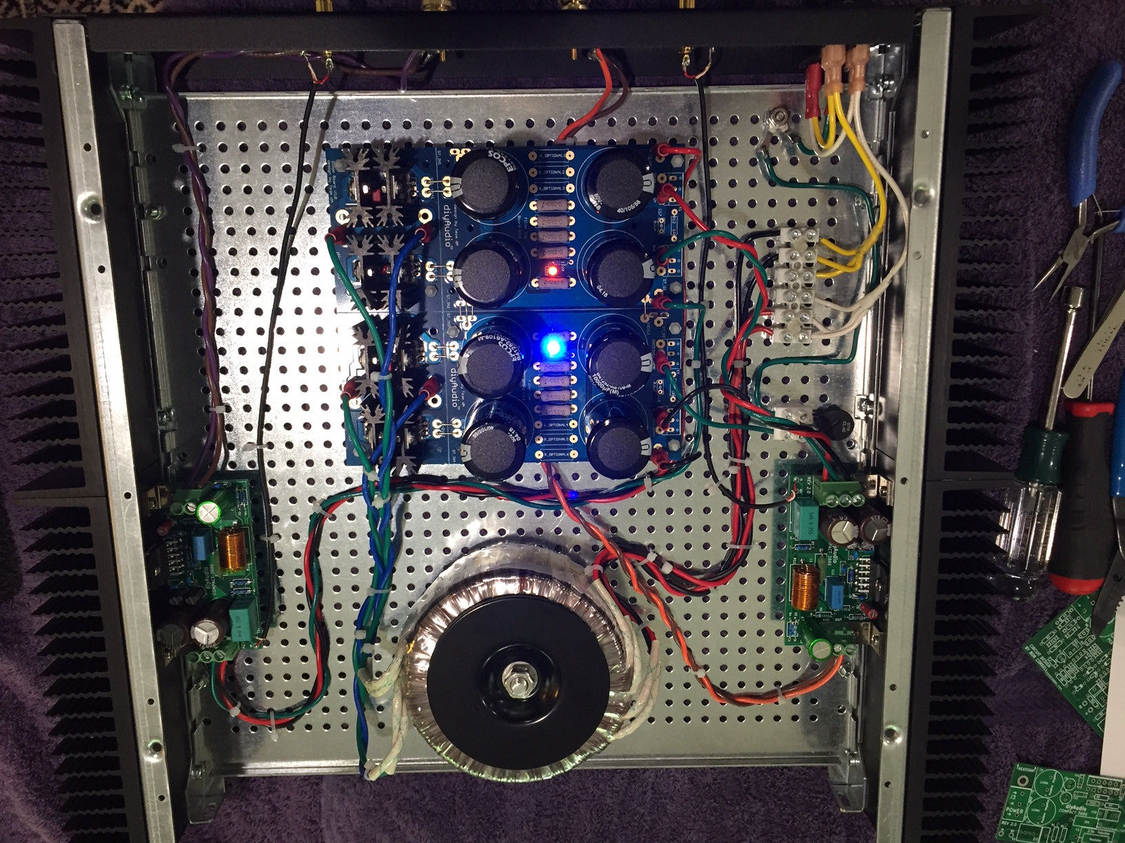

I just made up a couple of these boards.. Thanks Mark!!
Found an error in my cart!!—fixed here:
Mouser Electronics
I'll post some pics of the built boards later...
Suffice it to say I learned a lot about soldering—and I wouldn't say I'm a novice there—but I had to go up 100 degrees F to get some areas to flow... Assuming that's due to the fact that more than half the board is copper...? The experience was the same for both boards... Kinda interesting...
Mouser Electronics
