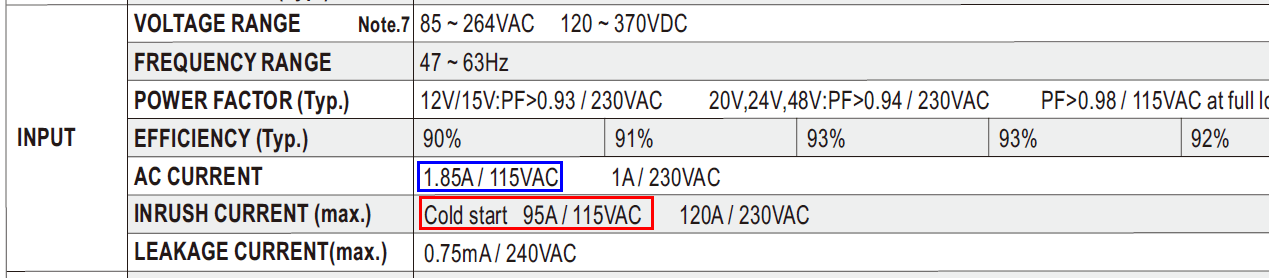

Attached below is a datasheet of the SMPS that Nelson Pass specified for the VFET lottery amplifiers here on diyAudio. This SMPS has an inrush current (drawn from the AC mains when the SMPS is turned on) greater than 90 amperes (120 amps in Europe). If you are concerned that this huge current will stress your power on-off switch, and/or mains fuse, and/or the home circuit breaker, then a soft start can bring peace of mind. It's a human judgement call.

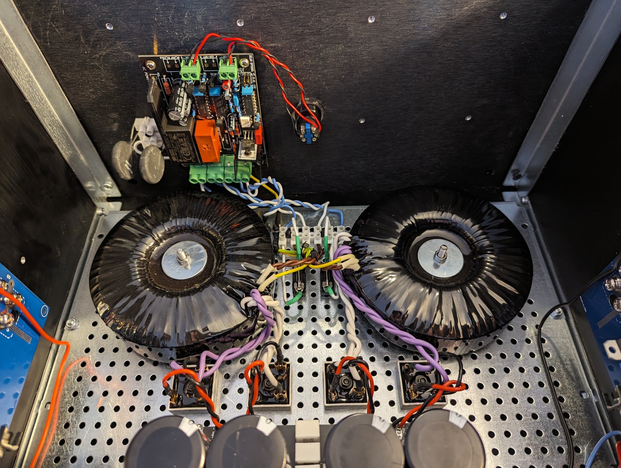

I have been using the the soft start board for the past 10 days, in a newly built xa252. Today, it suddenly does not turn off the amp when the momentary switch is pushed. If I power off and on the mains inlet, it returns to the resting stage and can be turn on using the momentary switch. However, no turning off with the momentary switch. I tried searching the thread but came up empty and thought I would ask for advice here.

Do you hear the sound of a relay click when you go to turn it off (after depressing the momentary switch)?
It seems there is a click, likely the bypass relay? Could the main relay have gone bad? Guess I will need to haul it out, open it up and inspect. Just noticed that one channel turns off...and the second channel after 40 seconds.
It is hard to tell from your photograph in post #696; is the jumper labeled "MOMENTARY OPTION" (schematic P6) installed? It should be. You can remove and replace the jumper shorting-block a few times, to polish the contact surfaces. Maybe that fixes your problem.
The first thing to find out is: do the 5V logic signals SW_ON and SW_OFF change, when you push the momentary switch? They should.
SW_ON can be probed at U3_pin_8 or U5_pin_1 or U5_pin_8.
SW_OFF can be probed at U3_pin_6 or U3_pin_9.
If SW_ON and SW_OFF do not change when you push the momentary switch, the list of possible causes would include
