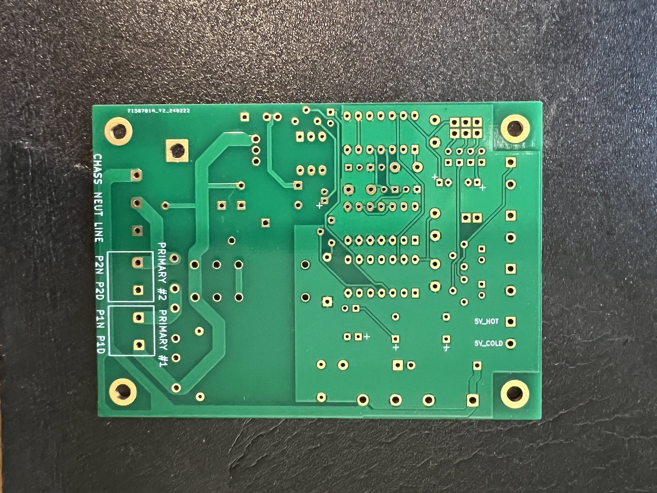

I have just built two modules, all good.
I have six spare PCBs (I have ordered 10 with intention to share here).
Manufacturing details:
Base Material: FR-4
PCB Thickness: 1.6
Surface Finish: ENIG
Gold Thickness: 1U"
Outer Copper Weight: 2 oz
I have paid about 6 Euro per PCB (boards, shipping and tax), shipping across EU is about 6 Euro (registered economy).
If anyone in EU would like to get such a PCB (6+6 Euro), PM me. Six boards to go.

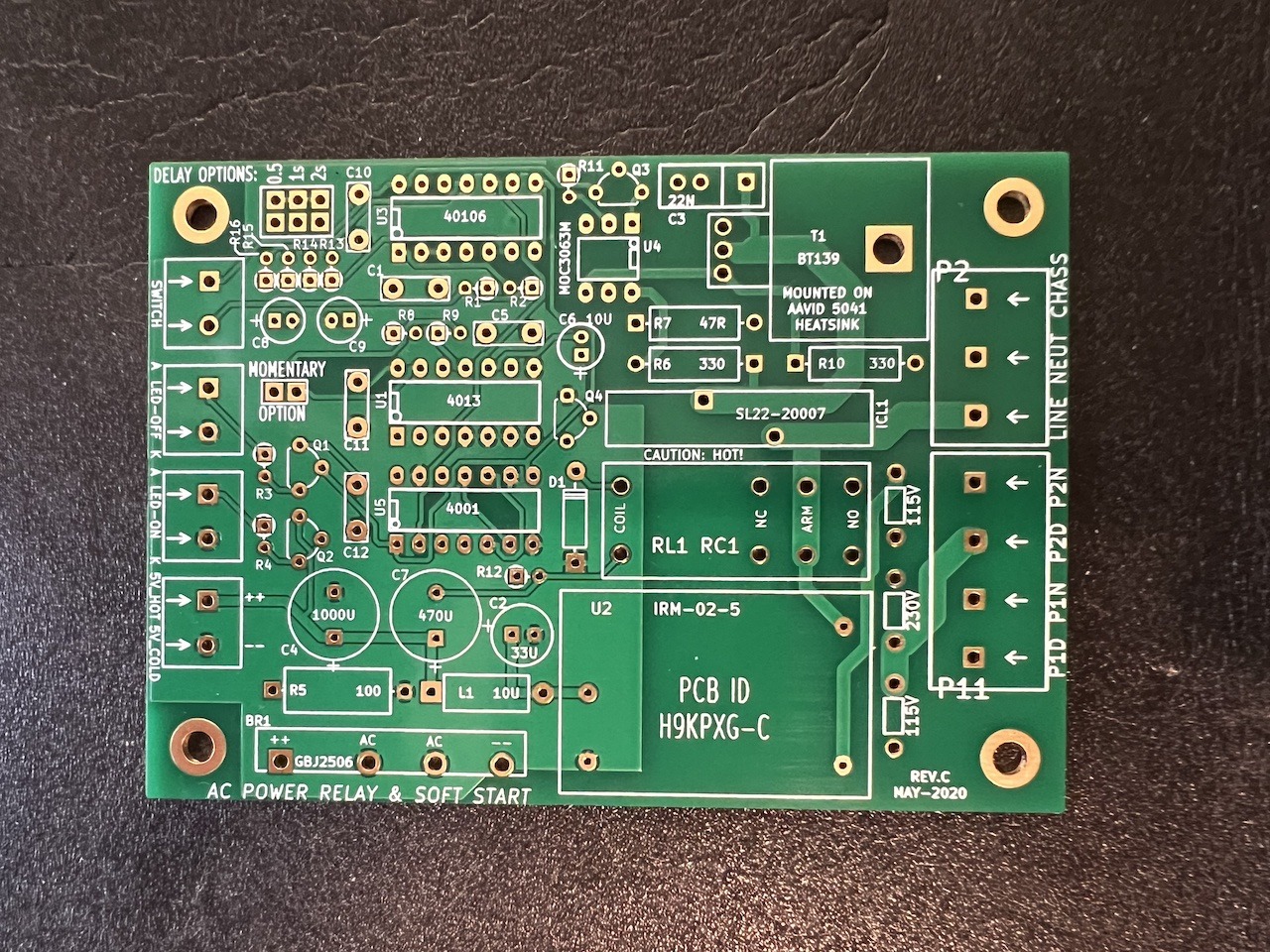

So after the initial power on the inrush current goes through ICL, time delay passes, and then relay contacts are closed to bypass ICL and connect the load to mains. My question is why there is no need for relay contacts protection like RC snubber? Would there still be an arc when relay bypasses ICL? Thanks
A vendor sells a fully assembled and tested soft start PCB similar to this one, currently priced $189 plus shipping. They consider VivaVee's observation (about H9KPXG) to be an important sales feature of their board too
The vendor's sales page says ...
Relay Saver Technology I: An electronic switch engages the soft start before the main power relay on power-up and disengages after the power relay on power-down. This minimizes the switching current and voltage across the relay contacts, thereby minimizing arcing and the associated contact wear and RF emissions.
("An electronic switch" on the sales page, is triac T1 on the H9KPXG schematic)
At the time that the relay contacts close, current is already flowing through the triac therefore the voltage across the relay contacts is almost zero, therefore no arcing.

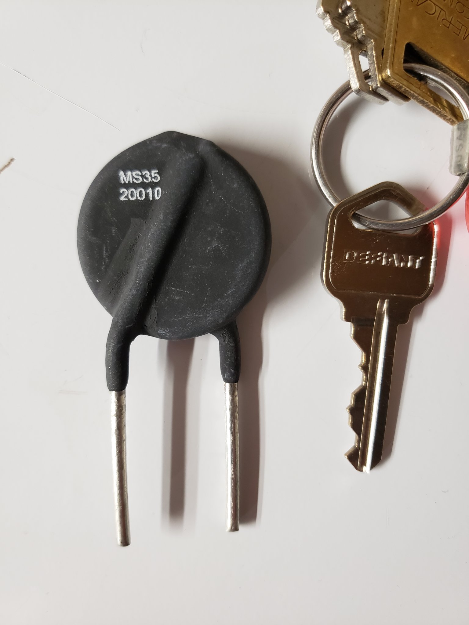

If I were going for a single CL then perhaps this looks like the right puppy
https://www.mouser.com/ProductDetail/Ametherm/MS35-20010?qs=PVyXUKBeRH1hG9TUGmmutg==
20ohms cold and 500Joules.
got some serious legs on that thing 2.5mm diameter! welding rods.
