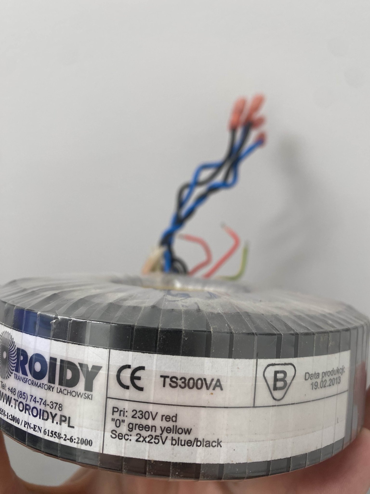

Hello everyone,
I'm in the process of setting up a soft start circuit and I want to double-check my toroidal transformer wiring. I've attached two pictures for reference. The label and the wires. I'm using two toroids in double mono configuration. I'm connecting the green/yellow wires of both toroids to the inlet Earth/Chassis. As for the 230 primaries, I'm connecting four red wires in parallel to P1D and P2N. I'm mostly unsure about the green/yellow wires. Is this the correct way to connect them to the inlet Earth/Chassis and both transformers with a soft start circuit? Thanks in advance!
Solder a jumper in position 230V. Leave positions 115V in their virgin, unstuffed and unsoldered condition
Red wires of transformer_left connect to P1D and P2N
Red wires of transformer_right connect to P1D and P2N
Green/yellow wire of transformer_left connects to chassis earth
Green/yellow wire of transformer_right connects to chassis earth

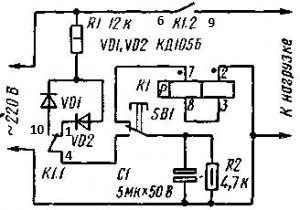

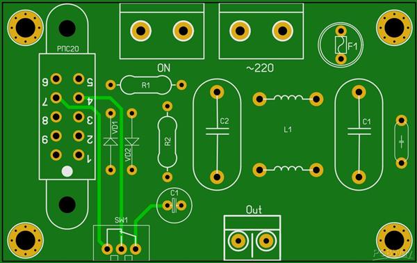

For low-power devices, I use a diagram in the figure with a polarized RPS-20 relay (РПС-20 soviet relay), adding a simple filter to it. The button is needed without fixing with contacts for switching.

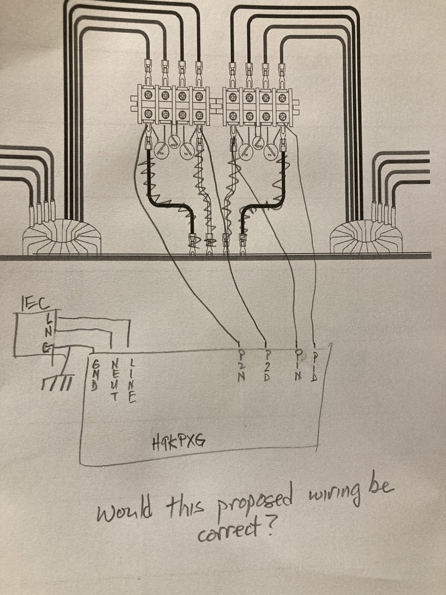

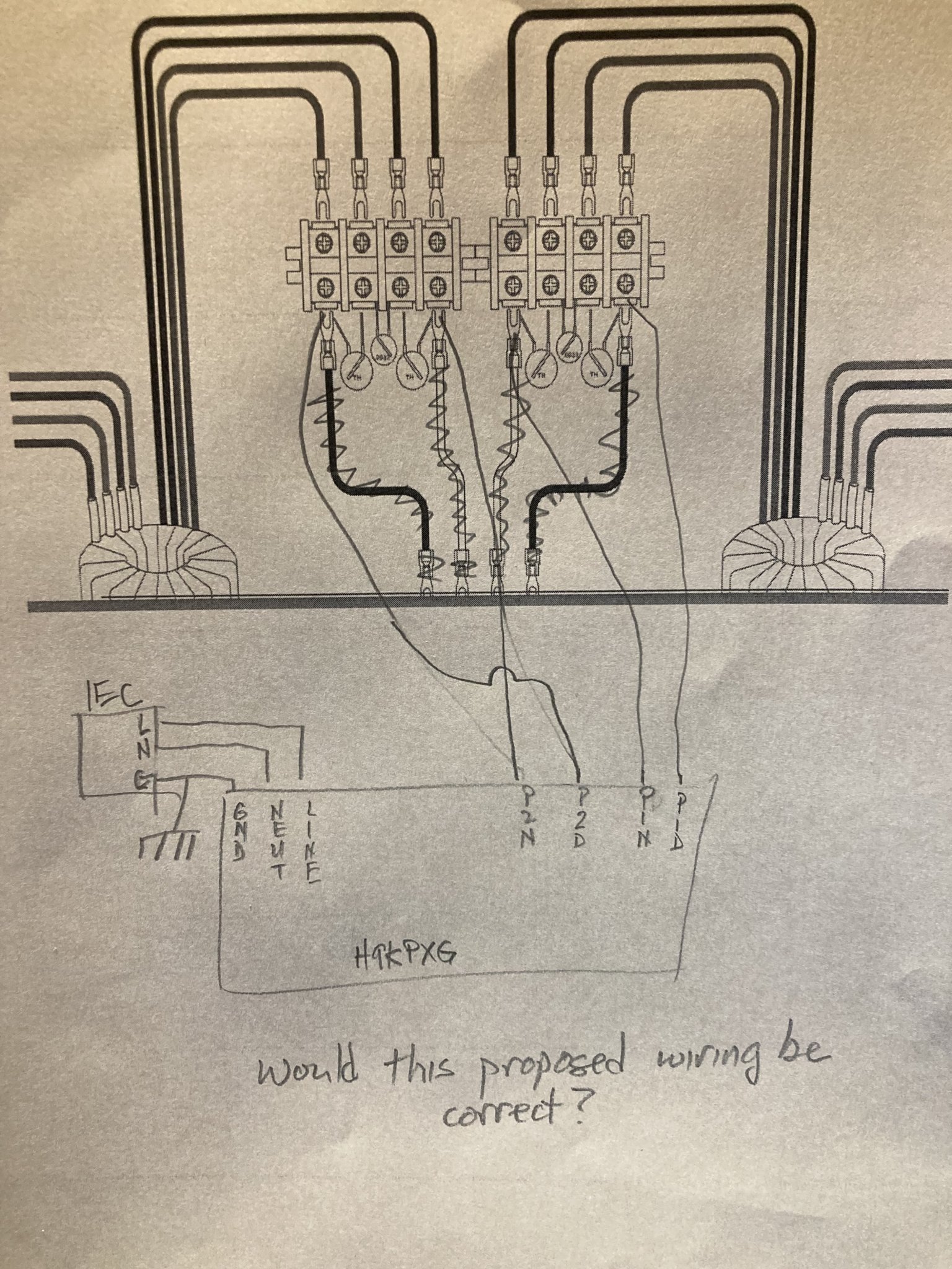

My H9KPXG arrives today. I'm using the DIY universal PSU in a dual mono. I've read all the posts in this thread and still want to double check how I wire this in. Attached is what I think I've learned. Does this look right?
Also I have this set as as dual fused. Is there a way to keep this and still use just just one H9KPXG-- like fusing the P1n and P2n wires?
Sorry in advance
for such a boring, low level question, I just hate smoke, though
