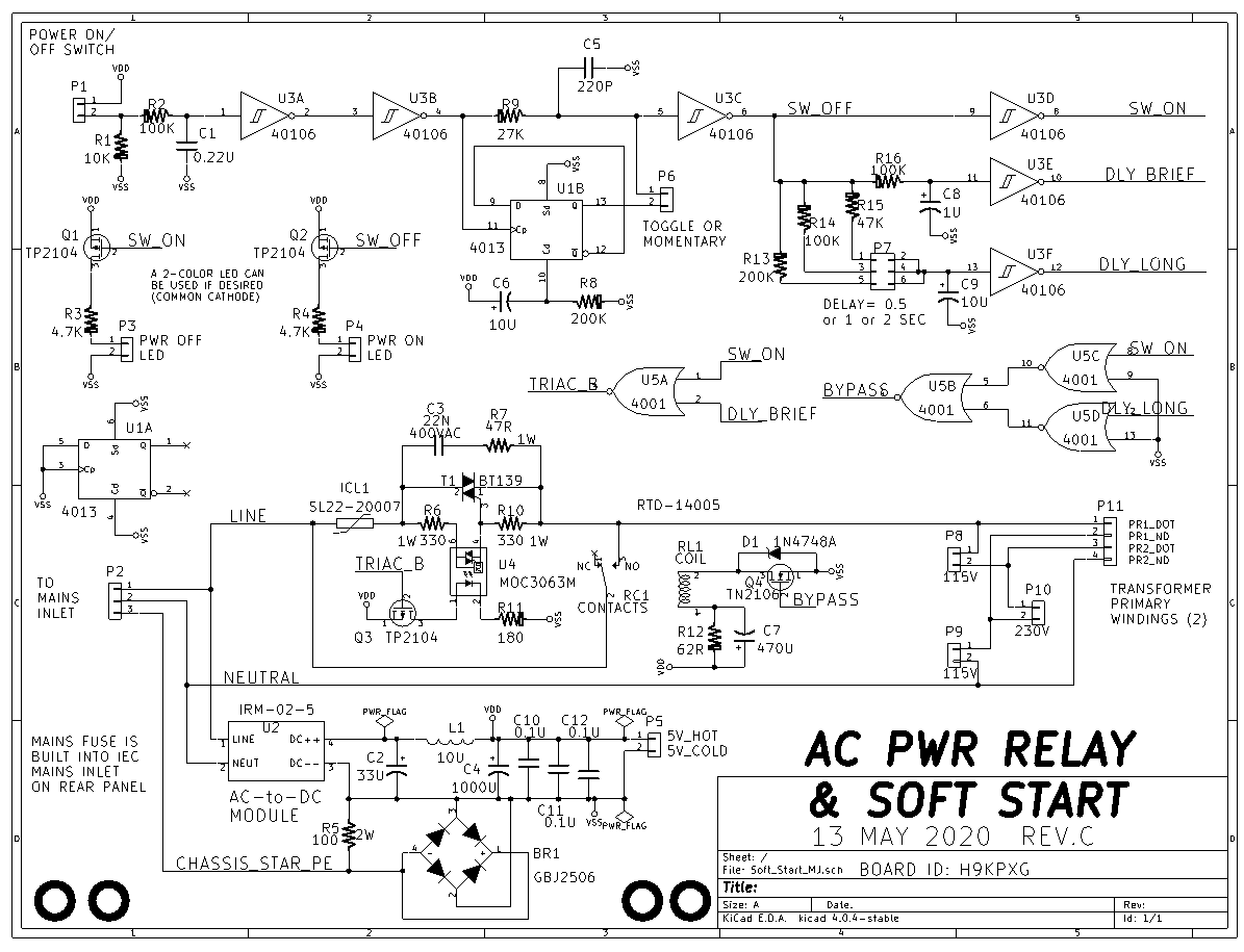

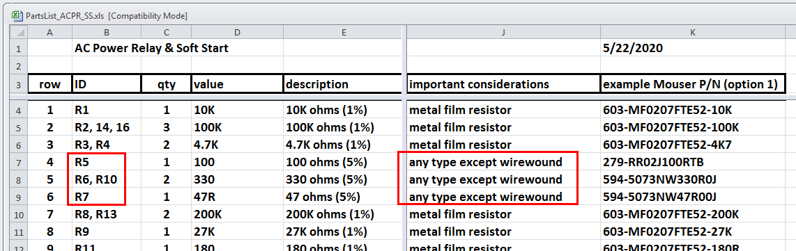

Can anyone explain to me why wirewound resistors are less suitable (or non-suitable) in certain applications, such as at R5 on the H9KPXG circuit?

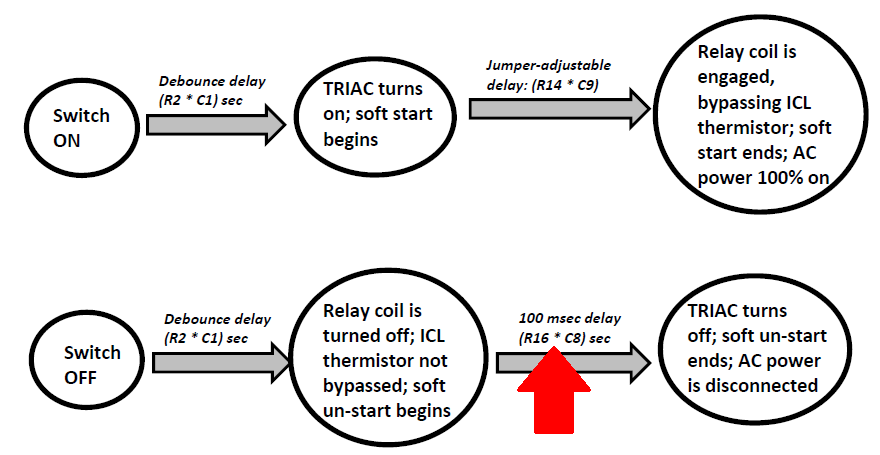

Ok, I've digged a little bit more the schematic and found the solution by my self to my question (post #257)
at first power on C8 is discharged and take some time to charge. While C8 reach it’s charge U5A have SW_ON (+) and DLY_BRIEF (-) (U3E and U3D)
U5A is a NOR gate so it will issue a LOW signal (TRIAC_B = Low)
Q3 will light the optocoupler (U4) and Triac let the main flow
Now, some time passed, C8 is at is nominal charge and U3E change it’s logic state and so do U5A issuing a HIGH signal (Triac_B = High)
Now, only now, Q3 and U4 will react, turning off the Triac
All this will happen in a very short time but it is sufficient to fire up my big donut
Is this critical ? I really don’t know but I think I will not mount C8 again…

I'm in the midst of building my first H9KPXG board and have just discovered that the 100R 3W resistor in my inventory that I was going to use at R5 is a Vishay RS series wirewound. Your BOM warns against using wirewounds in that position. Can you explain why?
Scott
Maybe I'm wrong but I believe that it is because wirewounds resistor have some characteristics inductance that are not suitable for the pourpose that R5 is intended for in this specific position
R5 and BR1 are parts of safety circuit Mark designed to save our lives...🙂

Michele:
That's interesting and something I wouldn't have guessed. Unless someone says otherwise, I'll trust your response is correct. That changes things a little, and I now need to order some resistors.
Thank you!
Scott
I believed that everyone who builds one of these boards, will need to order some or all of the components from a distributor. After all, who has a triac AND a 125 Joule inrush current limiter disc AND an AC-to-DC converter module with the right pinout AND the correct sized wire-to-board terminal blocks, sitting in their parts bin?? My answer: nobody. This means: absolutely every builder will order many or perhaps all of the line items on the Detailed Parts List.
Since you're going to be placing a parts order anyway, I may as well recommend that you order the least controversial, greatest safety, most tried and true components that I'm aware of. And, for the resistors which connect to the AC mains, those are non wirewound resistors. Just order them and use them and sleep soundly at night.

When I turn it on with the mains inlet switch some current flows to the transformer and there are about 10v DC at the power supply output. This will slowly goes to zero while the capacitors discharge.
Unfortunately, what you are doing is exactly the opposite of what the AC mains relay & soft start board expects.
The board expects that you will leave the mains inlet switch ON at all times, and will turn the audio equipment on and off using the low voltage front panel switch.
The board contains an "always on" 5V DC power supply, carefully selected to meet international standards of ultra low standby power. And the circuit design assumes this 5V power supply is always on, namely, that it is always connected to the AC mains. But you are switching it off (and on) from the inlet switch. That was not forseen, indeed it was not even imagined, when I designed the circuit. Don't do that!
I don't recommend removing capacitor C8; it has an important function and that's why it's present on the circuit board. The state transition diagram from post #1 of this thread (copied below) shows why: C8 gives the soft unstart behavior that we want, to protect the relay contacts during shutdown. Removing C8 destroys the soft unstart, and thereby eliminates contact protection during shutdown. Don't do that.
If you are confident in your knowledge, and if you are brave, and if you really want to tinker around, you could replace C8 with a 1 microfarad capacitor to VDD instead of the existing 1 microfarad to VSS. You might as well use a nonpolar capacitor for the experiment, just so you don't have to worry about which plate of the capacitor is connected to which node. 1uF nonpolar capacitors are available in ceramic, film, and "bipolar electrolytic" types. A physically small cap with nice long leads would allow easy experimentation, and you'll want to have several of them so you can make several attempts.

Mark, I don’t like to make something w/o trying to understand what I’m doing, this is the reason why i wrote post #257
I live in a home that have a home automation system. When nobody is in, the home enter into sleep mode and all non essential appliances (including my Hi-Fi stuff) are disconnected from mains.
Now I see that the answer to my question was already here, in post #1.
I appreciate a lot your suggestion and will change C8 to vdd
