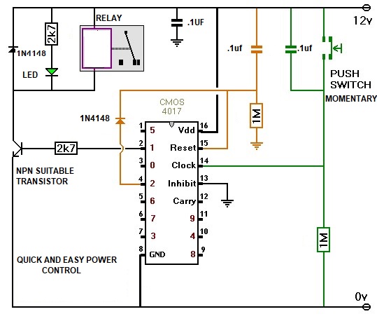

Here's my simple ON/OFF power solution using a momentary pushbutton switch/low voltage standby powered.
Works perfectly and uses a minimum of components.
If desired, a 555 timer can be implimented to make a "countdown" switch for a second relay.

This one uses a micro controller and costs less than building one.
12V Bond Bistable Relay Car Modification Switch Start Stop Self-Locking Module K | eBay
Mark's design has soft start though. Neither yours or this one do.
Yes, however I was just contributing a simple on/off approach that uses a low voltage/low current momentary pushbutton design to control a main power relay.
With an additional 4017, along with a simple 555 timer, the circuit could activate a second relay after a time delay used in soft-start application.
I would gather that parts and layout would be much less involved then the OP's design.

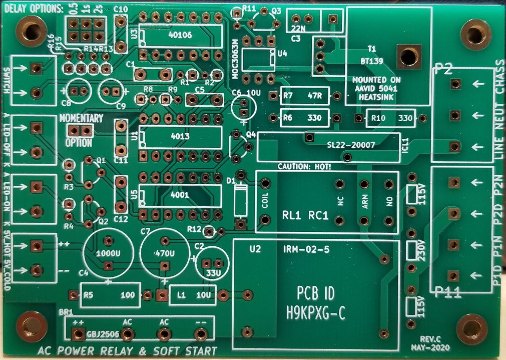

Guess?? The silkscreen AND the pcb itself is marked!
Silkscreen has A and K printed on the LED pads, and the solder pads themselves are square and circular, square is positive. (just like the capacitors)
I am actually talking about the wires from the switch LED. But, I am glad to see so many boards now with the square pads for the (+) for parts. That does take most of the guessing out.
And, yes, the board is quite well marked. The switch I am using came with a computer PC wiring harness, which I cut short, removing the marked ends. I did be sure to distinguish the power switch pair from the LED pair. Since I could no longer read the tiny indented marks on the switch LED tabs, I knew that the switch pair did not matter how connected. I figured I could swap the leads to the LED if it did not light up. Then I did not have to unmount the switch to try and read the dang tiny marks with my old eyes.
DO NOT depend on square vs round! It is completely arbitrary and could be used in both (opposite) orientations on the same PCB. In fact I think I might make my next few boards with all-square pads just to thwart people who use hole shape as a crutch. Don't do it!!
Instead, use your brain, use the schematic, use your DVM on continuity buzzer mode. One of the LED holes will have electrical continuity to the other component leads where the LED Anode (positive terminal) is connected. The schematic tells you what the LED Anode should be connected to. Buzz it out with your continuity tester and verify that Pad_X is connected everywhere LED_Anode is supposed to connect. If so then Pad_X is LED_Anode.
And oh by the way, the boards I lay out have the anodes of diodes marked with an "A" in top silkscreen, and the cathodes of diodes are marked with a "K". Even Light Emitting Diodes. I do this as a quick reminder to myself when stuffing boards: Anode goes here, Cathode goes there. If you see "A" and "K" on silkscreen, you can rely upon that. Just don't imagine that square pad or round pad means anything special -- you'll get burned.

If you stuff and solder an H9KPXG PCB according to the schematic and the Detailed Parts List, you'll get soft unstart whether you want it or not. If you really, really don't want soft unstart you'll need to devise a modification to the circuit design. It will probably require a few "cuts and jumps" to the copper traces of the PCB, but if you're both clever and lucky, no new components. I offer my best wishes for successful completion, but I do not offer any assistance; in my opinion soft unstart is a good idea not a bad one, and I won't participate in disabling it.
Soft unstart describes the gradual and safeguarded procedure used in H9KPXG during turn-off. The big idea is to turn the triac on and leave it on, before, during, and (importantly) after opening the relay contacts. Thus the triac + ICL appear in shunt, across the relay contacts. If the relay contacts bounce (and they usually do, when opening), the triac+ICL damps ("quenches") any possibility of contact arcing during bounce(s). Finally, after a delay time much longer than the longest possible contact bounce, the triac shuts off and current to the load (transformer primary) is zero.
Soft unstart lengthens the service life of the relay contacts, by preventing contact arcing during shutoff.
There's a diagram of this, figure #5 in post 1 of this thread. Look for the oval shaped bubbles and arrows.
