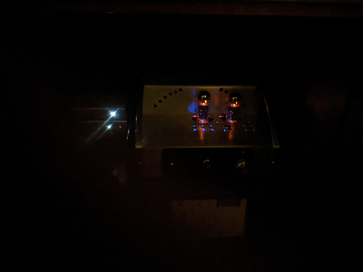

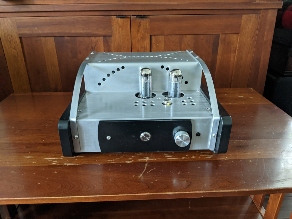

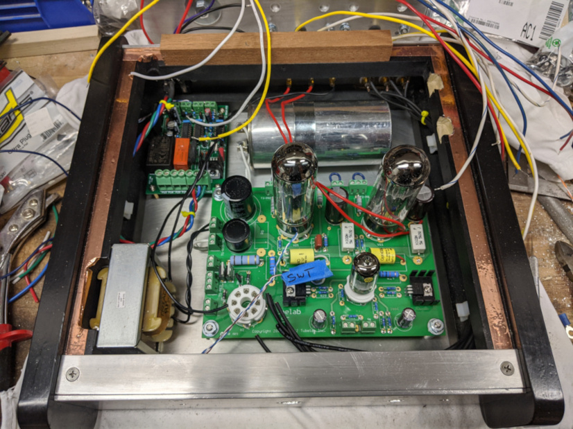

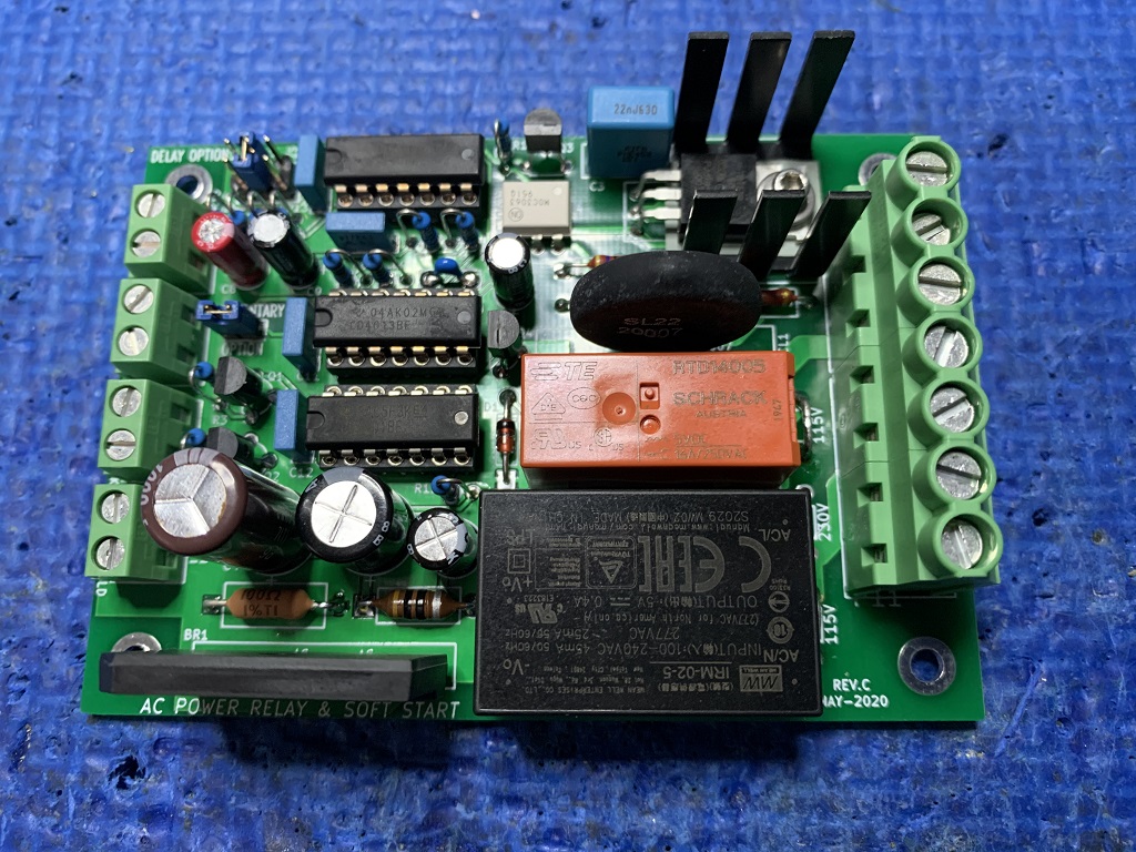

Sharing another completed project using Mark's soft start board. It is doing it's job in my recently completed Tubelab SSE. Makes life easier on the tubes set for a 2 sec delay along with the piece of mind that only 5V is running to the push button switch on the front. I think the blue led power on "accent lighting" it provides is perfect using the spec'd resistor. Of course now I need to do something about those retina abusive white leds on the components to the left.
I am sure I have been one of the needier builders so a big public thank you to Mark for his generosity in helping me out!
Lovely build, spiggs. Congratulations! I agree with you, that eerie blue glow from within is very appealing. Well done and good on ya.

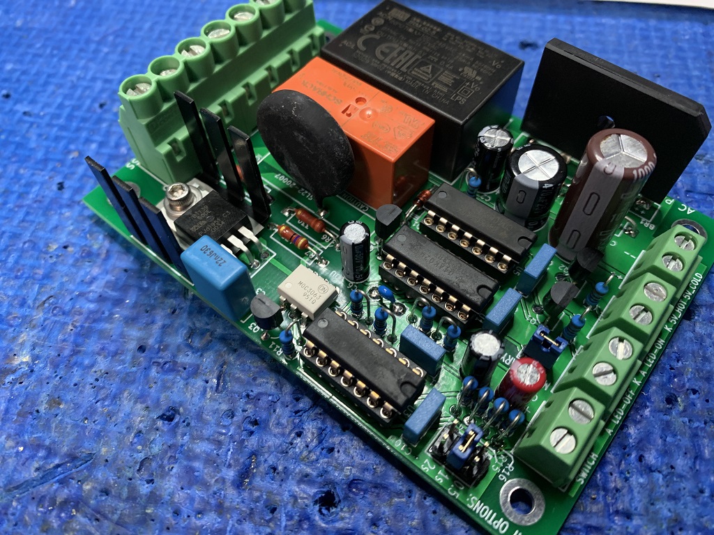

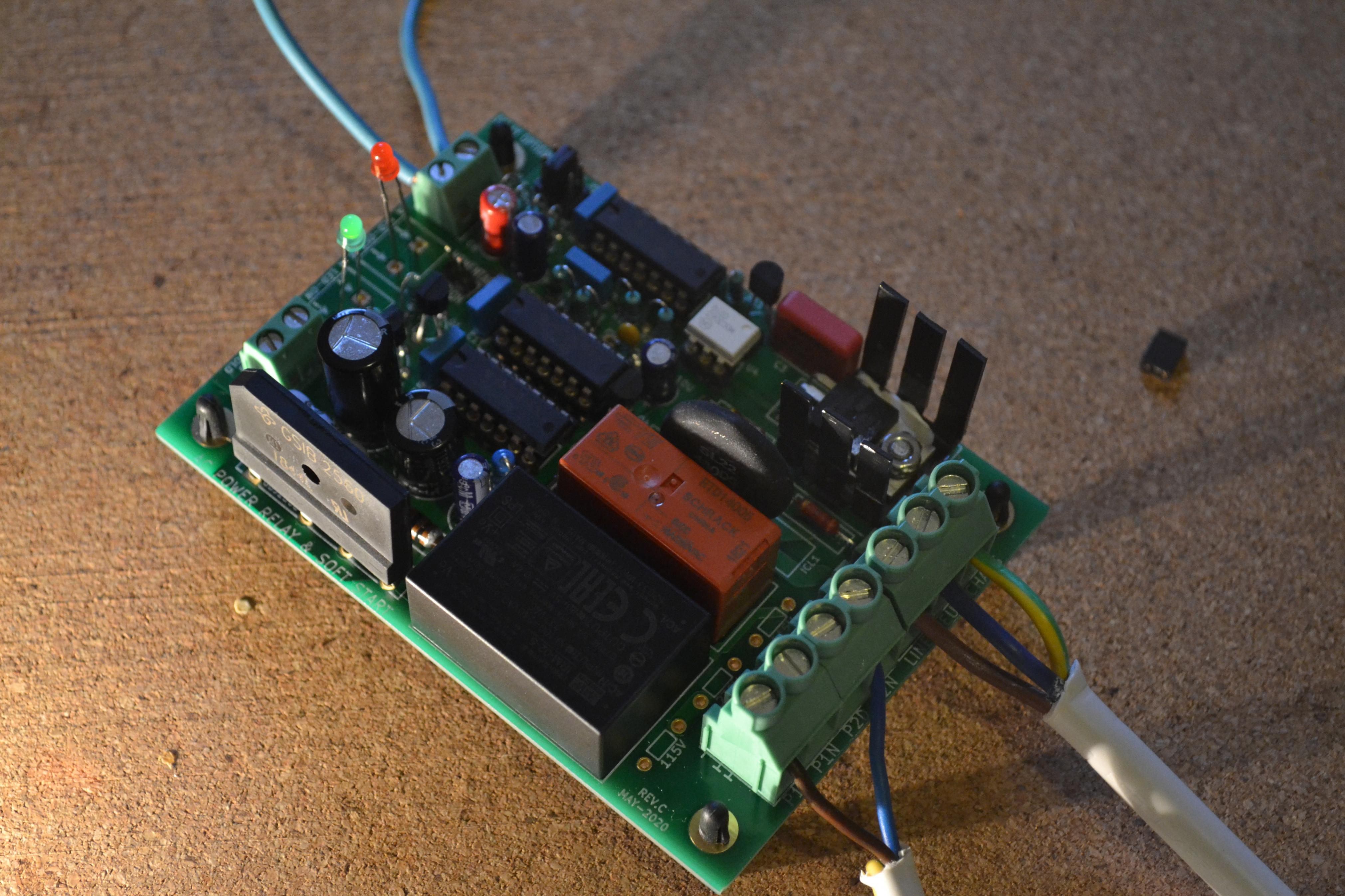

Hi all,
Got the PCBs today and assembled one board, tested and fully working! Thanks Mark for this super nice project!!

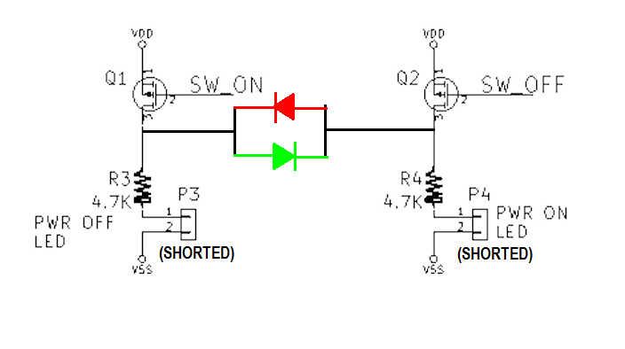

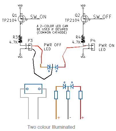

I have a question for you or anyone that could answer it... I plan on installing a Bulgin momentary switch with dual colour LED. Unfortunately, this requires reverse polarity for the second colour to light up. Anything possible with the current design to make this work without having to install relays or other ICs to do this properly?

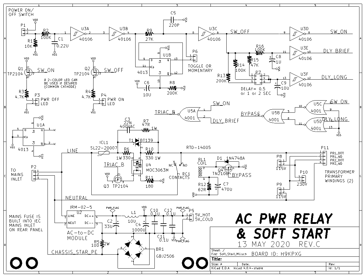

Bulgin has a very impressive catalog of many-many choices. Clue?
The first dual-LED I found looks like common-cathode which may be dead-simple in Mark's circuit?
https://www.diyaudio.com/forums/att...cludes-soft-start-h9kpxg-schematic_acprss-png
Hi PRR,
Yeah, a three wire common cathode is ideal in this scenario but I already have those bulgin switches and it is a two wire which requires reverse polarity to light the second led.
For now I just connected a led directly on standby so I can see it through the chassis grill.

@pinnocchio --- if you are an extremely brave DIYer with excellent fabrication skills, you could consider soldering a couple of "bodge" wires to the upper (loopy) leads of resistors R3 and R4; and then connect those wires to a two-pin, bidirectional, bicolor LED. You'd need to devise a way to mechanically support those wires, because solder joints are notoriously fragile. This is certainly not a supported option, and I don't recommend it, and if you decide to do it anyway: you are completely on your own. So don't try it unless you are extremely brave.

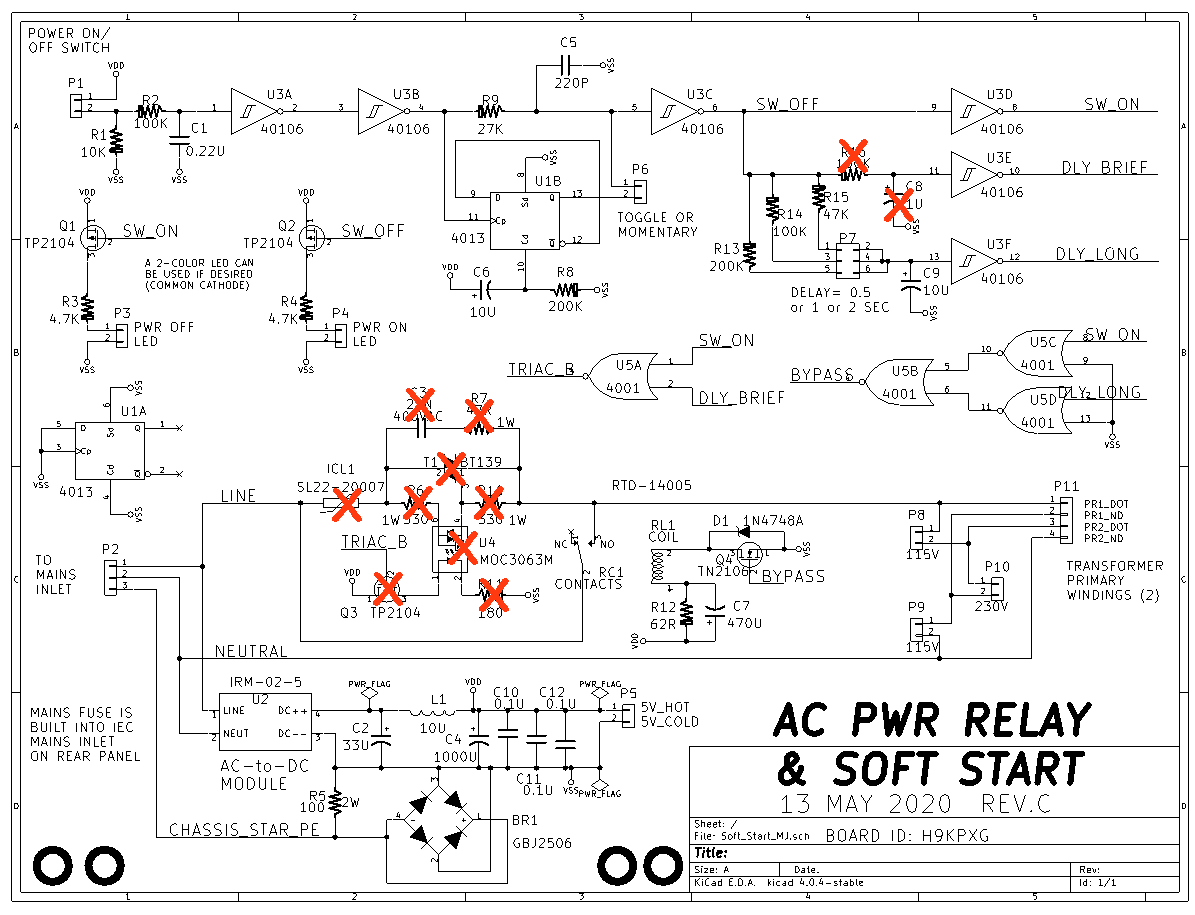

Hi Mark,
If I want to use this circuit for powering a small current device like a preamplifier, I don't really need the TRIAC and Inrush, just the bypass relay. Looking at the schematics, can I omit the following parts :
Q3
U4
R6, R7, R10, R11, R16
T1
C3, C8
ICL1
Am I missing anything?
Do
Q3
U4
T1
C3, C8
ICL1
Do

Might be better to mark-up a schematic instead of a detailed text question. It has taken me 20 minutes to find the schematic, find the many SMALL parts listed, and mark them out. What is this, $5 of parts?
Hi PRR,
It’s not a question of cost, I don’t really care about the cost. It’s just of optimizing for the need. I’ve got some PCBs assembled for amplifiers and some for preamps. No need for inrush in the later case.
It doesn’t matter how small or big is the power supply, it will always have some inrush current to handle.
so, to answer to your question, taking out these components will let the board work as a delayed switch
but in this case you have to consider that inrush current, however small, will be handled only by the tiny relay contact
