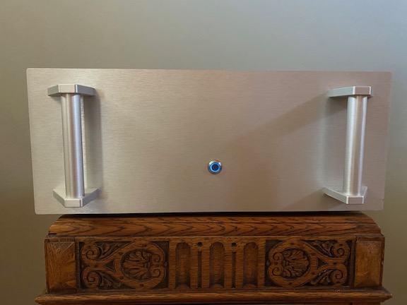

I don't have a big inrush limiter to show off but it did occur to me I never posted the finished project with my H9KPxG installed. I purchased my switch from Oznium (Bi-Color Anti-vandal LED Switch | 16mm Push Button Enclosure) because the red/blue bicolor LED I wanted for my M2X was in stock and shipped quickly. It may be cheaper somewhere else but it's a good quality switch. Like Mark, I prefer not too bright LEDs that are perfect for a dim room.
Red = Off, Blue= On
Red = Off, Blue= On
Woo, that is drop dead gorgeous! Congratulations to Audiobear!
Although I think it might give the EU regulators a little less fibrillation of the rectum, if you were to refer to those two power states as "Standby" and "On" in your published literature which they may read one day. How can it be "Off", when an LED is illuminated?, after all. If they desire Really And Truly "Off", they must flip the back panel mounted, IEC mains-inlet integrated, EU hiney-meat fibrillation preventing, DPDT switch. Now it is truly Off.
Good point. It raises a philosophical issue about just when off is off. I will do Standby and On. No problem. I don't know EU regulations but it may be that less than 0.5mW is "off." Certainly is from a low energy perspective. By the way, the AC mains is plugged into a smart switch that responds to Alexa but obviously when I use that 3rd switch I don't see the red LED.
