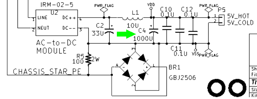

Ordering parts for the H9KPHG Soft Start. Looking at the BOM from post #1.
On the BOM "647-UHE1C102MPD1TD" the voltage reads "25" volts. When I pull this part number up on the Mouser Site, the specifications state "16 Volts. This is line item #16 on the BOM
Is this the correct part or do I need a 25 volt cap?

I think you might be talking about electrolytic capacitor "C4" (?)
Here it is on the schematic. C4 is being used as a filter capacitor, to smooth the output of the AC-to-DC module called "U2" on the schematic. The maximum voltage C4 will ever see, can be deduced by studying this little piece of the schematic. To select a capacitor voltage rating, add some more volts, enough more volts to provide a margin-of-safety which makes you quite comfortable, and that's the voltage rating to buy.

It's almost as though you are saying, "don't ask me to think, just tell me the answer". Which is not, in my opinion, the path towards flourishing growth as a hobbyist. You really will need to gradually learn to read schematics, you really will need to learn to navigate parts-seller's websites and choose components, you really will need to begin to reason about the circuits you build. If you find that totally unacceptable, if all you want is paint by numbers with absolute-beginner level handholding, this might not be the right project for you -- at least, not yet. It might take you two or three or even more, absolute beginner-level project successes, to get to the point where this one feels less opaque and mystifying.
Rather than just tell you the answer, I genuinely did hope that after 30 seconds of study, the little schematic fragment would scream out to you
Now that I've just told you the answer, you can pick a voltage rating for C4 which is sufficiently greater than 5 volts to make you feel comfortable. Both 16V and 25V would make ME feel comfortable, but you are not me. You make the decision. It takes bravery to step outside your comfort zone, but that's how we learn and grow.
- Hey!! C4 is connected between two circuit nodes, named "5V_HOT" and "5V_COLD"
- Hey!! C4 never sees more than five volts
- Looky here! C4 smooths the output of an AC-to-DC converter module, that produces 5 volts

To understand that the "IRM-02-5" has a 5v output that continues through multiple components, with a low enough voltage to use a 16v or 25v capacitor does not jump out at me.
I am not suggesting you just tell me the answer, but maybe a couple of well placed questions. Like what is the output voltage of the IRM-02-05? What is the Voltage at "P5"? Ahhh-Haaa! So 16v would be fine. It makes some sense to me now.
