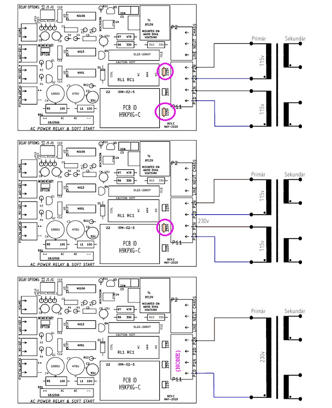

I received a Private Message from a diyAudio member, who asked how to connect a 230V transformer with a single secondary.
Since I think the Forum is by far the best way to share technical expertise across the whole community, I will put my reply here where everyone can see it, and possibly reply with their own thoughts.
The member drew a very beautiful figure which illustrates his/her opinion about the right way to connect three different transformers to H9KPXG. I agree with all of them! I congratulate you on a beautiful piece of engineering communication. I think I would also mention, very briefly, that it is also perfectly fine / perfectly harmless to add a jumper in location "P10" for the 230V / single_secondary case. The bottom drawing in the stack of three drawings.
Well done!
Mark

So what would be the correct or better way to connect TWO 230V transformers with single primary to one board.
1. Jumper 230V both transformers connected to P1D and P2N.
2. Jumpers across 115V and connect one transformer to P1D - P1N and other P2D - P2N.
sorry for repeating myself...
I would choose whichever option is the least confusing to someone else.
  • Your kid, that you give the amp to, when she leaves for college
  • A repair person
  • The next owner after you. Maybe you'll sell the amp, maybe your widow will sell it upon your death, etc.
I suppose it might be even better to say "the most intuitive" rather than "the least confusing"

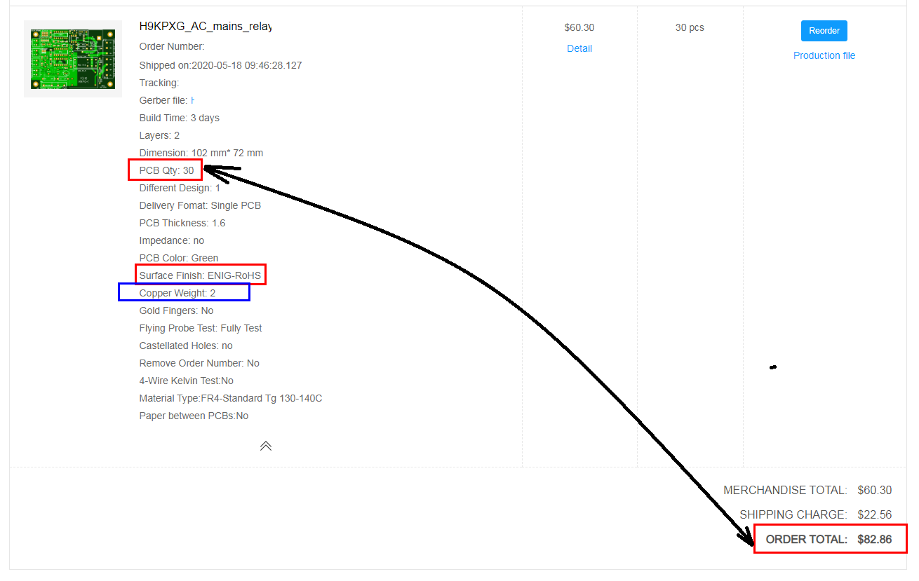

Q re pcb fabrication
I have heard that OSH Park is a pcb maker that many hobbyists use. I like that it is located in the U.S., although it is a bit more expensive than the Chinese fabricators. I obtained a quote of $57.25 for 3 pieces, which does not seem too bad. However, if I want 2 oz. copper (which I do) they fabricate a thinner board (.8mm thick instead of 1.6mm). Does that disqualify them or is it okay to have the thinner board?
Thanks for any insight anyone can give.
Jazzzman
