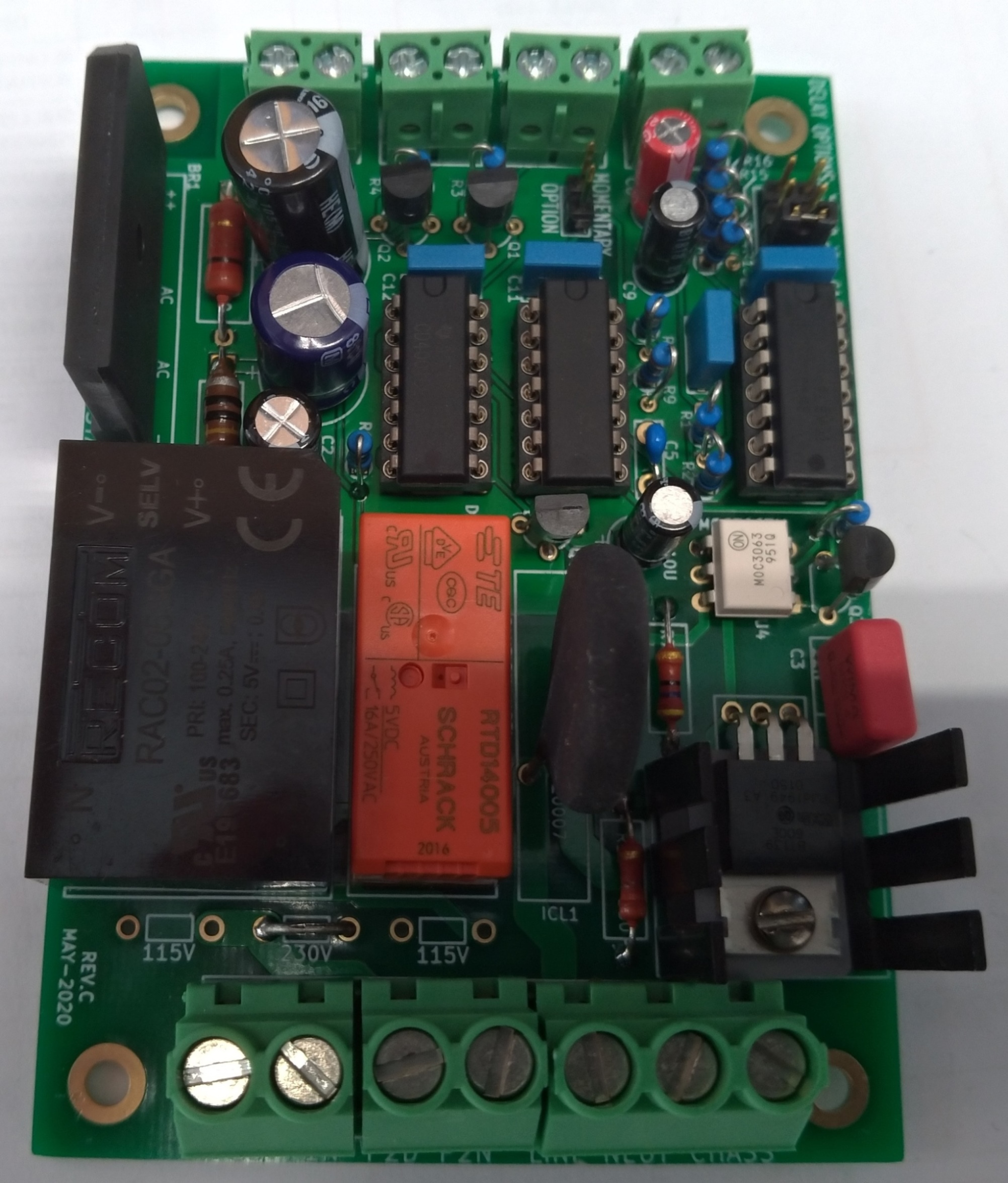

Hi Mark, I see that the L an N input and transformer connection block then (ideally) should be swapped. Aesthetical as it prevents crossing wiring and wire routing is nicer when the PCB is used with an IEC inlet at the right side of the back cover. The SMPS is then also most far away from sensitive circuits just like the transformer and all mains related wiring.

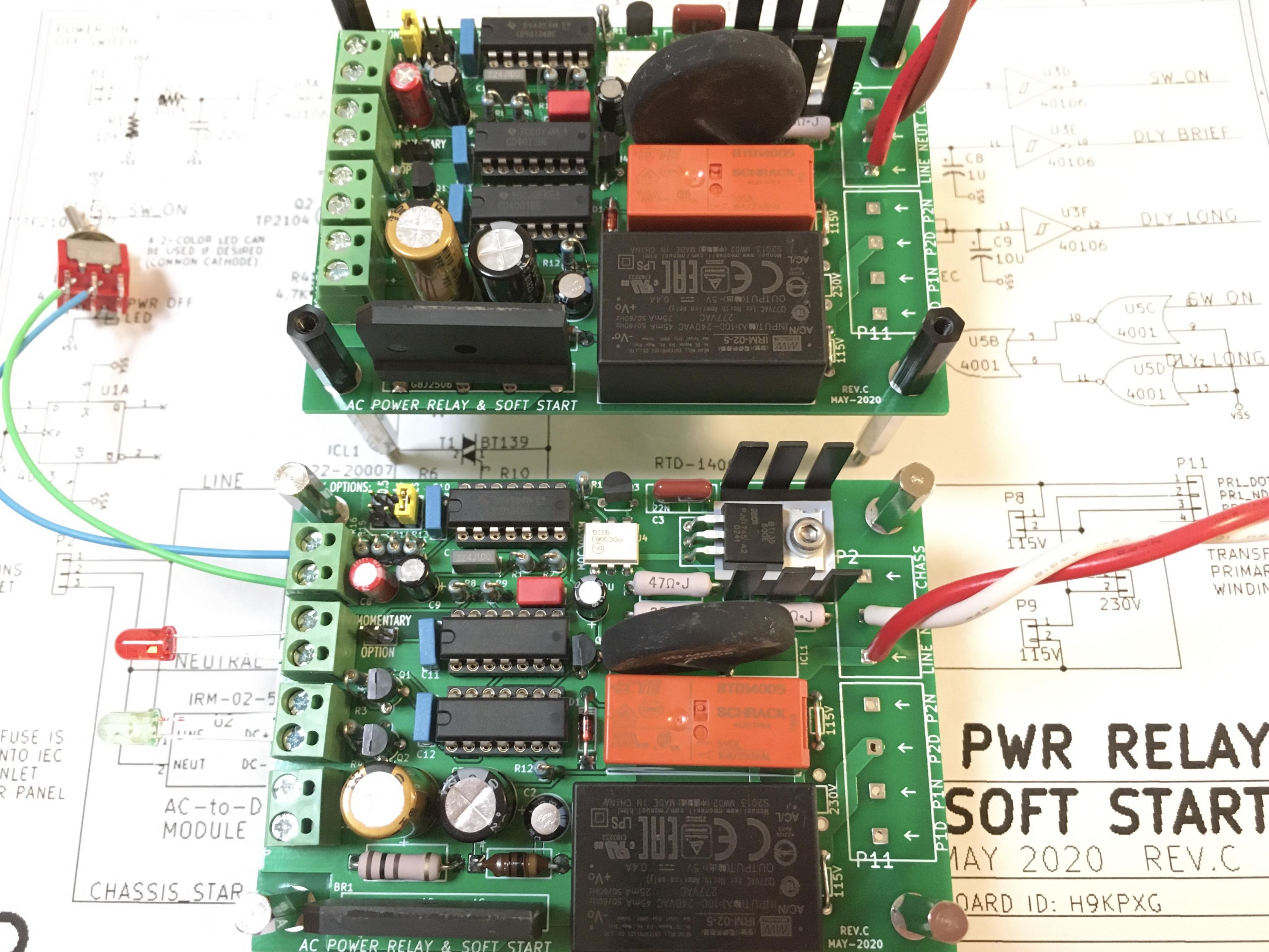

I ordered PCBs based on your design data (first experience for me) and completed two today.
I will use these for mono block singing bush power amps.
Let me ask you one question.
The board seems to work fine when I load (light bulb as a test) the P1D/N terminals.
When the mini switch is Off, there is no AC voltage on P1D/N. When the switch is turned on, AC100v will come to P1D/N.
However, when P1D/N is open (no load), AC 100v is measured by the DMM regardless of whether the switch is On or Off.
The two I made have the same behavior.
Is this normal?
Thank you again.

Congratulations on your success, yoshida! Your assembly and soldering appears to be first class. I hope you are quite pleased with the finished equipment.
It's true that modern, very high impedance voltmeters read non-zero voltages on the "transformer primary" output terminals, even when the triac is off. Other builders have noticed this, see posts #65 and #66 in this thread for example.
You can prove to yourself that the voltmeter reading is nothing to worry about, by temporarily connecting a 100K resistor across the voltmeter probes when performing the measurement. Presto, the voltmeter reading immediately falls to zero. Another experiment you can try, is to connect a very low wattage, mains-powered incandescent light bulb where the transformer primary would go. A bathroom night-light (3W in USA) would be perfect. Presto, the bulb does not light.

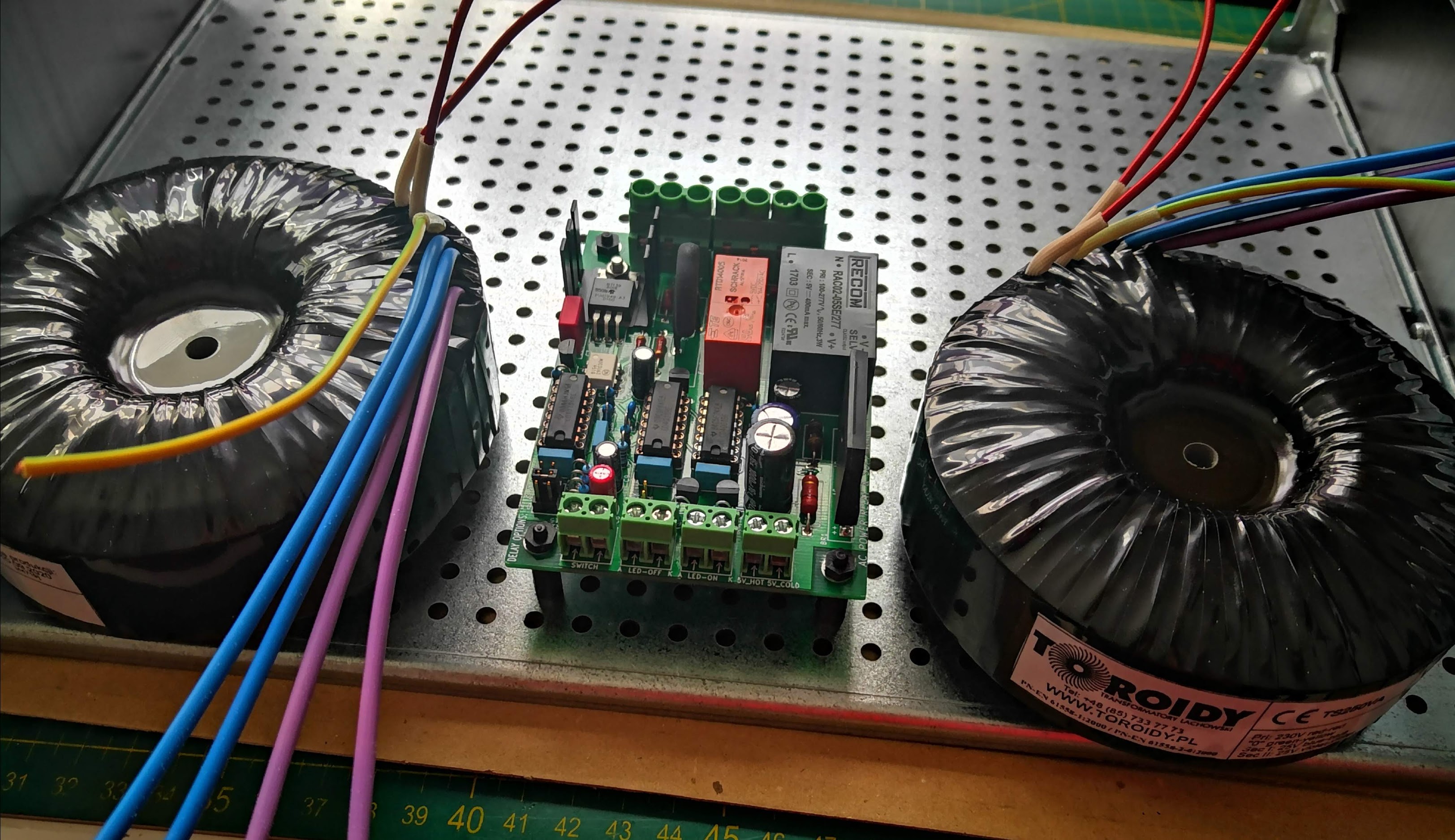

Hello everyone
I wanted to thank Mark Johnson for his generosity in sharing this project and saying that I was one more who decided to follow Mark Johnson's recommendation, and ordering PCB's (for the first time) to do this project.
Below is a pair of photos from my finished and verified soft start.
The pcb was ordered according to all indications provided by Mark Johnson, and it is working as expected, except for one point, and this is what puzzles me. If I don't connect anything to P1D; P1N and P2D; P2N, I can measure 230v at the output terminals. If I connect the 30VA toroidal that is intended for a Nelson Pass BA-3 preamp, I have no reading on that terminal but I have it in P2D; P2N. Changing the connections (P1 to P2), the same happens, I get reading in P1 and zero in P2 ...
If you bypass the toroidal connection to the soft start, I will have + - 24V on the power regulation pcb again.
I would appreciate some guidance, I am doing something wrong, I have something badly connected, whatever ...
Thanks in advance.
Best regards
Carlos
Thanks in advance.
Best regards
Carlos
Sketch is connection for one transformer with two primaries. You have one primary.. If you have connected both transformers, remove them and measure again to confirm you only have 230V between P1D and P2N. If you are measuring both transformers connected then they are in series, but I can't help you if this is right way to connect two transformers to one board because I am very new to this DIY audio stuf and have no clue how would connecting two transformers in series affect your amplifier.
