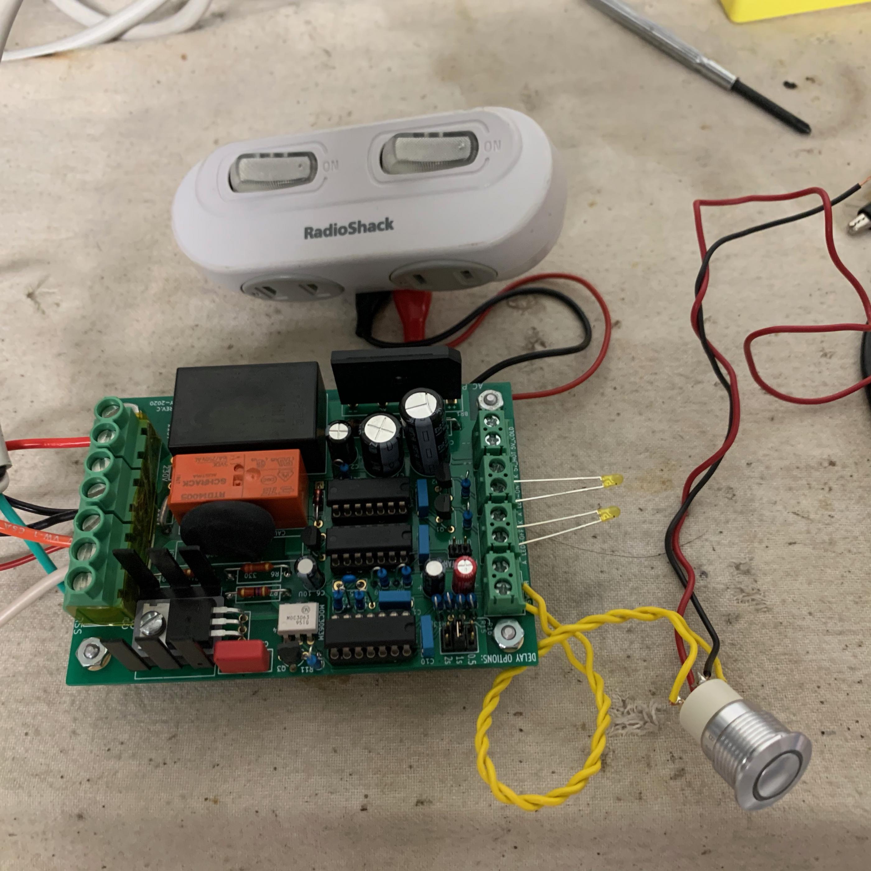

I tested my PS today. First time the power is ON by flipping the switch, there was a delay with seems to be relay clicking, then I heard the relay click again and measured 120 Vac at P1D and P1N. Measured voltage at LED On-Off at 5.1 Vdc.
When I flip the switch back to OFF position, the voltage across P1D and P1N stays at 85 Vac. LED voltage 0.0 Vdc.
Any hint on how to troubleshoot? Thank you!

Don't the philippines use 220V? If that is the case and you put jumper across 230V you should measure between P1D and P2N and get 220V reading.
If you live in US then the reading between P1D and P1N is correct. But there should be almost no current when off, maybee 1V if nothing connected.

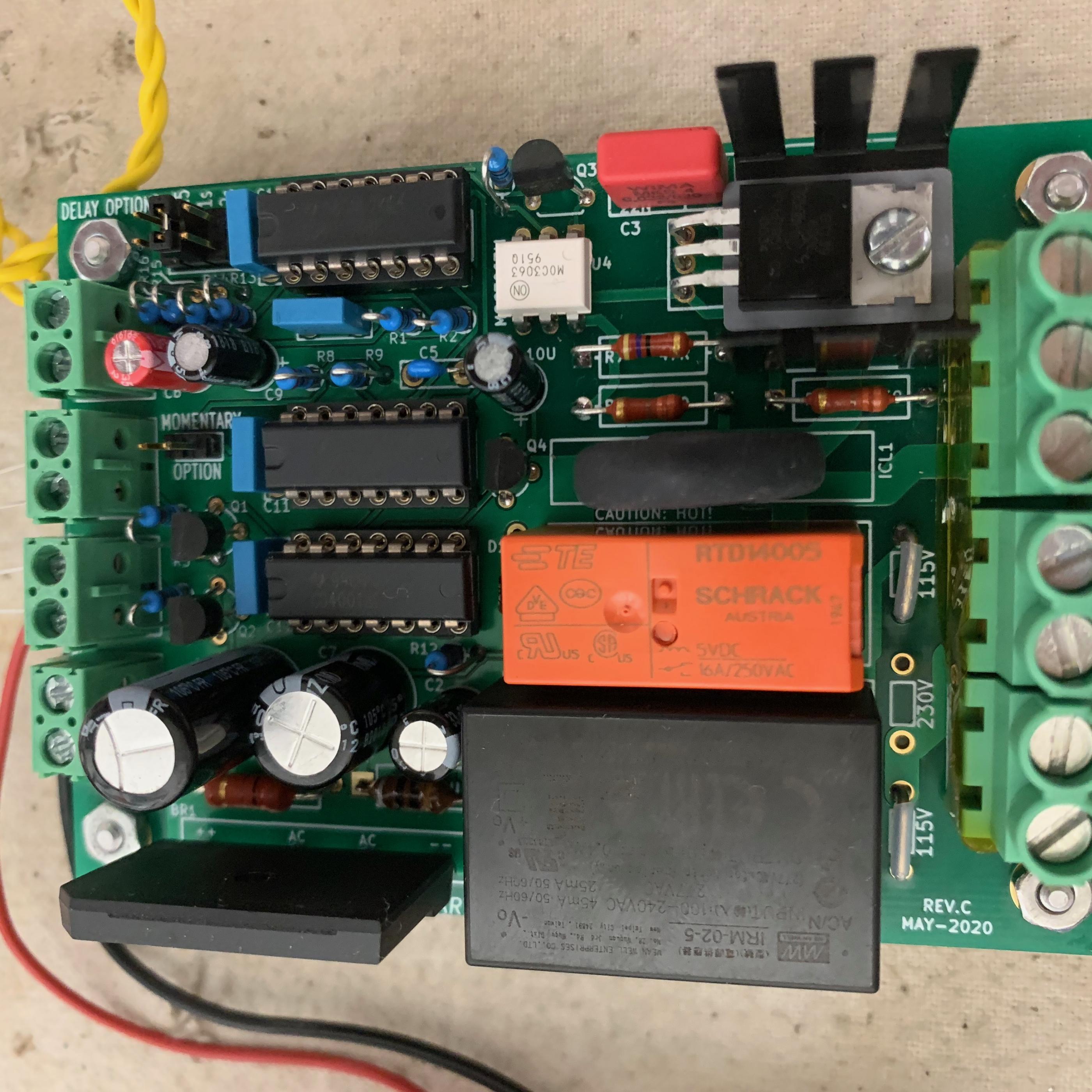

Additional Pics.
First Pic- power connected to L,N, and Chassis, switch open, LED Off is illuminated, lamp (RadioShack) connected to P1D and P1N illuminated (85 Vac Measured across P1D and P1N, P2D and P2N).
Second Pic - switch close, LED On illuminated, lamp still lit but brighter (120Vac measured across P1D and P1N)
I saw Marks post (#126) and says
"Another experiment you can try, is to connect a very low wattage, mains-powered incandescent light bulb where the transformer primary would go. A bathroom night-light (3W in USA) would be perfect. Presto, the bulb does not light".
In my case, the lamp is always ON but just varies in intensity.
Hah! I finally figured it out!
When configured for 115Vac double primary, if you leave one set (say P2D and P2N) open, it acts what I had experienced. Need both sets, I use 100K resistor, with a load. After that, works fine.
Mark I believe already mentioned similar this but took me a while to find the documentation on the thread.

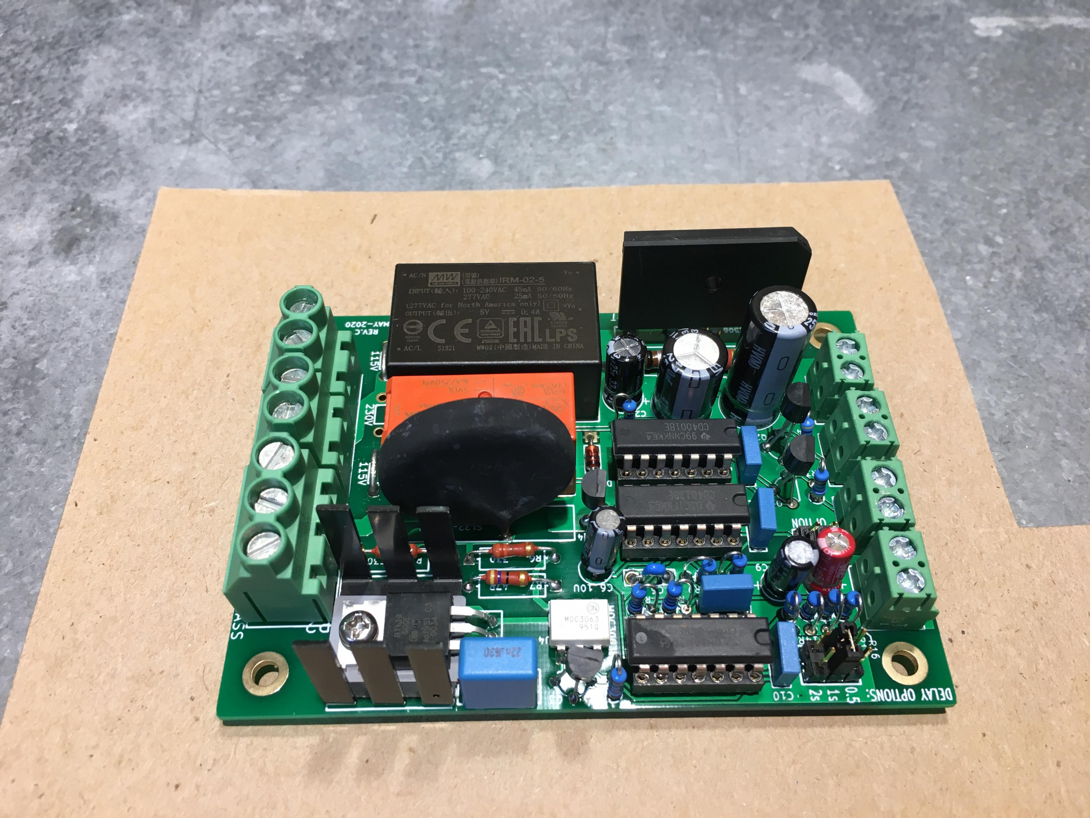

My PCB's arrived from China, and I found the Meanwell relay's,only took a week to get them. The first one is for the Singing Bush SIT amp which I have a 48v 1000va torroid. The soft start has the 250 Joules thermistor for the mongo transformer.

WHOA! That's spectacular, elwood625! Congratulations. I think you might be the first builder to drop in one of the 250 Joule ICL discs and show a photo -- it's extremely cool.
Very nice looking assembly with neat soldering and beautiful flux clean-off.
Now there's another 250 Joule Sumo Wrestler in town. Wimps had better get out the way.
