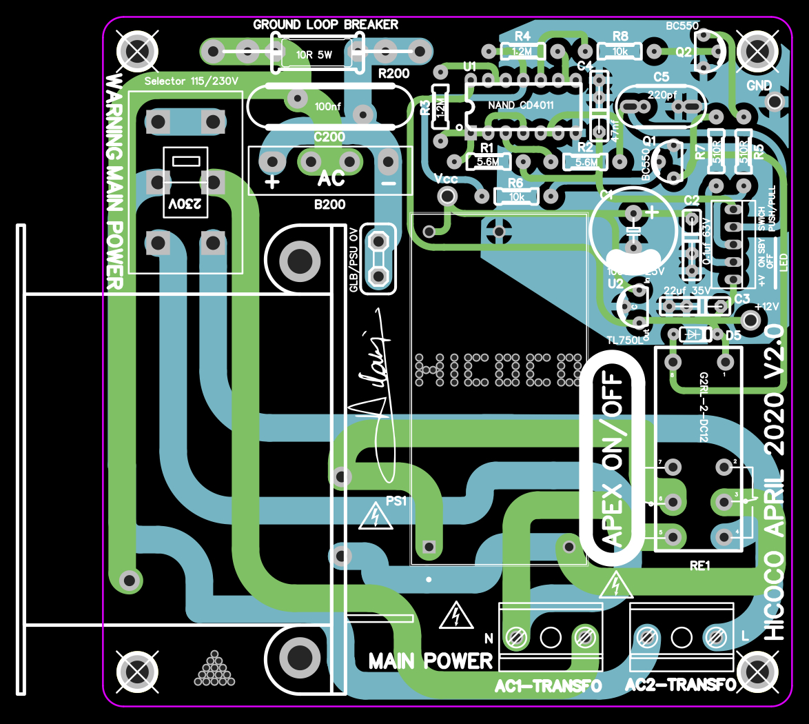

PCB: low voltage On-Off switch drives AC mains relay \ includes soft start .. H9KPXG

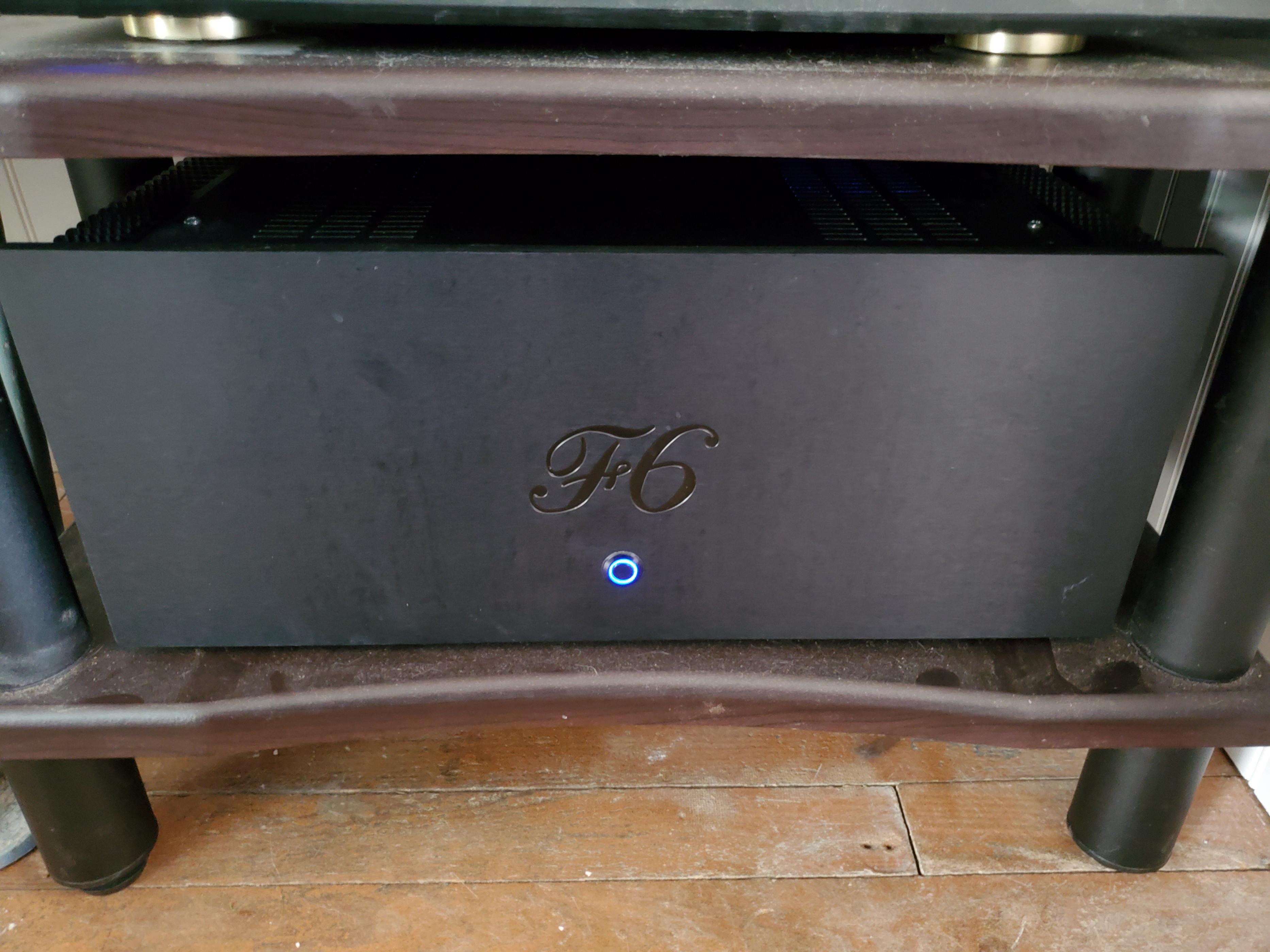

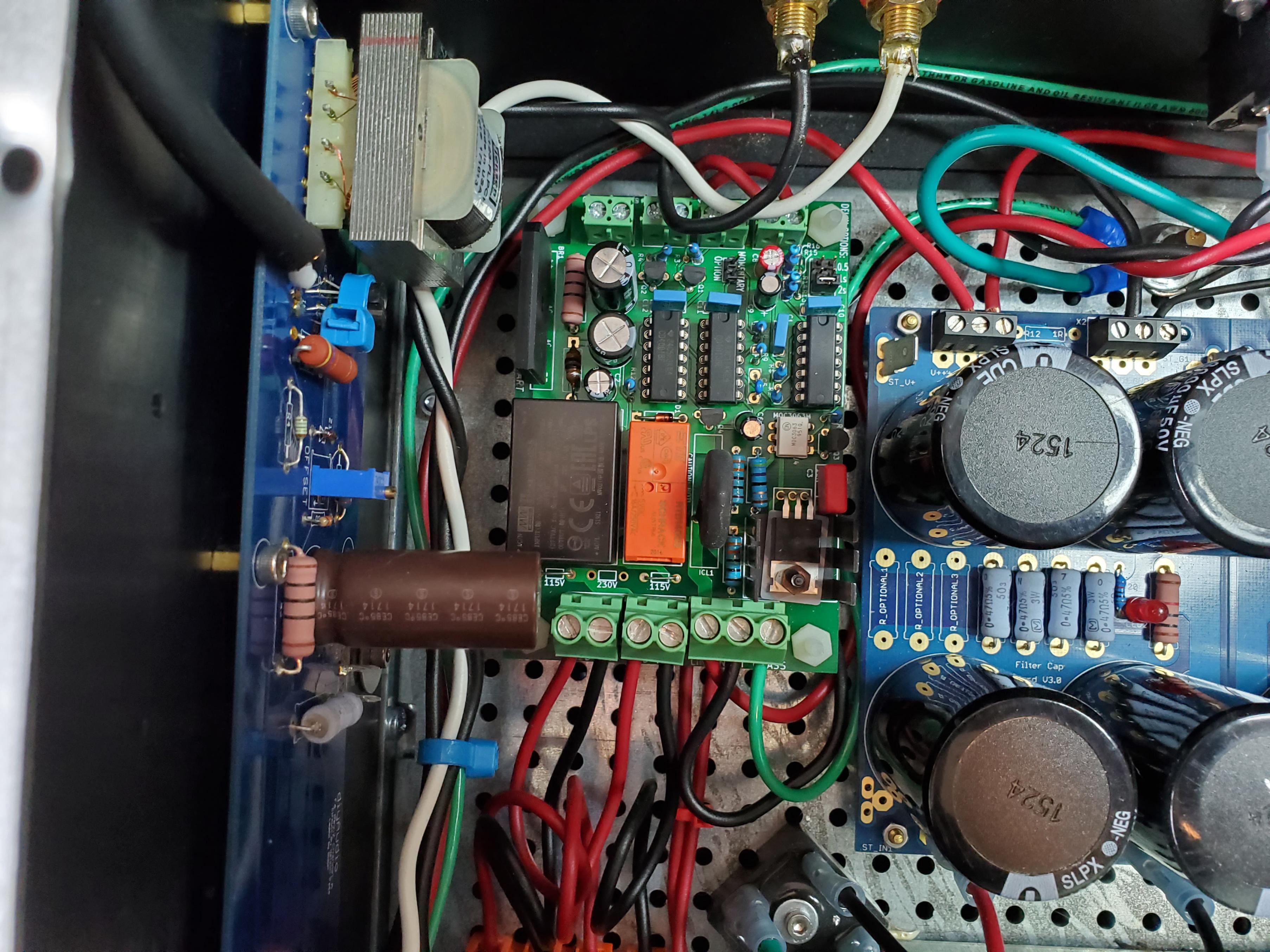

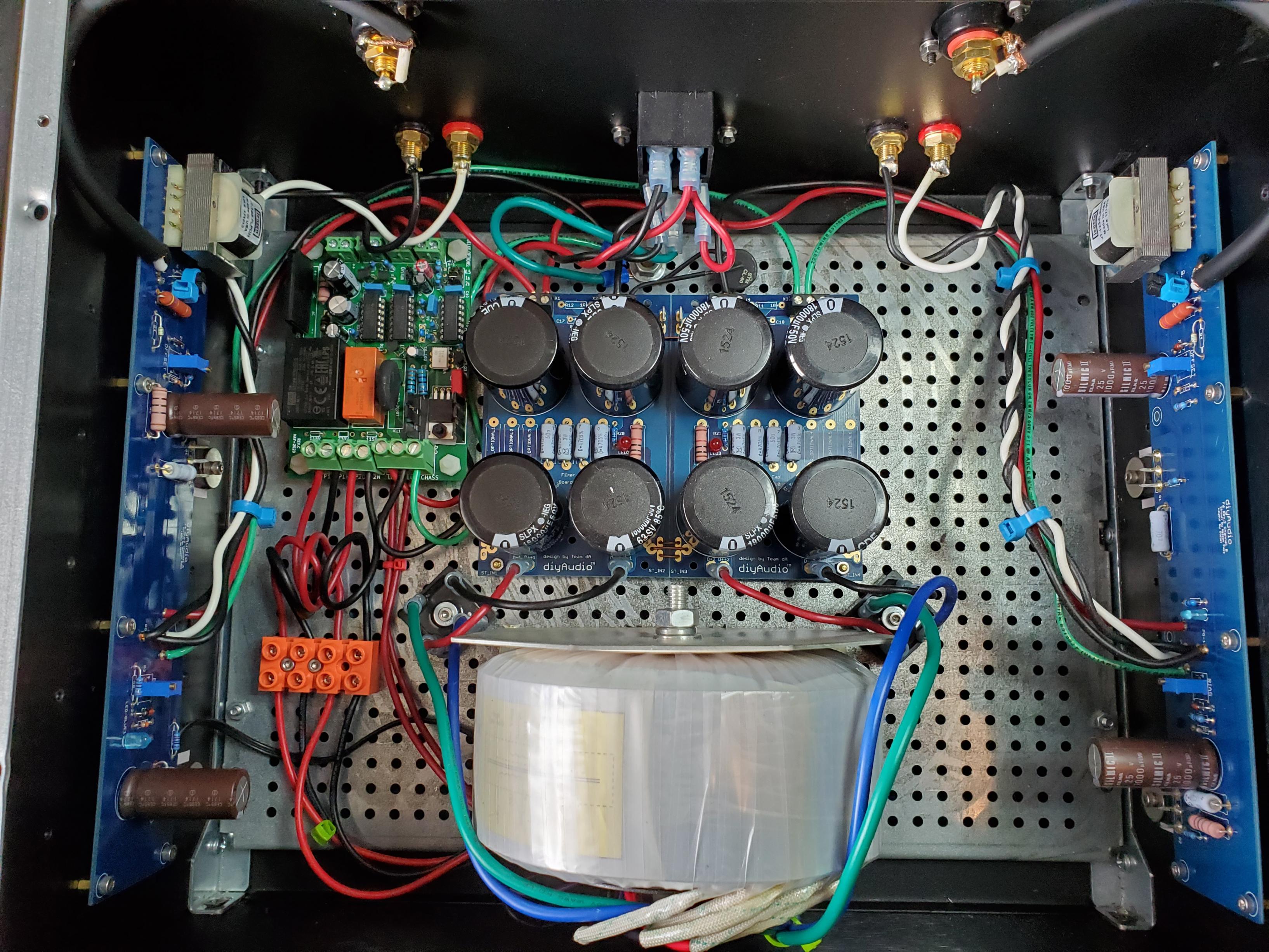

Just installed in the F6, nice to have a front panel power button.
Looks great, angrypat! congratulations. Maybe on your next build, you might decide to offset the trafo and/or the PSU PCB by one or two ranks of holes. Accepting a small amount of asymmetry, in exchange for a lot more room to mount the H9KPXG and route its wiring.
I did that on a Cordell's Super Gain Clone build, and the visible, but slight, asymmetry didn't trigger a crippling bout of Obsessive Compulsive Disorder. But you may feel differently. Click on the image to see it full size & undistorted.
846206d1590099408-bob-cordells-super-gain-clone-pcb-lm3886-stripped-version-compact3886-img_1729-jpg
edit- forgot to say: H9KPXG board is at right front, immediately behind front panel "anti vandal" pushbutton switch. Orange colored "soft start bypass" relay is clearly visible.

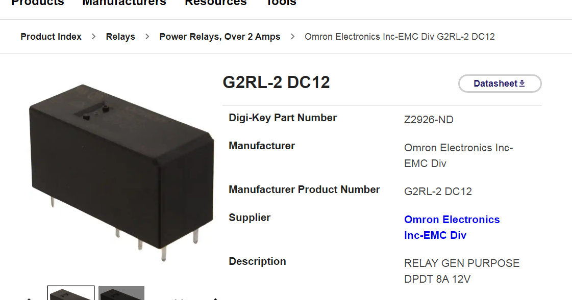

That would be a great idea! I think you might find there are far fewer choices of relays with >15 ampere contacts, when you search for double-pole relays instead of the single-pole relay used in H9KPXG.
The new relay might turn out to be housed in a physically larger package, and the necessary coil current to activate it might be a lot higher. The extra current probably won't be a problem since the AC-to-DC converter has plenty of output. But, if not, then perhaps you could change the entire circuit to operate from 12V instead of 5V. The CD4000 logic family is rated for 12V (in fact, 15V!) and the low voltage switch is almost certainly rated for it.
I don't think I will include this in the H9KPXG, but please accept my encouragement to try out the idea yourself.
