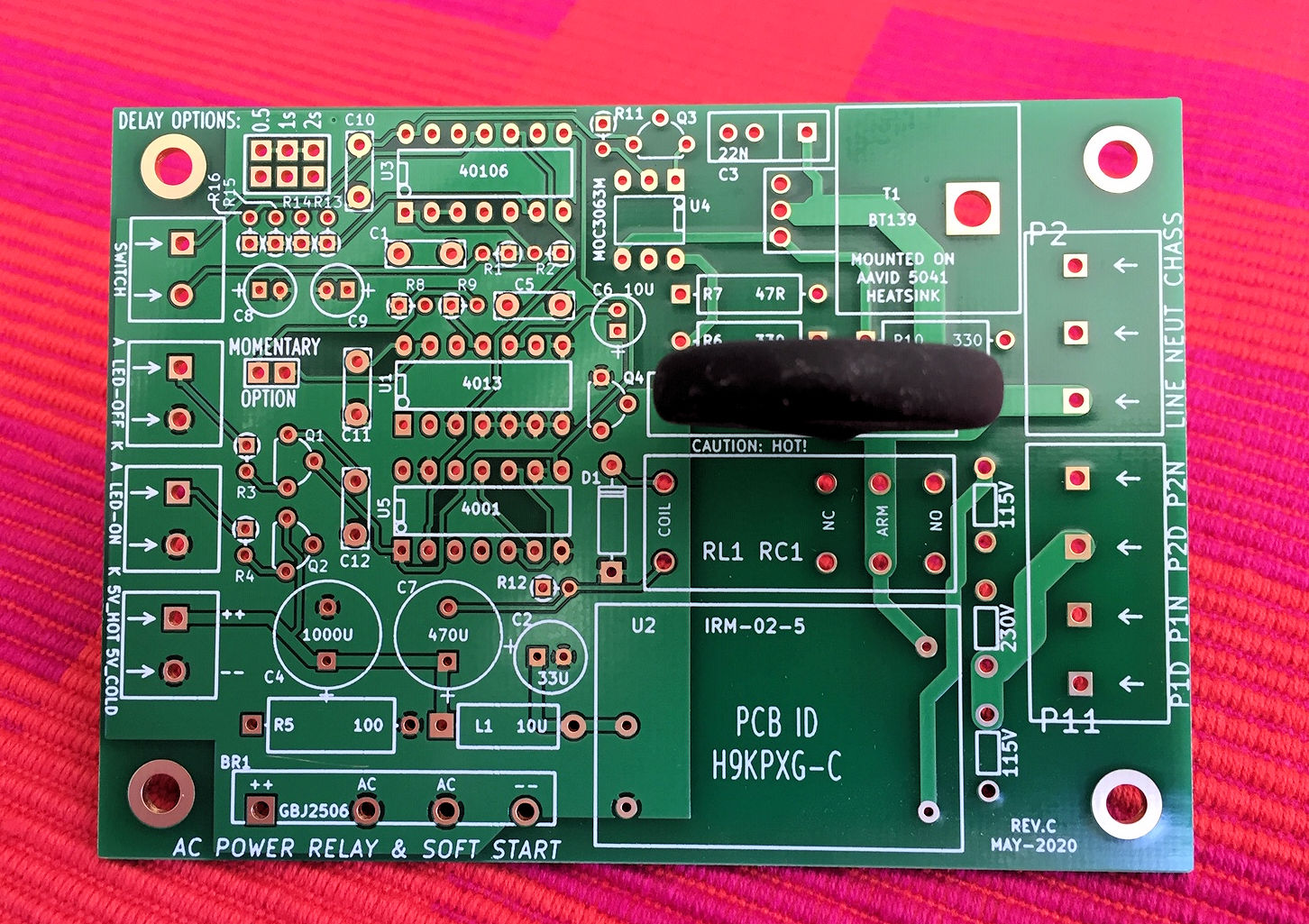

That relay doesn’t appear to be the proper type... it’s 20V with 8A contacts. The BOM asks for 5V coils and 16A contacts.
RTD14005 TE Connectivity / Schrack | Mouser

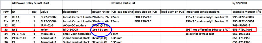

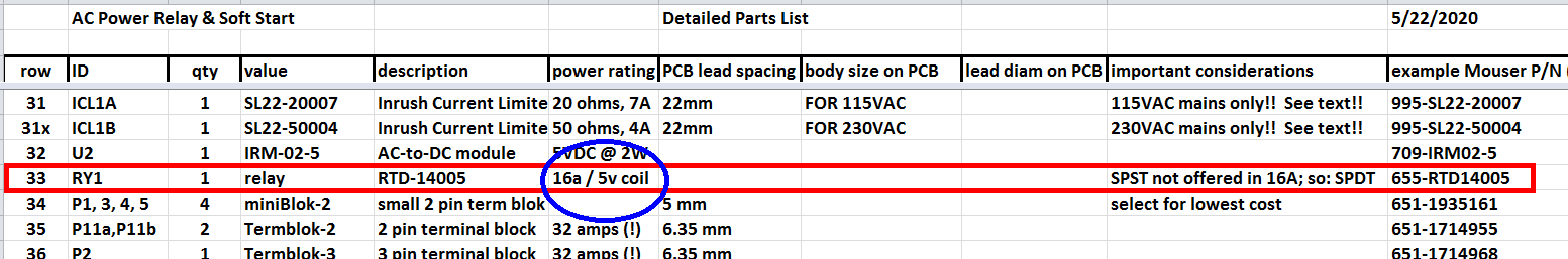

Check the circuit design and schematic and Parts List of H9KPXG once again.
I think you'll find that it contains an AC-to-DC converter whose output is +5V DC. This is applied to the coil of the relay. I think you'll find that the parts list calls for "RTD-14005" which is a relay with a 5VDC coil and 16 ampere contacts. Makes sense: with a 5V supply we need a relay whose coil operates at 5V.
Unfortunately your photographs in post #100 above, appear to show a different relay with a different part number. Your relay appears to have a 20 volt coil and only 8 ampere contacts. That's wrong, twice. I couldn't find a datasheet or a pinout; if the pinout of that substitute relay is different than the RTD-14005, then it is wrong three times -- an award winner. Suggest you unsolder that relay and install the one called for in the Parts List.

Thank you gentlemen. I went back to look at my Mouser order and it clearly says I ordered a RTD-14005 but obviously received something different. Shame on me for not double checking.
Yes. I ordered by using a link to a Mouser BOM posted earlier in this thread so I wanted also make sure nothing was off so no one else has this issue. Nope, traced it all the way through from the BOM to web order and invoice. Right part number ordered but wrong part showed up.They sent the wrong part? That’s a bummer. I’m sure they will sort it out.

I have an extra RTD-14005 relay, PM me your address and I'll ship it to you right away.
This is the award I needed, thanks Mark! 🙂

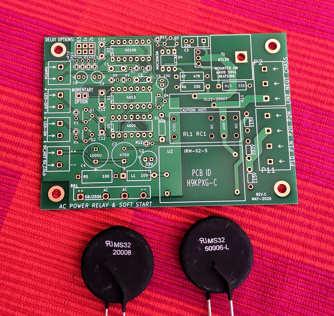

Eureka! You can install a 250 Joule(!) ICL into this ACPR+SS board
I just received a couple of 250 Joule rated Inrush Current Limiters from Mouser.com, and I'm delighted to say they can be used with the existing (Rev.C) AC Power Relay & Soft Start PCB. You might remember from post #1 above, that the standard ICLs called for in the Detailed Parts List, are rated for 125 Joules. So these new ones are twice as rugged, twice as beefy, and twice as macho. For those who may be interested, example calculations of Joule requirements are also included in post #1.
These great big ICLs are made by Ametherm. If you think you really want or really need a 250 Joule ICL, the one I recommend for 115VAC mains is Mouser part number 995-MS32-20008 [32 mm diameter / 20 ohms cold / 8A max steady state current], and the one I recommend for 230VAC mains is Mouser part number 995-MS32-50006-L [32 mm diameter / 50 ohms cold / 6 amps max steady state current]. Their .pdf datasheets are attached below.
The footprint on the ACPR+SS PCB Rev.C is deep enough and wide enough to accommodate these 32mm ICLs without touching neighboring components. The drill holes are juuuuust big enough that the "115VAC mains" ICL slides in easily. However the "230VAC mains" ICL has slightly larger diameter leads, so you'll need to reduce them a teeny bit. Sandpaper, needle file, scraping with diagonal cutters, anything you try will probably work. Don't worry, an ICL is not Static Sensitive and it survives an Electro Static Discharge with zero damage. So sand / file / scrape to your heart's content.
Maybe, some day, I might revise the PCB layout and include slightly bigger drill holes, to make the PCB comfortably accept the "230VAC mains" version of the 250 Joule ICL. If there is another compelling reason to make a PCB revision, I'll roll in this change too. Meanwhile, get out your sandpaper and spend a relaxing ten minutes of your time, in exchange for bragging rights about Two Hundred Fifty Joules!! And shake your fist at the lucky DIYers in USA, Japan, Canada, and other places. These fortunate souls can use the 115VAC part number of 250 Joules ICL, which needs no sanding or shaving or scraping.

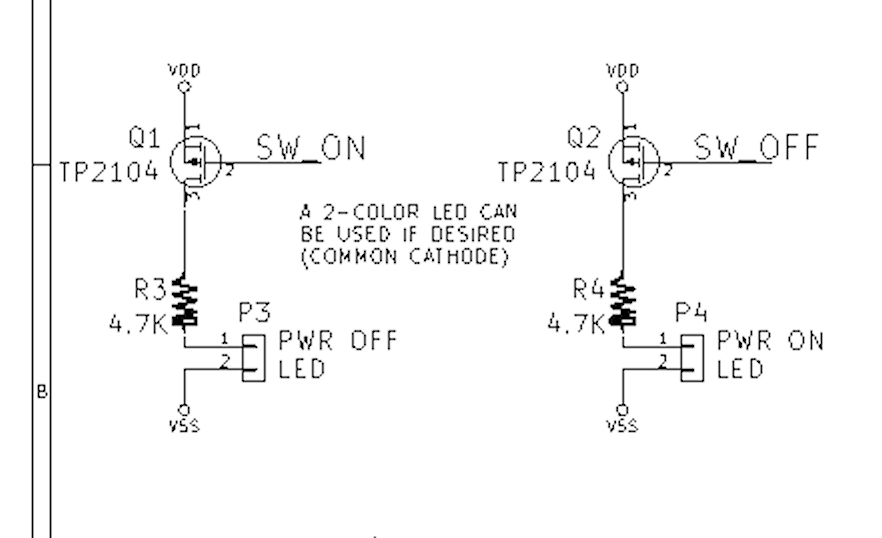

May I kindly request to include PCB pads for a single bicolor LED in a possible next revision ? With a common cathode LED pads for a 3 pin connector would be enough. It is unusual to have to drill 2 holes for 2 LEDs of which one lights in the Off state (which could be called Standby).
You can use a bicolor LED with the current (Rev.C) version of the PCB. Simply connect Anode-Red to P3 pin 1, connect Anode-Green to P4 pin 1, and connect Cathode-Common to P3 pin 2. Schematic fragment, snipped from post #1, below.
Then you have a 3-wire cable which runs from the LED to the PCB. Two of the three wires attach to connector P3, and one of the wires attaches to connector P4.

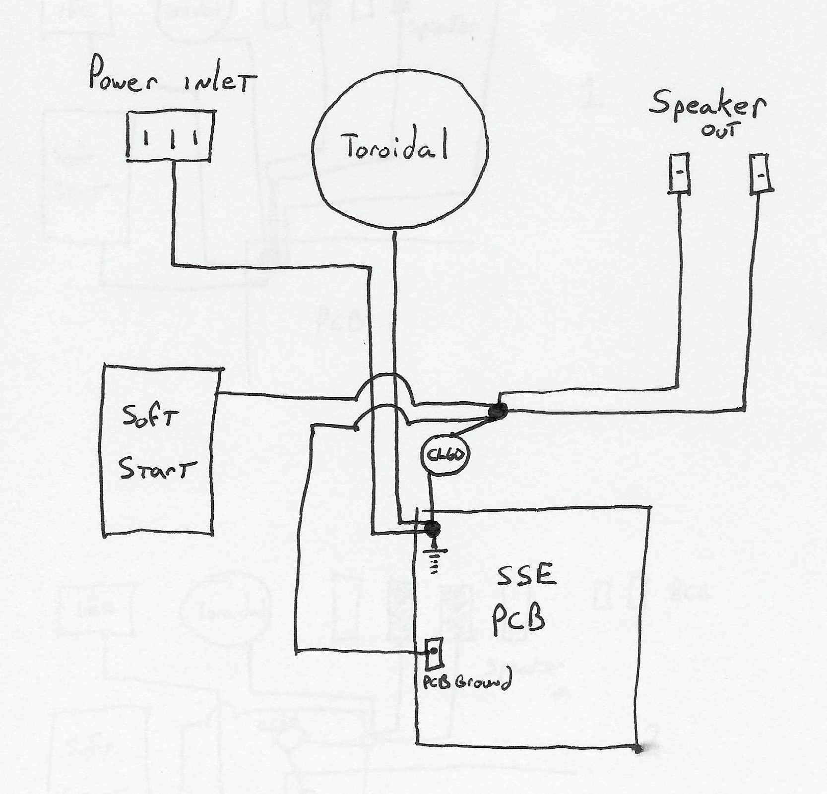

Mark, I tried to follow your advice on integrating a CL-60 into the grounding circuit of my Tubelab SSE. Please see attached drawing. The speaker out, pcb, soft start are grounded to a point that is connected to chassis ground through a CL-60. The power inlet and toroidal ground are connected directly to chassis ground. Did I get this right?
... it's a low resistance CL-60, sometimes it's a combination of them.
Gently, I suggest you study the photograph attached to post #16 of this thread. It's a stereo amplifier which uses this mains relay & soft start PCB (yellow arrowhead). But what ELSE do you see? Look hard.
Hint: look at the intersection of row_4 and column_4 of baseplate holes.
Another hint: some mounting bolts are silver colored because they are metal & conductive. Other mounting bolts are white colored because they are nylon & insulating. The photo includes some of each.
