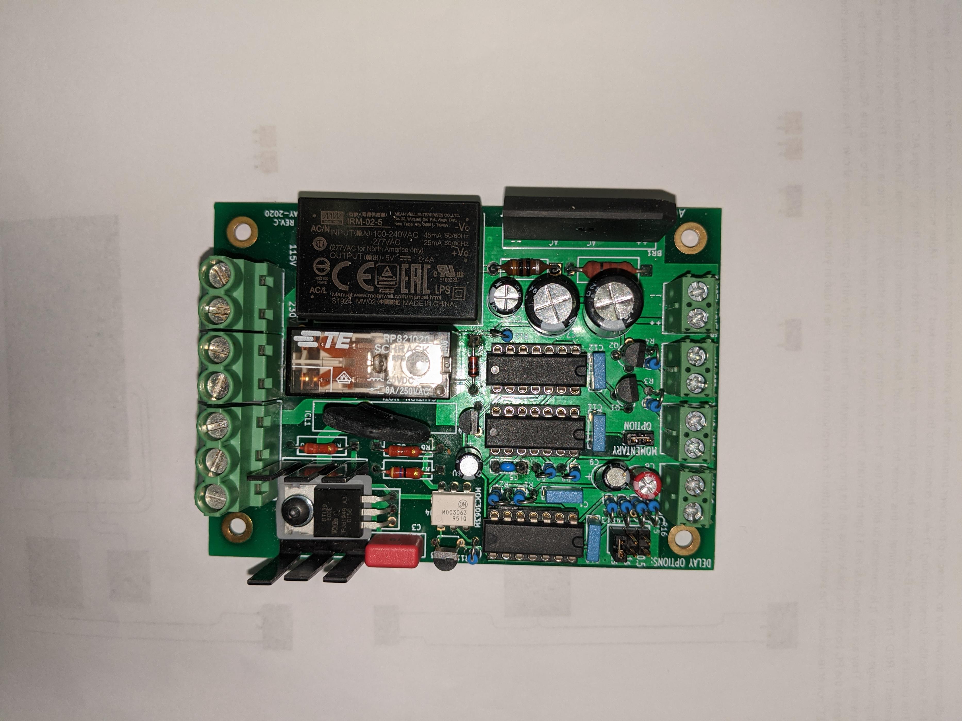

I added the soft start board in circuit with my Tubelab SSE and it powered up just as it should but I noticed that B+ is 10V lower than before. Without the board when I turned the power on B+ would spike to 500V then drop down to 430V. With the soft start board at power on the volts spike to 480V, then drop down to around 400V, then very slowly climb to about 420V. Does this make any sense or have I got something wrong?
Spiggs it sounds like your bypass relay might not be engaging. As though there is an assembly error or a bad component somewhere in the relay coil circuitry. Did you remember to install a shorting-block to select a bypass option (0.5, 1.0, 2.0 sec) ?? Do you hear the relay make a click sound?
One of the simple tests for H9KPXG that I found useful, was to disconnect the transformer primary(s) and instead, connect a >= 100 watt incandescent light bulb as the load. At turn-on, the bulb comes on bright, goes half dim, and gradually grows brighter. Then, at t=2.0 seconds, the bypass relay engages and (a) you hear an audible click; (b) the bulb goes to full brightness. This might be a quick and easy diagnostic test to check whether your bypass is working correctly.

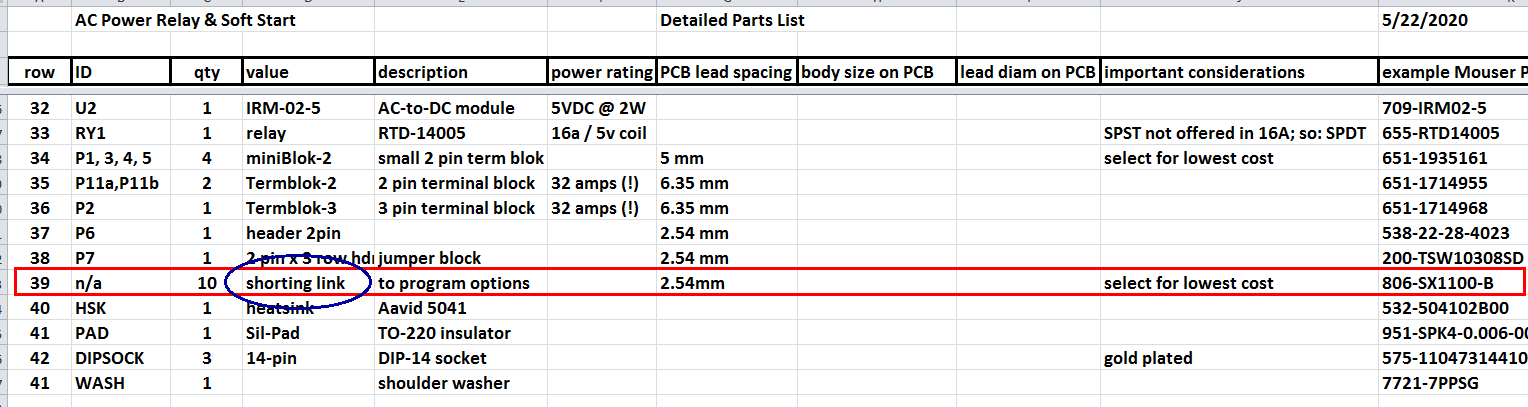

Shorting block is installed at t=2 and I tried the 100w bulb test. Plug it in then hit the switch and bulb comes on, 2 seconds later I hear a click. Don't notice the bulb getting dimmer, or brighter. i also measured volts in at ~119, volts out ~113 after the click with bulb lit. Attached are pics of my board.
