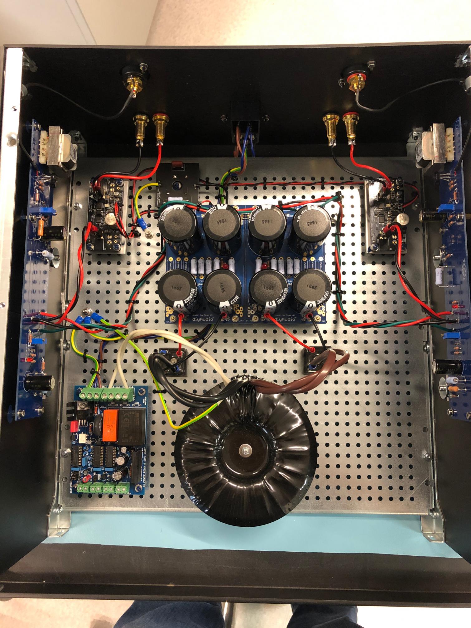

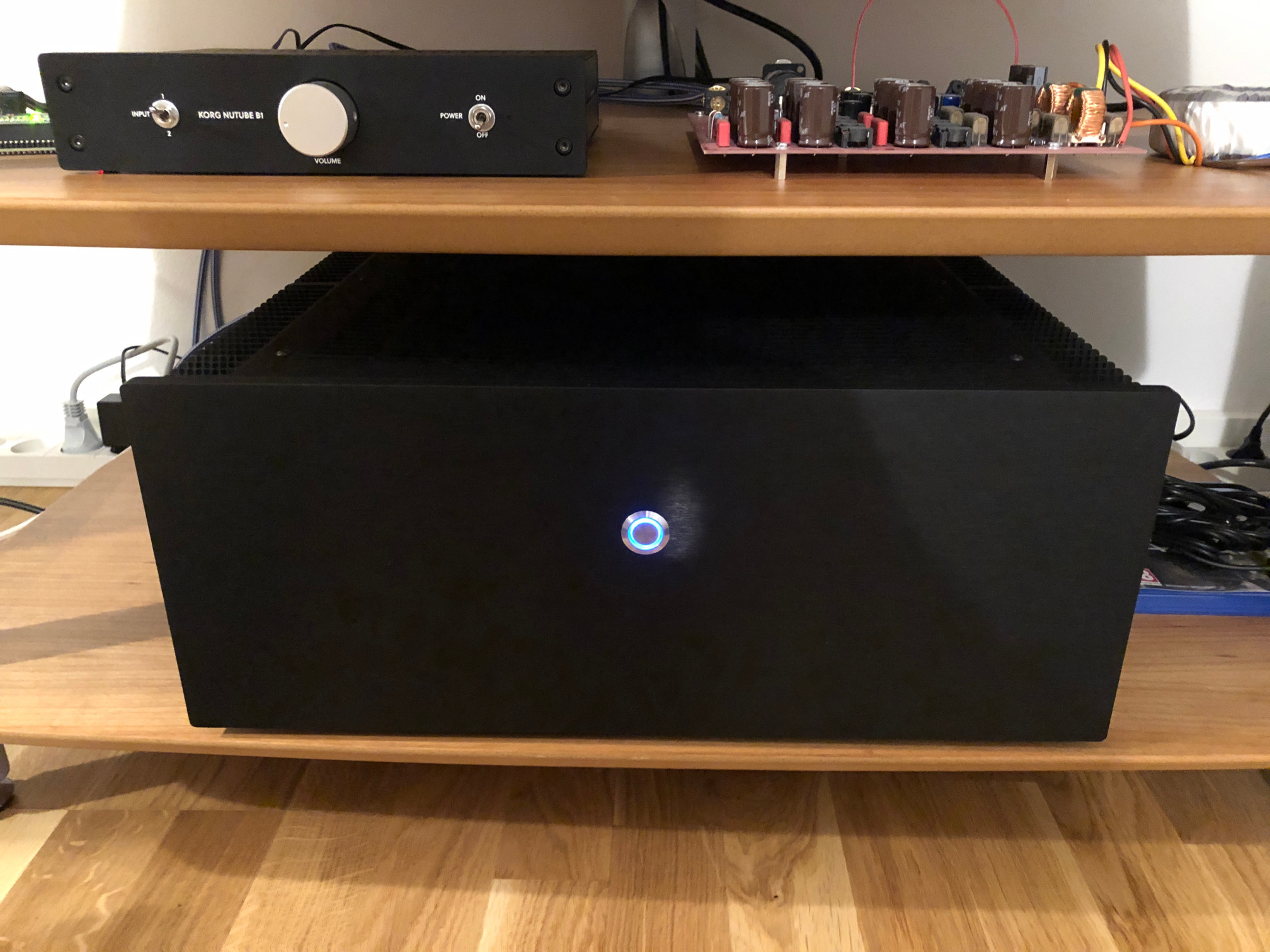

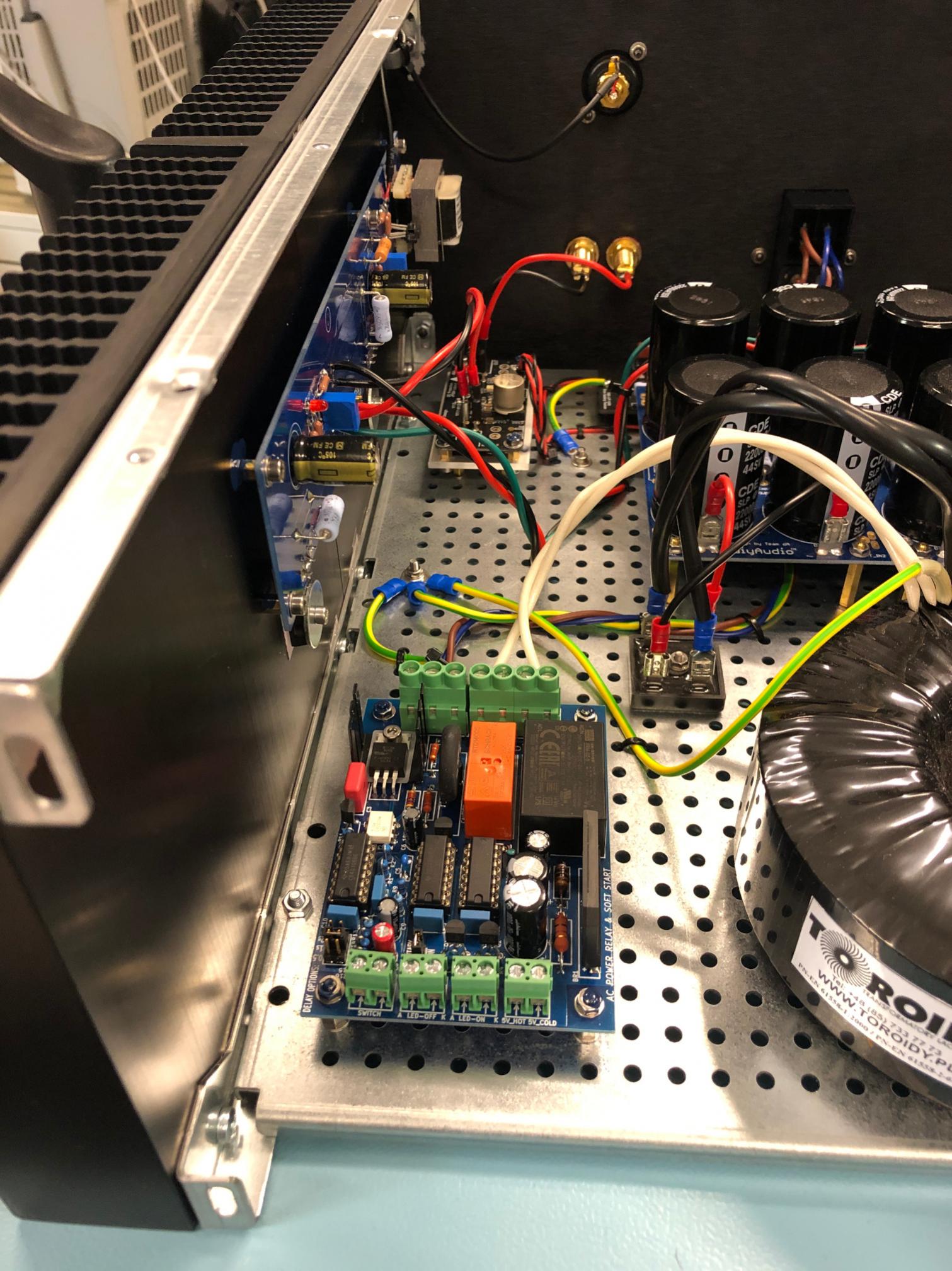

Installed in an F6 - works perfectly 😀😀

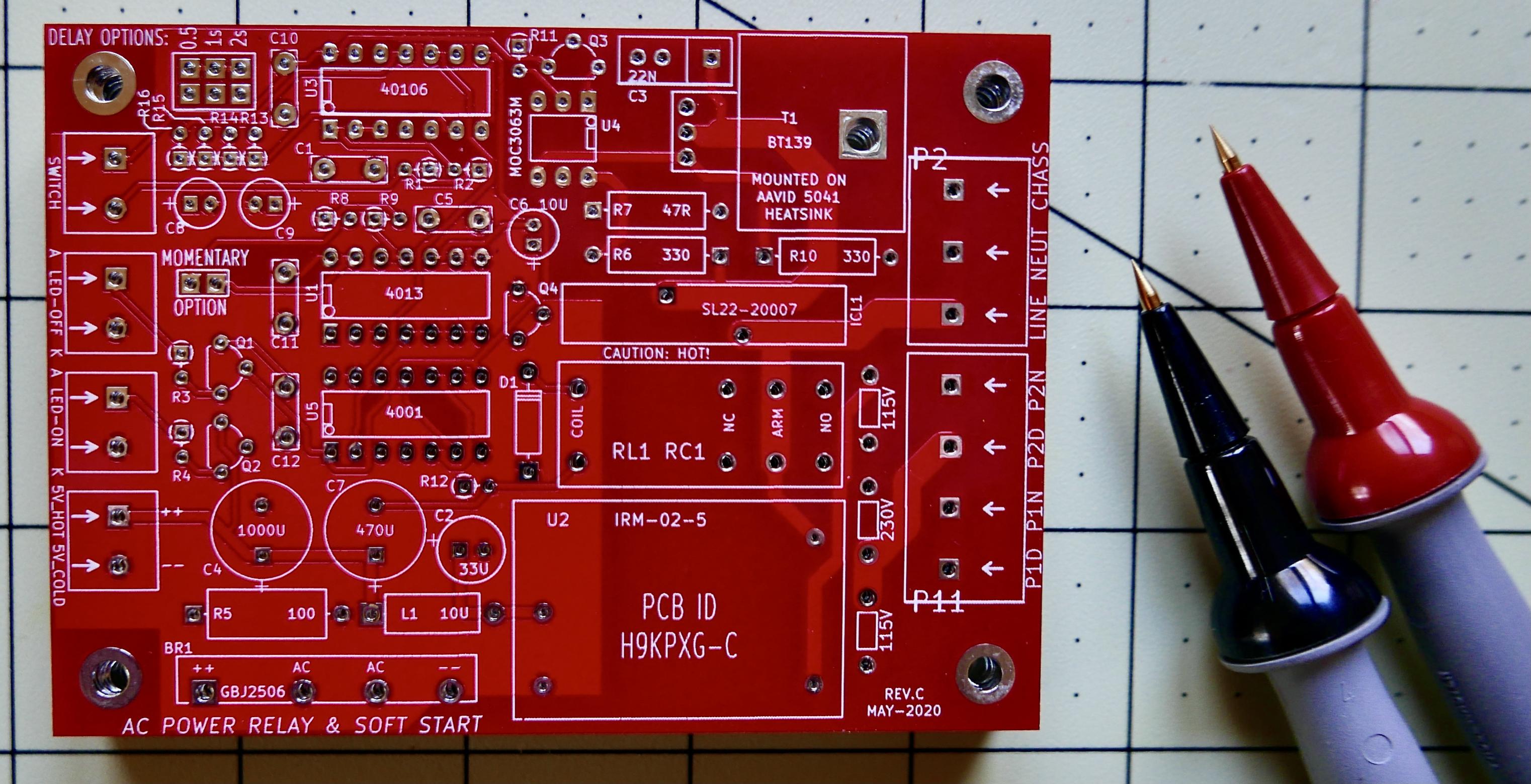

[special=]%[/special]Hi all!
First off one sincere “Thank You” to Mr. Mark Johnson for all of the time and knowledge that he selflessly invests in these projects …quite inspiring…Thanks for the great present(s) Mark.
Dec. 24th. 2020 sent Gerber’s off to China (PCB_WAY?) & Jan. 04th. 2021 DHL dropped off 15 boards. Twelve days, over the holidays and during a global pandemic no less? Do encourage others to give it a shot. You’re not careful you might learn something and please keep the ball rolling. Note: I used PayPal and DHL which added another $31.00 to the bottom line. 2.0 copper, Red, White screen, etc.
Perchance anyone is interested I’ve 9 boards (per photo) available at $9.87 (my cost) per board plus shipping to where ever you might live. Lower 48 stateside only…Sorry! Drop me a Personal Message if interested details/questions/what-all.

Sorry all…9 boards I had to spare/share are spoken for. Given the response it’s apparent that this board needs to be added, given Mr. Johnston's approval, to the diyAudio Store bare board selection! I’ll be in touch with the first seven who responded this weekend.
