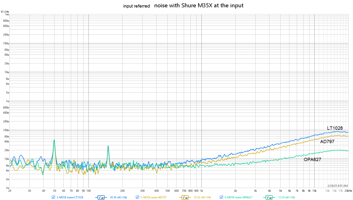

Noise-wise, the LT1115, LT1028 and LT1128 are the very worst op-amps for MM, by the way.
Yes. Below the measurement of noise with Shure M35X cartridge. It is measured with linear gain +30dB and noise is referred to input. 47 kohm load. NE5534A is still the best talking about bipolar input opamps, but a bit worse than OPA627. Repetition is the mother of learning 😉.
Reactions: hbtaudio
Do you happen to know how the NE5532A performs compared to the NE5534A?
I know that at 1 kHz, both its equivalent input noise voltage and current specs are clearly worse than those of the NE5534A, but looking at the 30 Hz spec and the input bias current, I suspect it is still largely 1/f noise current at 1 kHz. If its noise current drops to √(2qIB) ~= 0.2532 pA/√Hz at higher frequencies, its total RIAA- and A-weighted noise should only barely be worse than that of the NE5534A for a 500 mH cartridge.

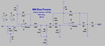

Regarding your question about the circuit of post #396, https://www.diyaudio.com/community/...split-from-opa1656-thread.377331/post-7940730 , suggested values with an OPA627 instead of an OPA1656:
Second-order: R8 = 34.8 kΩ, R9 = 0 Ω
Third-order: R8 = 19.6 kΩ, R9 = 15 kΩ
A belated Thank You Marcel! Don't know why but I expected a larger diff in the R values.
I see that the 627 3rd order R8+R9 sum is ~ 1.4% different from the 1656 3rd order R8+R9 sum. Would I risk spinning-up the gods of perfection if I just used the 1656 values in the 627 application..? And then ran far far away....
No, that should also work fine.
In fact, I'm not even sure that the values I recommended are an improvement. They shift the second RIAA pole closer to its ideal position, but at the expense of a less accurate RIAA zero. Basically I'm just smearing out the 0.23 dB error you get due to finite gain-bandwidth product over a wider frequency range.

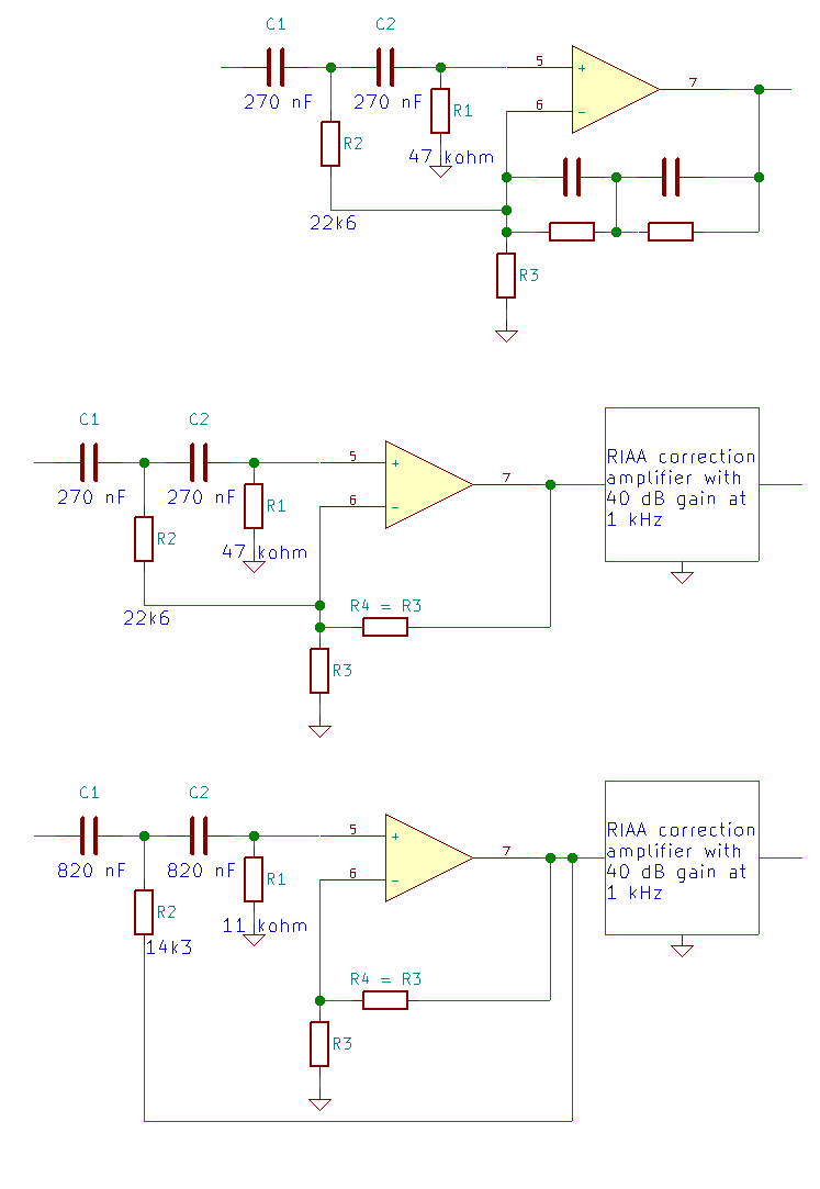

If you were to replace the RC parallel networks in the schematic of post #287 with just a resistor with a value about equal to R3, with R3 << R2, you would get at least about the same noise penalty as with the circuit of post #287.
I'm not sure if you could reduce the noise penalty by connecting R2 between the times-two amplifier output (rather than the op-amp's negative input) and the point where the two capacitors C1 and C2 are connected to each other. You get a negative damping term that you have to correct for by making R2 larger (which reduces its thermal noise current), but you also get a negative conductance term due to R2 then, so R1 then has to be smaller than the usual 47 kohm (which increases its thermal noise current).
Let me rephrase it in schematics then:
The upper schematic comes straight from post #287. I've shown there with a couple of noise transformations that it is not a very good circuit noise-wise, mostly because of the thermal noise current that R2 injects into the signal source.
The second schematic has the exact same issue.
Yesterday evening I was a bit too tired to work out the third solution, but it actually gets worse. This circuit also has 47 kohm input impedance at high frequencies (47.6666... kohm to be precise), but it injects more thermal noise current than the others.
I've also looked at obtaining the signal for R2 from a tap on R3 (not drawn), but that doesn't help much either.

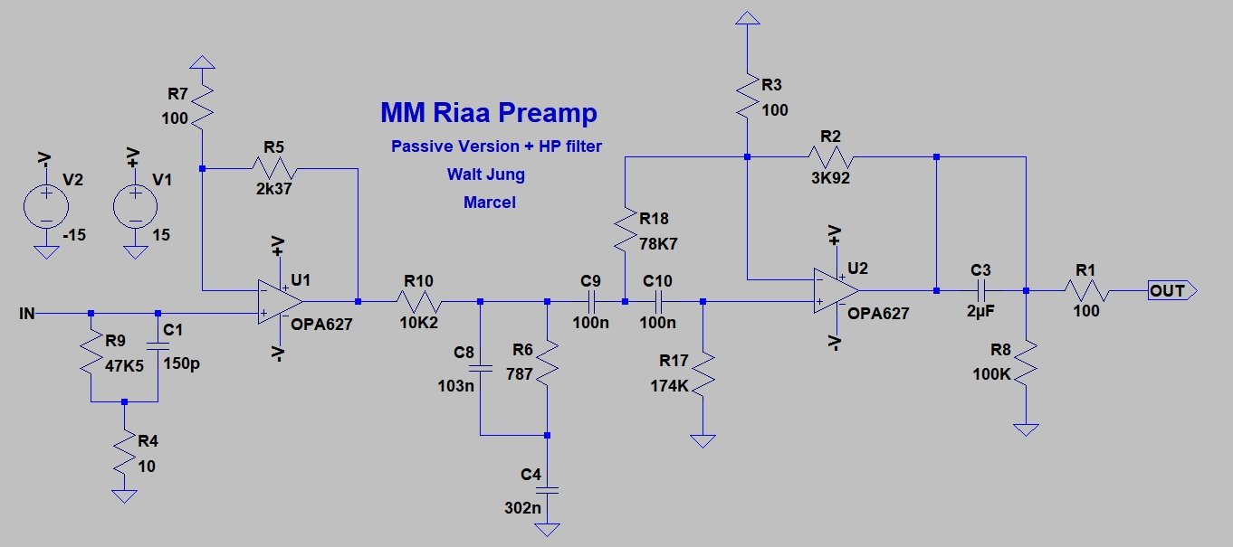

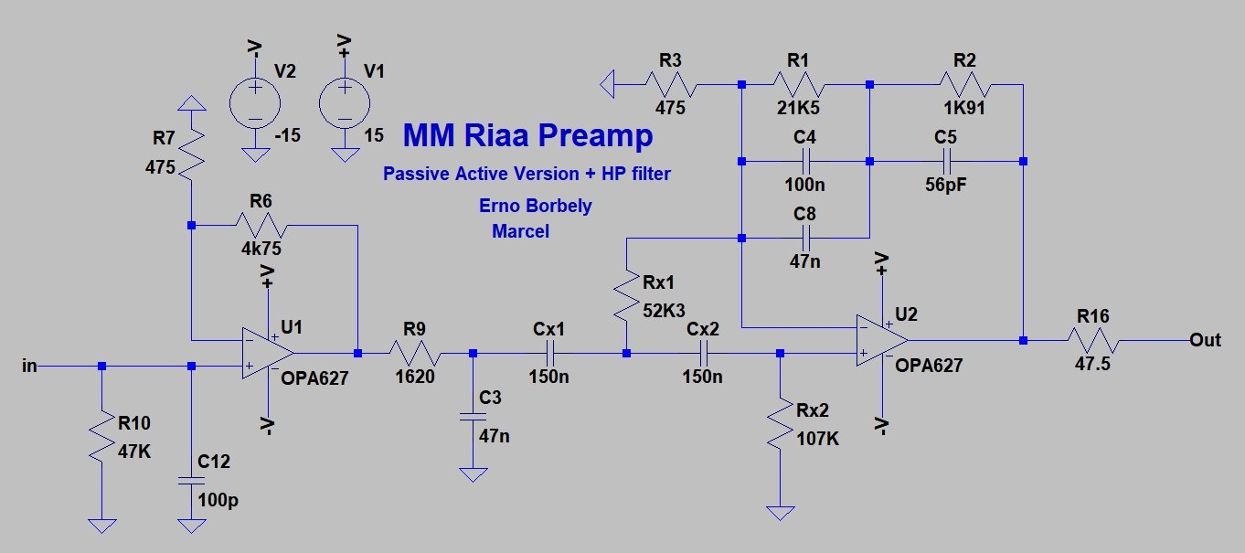

In this case wouldn't it be better to go for the active and passive preamps I had proposed originally, and which Marcel added the HP filter to? He also modified them to use without DC servos.
