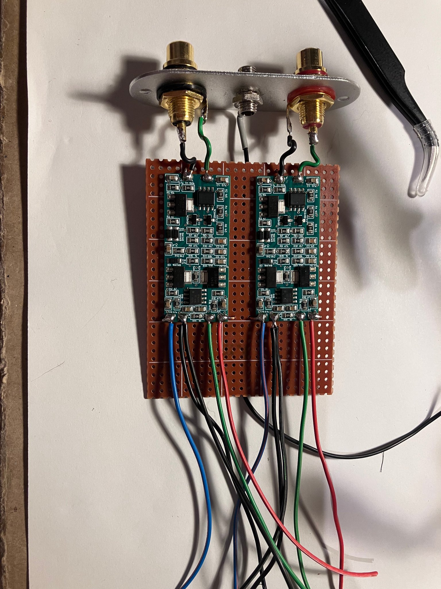

I use OPA192 since 2022 in all my preamp versions 5...9 - a nice SOIC-8 with 4 nV/sqrtHz and <5 uV DC offset
I found exactly the same SMD preamp you are using being sold through Facebook, and it seems it uses the OPA192 as a DC servo, not for the whole RIAA preamp. It's a dual JFET input discrete preamp, very good design BTW.
But I have checked again the OPA192 on the RIAA three versions I simulated, and offset specs seem very low, like a mere 115uV.
