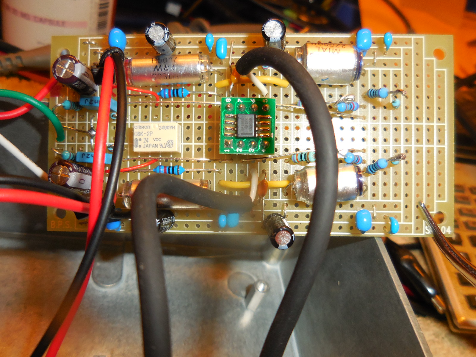

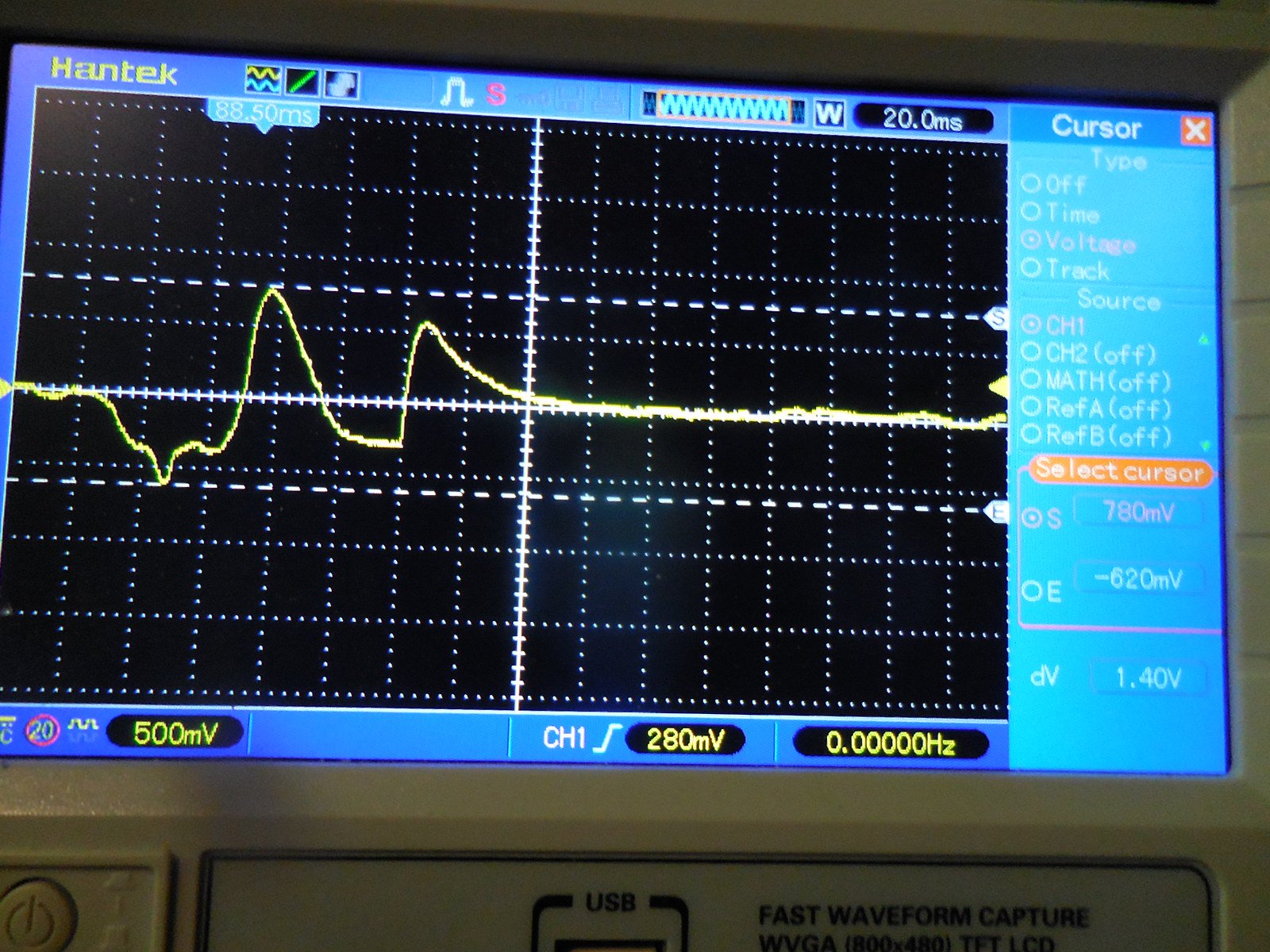

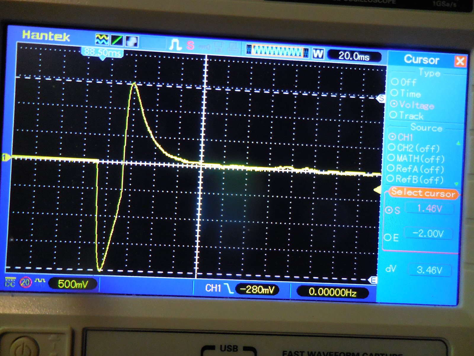

Isn't that a beaut! You should see the flip-side. That was pass #1 using 1% P-styrene caps from Nebraska Surplus back in 2021. Checked it out thoroughly as best I could with function gen and scope and a list of RIAA freq specs. I got some flack here about the "build" and improvements needed for parasitic this and that, grounding and so on so I redid it. I had no troubles with #1 until my first LP play when I did run the volume down for the first drop, then turned it up and it sounded clean - no misbehavior at all so I walked away thinking I'll listen from my home office while it's breaking in. The first side finished and then came the attached "OPA1656 lift ampitude" when the TT's slide switch closed as it lifted thus shorting the + and- cart outputs and pretty much bottomed my system. As I was running to the system the arm was traversing back to its rest but it was faster than I so there was another Wham-bang as the slide switch opened thus un-shorting the cart outputs as it dropped onto its rest where you see the 1656's behavior in the 2nd pic. So let's not talk about EMI/RFI influences anymore. 😉
