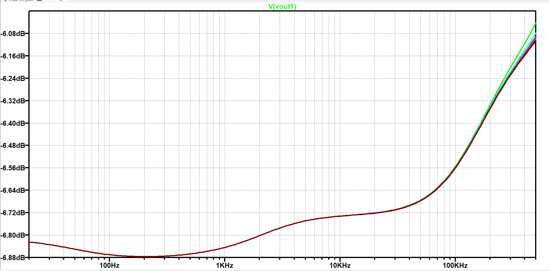

If you do RIAA conformance plots, it is a good idea to extend the analysis to >> audio band - say to 500 kHz.

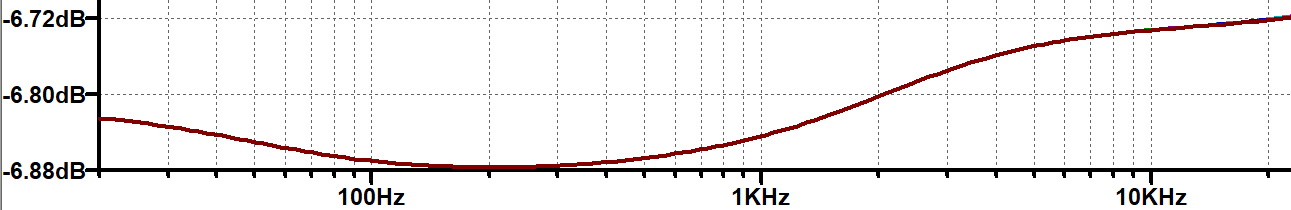

Here is a reasonably respectable all-active opamp based phono amp covering just the audio band and without the secondary LPF. Its within 0.2dB.
Here's the extended response
Ideally, the response should be tight in the audio band and drop off at 20dB/decade at HF beyond the audio band - in other words, having tight conformance over the audio band but out-of-band peaking or other response anomalies should be avoided.
Why? All that ultrasonic rise means is that the gain levels off at 1 while the theoretical reverse RIAA correction keeps rising indefinitely. In real life, even though the rumours about the Neumann pole are nonsense, the record cutting machine will roll off somewhere, probably at a higher-than-first-order rate and starting from a frequency below 100 kHz. On top of that, there is the roll-off of the cartridge and the damping of the internal wall (assuming it are the bats hibernating in your cavity wall you are concerned about).

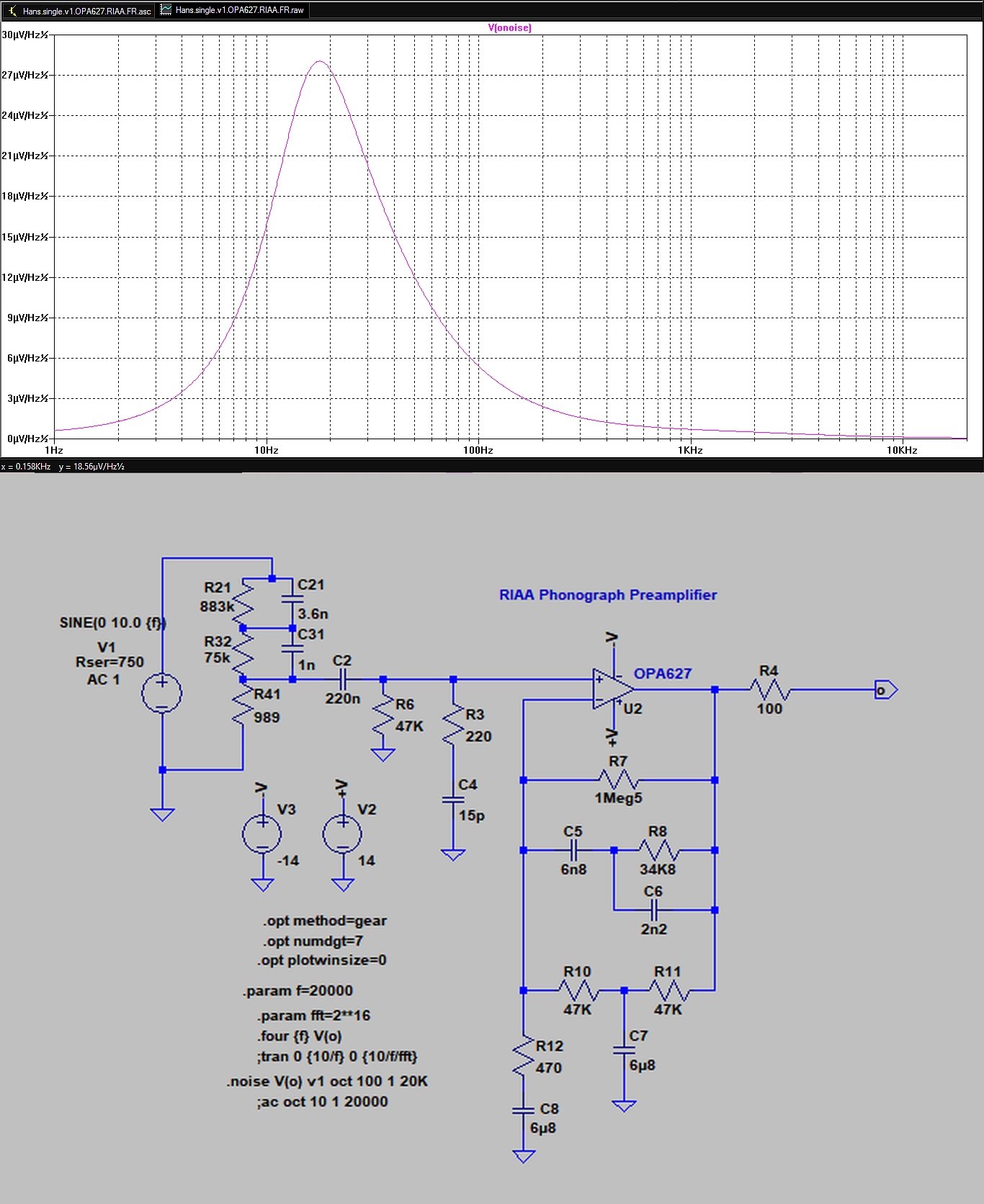

2) Has anyone simulated these circuits for noise response? I get weird humped noise curve: is that supposed to be so?
Posting #327.2) Has anyone simulated these circuits for noise response? I get weird humped noise curve: is that supposed to be so?
The hump was explained to you.
Hard to tell when you don't show what your "weird humped noise curve" looks like. The noise density plots should certainly be far from flat.
The equivalent input noise density should be sort of bathtub shaped due to the source impedance that rises with frequency, the 1/f noise and the coupling capacitor. The equivalent output noise density should roll off at high frequencies due to the RIAA correction and at low frequencies due to the decreasing source impedance and the subsonic filter.
It looks a bit weird due to the unrealistic non-inductive source impedance. You get roll-off below 16 Hz due to the subsonic filtering and above 16 Hz due to the decreasing impedance of the coupling capacitor and due to the RIAA correction. With 500 mH or so of inductance, the increasing source impedance more or less compensates for the RIAA roll-off over a wide frequency range.

Please tell me how should I connect this inductor, because I tried several options at the input with no results to the curve.It looks a bit weird due to the unrealistic non-inductive source impedance. You get roll-off below 16 Hz due to the subsonic filtering and above 16 Hz due to the decreasing impedance of the coupling capacitor and due to the RIAA correction. With 500 mH or so of inductance, the increasing source impedance more or less compensates for the RIAA roll-off over a wide frequency range.
