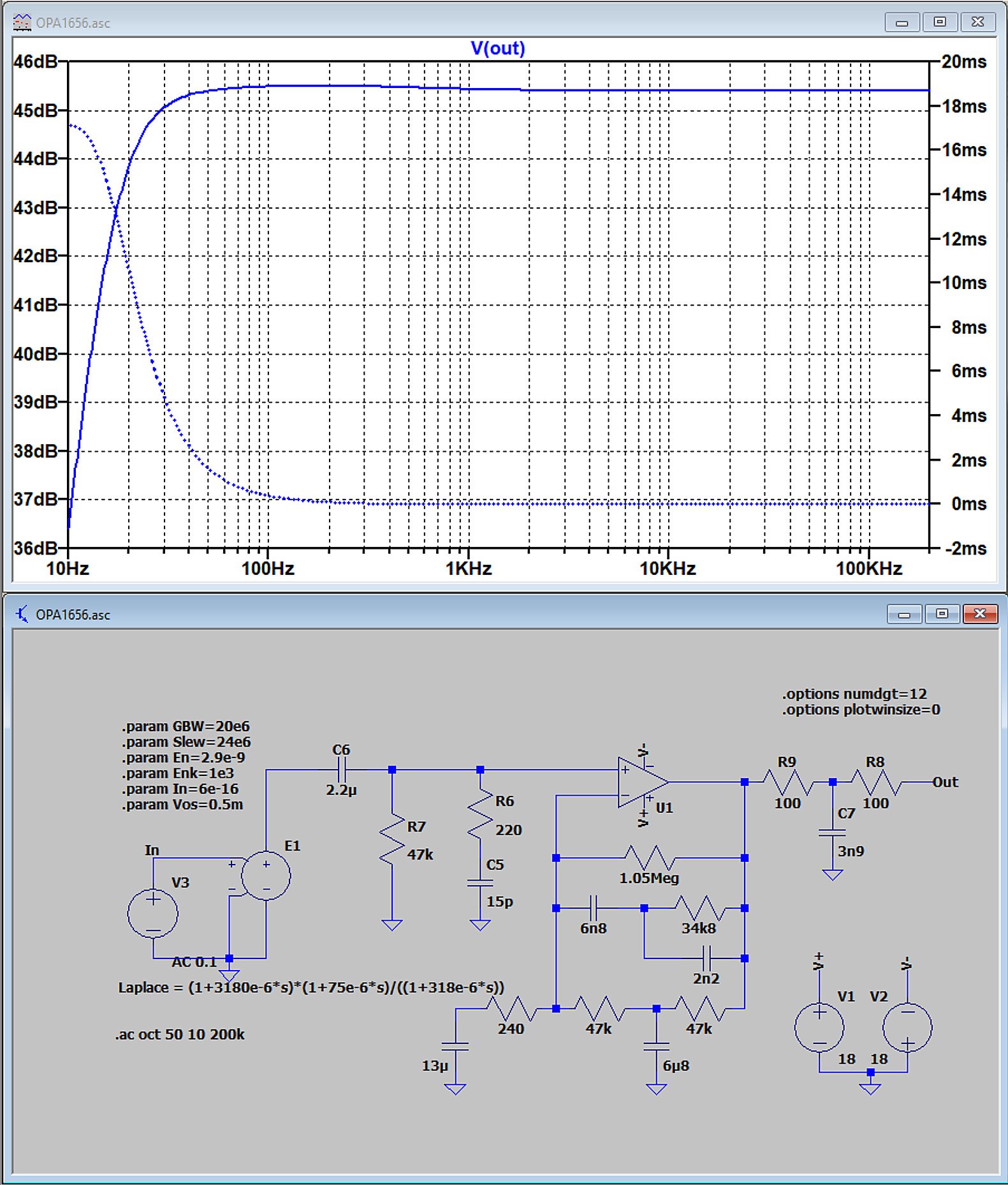

So, do we have a final schematic of Marvel's phono preamp?
1) Do we simply put say ~ 15nF at the output for the +1 problem?
2) Can we see a Bode plot of 40Hz and down? Is 30Hz preserved? 20Hz?
3) Can the 1KHz gain be increased by say +5dB as was part of my original wish list for a low gain system?
Hats off to all those here smarter than I!

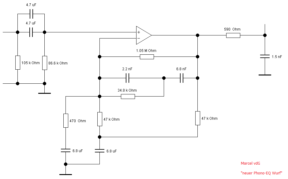

Schöne Idee - nice idea Marcel 😉.

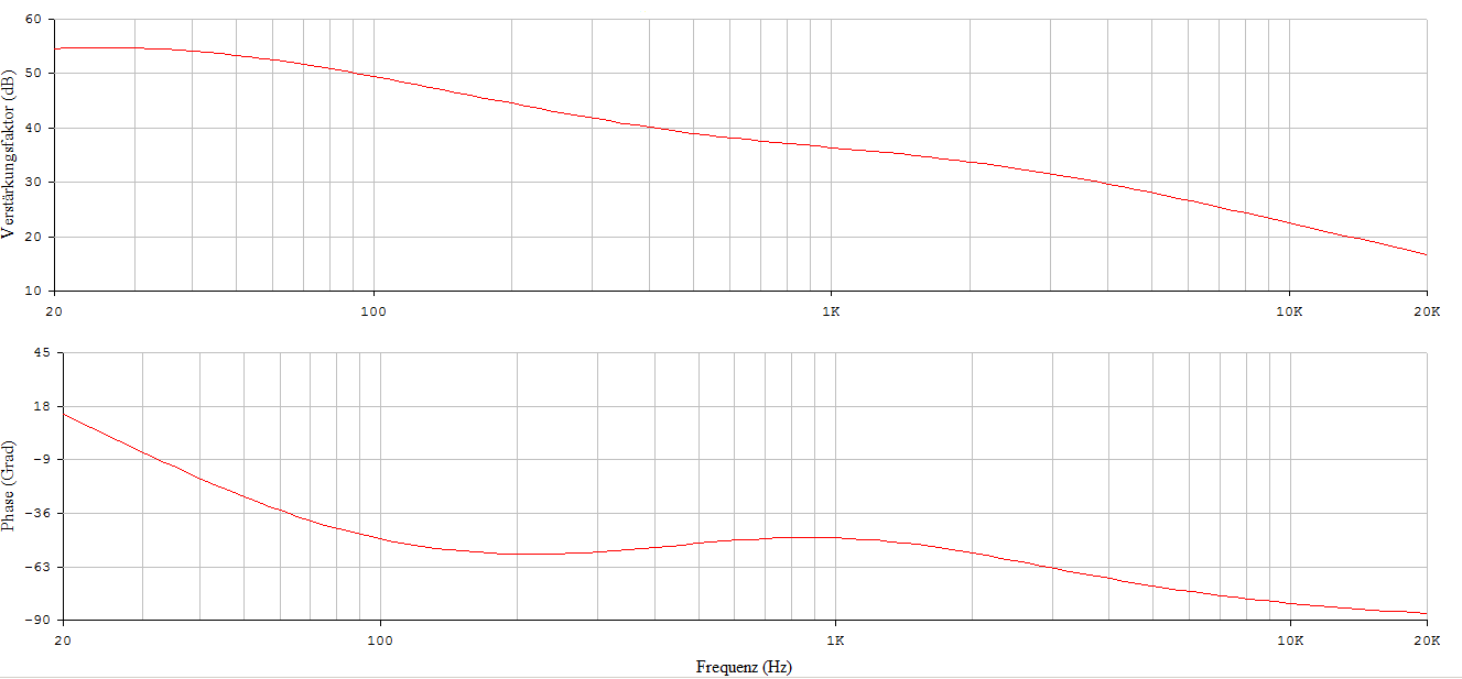

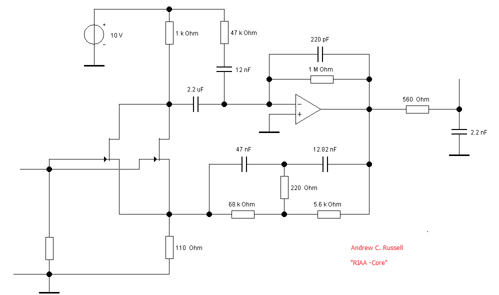

Personally, I also particularly like the Altra circuit.
We can probably all design an equalizer every 15 minutes to pass the time. Unfortunately, at some point the decision as to which litter you should enjoy the music with becomes increasingly agonizing.
greetings,
HBt.

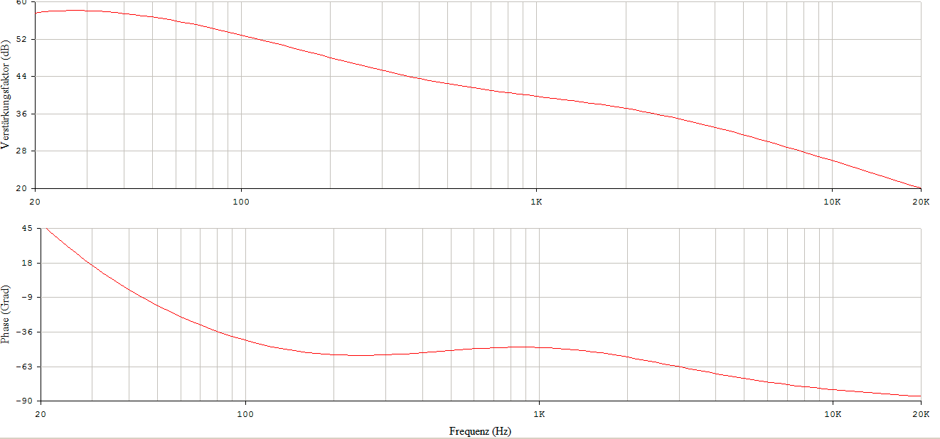

Here you are,
Two sims, first attachment with a 2nd order and second attachment with a 3rd order rumble filter.
Gain increased to 45.5dB.
To compensate the +1 effect, a 100R+ 3.9nF has been added, keeping the outer 100R at the output intact to cope with interlink reflections.
Be aware that the 3rd order filter exceeds the 20msec@20Hz group delay that Tomlinson Holmann advices as a maximum.
Hans
