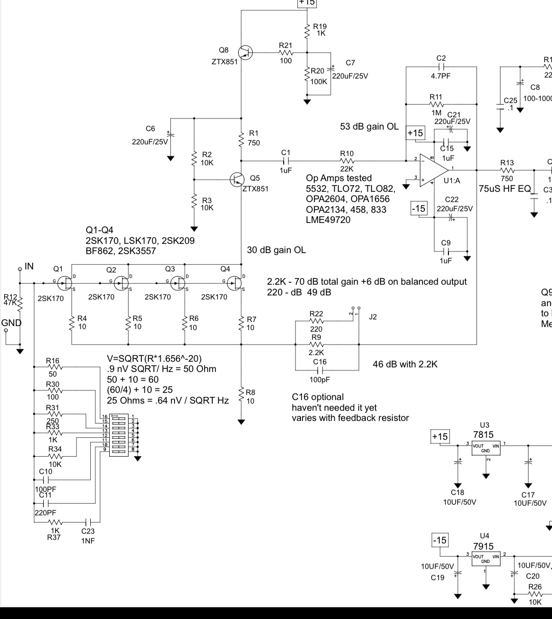

In that case it is pointless doing things like paralleled jfets as in this Pearl 3 design??47 kohm is the most important cause as long as you don't do anything silly. The total A-weighted

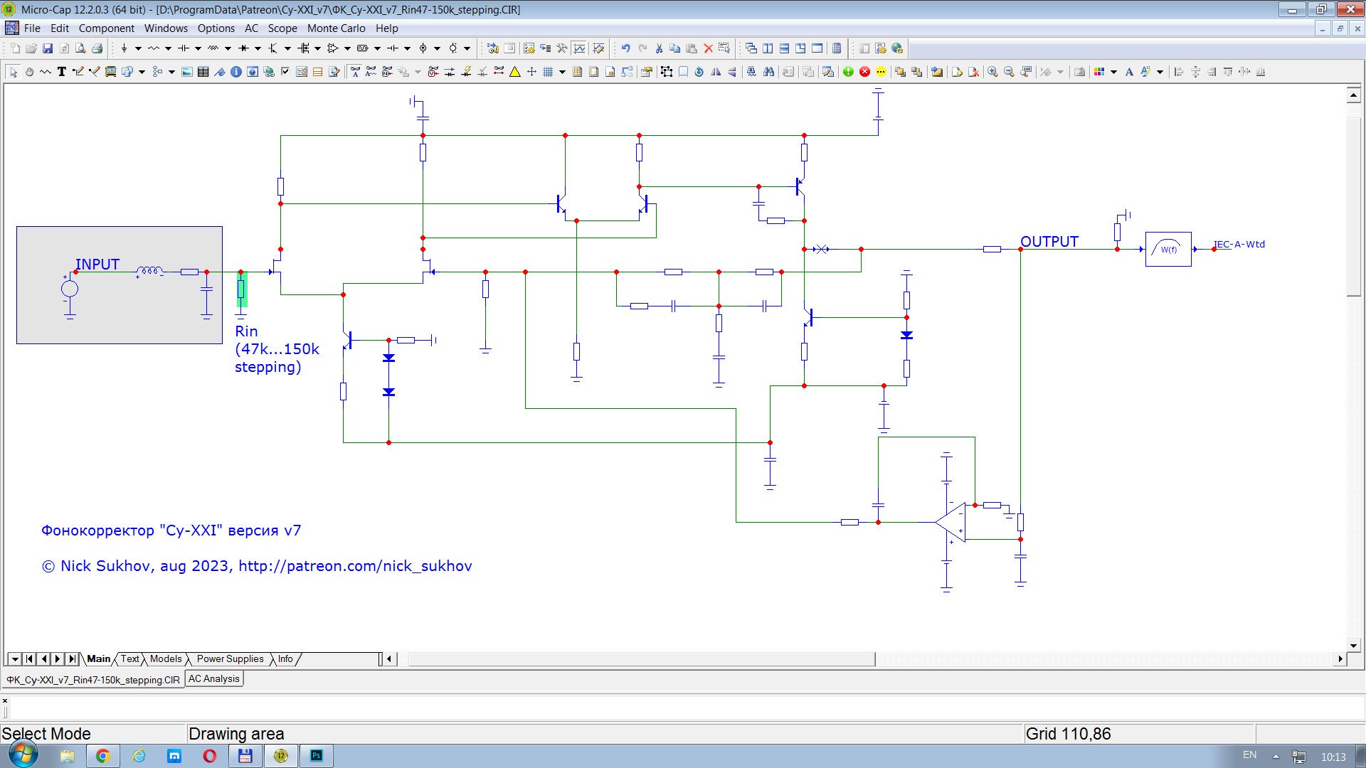

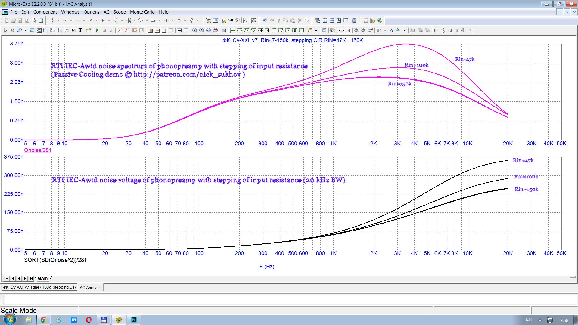

Marcel, even A-wtd noise with 47k is much more than with 100k and 150k as in my "passive cooling" (see attached MC12 simul) and even more so with your active cooling R3=1M from Fig.6 EWoktoba2003page4247 kohm is the most important cause as long as you don't do anything silly. The total A-weighted noise may therefore not tell the whole story.
No, because it and Bonsai's circuit are also meant for moving-coil cartridges. Due to their much lower impedance, termination resistor noise plays much less of a role (hardly any, actually) with moving-coil cartridges.

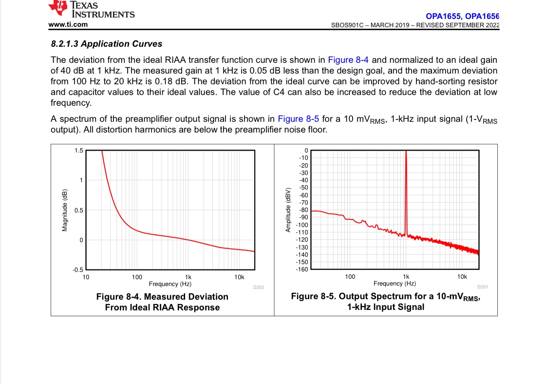

Another reason for the difference between our dBA values is the fact that the OPA1656 has in fact 2.9nV/rtHz and not the 4.3nV/rtHz that you mentioned.
But the knee frequency is at 1.2Khz, that's why 4.3nV/rtHz @1Khz has been specified.
I'm sure when you use these figures you will come even closer to the 80.5dBA.

For my calculation, I need the voltage noise density at 1169 Hz or 1160.23 Hz (see the article for an explanation why). With a white noise floor of 2.9 nV/√Hz and enough 1/f noise to make it 4.3 nV/√Hz at 1 kHz, the correct figure should be 4.13496 nV/√Hz at 1160.23 Hz.
The total noise then decreases to 9.05212 nV/√Hz and the A-weighted noise with 20 Hz and 20 kHz limits to 513.197 nV, -79.77372 dB with respect to 5 mV. I didn't bother making this small correction yesterday because it was quite late, I forgot it this morning.
