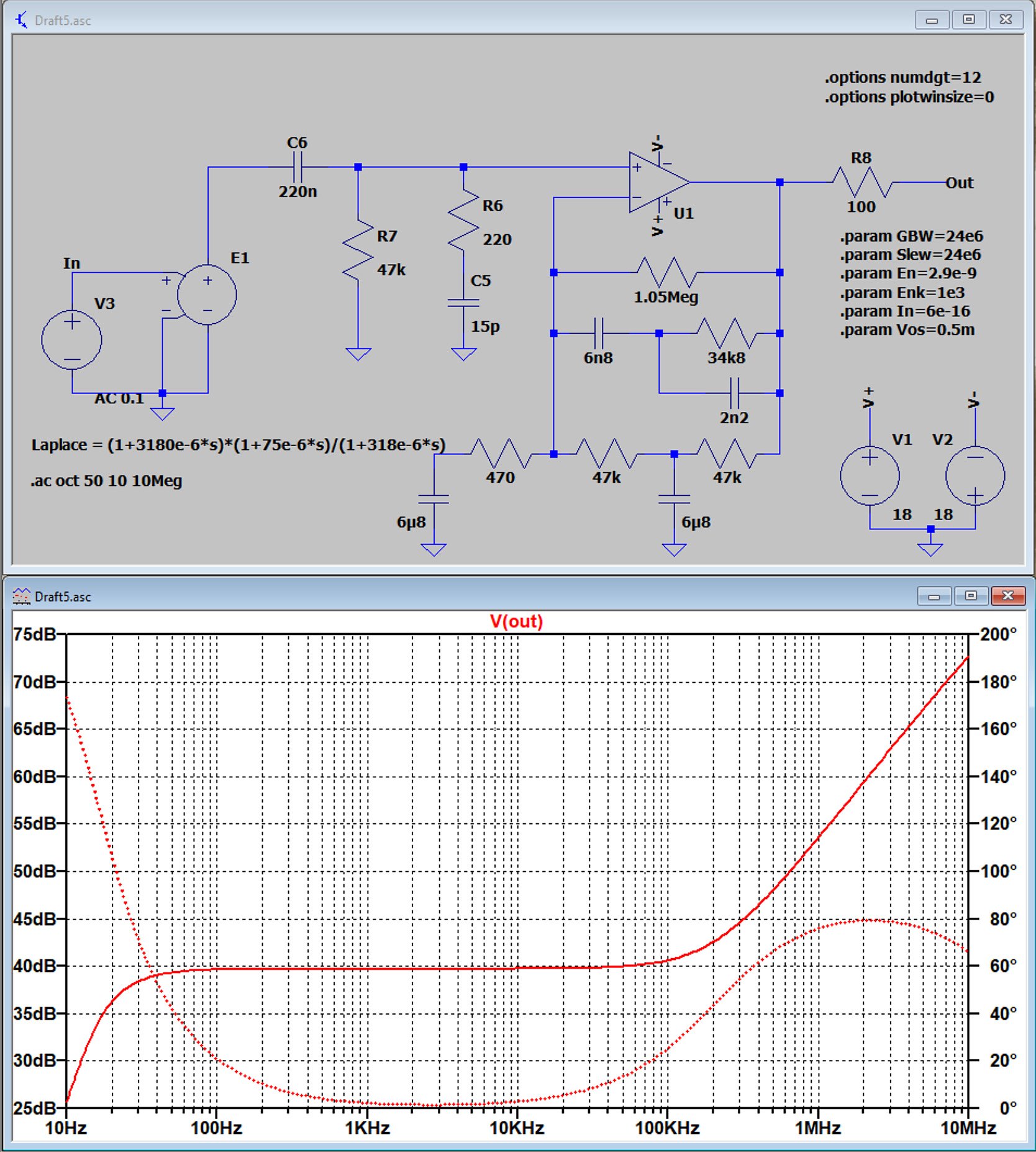

I believe Hans added another pole in the LTSpice Laplace for me when I was simulating my MC phono. Don't some add another pole at 50kHz or so?
Looks as the Laplace input keeps rising when the amplifier turns into unity gain?Isn't that simply the +1 error? What other mechanism could cause a zero there?

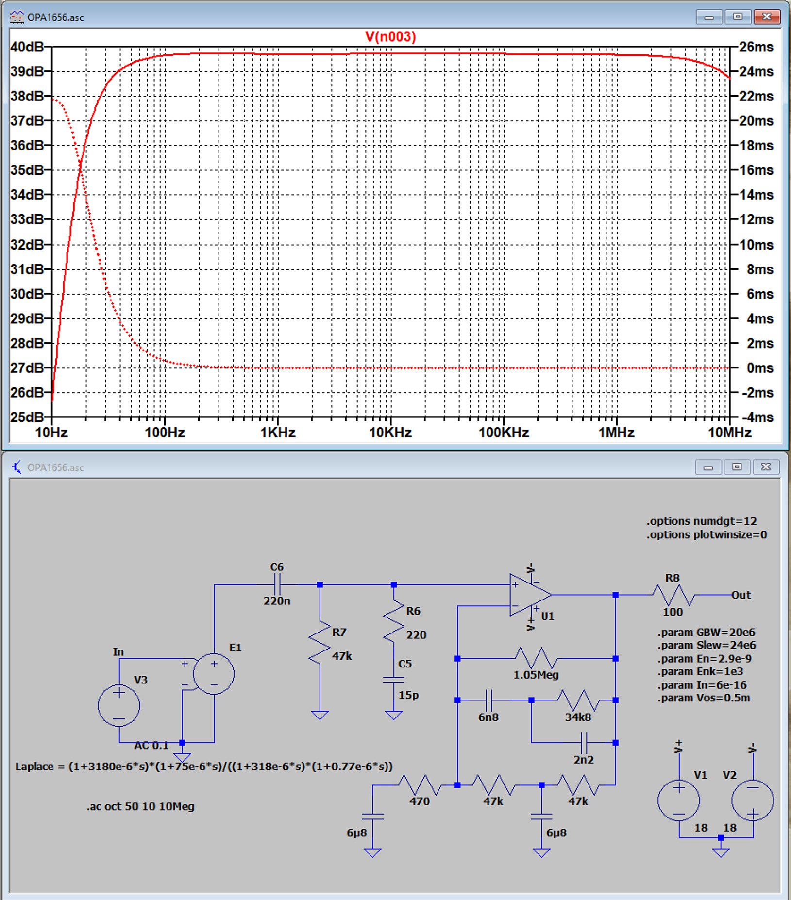

With an amp is driven from the positive input, you will have to deal with the minimum gain of 0dB.
I personally prefer to filter this in the amp, but when adding a pole in the Riaa source at 0.77usec or 207Khz, this will make the FR straight again.
At the same time I've also shown the group delay.
According to Tomlinson Holman group delay at 20Hz should be below 20msec, that's why I simulated a 2nd order and not a 3rd order rumble filter.
Hans

Regarding the zero caused by the +1 term, I usually deal with it by calculating the error at 20 kHz and concluding it is smaller than the error you are going to get from component tolerances and rounding values to E96 values. In fact, it's still well below 1 dB over the feline hearing range, so the chances of getting complaints about it from my cat are also small.

Did you try a different op amp vs. the rambunctious opa1656? Like the opa1641/42 or the opa627? I haven't a clue of what that graph shows.I stopped here.
First the rise in FR beyond 100Khz has to be solved.
The graph shows frequency response rising at very high frequencies (a "zero") caused by "the +1 error" which is itself caused by a non-inverting feedback amplifier's inability to have less than unity gain, and a test signal assumed to be flat forever.
Opinions vary on whether or not this matters. Real records are cut with considerable ultrasonic filtering, to accommodate real cutter heads' limitations, so the issue is somewhat artificial. Stylus / groove wall interactions get murky at short wavelengths, complicating it further. Some folk will tack an RC LPF on the output if they're concerned.

I don't see the 2122Hz pole at 2122Hz. That's what is befuddling. I thought this was to be a FR sim of Marvel's RIAA EQ circuit.The graph shows frequency response rising at very high frequencies (a "zero") caused by "the +1 error" which is itself caused by a non-inverting feedback amplifier's inability to have less than unity gain, and a test signal assumed to be flat forever.
And who cares about the RIAAs max hi-freq limit of ~50-100KHz. @20dB gain @ 21kHz and @ -6dB slope beyond, many op amps hit the open-loop 0dB wall at about that. Or have I had too many cocktails tonight.
The post filter I see has a wee problem. The R has to be large enough to limit op amp's Vo loading at high freqs but not too big to screw with the output resistance wrt unknown downstream loads. EG: Big C, + small R = R//feedback elements @ HF = maybe Vo overload. Big R + small C = need for output buffer.

The error due to the "+1" is not much smaller than the error due to 2% capacitors (+0.1dB at 20KHz versus +/-0.2dB). This matters if one is aiming for world-class EQ accuracy.
Ed
It's about 0.04 dB actually, not 0.1 dB.
The graph of post #306 shows the deviation from an ideal RIAA response, basically what I had already checked with my pole-zero extraction program. Ideally it should just be a Butterworth high-pass filter, but there are some small differences in the deep subsonic region and some at ultrasonic frequencies due to the + 1 term.
