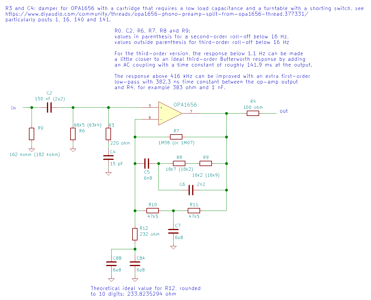

The schematic below would be my increased gain version, gain roughly 46 dB at 1 kHz. With midband gains of 40 dB or more, adding extra filters to correct for the + 1 is quite unnecessary in my opinion, as long as the + 1 is taken into account when determining the component values, as it always was. If you really want to, you can put a first-order low-pass with 382.3 ns time constant between the op-amp and R4. Like Hans wrote, it is a good idea to still have a resistor straight at the output to prevent sharp transmission line resonances that might cause instability in the next stage.
As implicitly suggested by hbtaudio, I've split up the former R6 into two parts, R0 before and R6 after C2. The main advantage is that it gives me more control over the input time constant, it also provides a discharge path to C2 when there is no cartridge connected.
Besides the ultrasonic effect, the + 1 term also changes the slope of the subsonic filter below about 1.1 Hz. For the second-order version, this is corrected for by C2, for the third-order version, it is not corrected. If you should find it necessary to correct for it, put a first-order high-pass with 141.9 ms time constant at the output. I think it's quite unnecessary, as the third-order response is already close to -70 dB at such low frequencies.

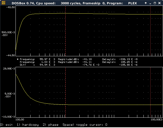

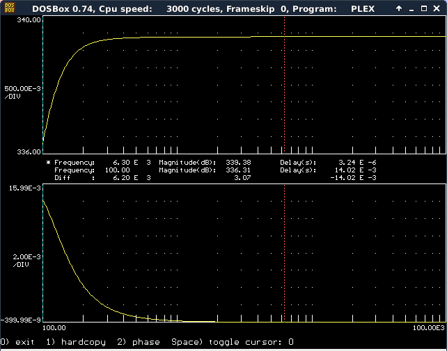

This leads to the following deviation from an ideal RIAA response over the 100 rad/s (15.9155 Hz) to 100 krad/s (15.9155 kHz) frequency range:
Upper graph: magnitude in dB, lower graph: group delay in seconds. Please subtract 339.38 dB from the numbers in the upper graph to get it normalized to the gain at 1 kHz. At 100 rad/s, there is a -3.07 dB deviation from the ideal RIAA response, as was to be expected with a 16 Hz Butterworth subsonic filter.
Third-order version:
Poles:
(-49.750 +/- 86.408j) rad/s
-13.274 krad/s
-316.937 rad/s
-99.357 rad/s
Zeros:
-2.616 Mrad/s
-3.164 krad/s
-7.046 rad/s
-717.159 mrad/s
0 rad/s
Resulting deviation from an ideal RIAA response from 100 rad/s (15.9155 Hz) to 100 krad/s (15.9155 kHz), now add 41.14 dB to the values in the upper graph to get it normalized to 1 kHz:
With respect to 1 kHz, the response has dropped to -2.93 dB at 100 rad/s (15.9155 Hz) due to the subsonic filtering. The deviation from the ideal RIAA response at higher frequencies is not quite as flat as in the second-order case, because the RIAA zero and second pole are slightly less accurate.
Same plot, but with the cursors placed elsewhere:
This shows that the peak-to-peak error due to the slightly less accurate RIAA zero and second pole is about 0.07476 dB.
Please explain the "as long as the + 1 is taken into account when determining the component values, as it always was." part. +1 poles at 100KHz and 200KHz were brought up and now only an added 400KHz pole because why..? What about the original zero deviation at 100Khz and up?
I had a little disagreement with @EdGr a couple of pages back about whether the error due to the + 1 would be 0.1 dB or 0.04 dB for the frequency range up to 20 kHz when the gain at 1 kHz is 40 dB. In the end, we figured out that it depends on how you determine the component values.
When you calculate them while neglecting the + 1 term and then in the end at + 1, you get an error of about 0.1 dB at midband frequencies that cannot be corrected with an extra low-pass filter. (That's for 40 dB gain at 1 kHz, it should be about 0.05 dB for 46 dB gain.)
When you take the + 1 into account from the start, all you get is an extra zero that causes a +0.04 dB error at 20 kHz (for 40 dB midband gain, +0.01 dB for 46 dB midband gain) and that you can correct with an extra first-order low-pass filter. (I don't see the point because of the small magnitude of the error, but still.)

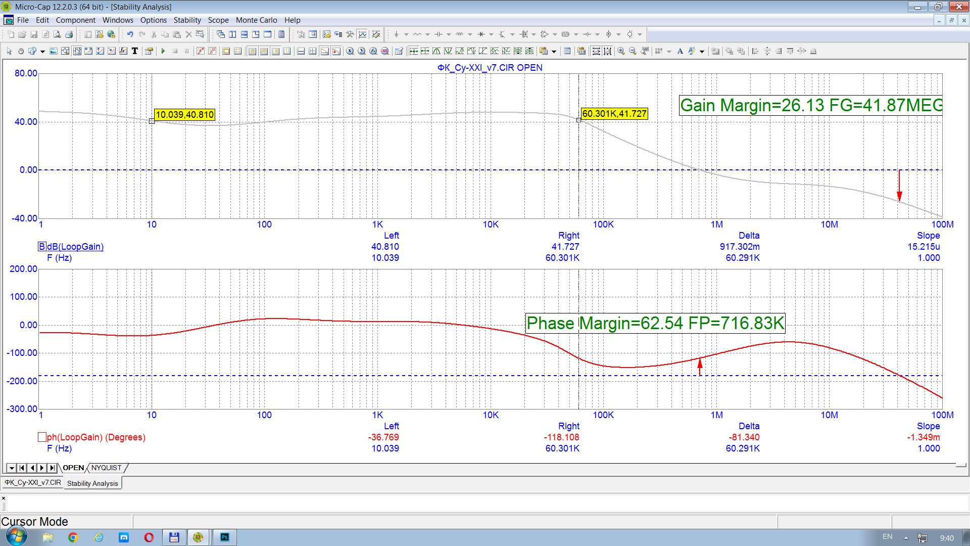

The other source is the finite open-loop gain. The discrete-transistor pre-amps I was designing in the 1980s did not have enough open-loop gain for accurate active EQ
But if you make almost constant 40 dB loop gain 1Hz...60 kHz [ see attached loop gain ] the discrete-transistor preamp with transadmittance RIAA output [ https://photos.app.goo.gl/8pHWArfTaYrDsXQx9 ] is fine

The +1 term in the non-inverting feedback equation is only one source of error. The other source is the finite open-loop gain. The discrete-transistor pre-amps I was designing in the 1980s did not have enough open-loop gain for accurate active EQ. I went to passive EQ to eliminate both errors.

Regarding the effect of the finite gain-bandwidth product, due to the OPA1656's fairly large gain-bandwidth product (53 MHz), the effect is rather small. The RIAA correction poles shift a bit, particularly the second one, the zero remains where it is (both in LINDA and in calculations). The first pole shifts by about -0.21 to -0.25 %, the second by -0.6 % to -0.67 %.
When R8 + R9 in the circuit of https://www.diyaudio.com/community/...split-from-opa1656-thread.377331/post-7939733 is reduced by 100 ohm, the second RIAA pole and the zero are both shifted up by about 0.285 %. The zero is then about as much too high as the pole is too low.
100 ohm lower values for R8 + R9 can be obtained by series-connecting two E96 values, as shown here:
Except for R8 and R9, nothing changed. Mind you, a slower op-amp such as an OPA627 would need a somewhat larger correction (presumably around -400 ohm rather than -100 ohm, but I haven't checked that).
