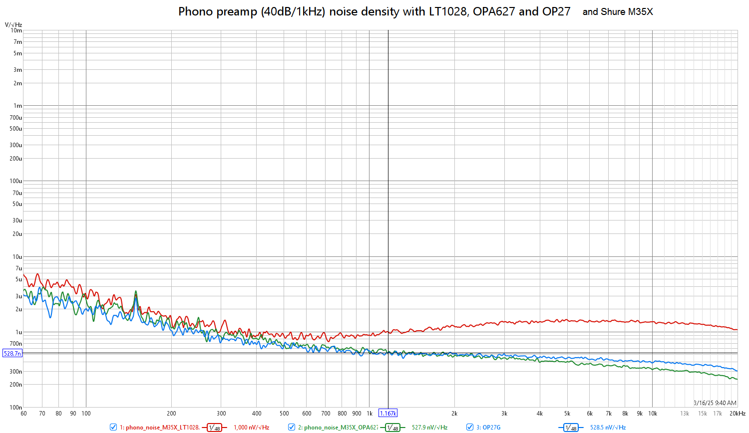

I can hear the 32bit file on my desktop system once the volume is cranked. OPA627 vs. LT1028 = rain standing inside v.s stepping outside. Big diff. You'll have me or rater my ear, glued to the tweeter. Thank you so much!I have prepared a real world record of the noise, maybe for @JRA (even if I doubt he is really interested in the roots of the issue), maybe for someone else who might be interested.
A simple RIAA preamp with one opamp and 40dB/1kHz gain has Shure M35X cartridge at the input. The output noise is recorded with 2 opamps, LT1028 and OPA 627. Bellow in the zip file are 2 files with recorded noise. 48kHz sampling, 32-bit float wav mono files. The FS level corresponds to 500mVrms. So, give it a chance, listen and you will know what is a "sharp" noise.

Sorry, but what does that noise prove?I can hear the 32bit file on my desktop system once the volume is cranked. OPA627 vs. LT1028 = rain standing inside v.s stepping outside. Big diff. You'll have me or rater my ear, glued to the tweeter. Thank you so much!

Proves that pA matter..? And now when I read that Marcel thinks one topology is inferior to another (a vs. b) b/c it's noisier I gotta wonder whether it's OCD or a real deal. I have never heard system hiss so loud that I could hear it except with my ear to the tweeter. Did you get the files to play? It was revealing. The LT1028 hiss was annoying if loud enough.Sorry, but what does that noise prove?

If it is the total RIAA- and A-weighted noise you are interested in, there is a break-even point for white and 1/f voltage noise at about 1169 Hz. That is, when you know the density of the equivalent input voltage noise at 1169 Hz, it doesn't matter for the total RIAA- and A-weighted noise what part is white and what part 1/f. (It may sound different, though, due to the different spectral distribution.)
