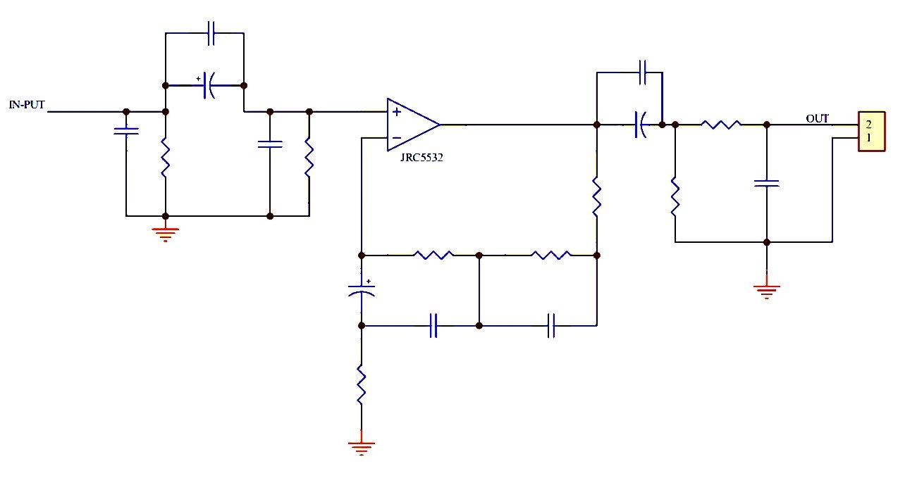

I still think my single-stage circuit is the most suitable, by the way.

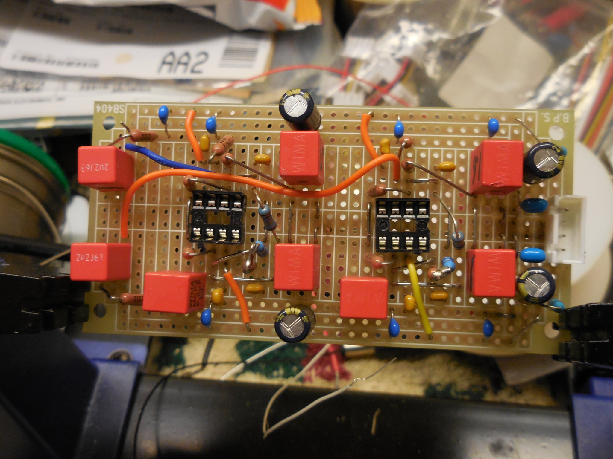

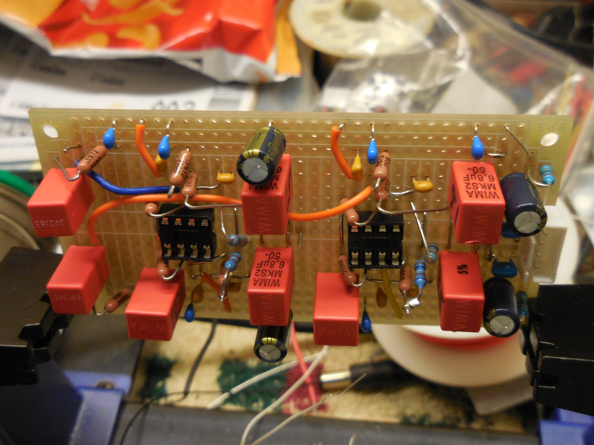

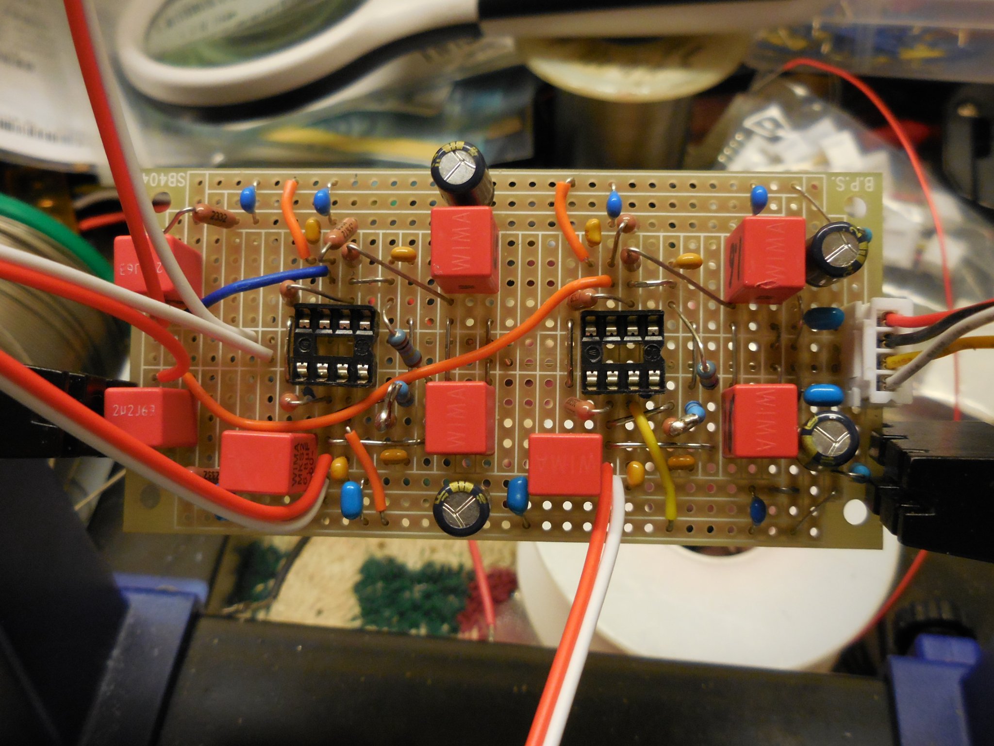

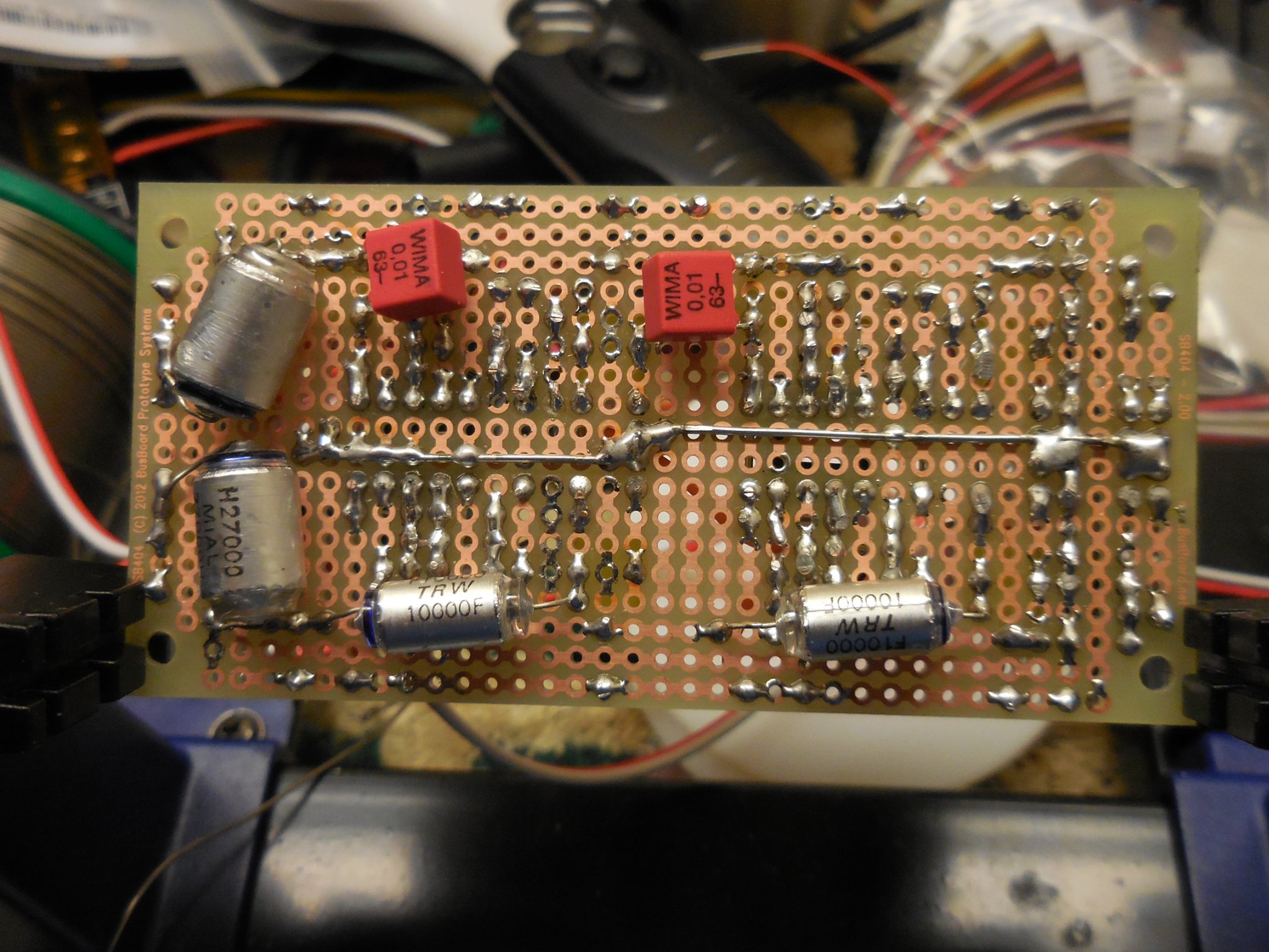

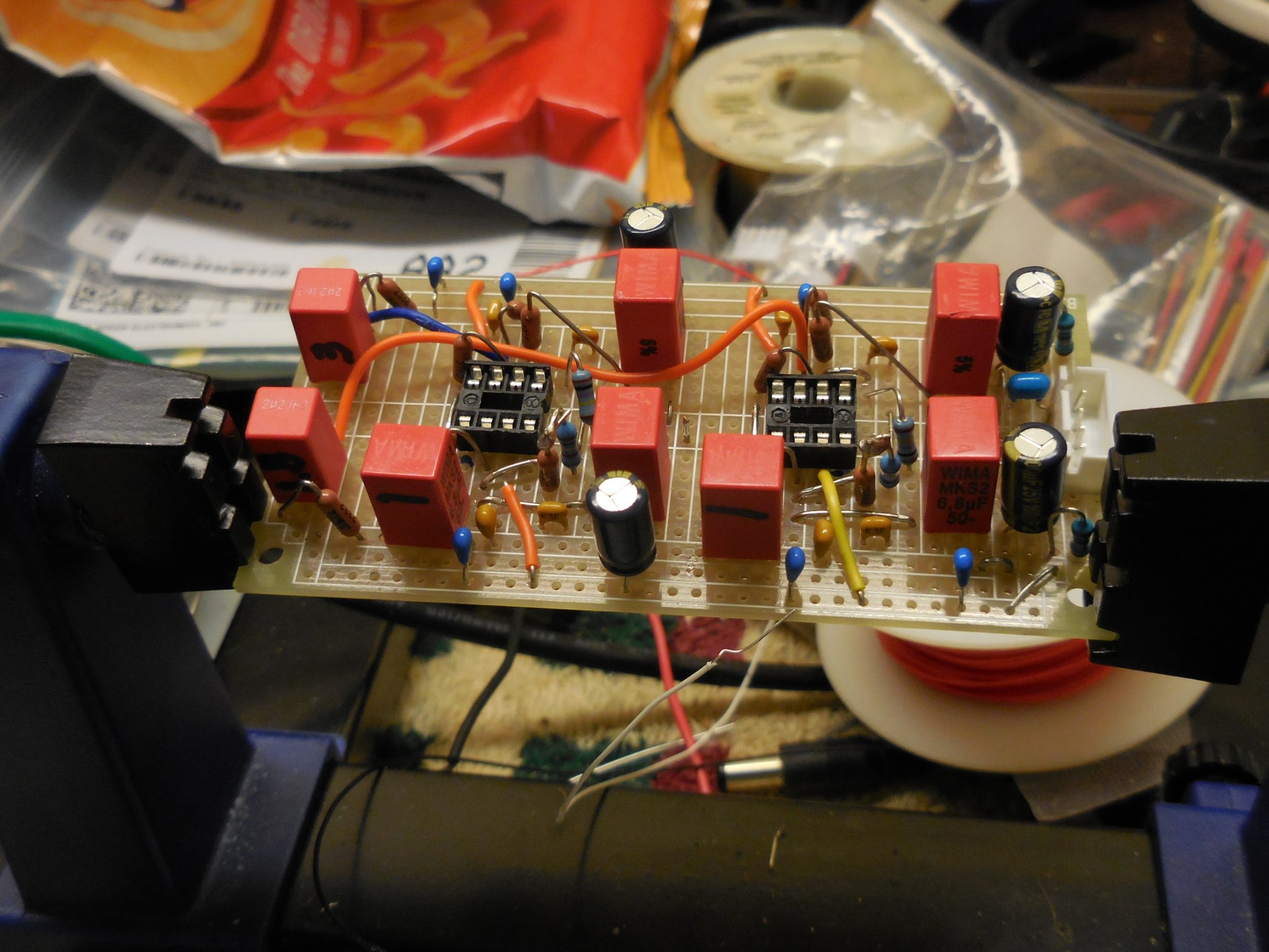

Of course you do Marcel so ready or not it's almost here. No laughing. I know, I know... it's ugly and primitive and many will eschew the power and ground routing but hey, I grew up with tube gear and point-to-point wiring and through-the-air here to there and Gnd is chassis metal right? and if it's in the way, jumper over and when it doubt tack it down, etc. So here it is, my version of the Marcel Marvel as of today.

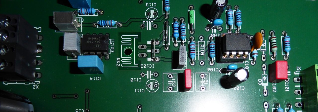

Even in case of prototypes. If you do not care about oscillations and inductive tracks effects, then of course happily stick with a breadboard 😉.
I measured the comparative noise plots of LT1028, OP27 and OPA627 in this provisional PCB, covered in a shielded case:

It should involve some working adding the additional passive parts from Marcel's schematic with the HP filter.
I understand the value of the gnd/power planes and copper flooding but just hink of a breadboard in 3D as in x, y and z vs. a flat x-y layout. When flown through the air the distance is shorter with no coupling. An A-to-B jumper is just a pcb trace and/or you can jump over things where otherwise you can't. Many times the here-to-there paths are the same or shorter. Parasitics are nil with a flying lead. Plus it's faster especially when/if you are not ready to commit. So there are "some" advantages. So you like pcbway.com? I imagine that it takes a good bit of prep on your part before handing them a design plan.
