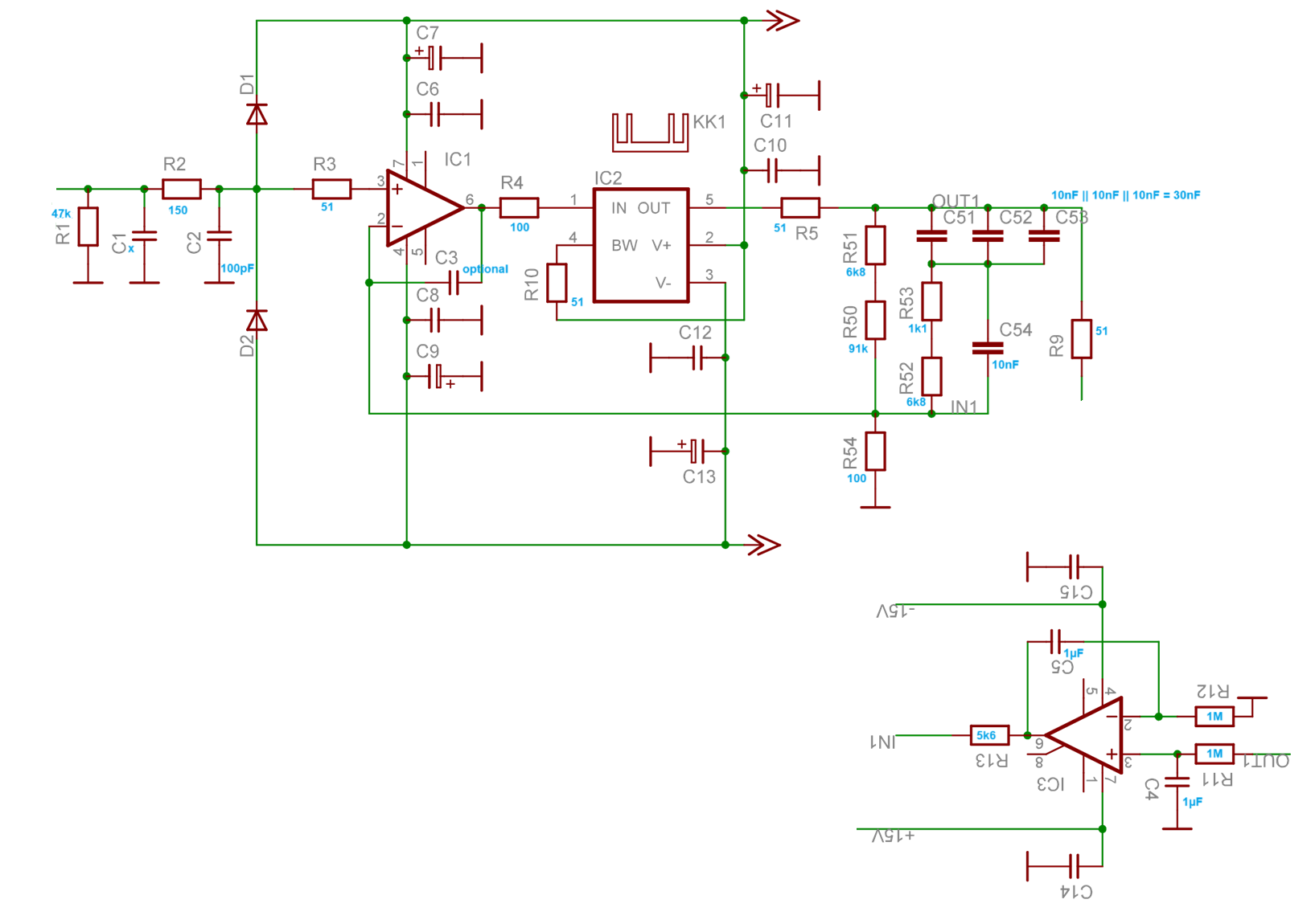

I hope I have read all the component values correctly from the BOM file in my haste.
So, this is your measurement circuit for the DUT ! That's all I wanted to know.
With the result that an LT1028 is of course worse than an OP27 or an OPA627 in this circuit.
In any circuit when there is a MM cartridge at the input.
Please stop trolling, the full documentation of the Openamp is on my web page, with bill of materials and Gerber files. You are posting a partial schematics only. And the test circuit recently did not use the LT1010, it was omitted, which I repeated several times.

Dear Pavel,
It is legitimate to ask a question and not "trolling". Especially when it's about totally harmless questions that can be answered quickly and easily. If I understand the thread creator correctly, everything here revolves around the use of the 1656 operational amplifier as an RIAA equalizer preamplifier - and this is actually a mundane topic, but nevertheless always exciting, in one way or another.
Incidentally, all the necessary (and often additional) information can usually be found in the (original) manufacturers' data sheets.
We can also find your great product, the OpenAmpOne, there - not quite one hundred percent, of course. But it is fair to say that you are providing a PCB for a well-known application note - no more and no less.
And that may also be said. Application notes are possible application examples that can be followed and are usually modified with slight adaptations to the specific task.
An LT1028 is totally unsuitable for the direct connection of an MM pickup, this is also (hidden) in the data sheet. However, this does not mean that this OP will not appear with an EQ example in the usual application possibilities. This component is not designed for high-impedance sources! And we've known this since this miracle OP made its debut on the market, so there's no need to lament it any longer.
That's why your noise analysis has a certain comparative appeal, but nothing more.

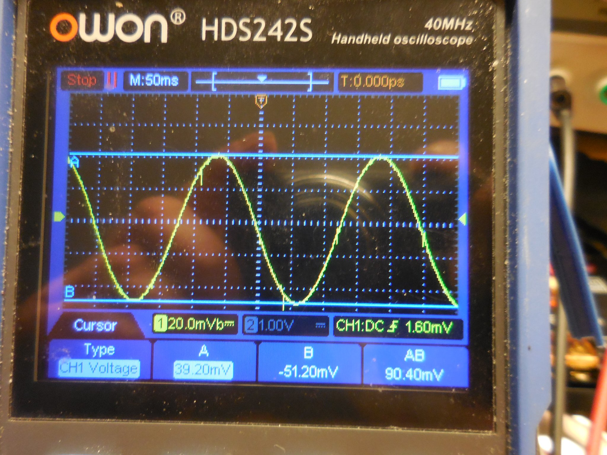

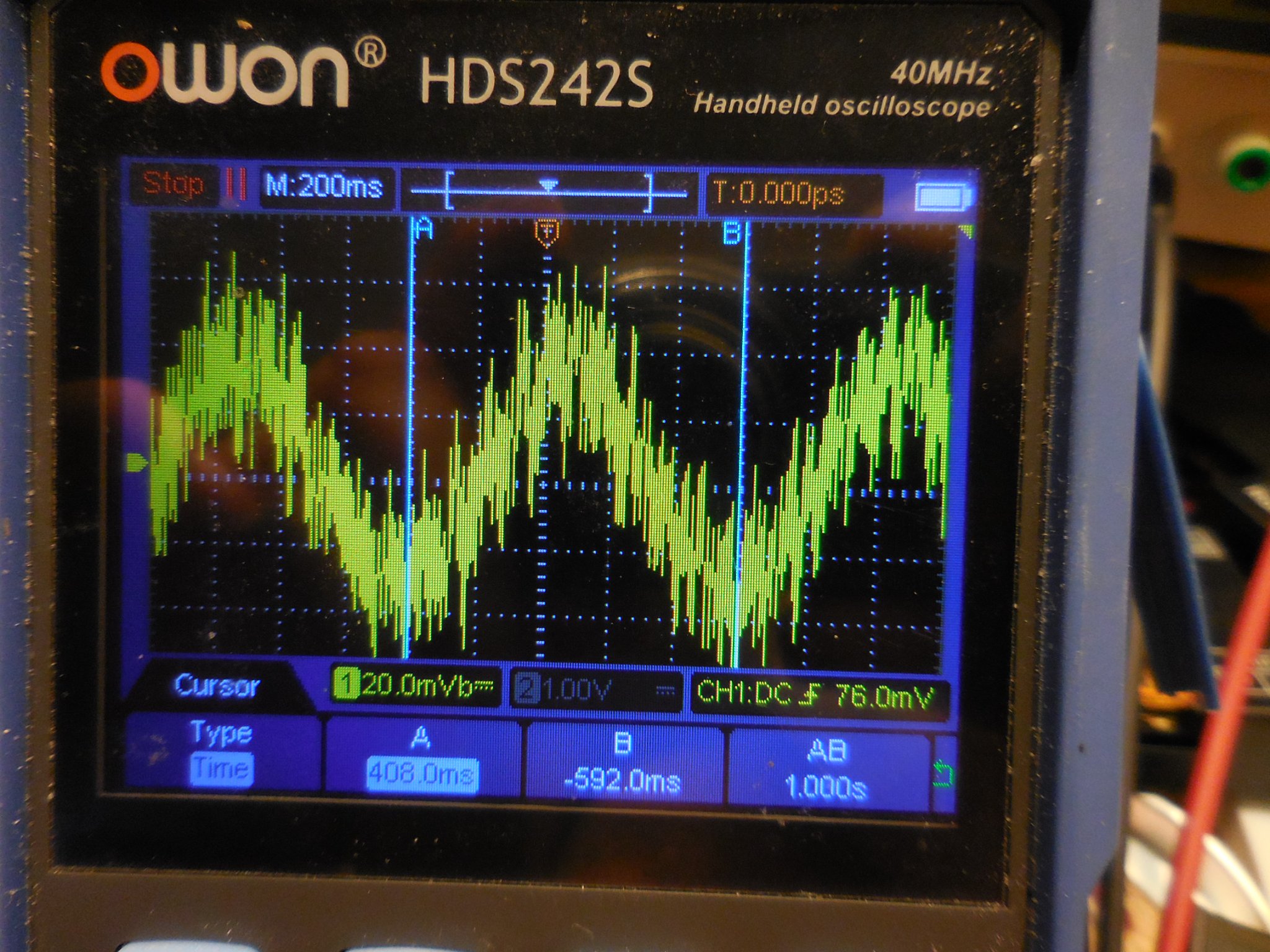

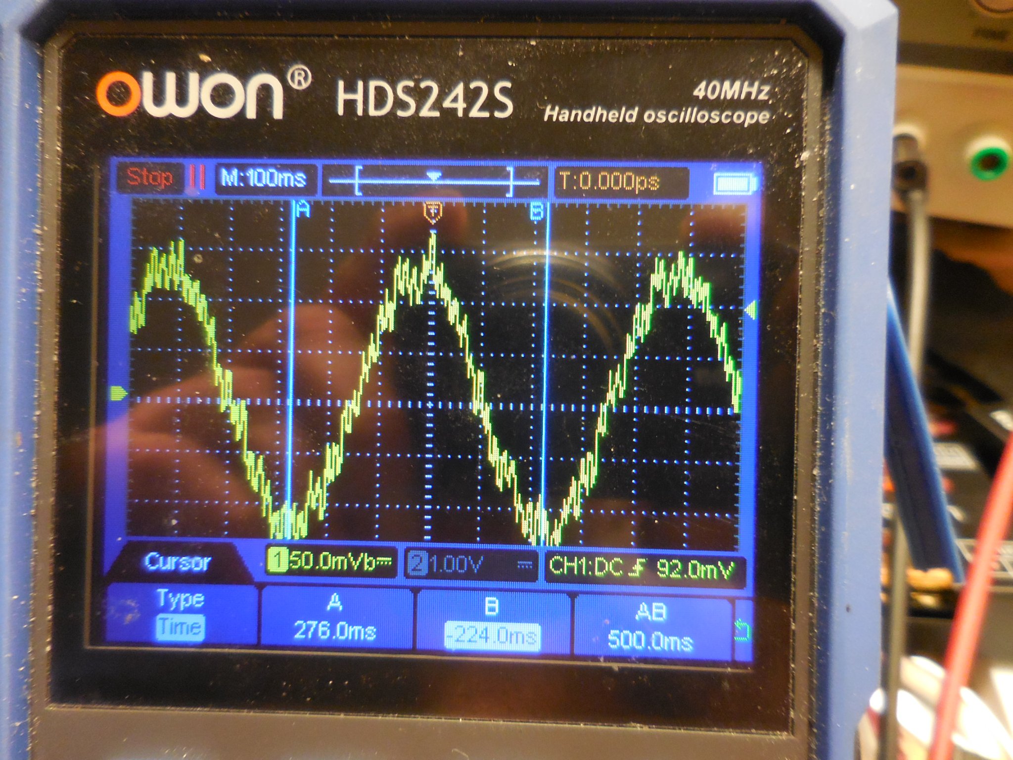

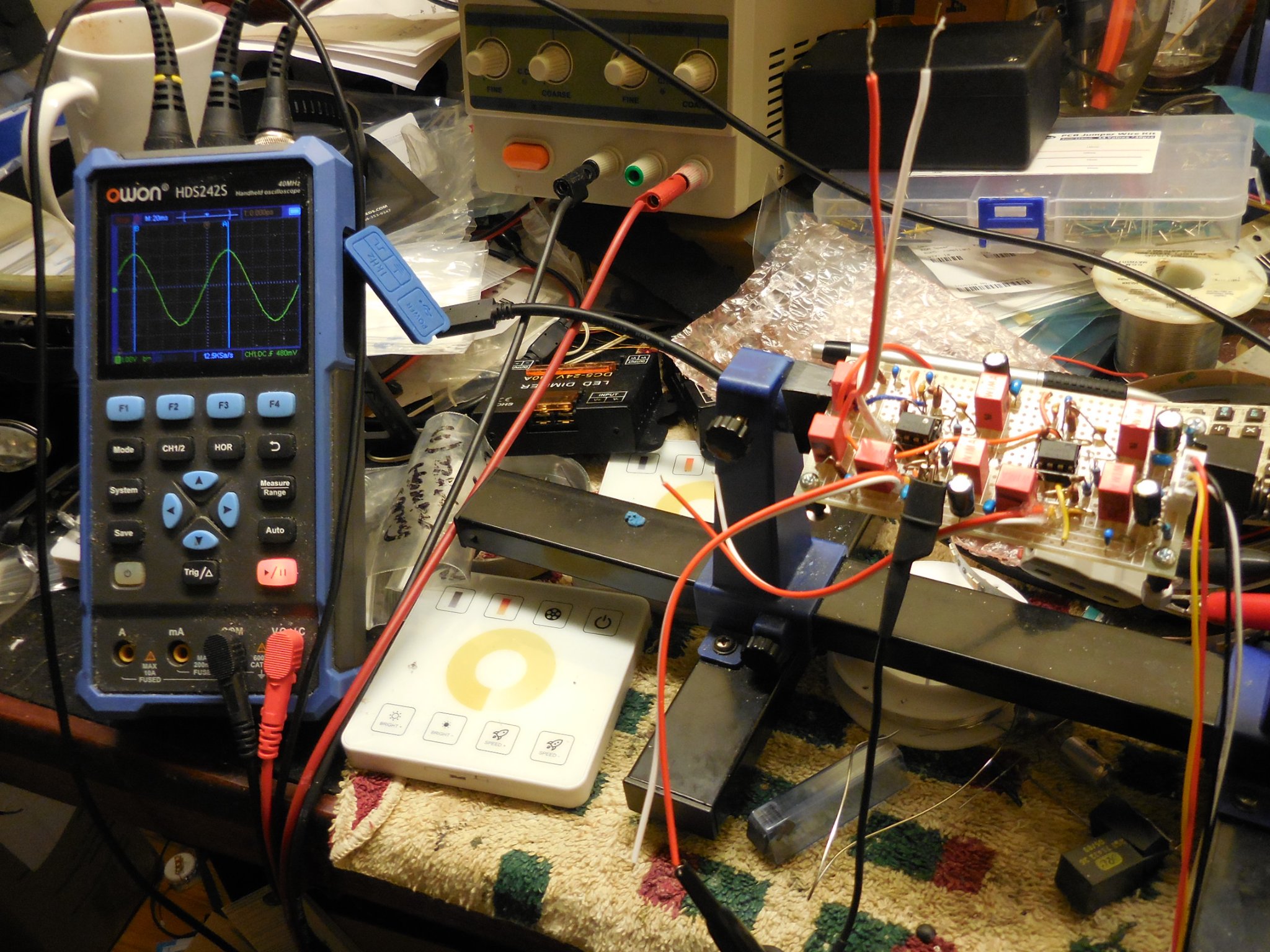

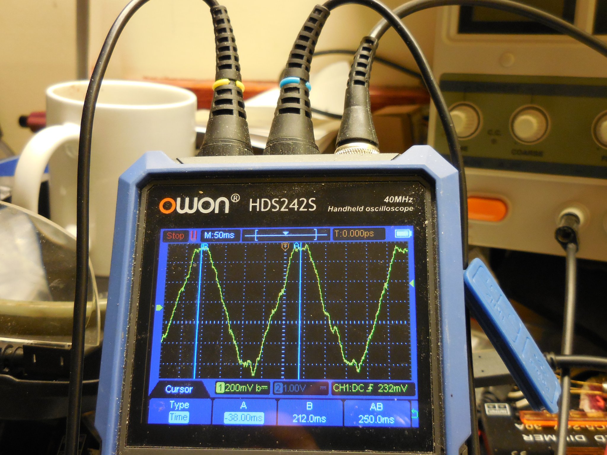

After two days, I have some results of FR bench testing for the accepted Marcel Marvel design for an OPA627 w/ 3rd order hi-pass Fc = 16Hz and 46dB 1KHz gain. Lacking the right gear this manual data gathering was tedious at best. But later, once all done I looked and compared my numbers with RIAA numbers and I must say they are quite close. So this attached graph is believable but not the Bible. It's a best effort, staring at a scope face and adjusting cursors. But I was careful. I made some NOTES and a few footnotes and some extended readings that didn't fit on the paper, FYI. I will be enclosing the card and wiring the "box" tomorrow b/c there is a great deal of other stuff on my scope.
Also attached are screen photos of the EQ's response with very low freqs. Pics of 8Hz, 6Hz and 4Hz are show as in how they degrade.

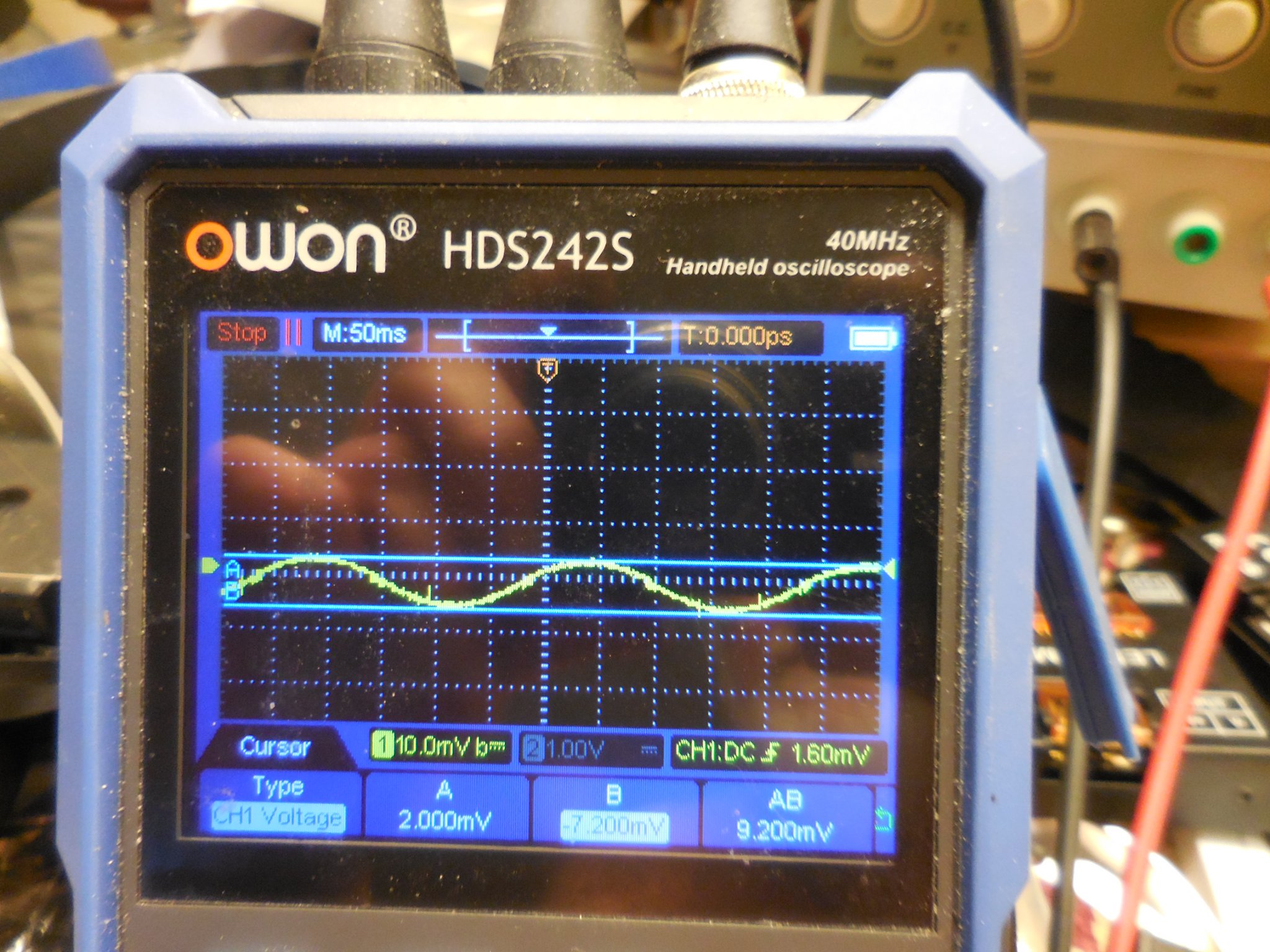

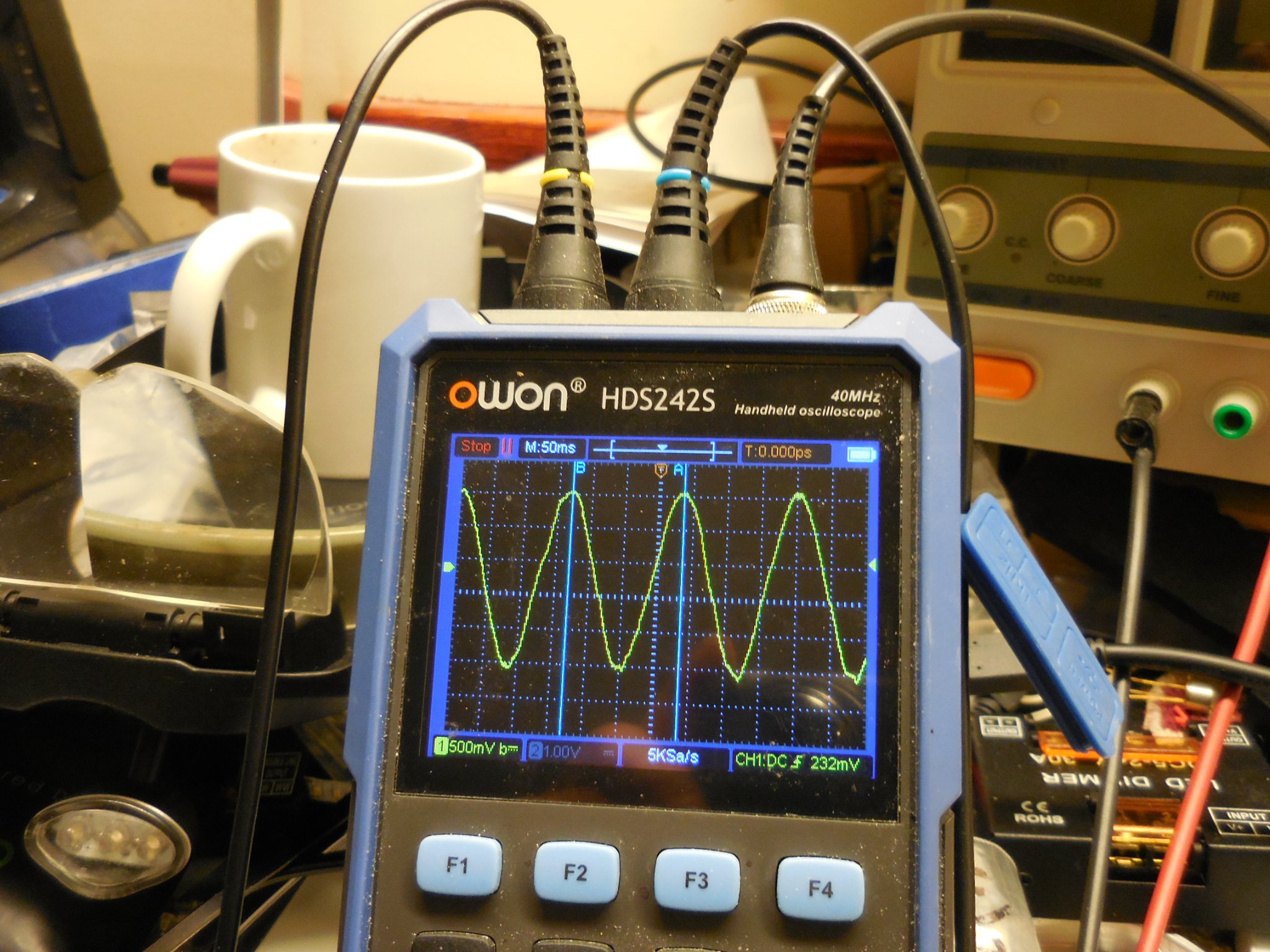

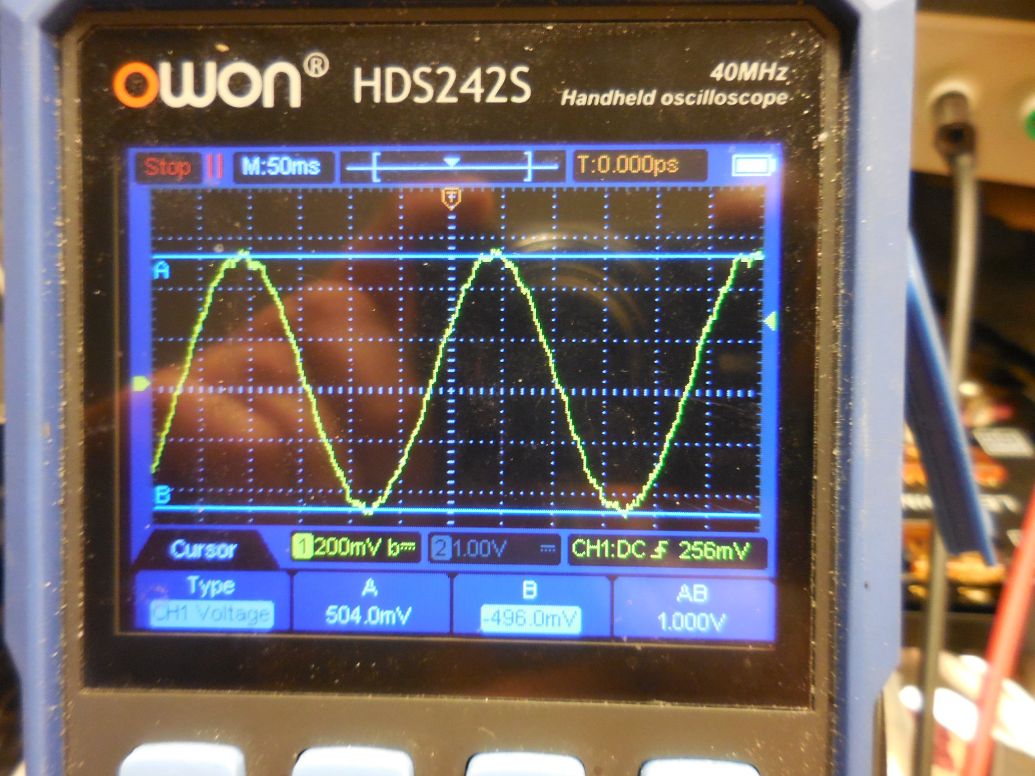

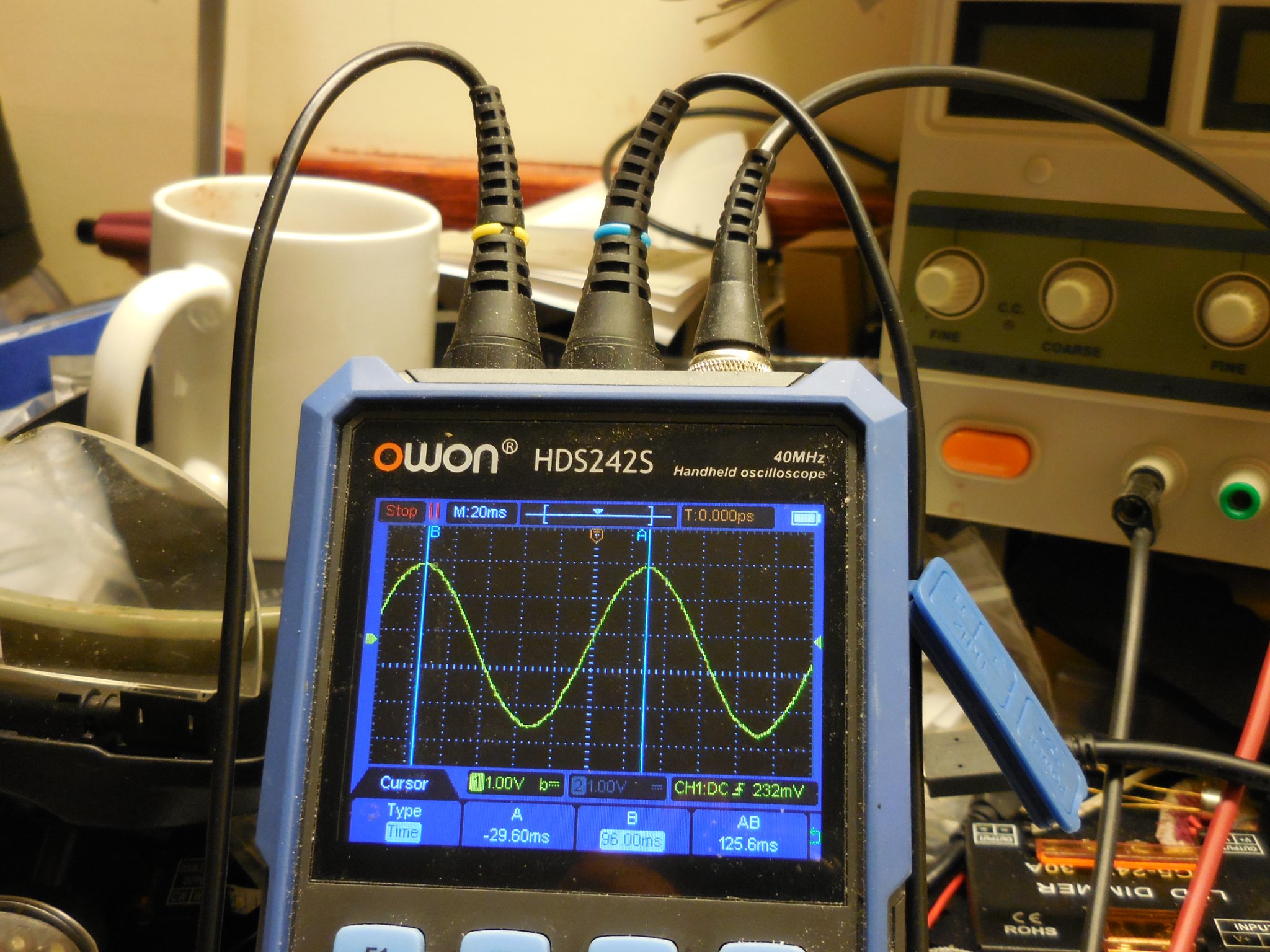

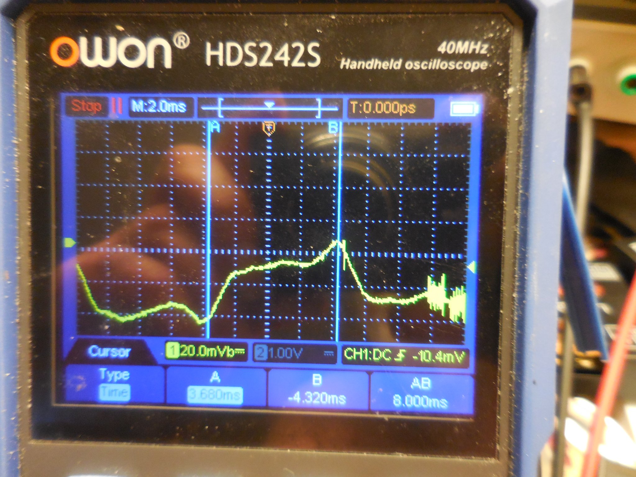

If the output signal of the signal generator is not perfectly clean, you will see a distortion increase at deep subsonic frequencies because the fundamental gets suppressed more than its harmonics. It's a digital generator with a DAC; does the 4 Hz waveform improve when you set the generator to (for example) an 11 times larger level and put an 11 times voltage divider between the generator and the amplifier input?
I built a supposed to be 11:1 divider from 5% 3K9 and 390R Rs. Acted more like 10:1. I set the sig-gen to 90mV so there's pic of that 4Hz waveform across the divider. There's a pic of the 9.2mV input waveform across the 390R. The one of today's 627 4Hz output is much better than last night's. And there are pics of 627 2Hz, 1Hz and a blown-up section of the chatter which shows an 8mS component so probably 60Hz crap. The 2Hz is ~500mVpp and the 1Hz is~70mVpp.
If I did this with my bigger-boy gear things might have looked cleaner. More to come with that setup when I get finished. Hope this helped some.

Did you frequency compensate the resistor divider? Otherwise traces may look cleaner because you created a LP filter, although it probably wouldn't attenuate too much given the low values of the divider resistors. What's the input capacitance of your scope? Does the scope's calibrator output look like a good square wave?
At 4 Hz? You need microfarads of parasitic capacitance then.
I suspect that JRA's digital signal generator attenuates the signal digitally when you set it to a low signal level, causing increased quantization distortion. Increase the generator level and attenuate its output and you have less quantization distortion.
I would not know how to compensate a resistor divider, so no, did not. 1 MΩ±2%, in parallel with 16pF±10pF. Square wave looks perfect. I did not have the scope attached to the input for the OPA627 output captures. The 4 => 2 => 1hz progression required increasing the scope's input sensitivity so everything got exaggerated including the much higher-frequency fuzz which I think turns out to be 60Hz riding on 4Hz or 2Hz or 1Hz with the scope's gain cranked up b/c the HPF is doing its job as the freqs go down. I'm not worried.
