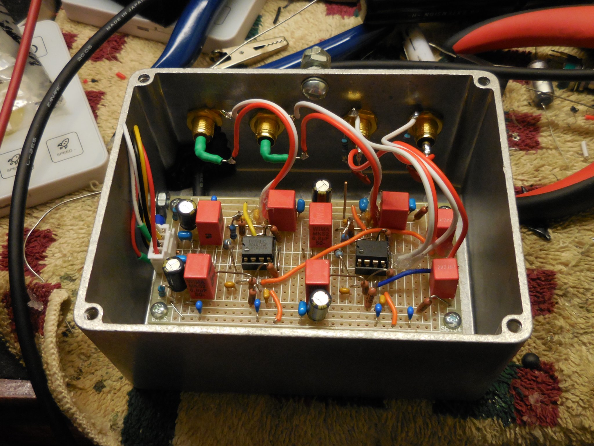

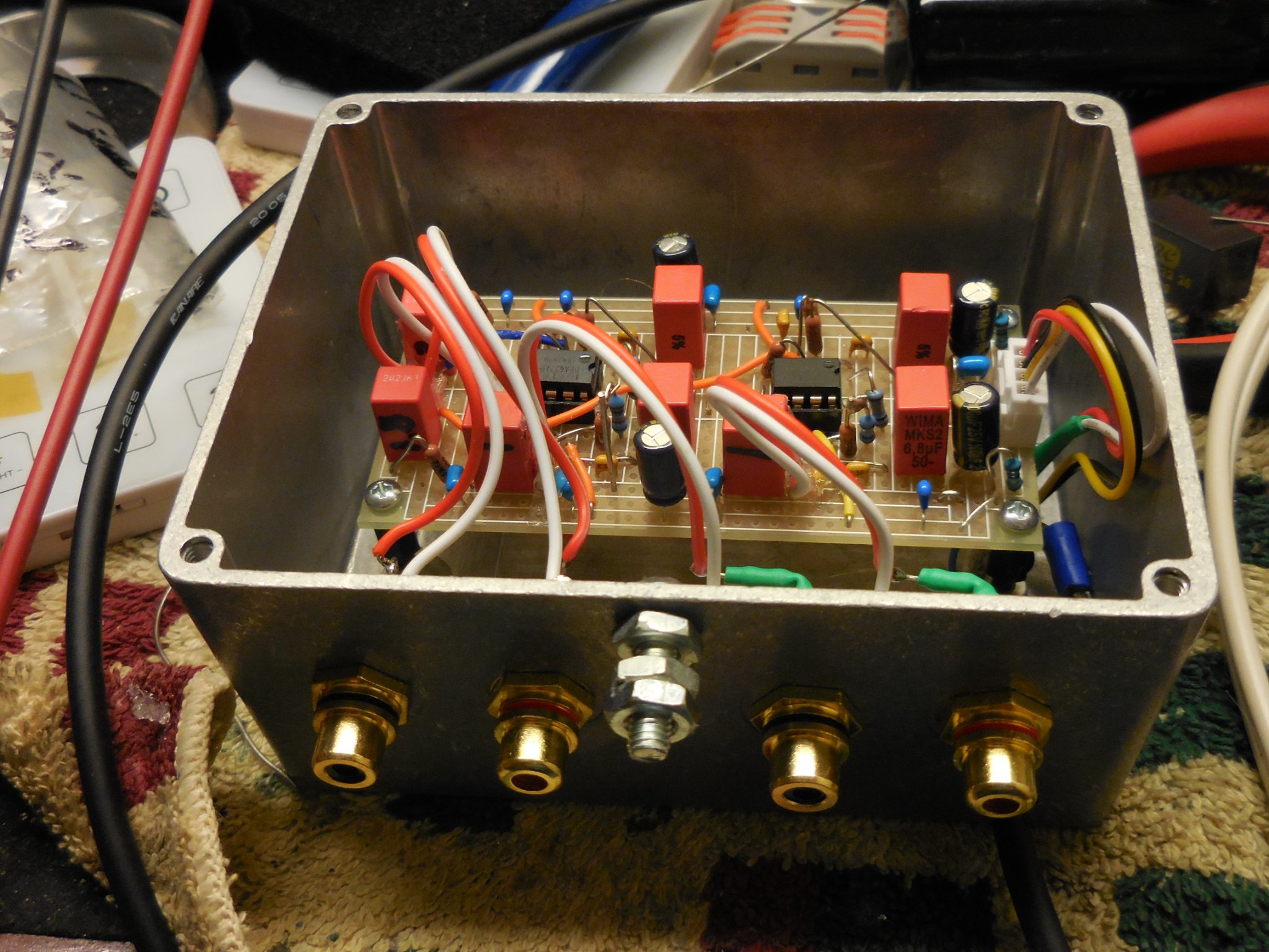

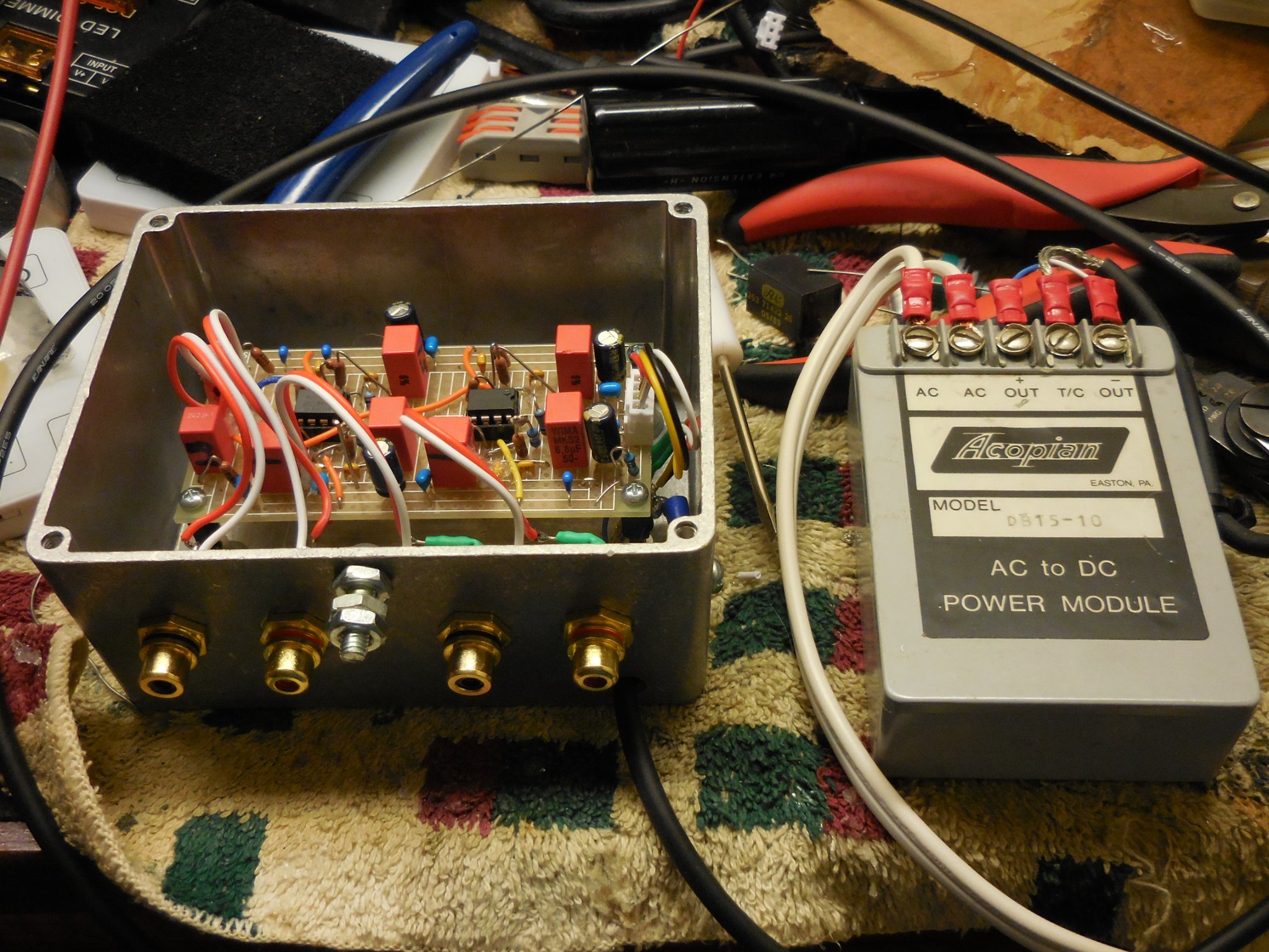

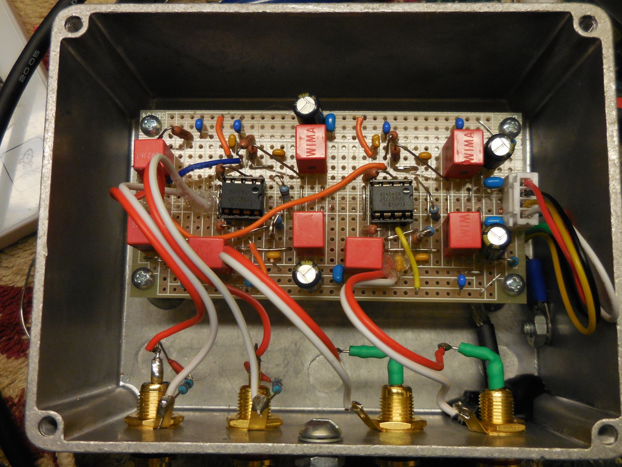

The box is done now sans the lid and probes are on the RCA outs. Whats there is a very clean and steady 50KHz sinewave with hash flying across the screen. The 50KHz signal gets much stronger (mV increases to 10s of mV) as I lift the lidless box up towards the bench's fluorescent tubes. The input RCAs are unterminated so all this is very prelim and not to get exited about. See attached pics as of today and a CORRECTED layout diagram from Post #506.
  • The board layout - CORRECTED 3-20-25.pdf
Reactions: Chris Hornbeck

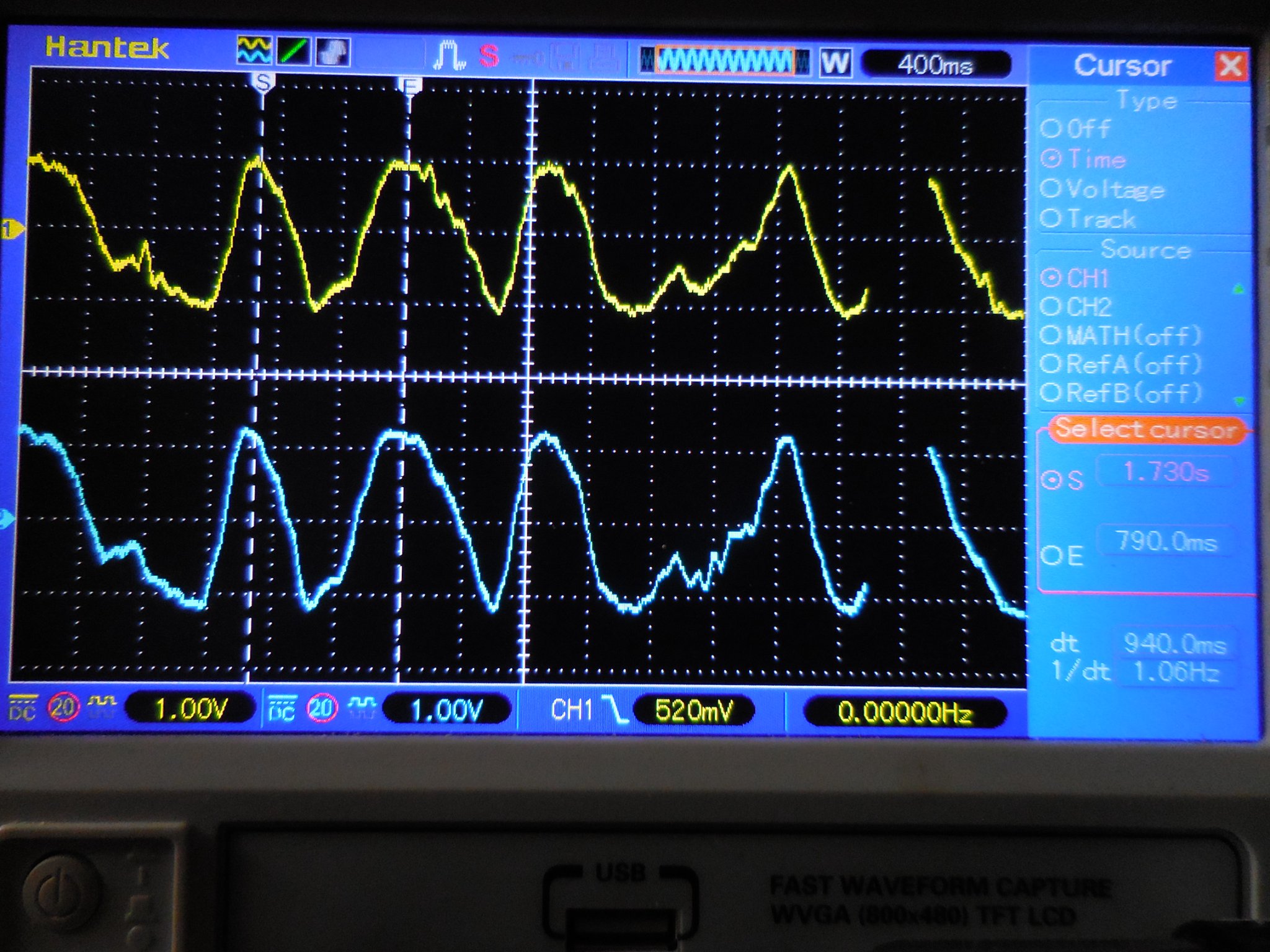

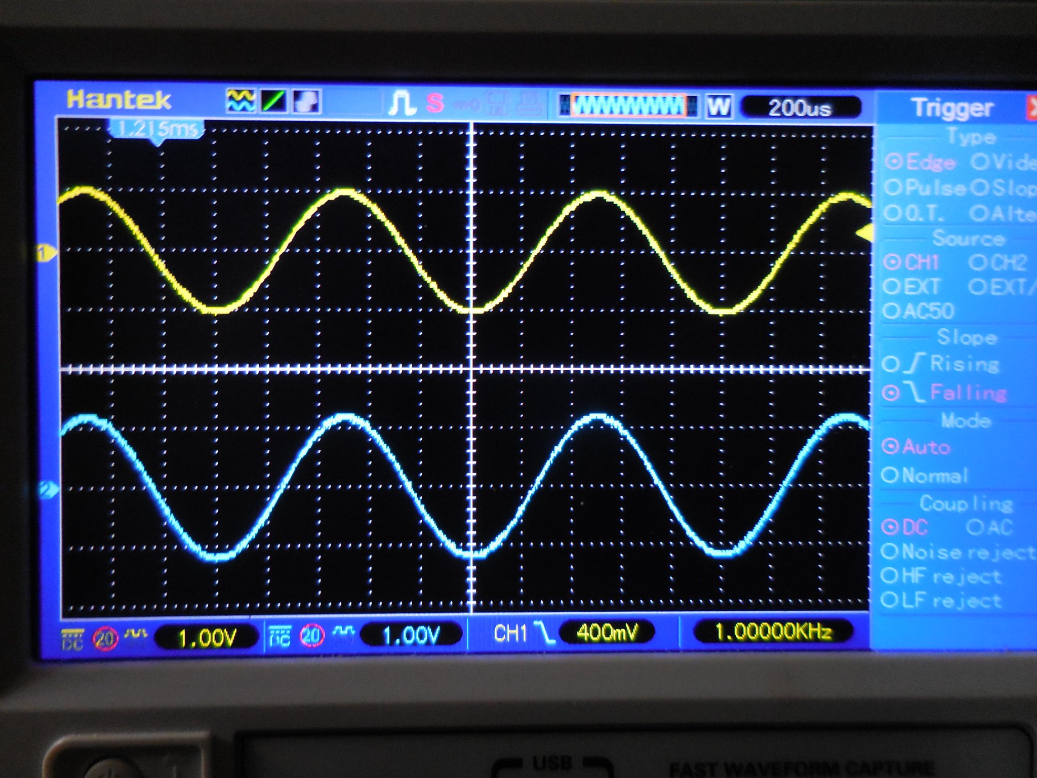

I have something to report re the Marvel phono preamplifier. Today with a new cart I started the setup rigmarole with the Analogue Productions test LP, side 1, track 1, 2 and 3 designed for chan/chan balance and crosstalk/separation using 1KHz as the signal. Track 1 puts equal signal on both L & R groove walls.
See AnalogProd S1-Tr1 - which looked clean but the scope could not lock-up the trace. It was dancing a bit like there was something else going on.

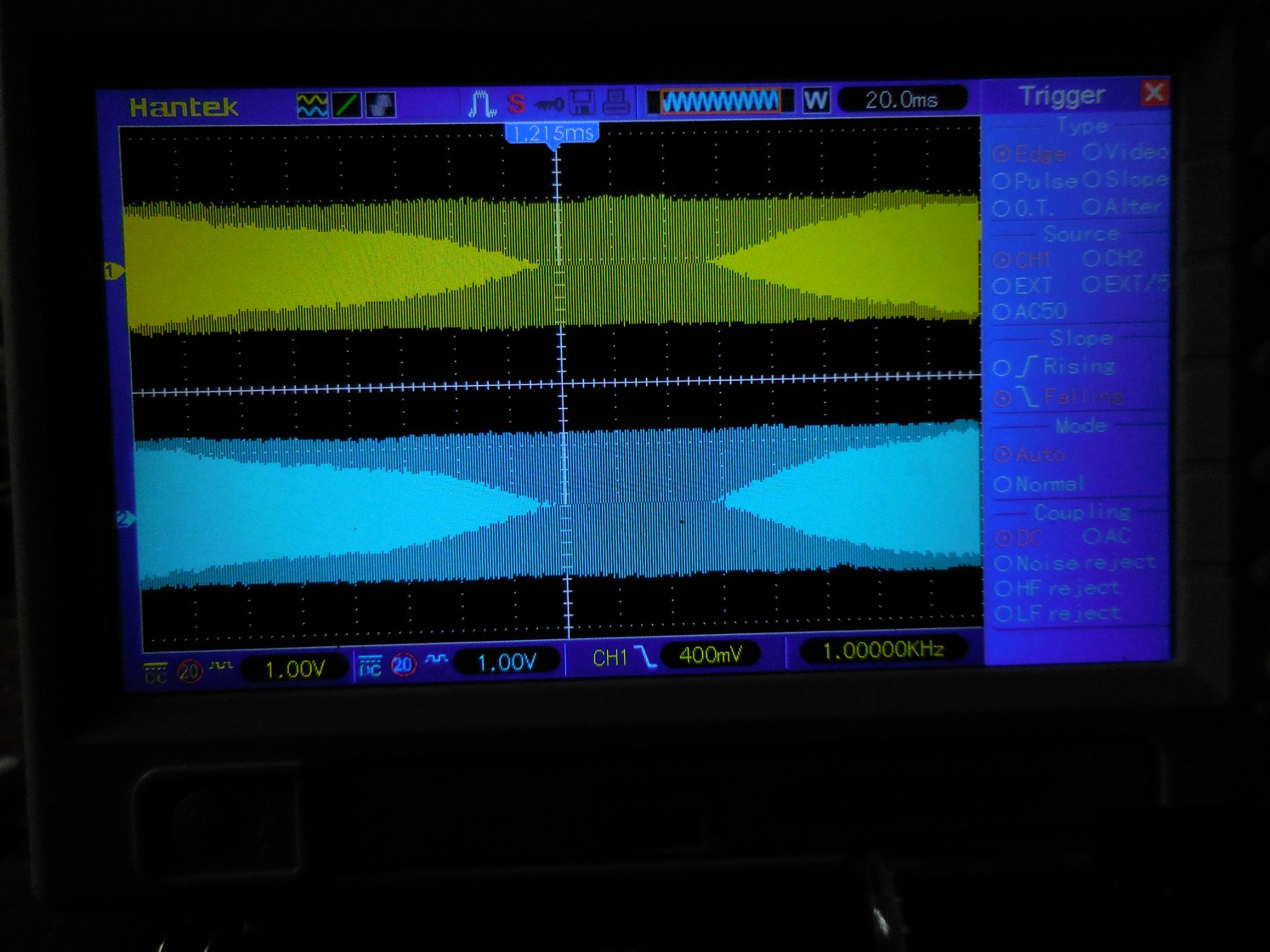

See 20mS-Div - which when the sweep was slowed from 400uS to 20mS revealed a possible 2nd signal mixed in.

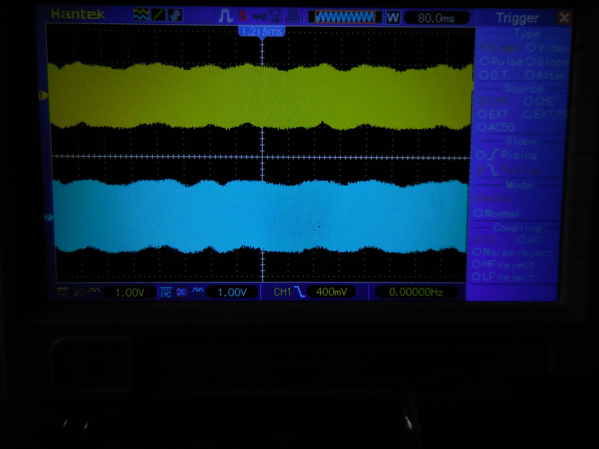

See 80mS-div - which looks like the 1KHz from the LP is being modulated onto or by a lower frequency carrier.

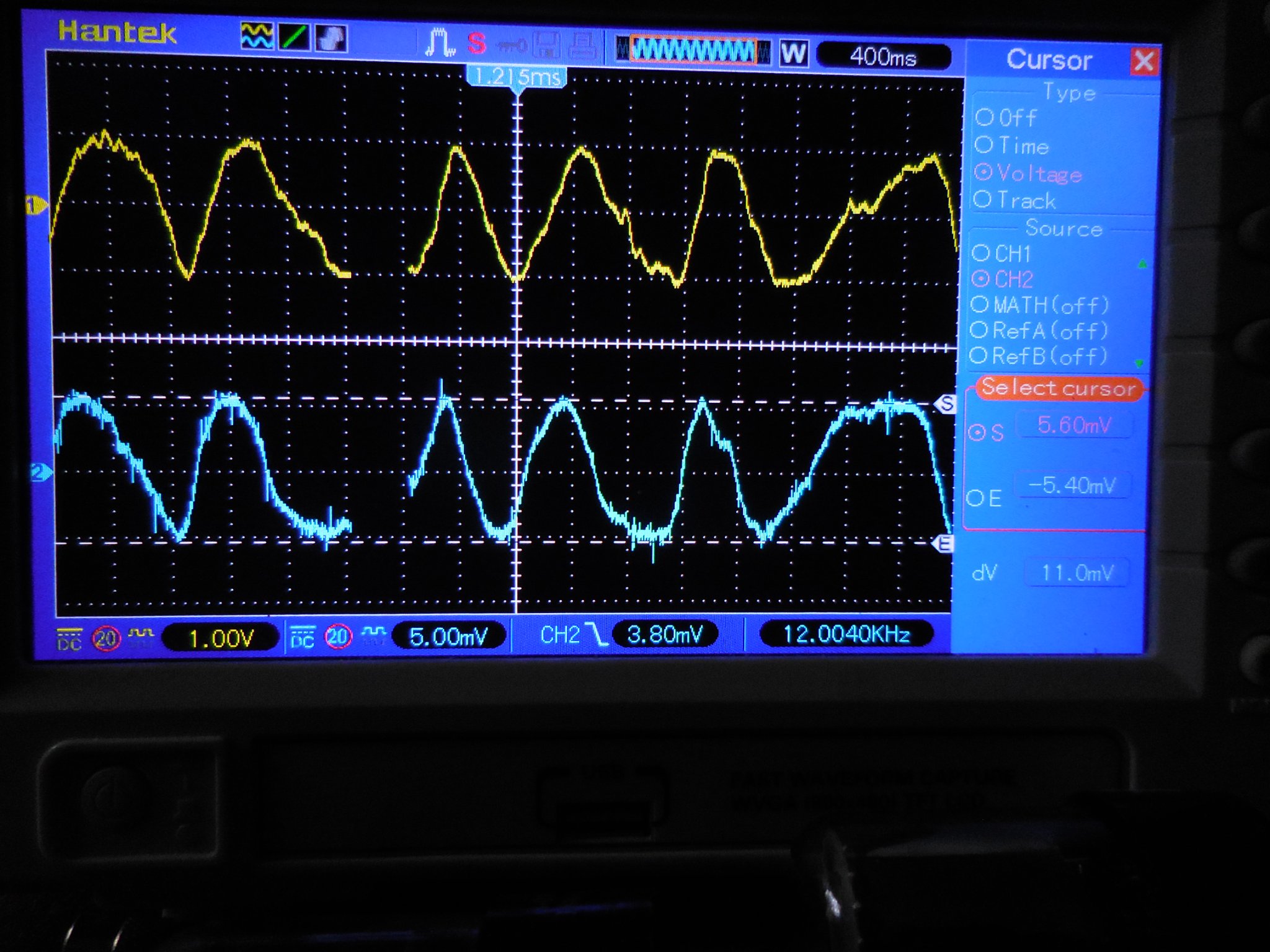

See 400mS-div - which is the 1Hz ghost in the deep background. Track 1 is still playing, the 1KHz tone can be heard but there seems to be a warble.
This 1Hz phantom goes completely away when the needle is lifted (cart outputs shorted) or when on the arm rest (cart outputs = normal play mode). Scope shows a flat line at 5mV/div.
I believe I saw this when I did my first bench testing using a sig-gen and scope combo but attributed any funny stuff to the bench environment. Now I don't know. What could this be caused by? Marcel? Help please.
Why don't you see the 1 kHz component on this plot? What is the oscilloscope's sample rate for the various plots?
Unfortunately, I haven't a clue what is going on. You could get a pretty bad resonance when R7 is missing or not connected, but it should be around 16 Hz rather than 1 Hz.

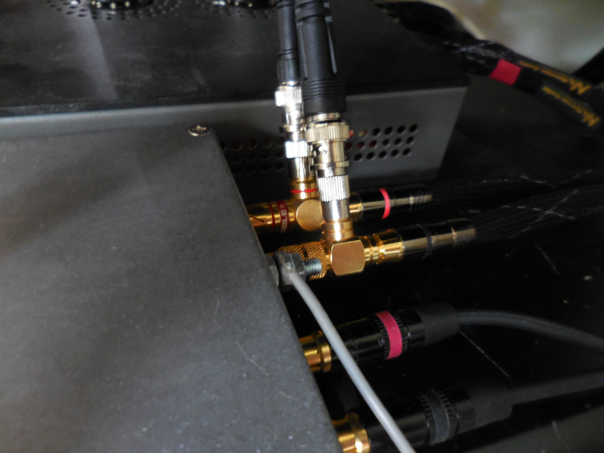

Is 1 V on the scope 1 V in reality or is there a probe attenuation to be taken into account?
Is R6 properly connected?
This will probably not change anything, but if you haven't already done so, you could add an extra decoupling capacitor (100 nF X7R or so) straight from pin 7 to pin 4 of each OPA627. With the present decoupling, there is a rather big loop from the positive supply pin via its decoupling capacitor and three ground traces through the decoupling capacitor of the negative supply pin to the negative supply pin.
Record warp / eccentricity signal occurs (for 33rpm) at multiples of 0.55Hz - your waveform suggests 1.1Hz so this is likely warpage and eccentricity showing up - this is why a quality RIAA preamp has an aggressive high-pass filter "rumble filter" usually with a cut-off around 15 to 18Hz. The second harmonic is more likely to be warpage, eccentricity would be mainly fundamental.
However there are other ways subsonic signals can get in - perhaps there is subsonic acoustic noise in your area? Or less-than perfect platter geometry and bearing? Slipmat that's not super flat...
With a poor quality pressing these 0.55/1.1/1.65/2.2 etc Hz signals can damage (sub)woofer drivers if it passes straight through the amplifier chain un-filtered, especially in a ported speaker, causing high dissipation and end-stopping - even smaller amounts will inter-modulate in the driver with other wanted bass signals.
Rumble filters are often omitted phono preamps, I think they are an essential part of what a phono preamp should be doing. Something like a 4 or 6 pole Butterworth filter is an approach one can use with a single opamp. Bessel filters might be better behaved in the bottom octave, although less effective. I think either is reasonable, again about 15 to 18Hz cutoff is a reasonable choice.
The 400 ms/div waveform looks irregular. Shouldn't it repeat every 1.8 s (at 33.3333... rotations per minute) if it were due to warps or eccentricity? Left and right appear to be in phase, so eccentricity rather than warps then?
This specific phono amplifier has a built-in second- or third-order 16 Hz Butterworth high-pass filter. If I understand it correctly, JRA built the second-order version. The 1 Hz must be what is left after 48 dB of suppression from the subsonic filter then.
I do not know why the 1KHz just disappears when I switch to slower sweep rates. Same thing happens using a different scope. I do not know what sample rate is used for either scope at the time of the scope shot.
R7 and R70 appear to be there, in-place.
The scope shots are with input = 1:1, direct in using BNC - BNC cabling. No "scope" cables and not 10:1. See hookup pic in #569
Yes, the vertical aspect is correct. 1V = 1V
R6 and R60 look good.
See attached

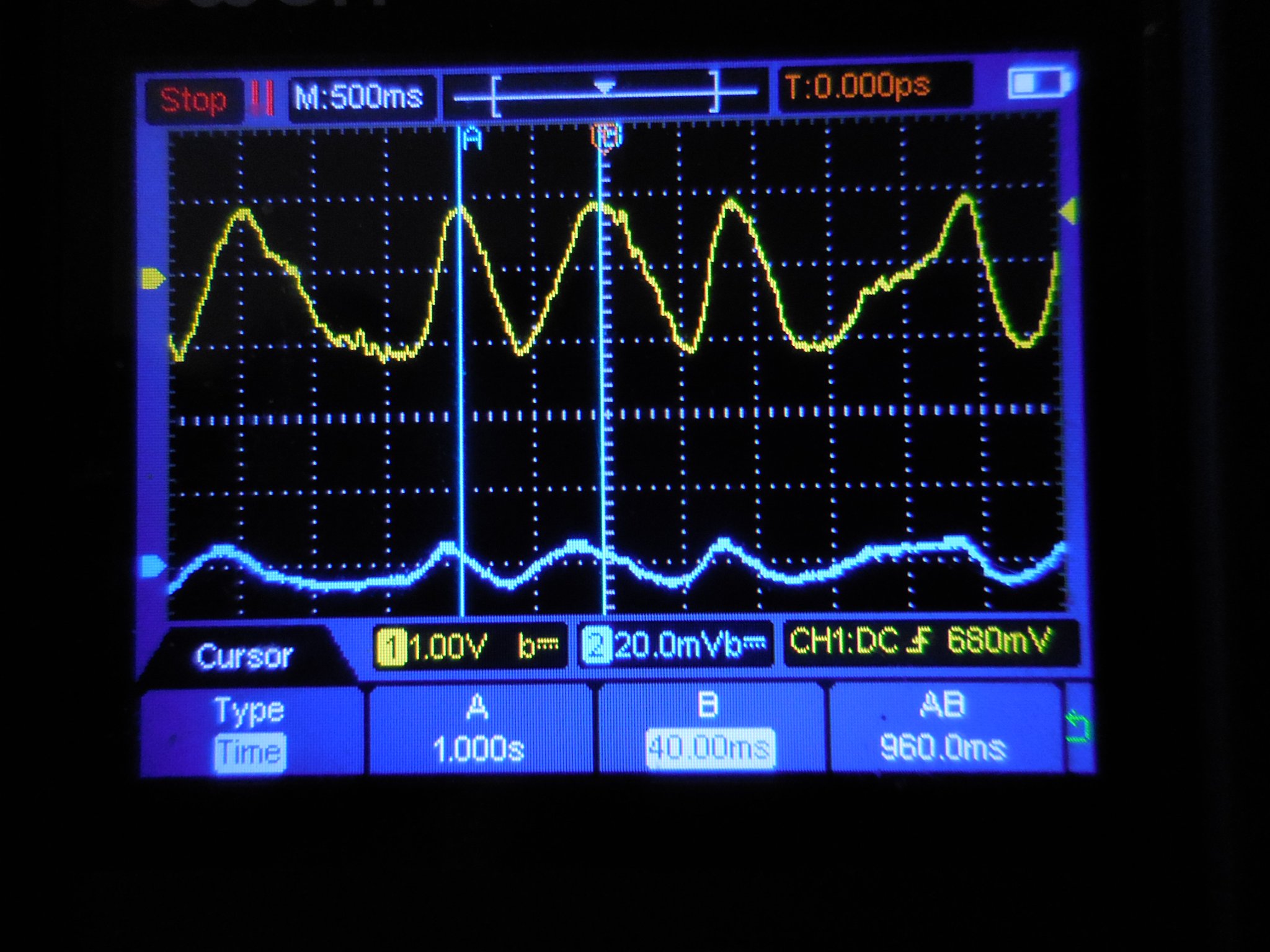

- Hantek scope: Yellow = Right chan Output during test LP 1KHz track 1. Blue = Right chan cart Input. They are the same. The 1Hz appears to be generated by the MM cart. 11mV in from cart and 2V out from preamp = 45.2dB = about right.
- Owon portable scope: Same thing as above at 500mS/div; in-phase, same voltages and same frequency - just a hair over 1Hz.
Both In or Out scope traces go flat between tracks as in no warp. Flat in the inner dead wax spiral as well.

I think the 400 ms/div plot from post #569 simply shows aliasing of your digital oscilloscope. The 1 Hz signal is just as large as the desired signal of the 200 us/div plot, as you would expect when it is an alias. If this hypothesis is correct, then slightly changing the turntable speed should change the frequency of that 1 Hz signal a lot: a 0.1 % speed change should change it by 100 %.
This doesn't explain the dancing of the signal at 200 us/div. Maybe that's some rumble that still comes through.
With C2 = 2.2 uF and R7 = 1.07 Mohm, the roll-off is second-order Butterworth. With 150 nF and 1.58 Mohm, it's third-order Butterworth.
Well first off I don't know what aliasing means in this context. I've never seen a scope misbehave like this, ever. Second thing is that my original TI/1656 preamp design I built in 2021 showed-up the same exact way with the weird 1Hz signal with slow sweep rates. No different. And it now has a standard S-K 3rd order hi-pass bolted to the front end.

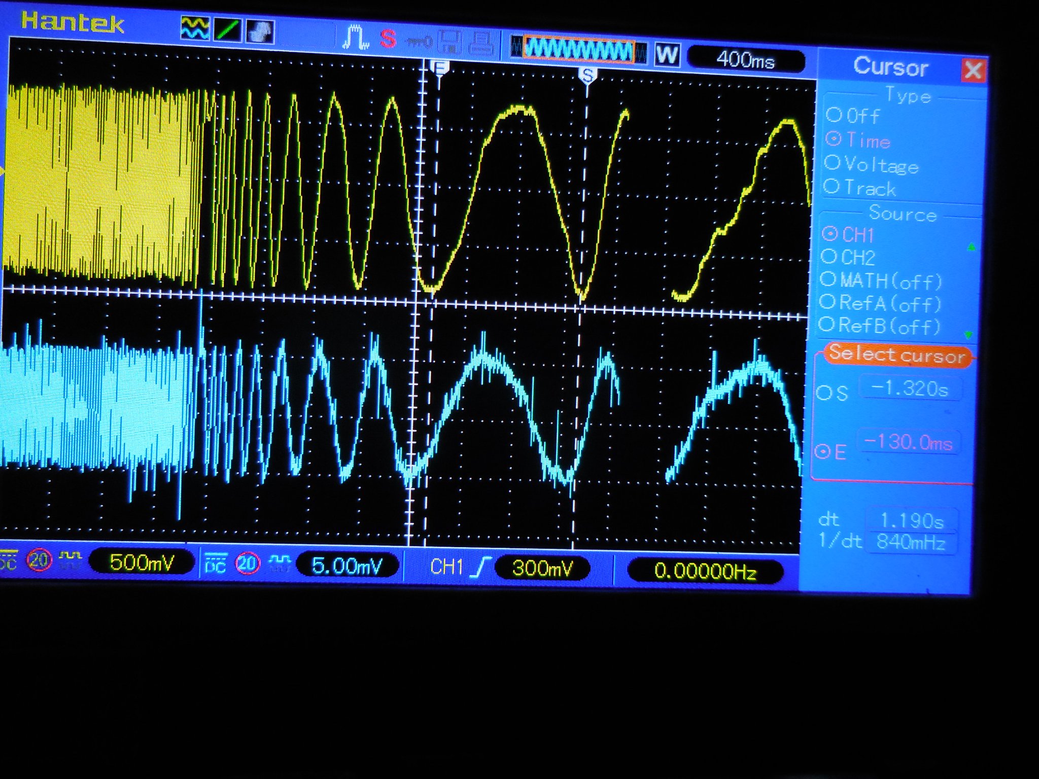

Attachement:
- Yellow on top = 1kHz LP test signal Vo from original pre. Left 1st quarter of screen = turntable slowed. Remaining screen = TT resuming speed.
- Blue on bottom = 1KHz LP test signal from cart. Ditto.......
Unbelievable! So you were right again Marcel but WTF does this all mean? Is it an artifact of the sub-sonic hi-pass filters used in both preamps? Same artifact showing up in two different scopes?

Relax and enjoy the music? The large 1 Hz signal you saw was just a measurement artefact, and per post #563 point 3, the subsonic filtering appears to be sufficient for normal use.
The fact that you haven't seen aliasing of a digital oscilloscope before means you have been lucky up till last Friday. They all sample and they never have anti-aliasing filters, so you can always get to see something at the difference between the signal frequency and the sample rate rather than at the signal frequency. For that reason, a now retired colleague of mine used to look all over the lab to see if there was still a good old analogue scope left somewhere when he needed to measure something with an oscilloscope.
