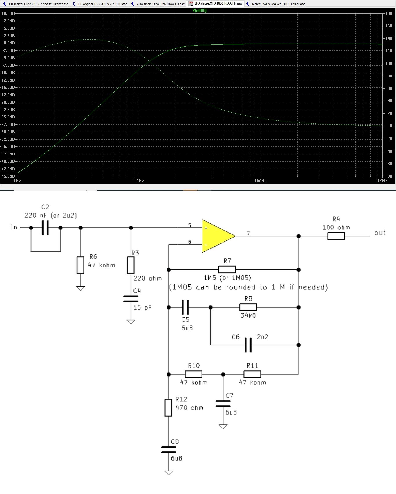

Maybe a bypassing pin should be worth installing alongside the cap. Easier to see the results with and without cap.
Attenuation @ 3Hz, which is the point I'm interested in, is just -28dB without bypass and -30dB with bypass, which I would consider negligible.
They move down, as it should, when using a 220n input cap, going to -43dB @ 3Hz. But I wonder what else is affected.

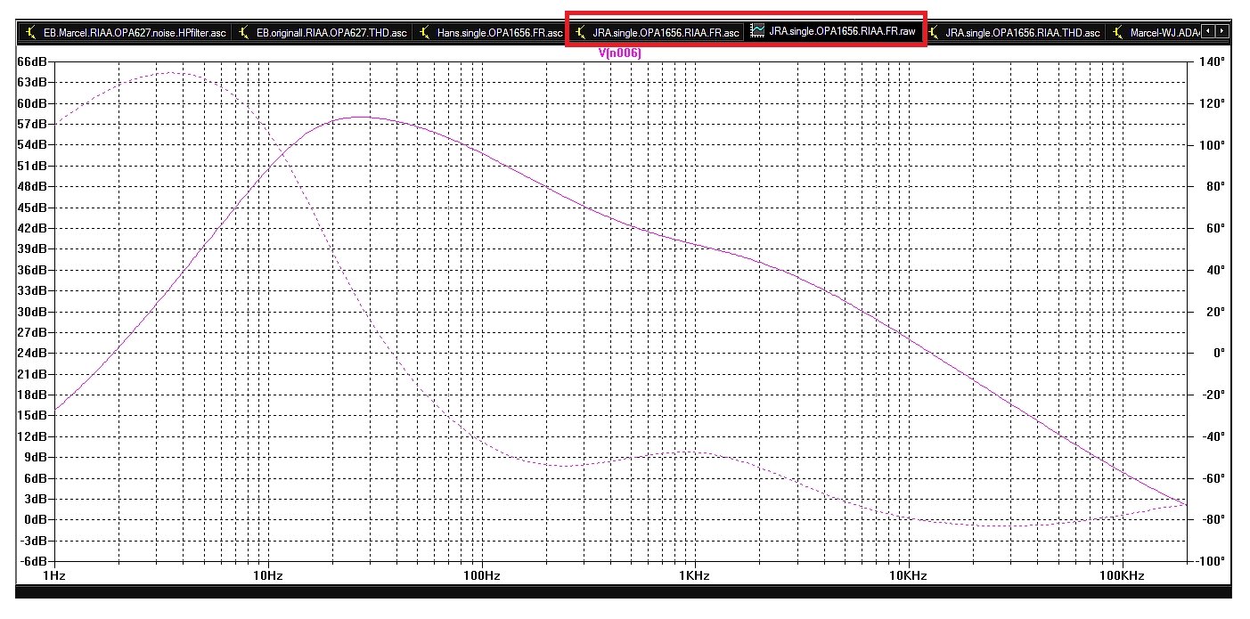

This is what my sim shows as input HP with no filter.
Is it what it should be, Marcel?
Yes, that looks about right.
Well not really. Schematically it's correct but the 0dB line is not right. You have to remember that @20hz the gain is officially up by +19.3dB from that of the mid-band, 1kHz, 40dB, aka 0dB. So, for example @3Hz you are not rolled-off by 28dB. You are down -28dB from +19.3dB or about -8dB wrt 1kHz.. You are showing 0dB as +19.3dB. If you harmonize my proto's FR graph with your numbers they pretty much agree at or near 20Hz and below - if you correct by ~20dB. Or have I misunderstood something..? Perhaps your graph is a RIAA variance graph?
I assume that @carlmart applied a reverse RIAA correction somewhere in his simulation and normalized everything to 0 dB at 1 kHz, so that you only see the high-pass transfer. If this were the transfer of the whole circuit without inverse RIAA correction or normalization, it would be very wrong: no gain, no RIAA correction.
Second order with shorted input capacitor and about 40 dB of gain at 1 kHz, according to the schematic of post #588.
JRA's should have twice the gain, and as long as the input coupling capacitor is still there, it should not have the slight bend in the curve around 1 Hz.
No, I don't, but I do see that the subsonic part of the curve of post #590 is not entirely straight, it slightly bends at very low frequencies (order of 1 Hz). That's a difference between the measured and simulated curves, and it is as expected, it's simply the effect of the shorted input capacitor in carlmart's simulation.
