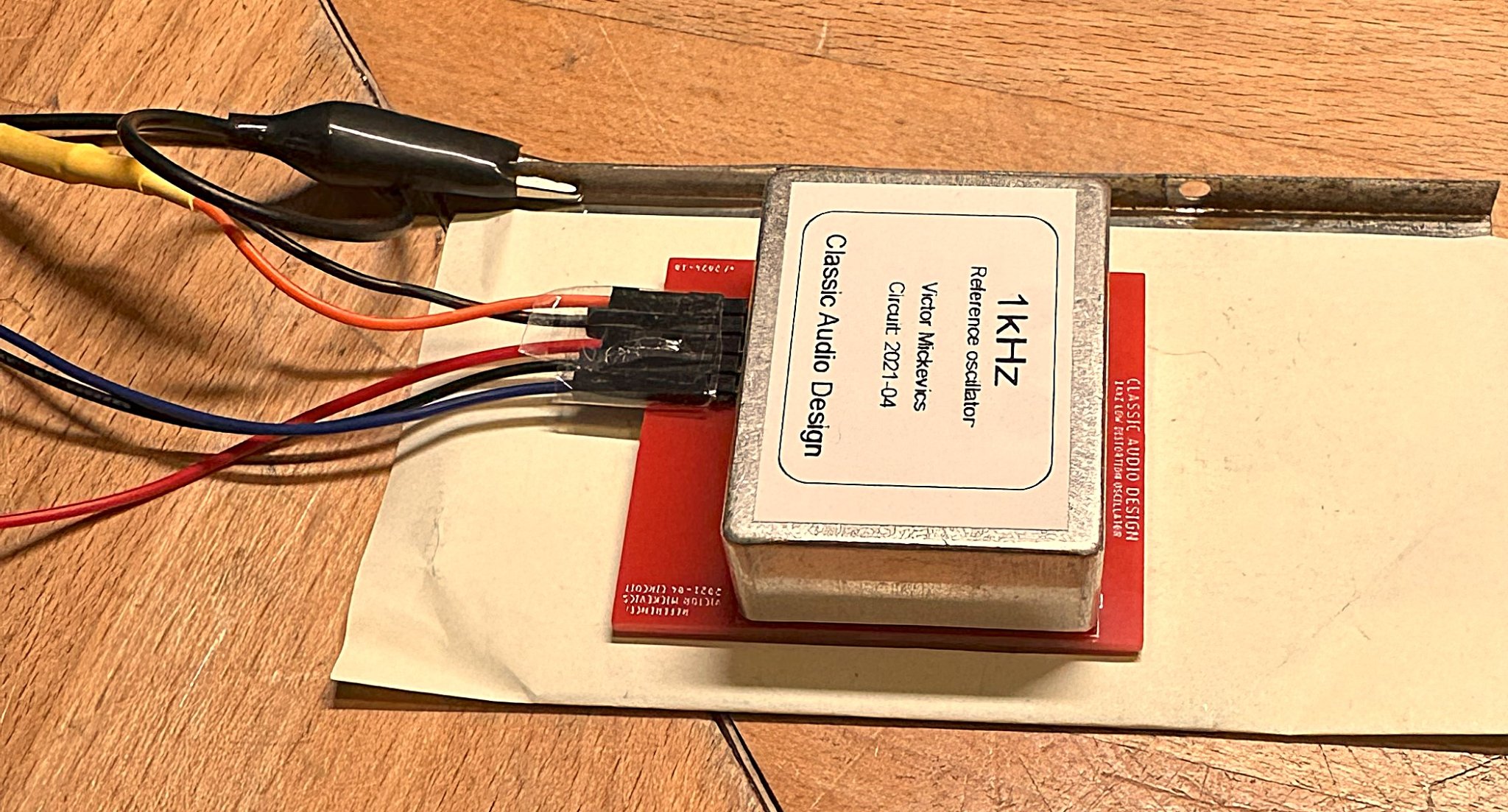

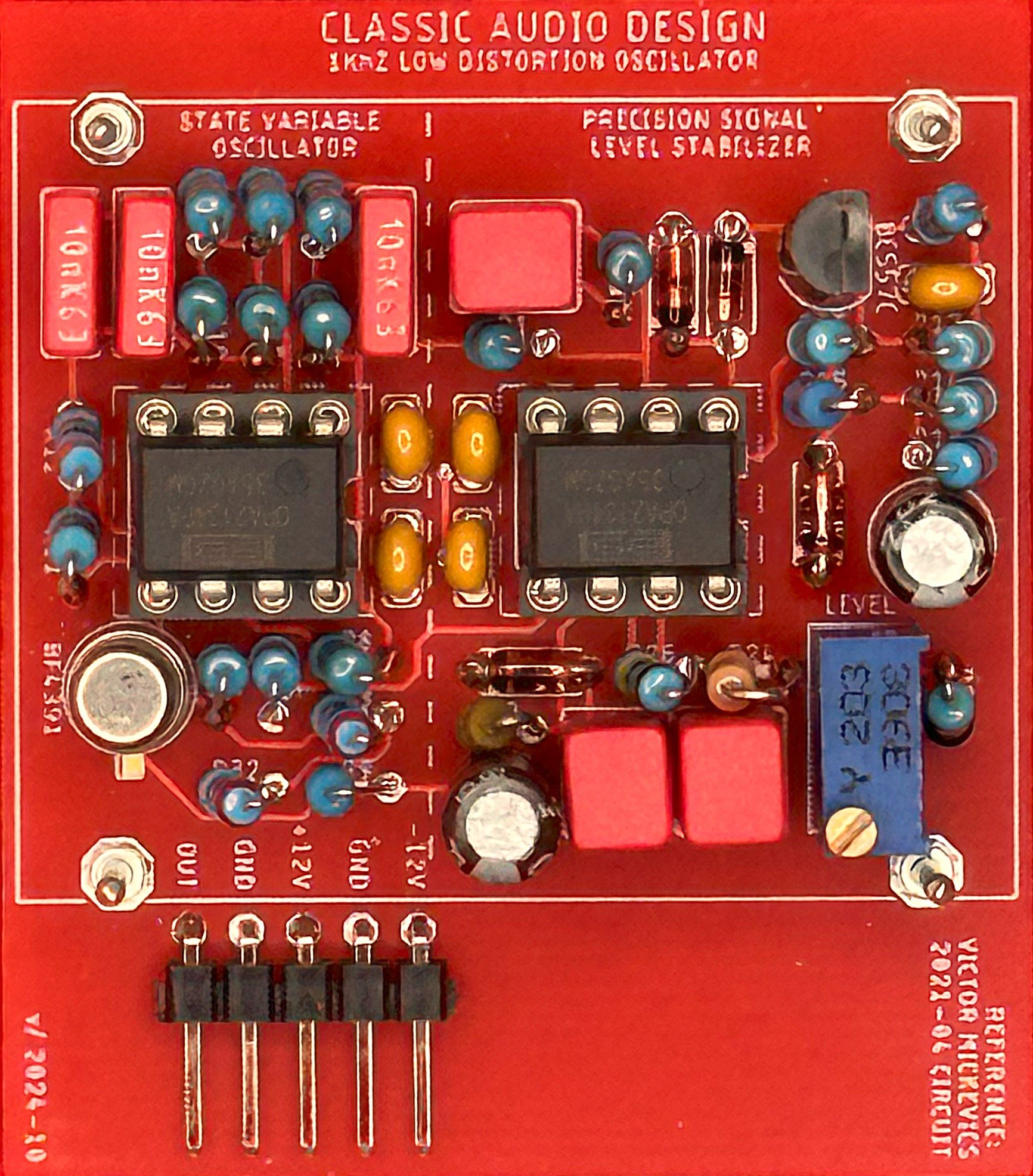

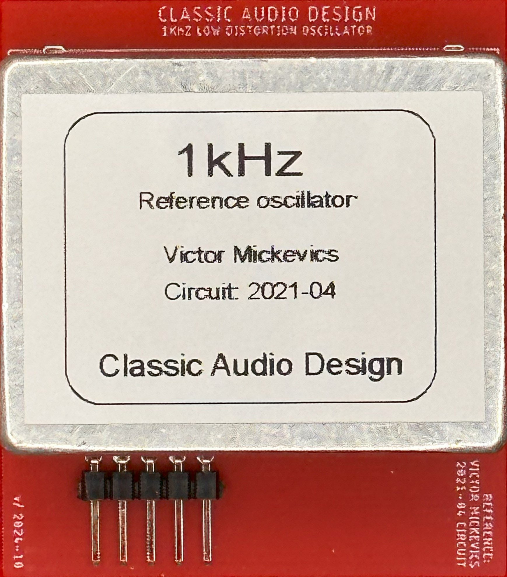

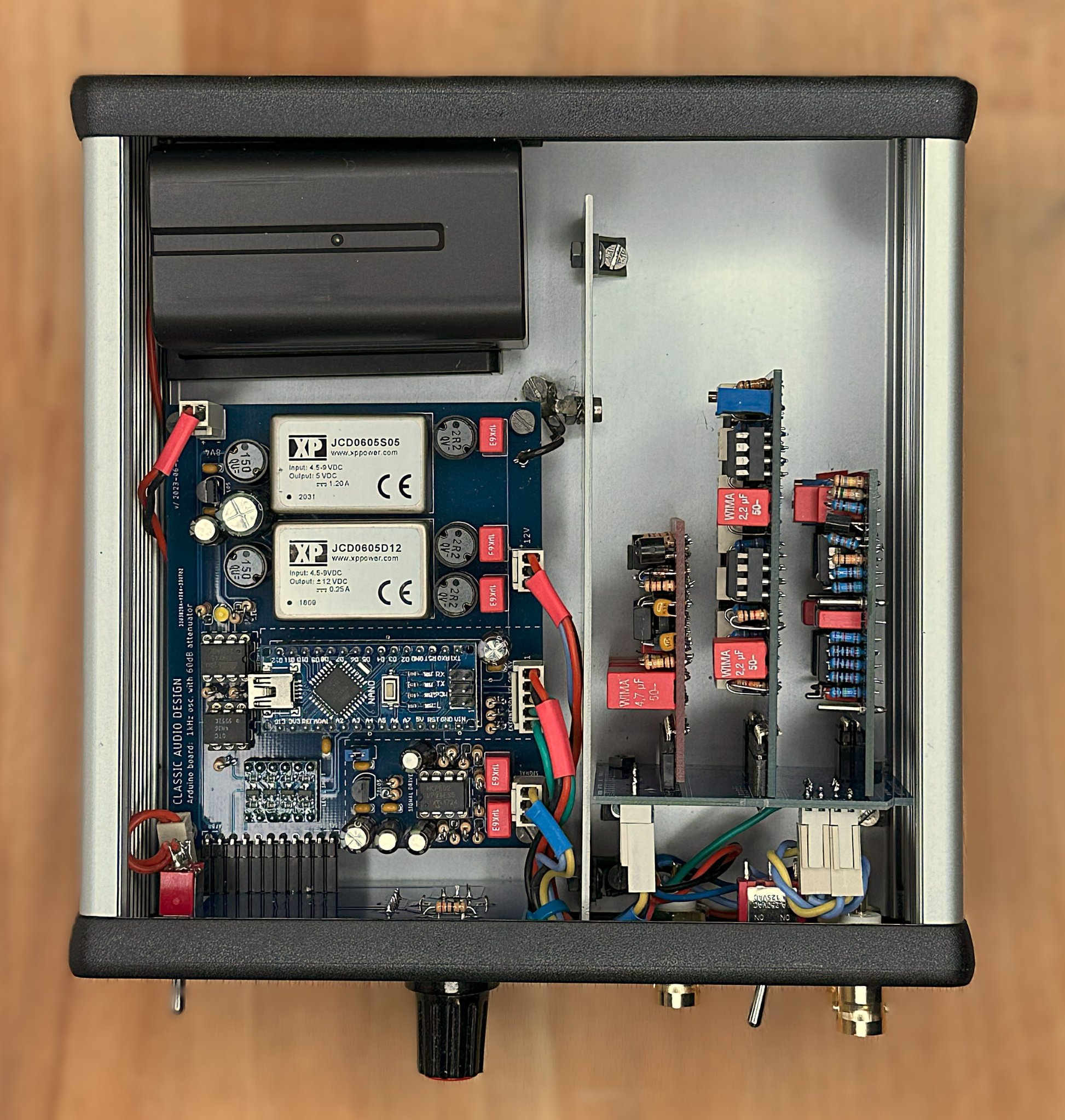

This is my version of Victors 1kHz oscillator.
I must explain, my design is with leaded parts, because I cannot design with surface parts because of my eyes.

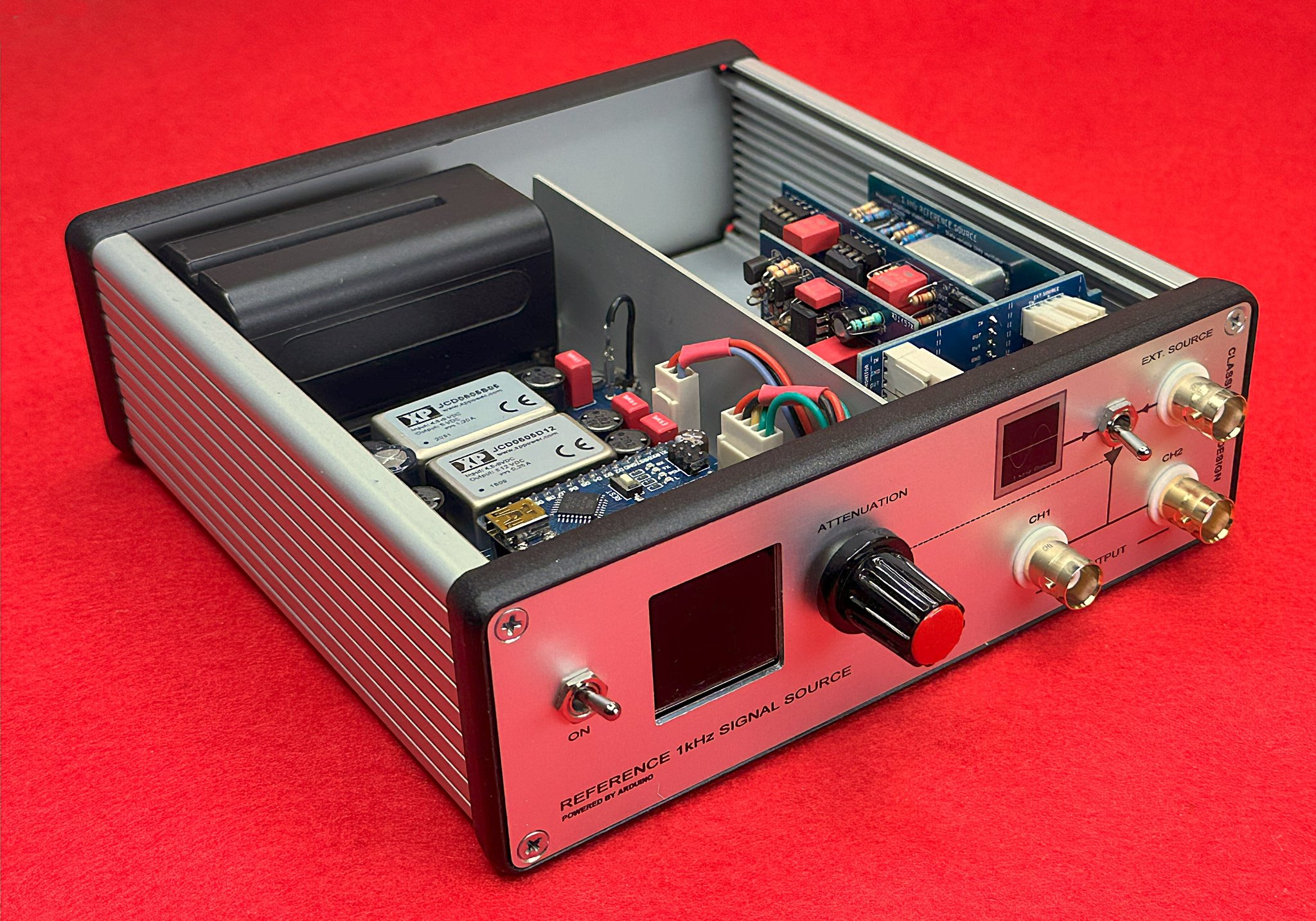

I plan to use the 1kHz oscillator in an existing design (see photo’s)
This is a 1 kHz ref. signal source with a 60dB attenuator (1dB step) and a dual output driver (very low output impedance). All is controlled by Arduino.
The 1kHz oscillator works great.
I have some difficulties getting the oscillator to start, but I received fast and good help from Vicnic.
The specification of my 1kHz version is not at level of the original Vicnic design, but I will later optimize according to Victors recommendations.

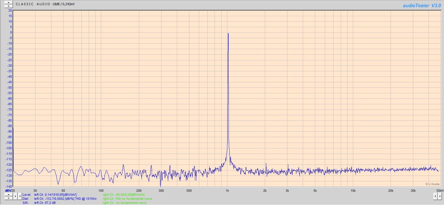

For you information ......... a couple of photo's of the system, my layout of the oscillator and the very first test results.

Hi Pizzigri,
I will absolutly not make a commercial project for any of my projects.
If anyone is interested I will be happy to share.

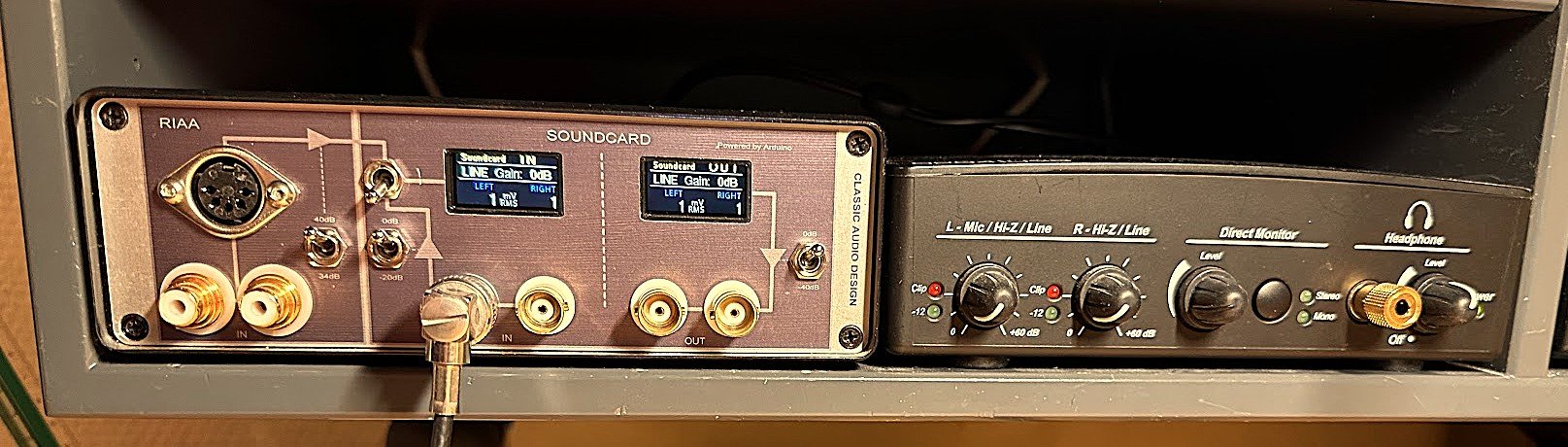

I have been using the setup of:
My own Soundcard interface - USB 0204 - Audio Tester - TrueRTA for more than 10 years (perhaps 20 years now)
Testing classic audio products like amplifiers - gramophones - FM receivers ect. in my small company Classic Audio.
I have now sold Classic Audio.
I have really a number of project for audio testing allready made with good documentation.
But I am not going to make any commercial project for any of the designs.
