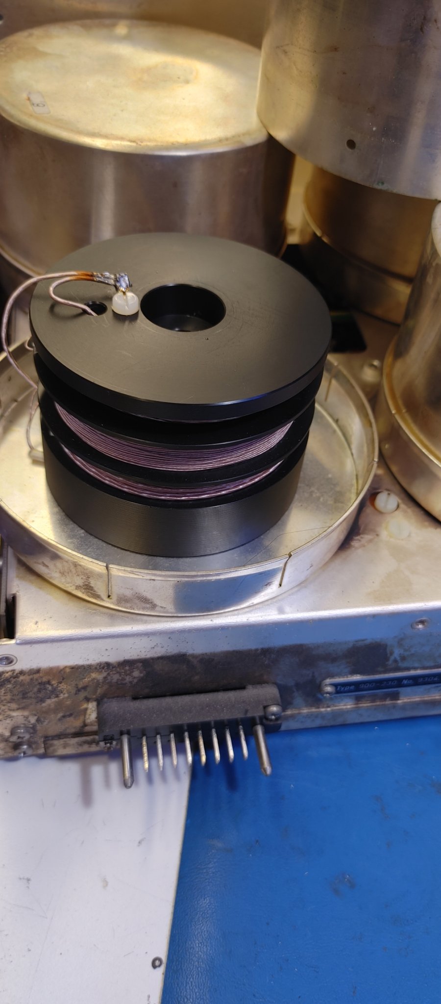

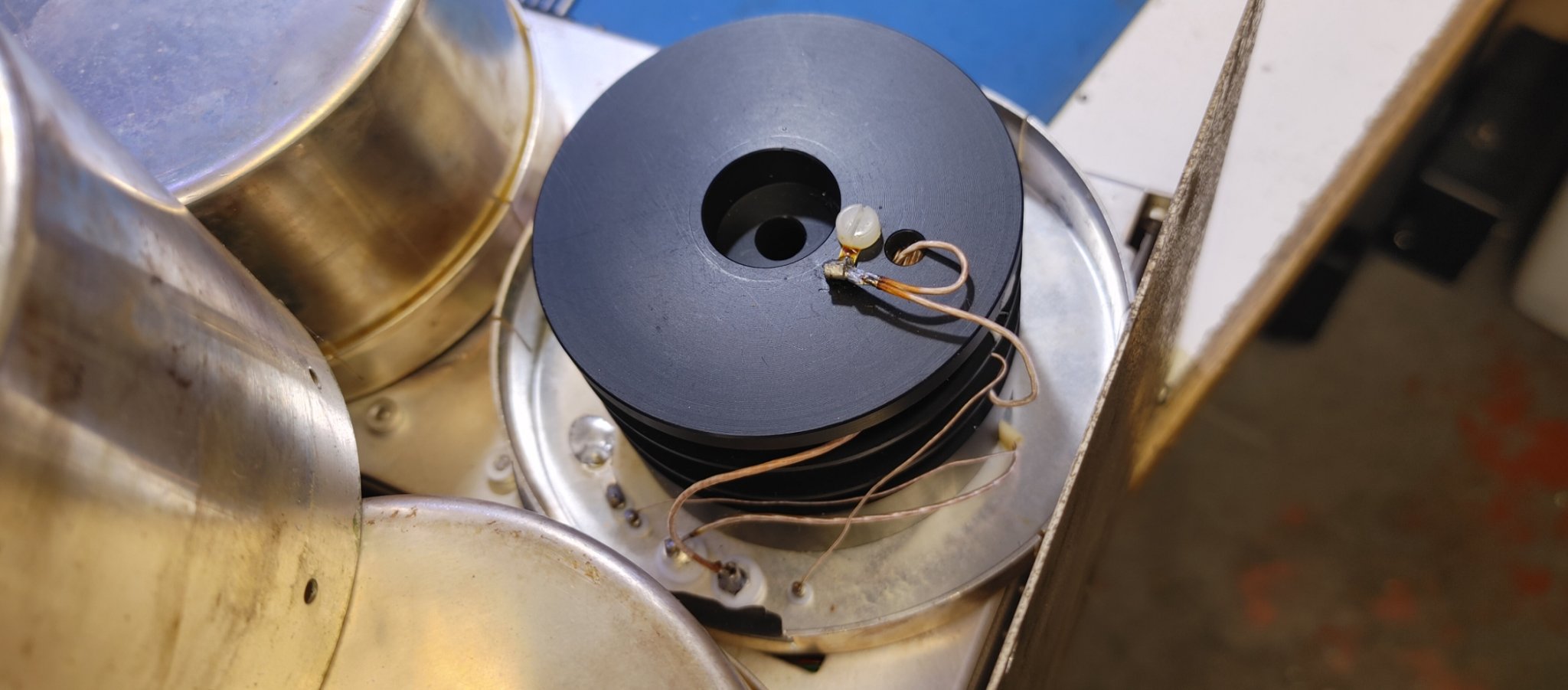

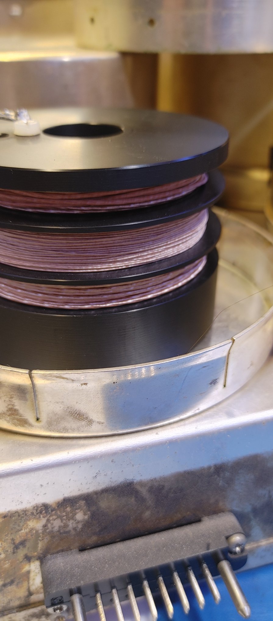

Thanks, that's very interesting. However, the coil doesn't seem to use a magnetic core, which would explain the ideal linearity. The shielding is quite substantial, logically. The capacitors are the excellent Rifa extended foil PS
Is that black material ferrite? It looks a lot like a plastic bobbin. If so, it would "just" be an air coil in a metal box, which would be good for distortion and noise.

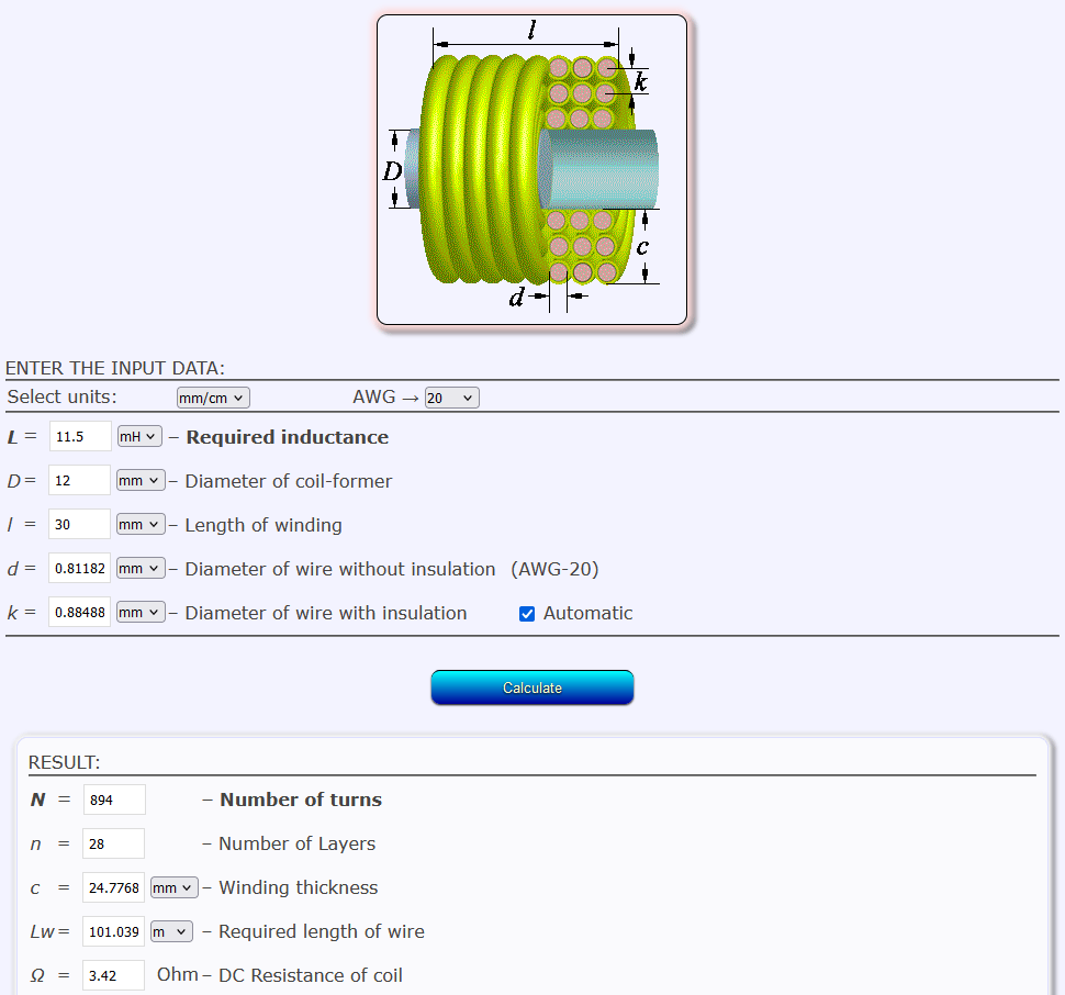

A quick calculation shows that it should be possible to do with an air coil.
I used this https://coil32.net/online-calculators/multilayer-coil-calculator.html
and approximate dimensions estimated from the pictures.

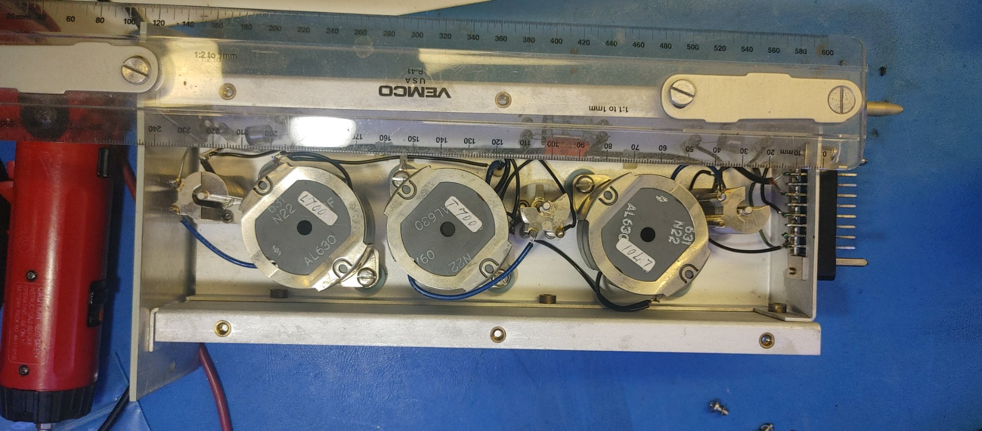

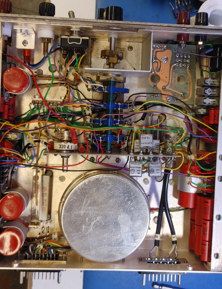

WRT CLT-1 some pictures and the schematic for the low pass filter.
The coils are large cup cores. Its a heavy part. The pictures are not great. The coils would need shielding to not interact. There is also a matching transformer to extend the range which is quite large.

Hi Demian,
That is a very cool instrument. I loved the USB plug for scale in the first picture. It had to be air core coils, nothing else would work. It also explains the 10KHz test frequency, balancing between HF effects and component size. A really well thought out instrument.
Hi Demian,

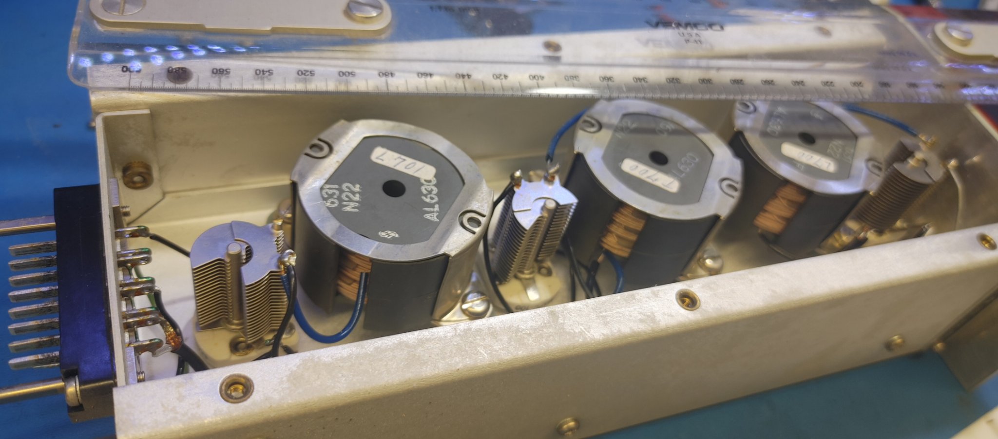

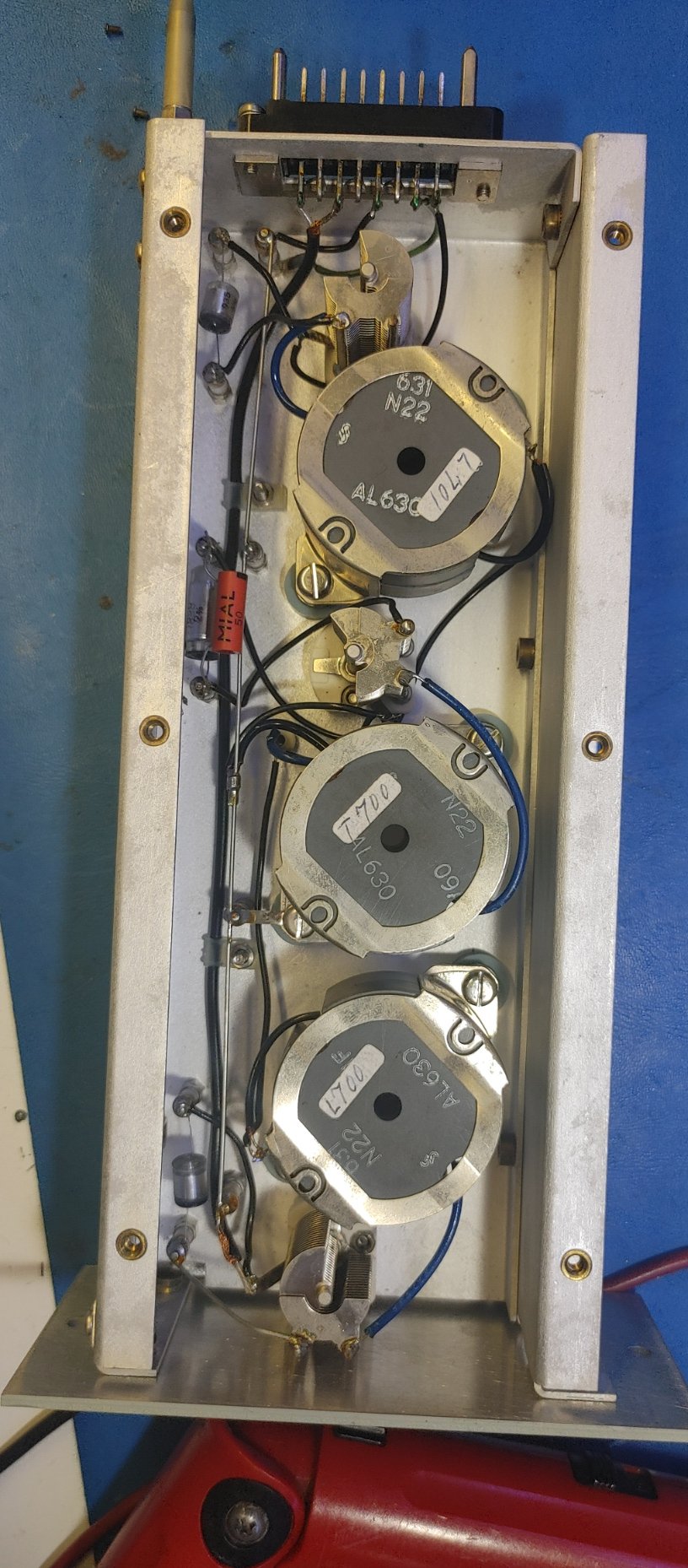

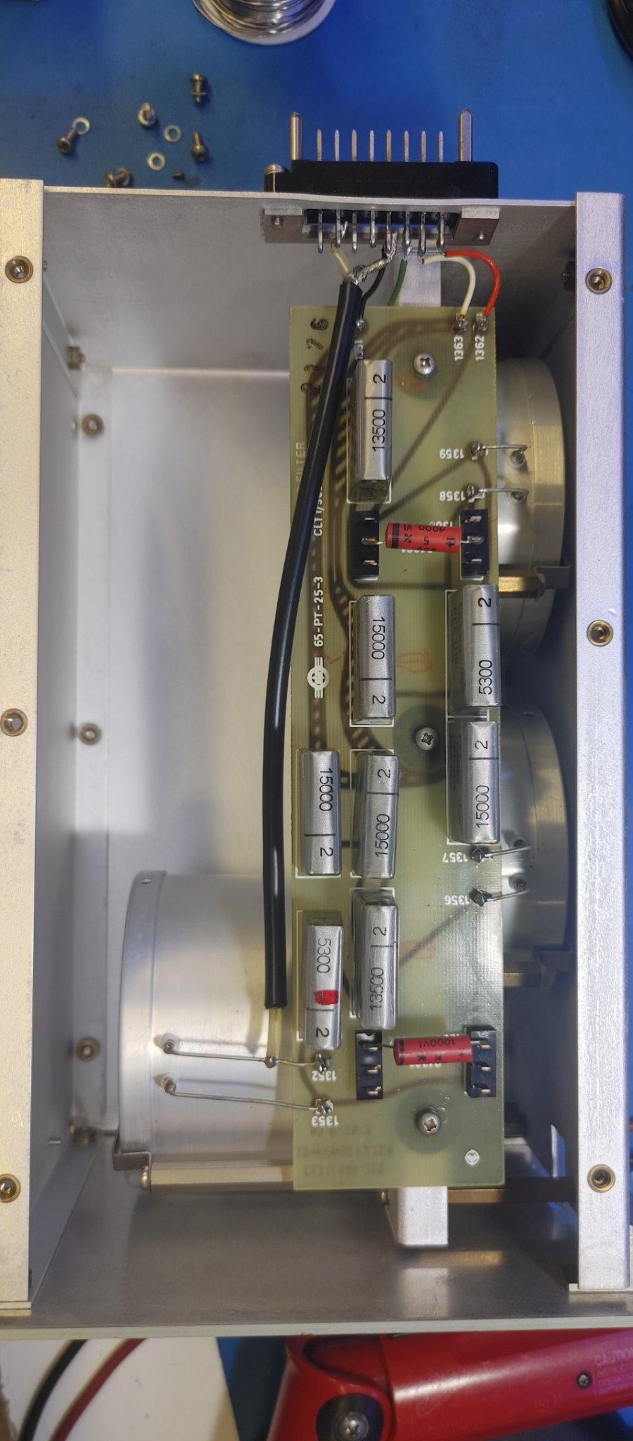

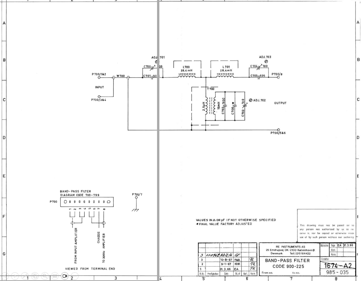

Afew more pics of the CLT-1 innards. The other pics I took years ago. These I just took. The low pass filter may be air core. However the bandpass filter (10 Hz? at 30 KHz) definately uses ferrite cup cores. Schematic attached.
Depending on the Ferrite, you may not have a B-H curve worth worrying about. Not in a practical sense and the performance this instrument has proves it.

It makes sense: with a sharp resonant frequency at 30kHz, the 10kHz current will be minuscule and won't generate harmonics. The 30kHz signal may be distorted, but it doesn't matter if some 90kHz is generated since only the amplitude matters for the measurement.Afew more pics of the CLT-1 innards. The other pics I took years ago. These I just took. The low pass filter may be air core. However the bandpass filter (10 Hz? at 30 KHz) definately uses ferrite cup cores. Schematic attached.
If the 30 kHz HD3 from the component is of sufficient amplitude to distort the magnetics in the 30 kHz BP filter its probably measuring a really bad part. Like maybe one of my CMF-55s. 🙂 1audio should have the samples in a few days.It makes sense: with a sharp resonant frequency at 30kHz, the 10kHz current will be minuscule and won't generate harmonics. The 30kHz signal may be distorted, but it doesn't matter if some 90kHz is generated since only the amplitude matters for the measurement.
It would probably be possible to reuse the very sound and sensible principles used in this instrument in a much simpler DIY tester. It wouldn't be a clone or a copy, but rather a tribute, having significantly reduced performances: for example, a measurement floor 40dB higher than -170dB. -130dB would still be incredibly useful for most DYIers.

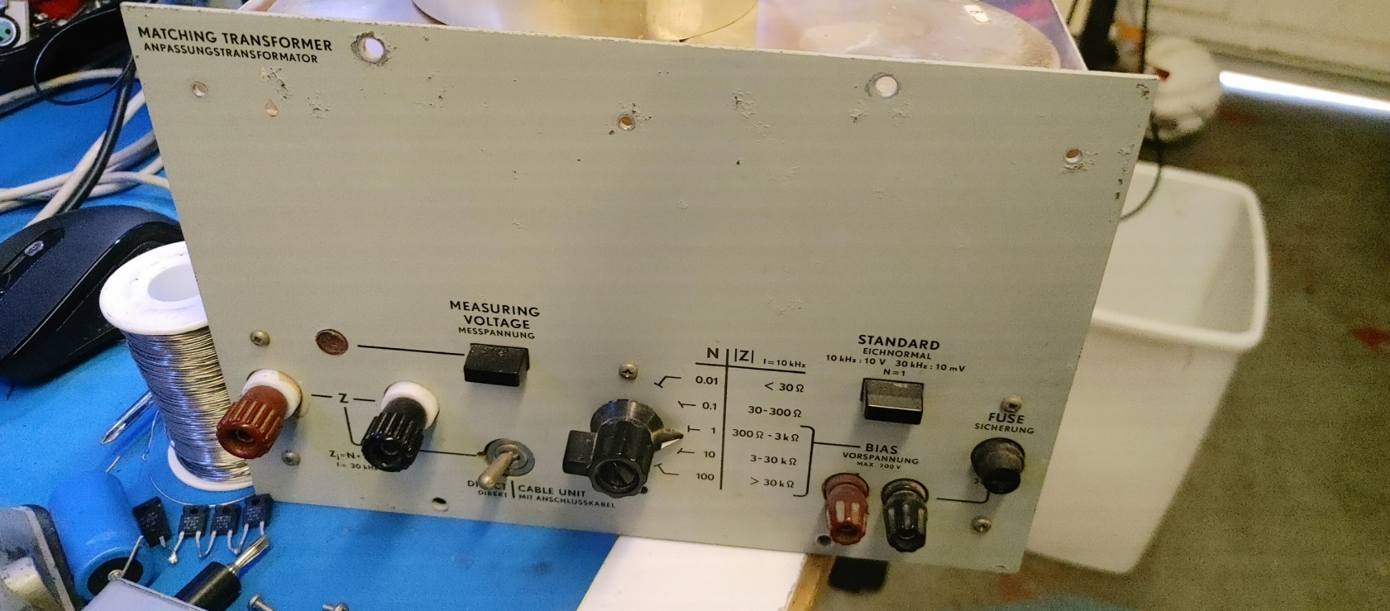

One question mark remains: the transformers. I don't see which trick to use to achieve a -130dB HD3 level with magnetic materials, even if the magnetising inductance is huge, and the peak induction minimal

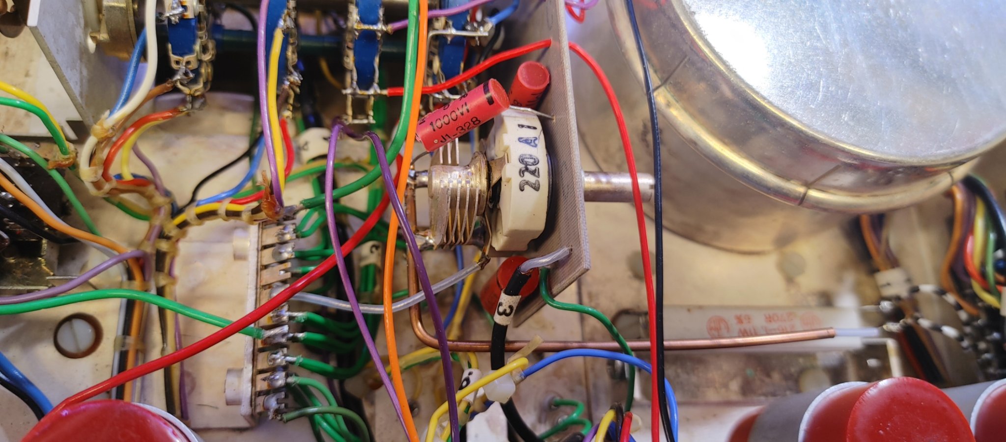

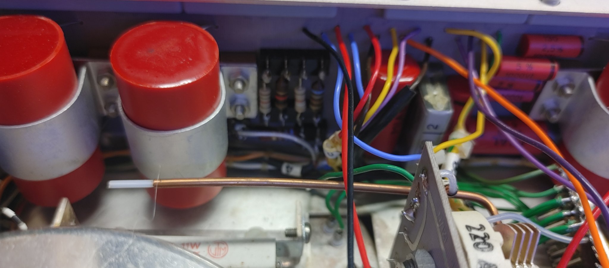

Here are some pics of the transformer module. The coil may be on a plastic former. The wire is litz. There is also the short piece of semirigiid used as some type of gimmick capacitor you can see in two pictures. The Vishay S102 10K reads -170 dB 3HD at 30V. i'll try some other resistors later. This instrument was invented by Siemens to select high reliability parts in the late 1950's. They wanted to be sure the undersea repeaters would not fail. Radiometer constructed the commercial version in the 1960's. There is a newer version with relays and a lot more automation. These were never big sellers. Dynavector used one to select parts for their preamp. Vishay film resistor group also has one. They are mostly in Japan I believe.
PM me if you want a copy of the manual.

I was going to write this post yet again, but I found one place where I wrote it before. I wonder if this would help:It would probably be possible to reuse the very sound and sensible principles used in this instrument in a much simpler DIY tester. It wouldn't be a clone or a copy, but rather a tribute, having significantly reduced performances: for example, a measurement floor 40dB higher than -170dB. -130dB would still be incredibly useful for most DYIers.
https://www.diyaudio.com/community/...r-transformer-core.220282/page-2#post-3180666
I have already experimented with the technique, but to remove crossover distortion:
https://www.diyaudio.com/community/threads/a-dive-into-the-past.252143/post-3839604
There are earlier, more detailed posts somewhere, but I cannot find them.
It should work for a transformer too, but the implementation is going to be tricky
