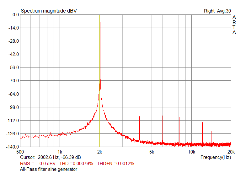

I've built it a few years ago, with a few modifications (a bit of filtering after the full wave rectifier): it's a very simple and clever design (the THD cancellation trick is lovely), and it is indeed capable of low settling time and very low THD - 0.001% or better mid-band:
but low settling time has a prize: amplitude flatness is far from optimum (with no integration in the level controlling loop the steady-state amplitude is a bit undeterminate...), and THD+N is somewhat high. If you are looking for something simple and fast to build it is certainly a good choice, but if you are managing to do some serious audio work then you should go for an SVF design - something like Bob Cordell's generator; or, maybe, improve a bit this generator with a better level controlling loop - never tried, but I think suprisingly good results are obtainable.

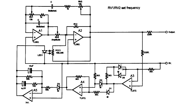

I too liked the simplicity of this. Here's my pcb layout. I mounted + / - 15V regs on the pcb.

I wonder if the distortion would be lower with something like the LME49740?
I think the answer is definitely... no. The distortion products you see in the spectrum I've posted are mainly (or entirely) due to the peak detector, whose time constant is zero - no filtering at all means very low settling time (which is good), buy the price you have to pay is that all the harmonics produced by the full wave rectifier are injected in the level control loop, i.e. in the output signal. In order to lower the output THD you have to set up an integrating loop - maybe you can try the one from the JLH's original design:
it's a Wien Bridge ring-topology (in order to get rid of the opamp common-mode THD), and the amplitude control loop is based on a canonical peak-detector/integrator chain (whose time constant you'll have the to tailor in order to suite your needs - ie freq range and output amplitude).
