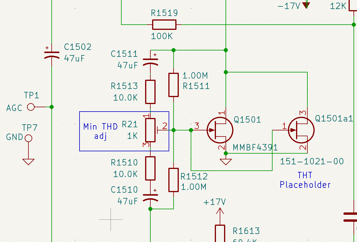

In an earlier Post, Bob Cordell mentioned that he added a 1K trimmer to tweak the Gate voltage of the JFET in the AGC section of his THD analyzer generator. I tried that with my DIY build of the SG505 and was amazed by the improvement. My 2nd H went from 0.00016% down to 0.000069% dropping the THD from 0.00021% to 0.00015%. Well done Bob, and thank you for the tip.
The circuit detail of the modification to adjust the 2ndH is attached.
This can also be done to existing SG505's.
I now also swapped out the original Tektronix 151-1021-00 JFET, and replaced it with an MMBF4391.
After re-tuning for the lowest 2ndH, I still have the same THD as above, but the 2ndH is even a bit lower at 0.000062%, so this is a good alternative.
I tried this mod on my original SG505. The 2nd H went down from 0.000081% to 0.000077%. THD went down from 0.00019% to 0.00017%. Not a big improvement in my case.
I have to add that 3rd H is dominant by being about 6 dB higher than 2nd H.
