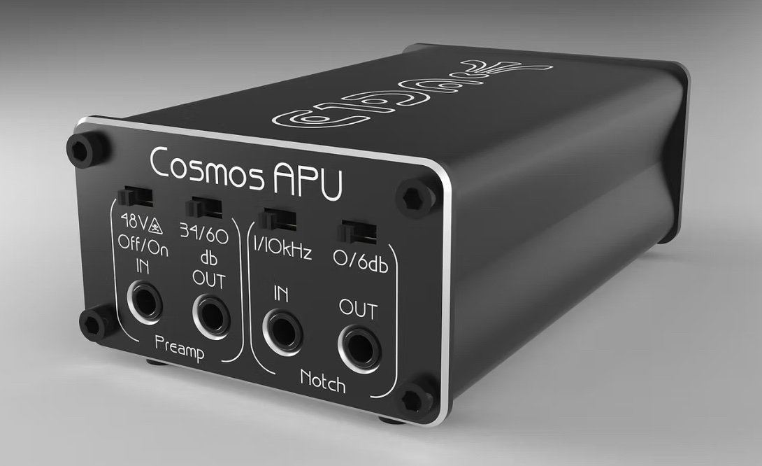

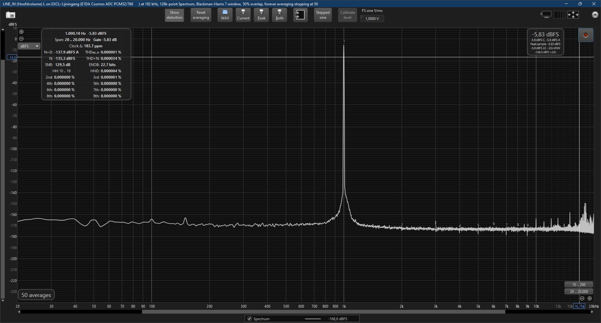

My dac is a 9039q2m from cosmos. Designed for oscillator/tone generator duty.
0dbfs is 4.2Vrms.
I only mentioned the price, because for €150 you get a great tool. Not only for 1khz thd measurement but for much more measurements like frequentie respons, fase respons, IMD, step respons and a lot more. All controlled by free software.
I said nothing about the adc or measure device.
And with harmonic correction file.
Reactions: esl 63 and CG

I always use the sweetspot output voltage(4.2Vrms) of the dac and lower this when needed with passive volume control.
Do not use correction file for adc but use notch filter/gain for 1khz thd measurements.
Results with thd measurements of opamps are onspec with datasheets, this is my reference.

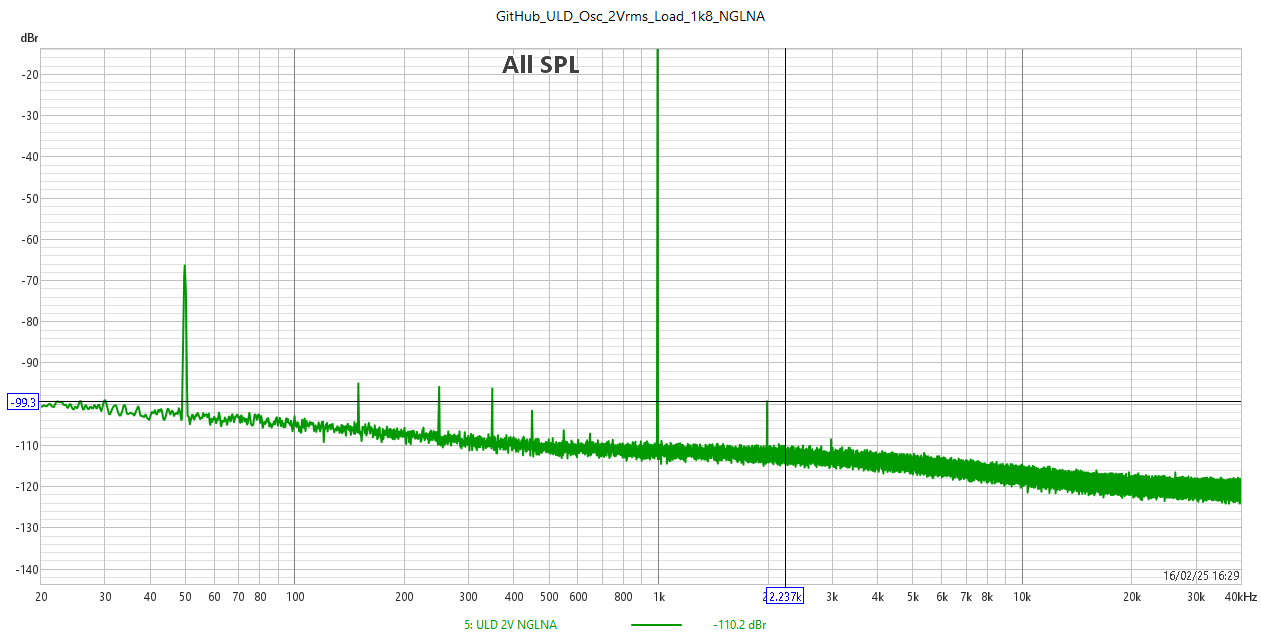

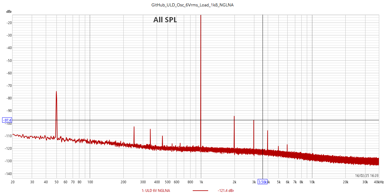

I've built it last year, and in the attachments are the spectra I measured at 2 and 6Vrms. The load was 1k8 (the input impedance of my notch filter).
In interpreting the results, the 2nd harmonic peak must be shifted down by 50dB, and the 3rd one by 54dB (the notch filter attenuation + the LNA gain of 60dB).
For example, at the output volage of 2Vrms, the 2nd harmonic is in reality at -149.3dBc, and the 3rd one at -162dBc.

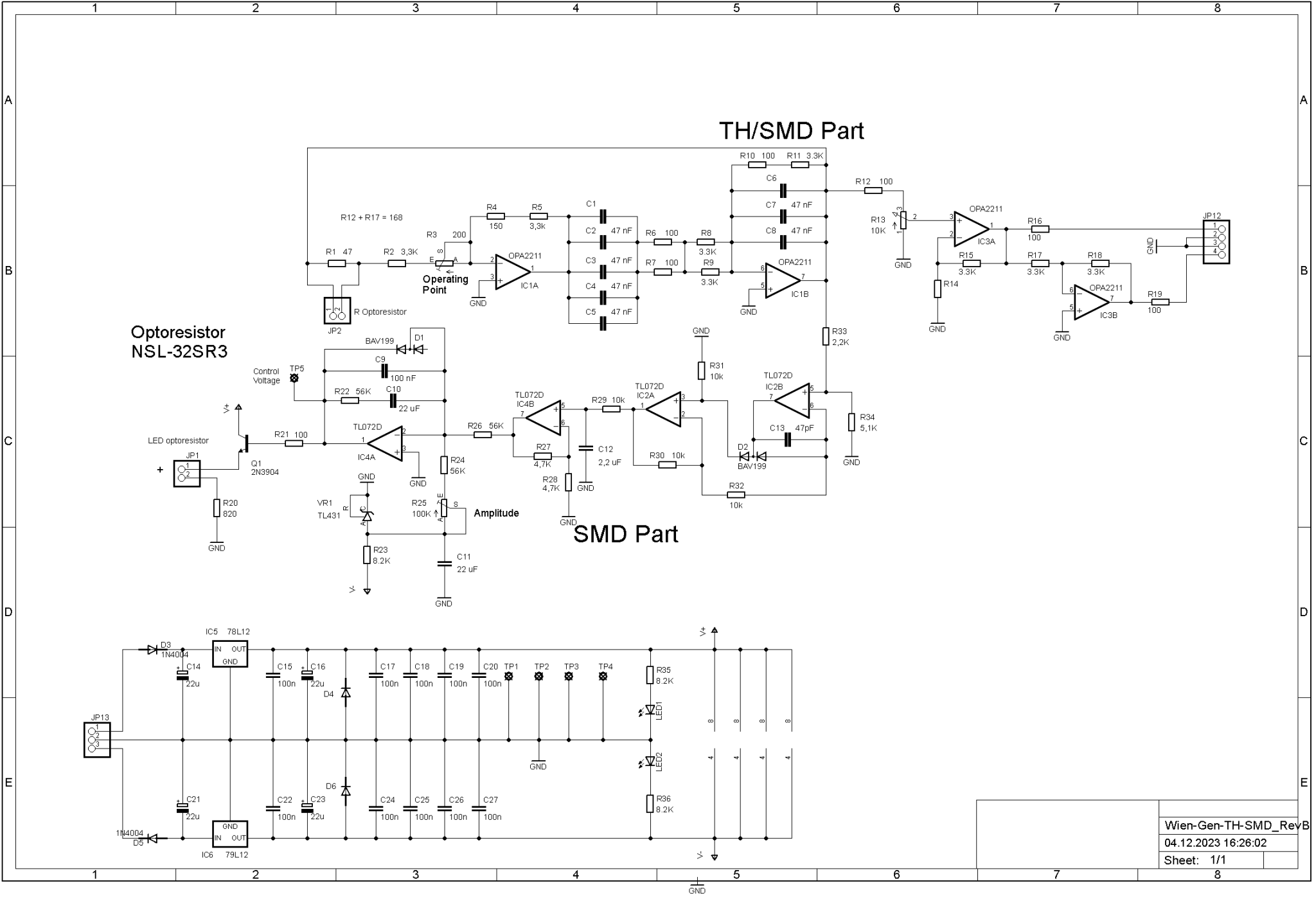

Hello DNi,

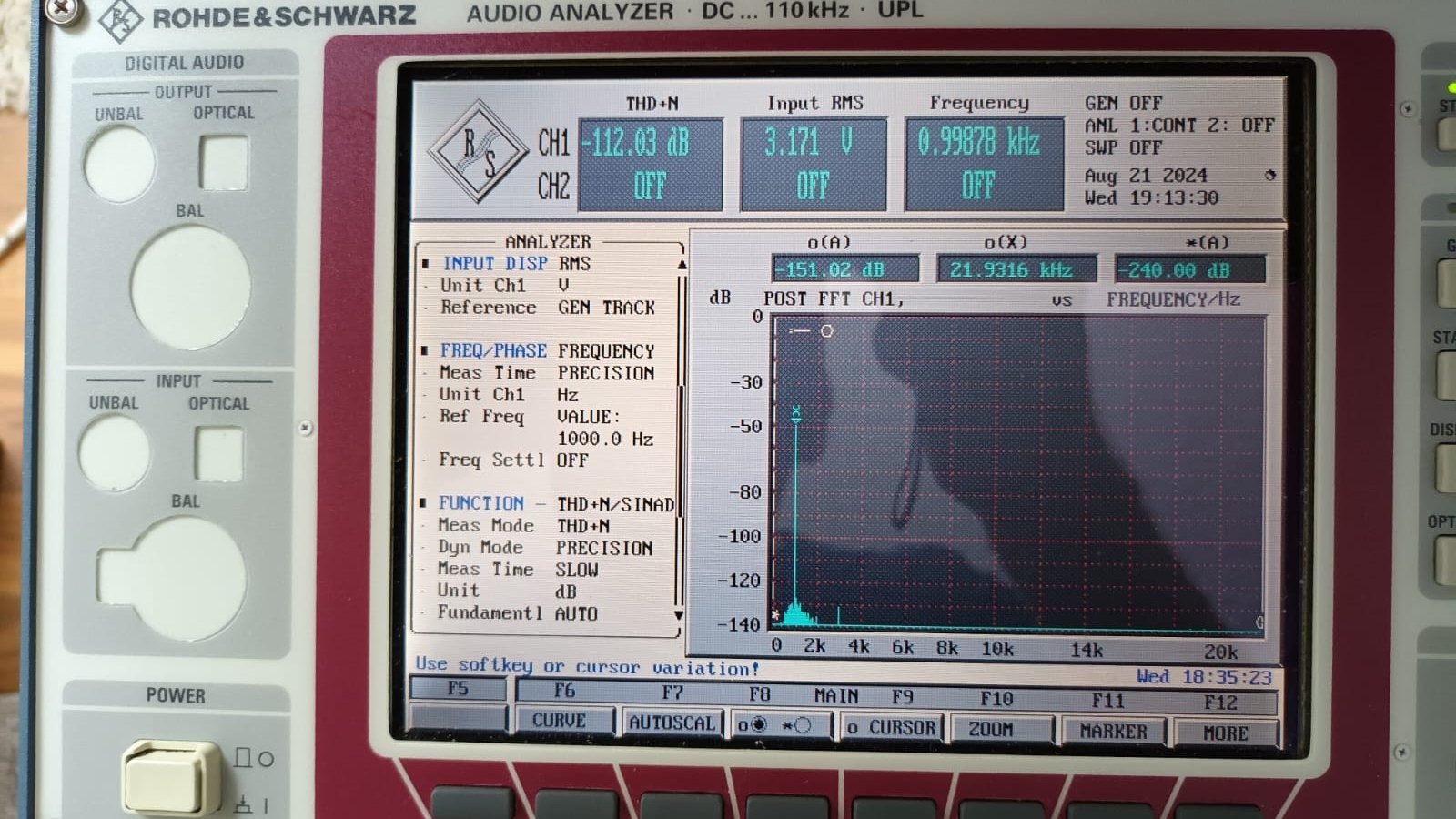

there is an identical circuit that was posted by user alfredr in his thread "Analog Filters, Notches, Amps, Attenuators and more". Same amplitude control with optoresistor NSL-32SR3. However, unlike janazcard's circuit, he has at least provided an output buffer with amplitude adjustment option, in this case a potentiometer. Here there is even a balanced output, with 100 Ohm output impedance each, so that at least a 1m long BNC cable can be driven without oscillations.
I received exactly such an oscillator from user alfredr and also measured it with a passive twin-T-notch filter. I implemented the output buffer with OPA 1656. The THD I measured was -138.80 dB at 3.171V RMS output voltage. (See also alfredr's thread). It's still very good, but 10dB worse than your measurements. It could of course be due to the board design, but alfredr is a very experienced engineer. What I noticed in my measurements on this type of oscillator, however, was the relatively mediocre THD+N value of -112dB at 3V RMS output voltage. The Bridged-T oscillators and especially the State Variable oscillators that I developed were at least 6dB better.

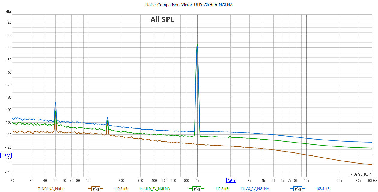

Hello Helmut,
You're right, the noise floor of the GitHub oscillator could've been reduced, at least by increasing the capacity in the NFB to the largest FKP2 capacitor (33nF).
On the other hand, an oscillator for use in the THD measurements must simultaneously have both the distortions and the noise floor than the prospective DUT.
Refering to the attachment, the uppermost spectrum shows the noise floor of my example of the Victor's oscillator, the middle one the same for my build of the GitHub project, and the lowest one is the noise floor of my measurement system (notch filter, 60dB LNA, and the Cosmos ADC at the 4.5V range, termed NGLNA in the curve legend). The two oscillators were both measured at 2Vrms, the load was 1.8k (the input impedance of my notch filter), and the NGLNA was measured with the input grounded.
Taking the 2nd harmonic as an example, and considering the notch filter attenuation of 10dB at 2kHz and the LNA gain of 60dB, the noise floor of the Victor's, GitHub, and NGLNA would be -158, -162.2 and -169.3dBc, respectively.
In order to be able to measure the 2nd harmonic of a DUT at the respective noise floors, the two oscillators must have their own 2nd's at the above limits or lower.
My Victor's is about right (typically, I measure the 2nd at -158dBc), but the GitHub's 2nd is in my case typically at -149dBc, which means 13dB higher than the respective noise floor.
However, it is encouraging that the GitHub even in this version has a lower noise floor than the Victor's, so it might profit from some tweaking.

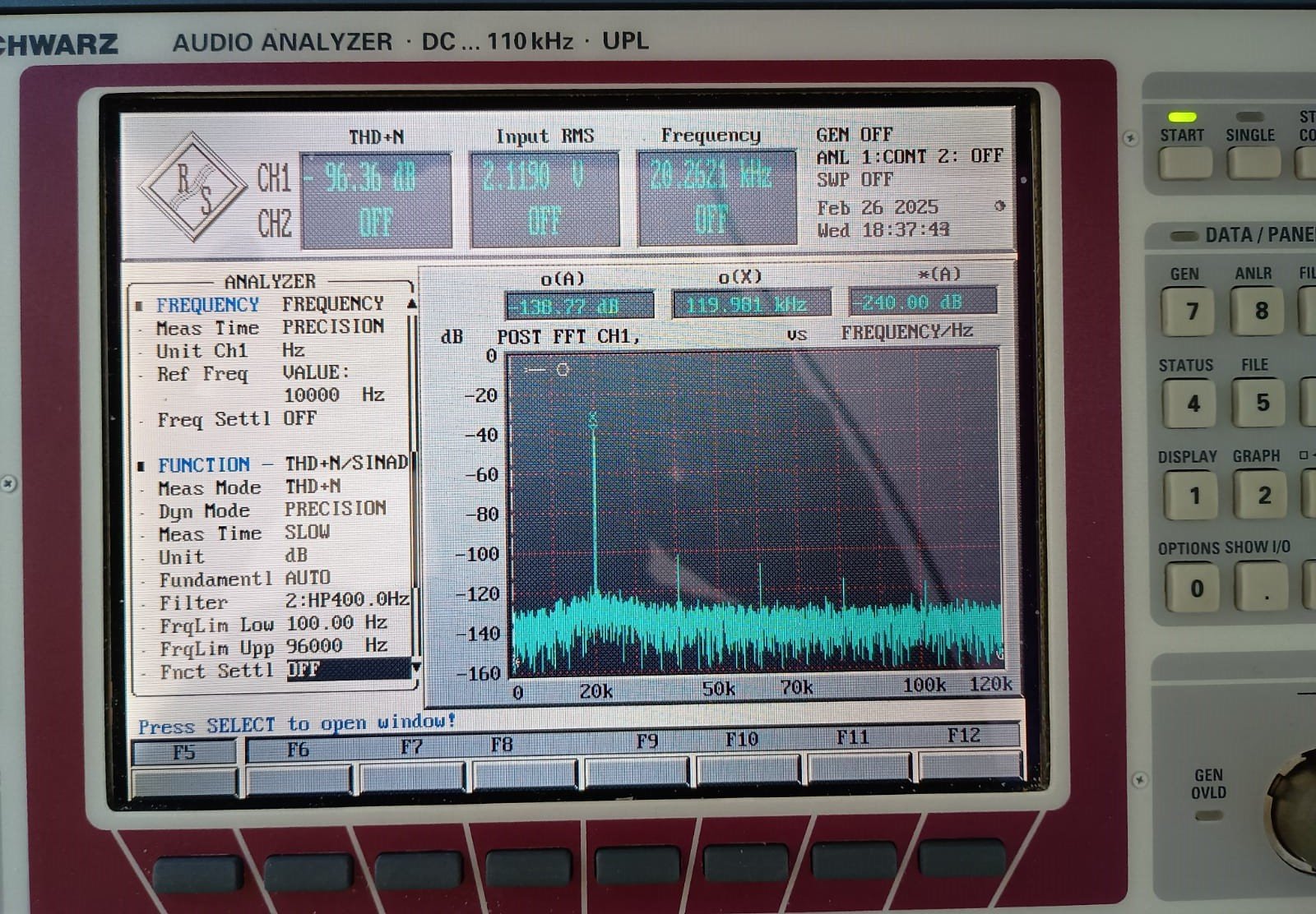

First of all, thank you very much for your very detailed answer. I agree with you that the QA403 is a very good and useful tool for testing power amps, etc. I bought a QA401 myself a few years ago. There was also a QA480 (analog 1kHz sine generator with twin-T notch filter). Unfortunately, I think only 25 units were built and the device is no longer available. I would pay significantly more than 250 EUR for it (price in Germany). But whatever, QA certainly had reasons for no longer producing the device.
That was also the reason why I developed the oscillators myself. I am an electrical engineer, but audio is just a hobby of mine. I will certainly never reach your skills in analog circuit technology. The project with the continuously tunable 5-stage SVO sounds very exciting...
I started building oscillators with 1kHz about 10 years ago. These were Wien bridges and then bridged-T oscillators, like the HP339A but only for 1kHz. I modified the amplitude control of the HP339A (different time constants for the integrator, etc.) and achieved a THD of around -140dB at 1kHz and 1-3V RMS output. Then I also used the state variable principle. The oscillator that I had measured with the APX555 has 4 fixed frequencies 1,2,3,5 kHz. So it is not continuously tunable. But I also built one that can be switched from 1-10kHz in 1kHz steps, with a similar performance of THD and THD+N.
In order to test my oscillators myself, I built a notch filter (state variable filter) where I can adjust the frequencies from 1kHz-20kHz in 0.5kHz steps using DIL switches. The notch filter has a Q of 1 and therefore suppresses the harmonics much less than a twin-T notch filter. An amplifier (OPA 1612) then amplifies the notch output by approx. 30dB. The attenuation at the resonance frequencies is approx. -80dB. With this filter and my R&S UPL, which then does the FFT, I can measure up to approx. -150dB THD.

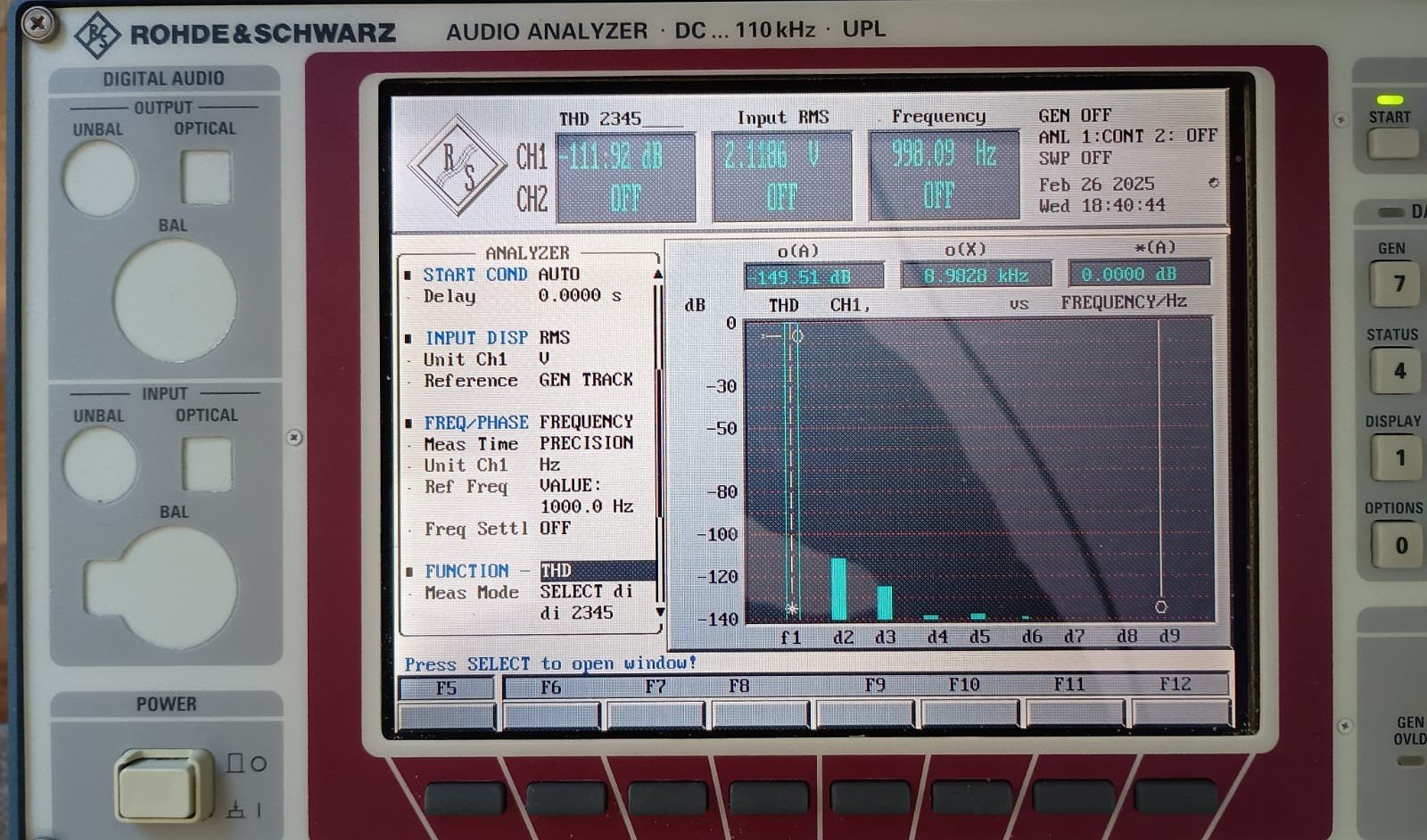

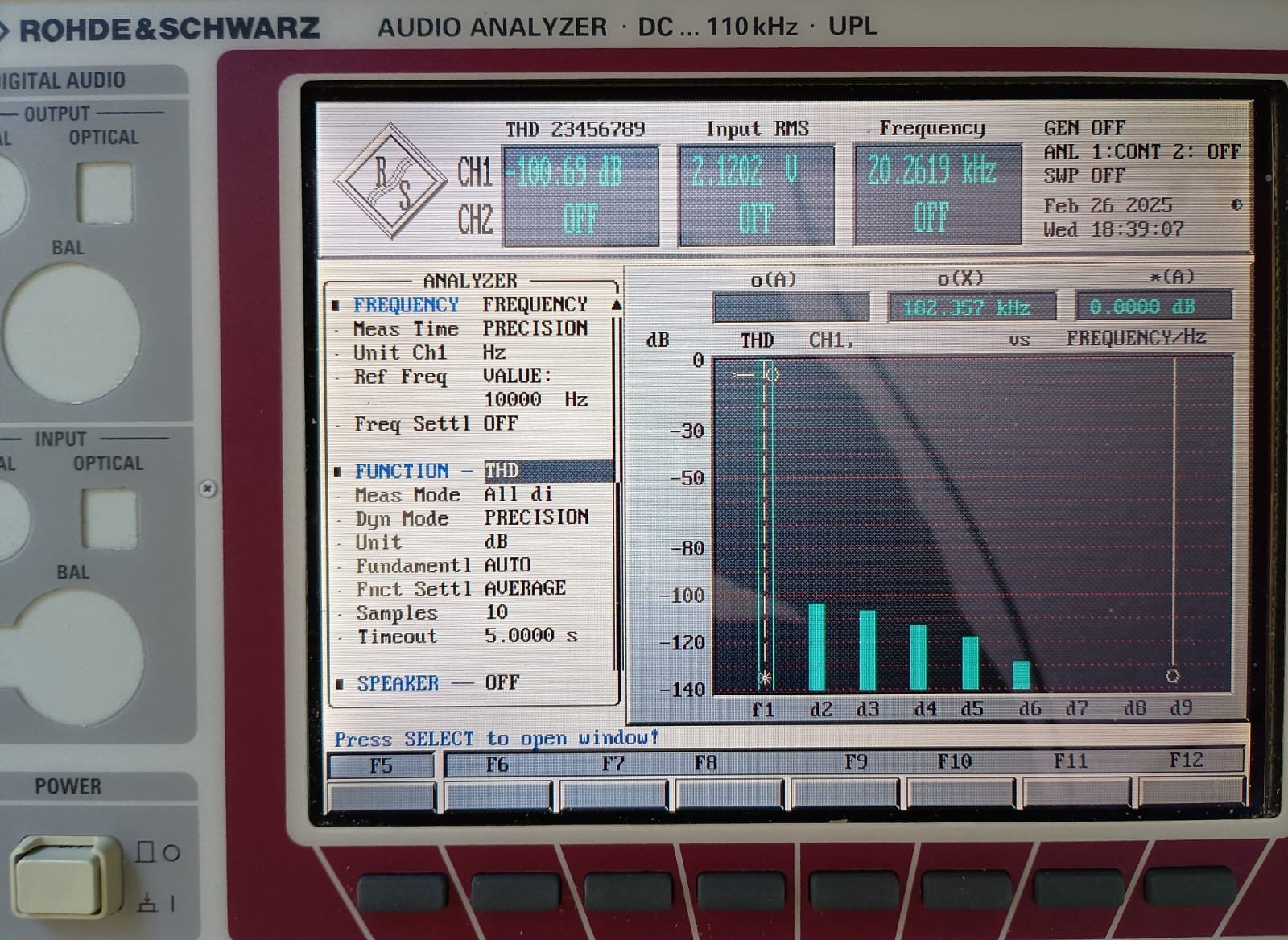

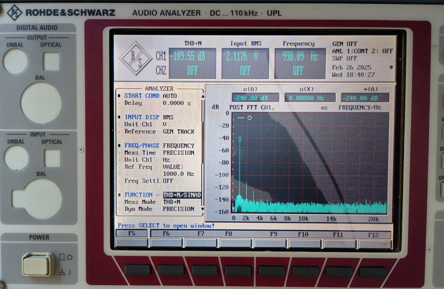

Hi Bob,
I may have expressed myself in a confusing way. I have the operating and service manual for the HP339A. There is also a circuit diagram of the oscillator. Based on this circuit diagram, I then developed my own bridged-T oscillator, which then has a THD < -140dB at 1kHz (1-3V RMS). The original HP339A obviously cannot achieve this, simply because of its age of almost 50 years. But I still have one on my workbench. I measured it again today with my audio analyzer from R&S UPL (also almost 30 years old). I haven't used the HP339A properly for 10 years. If the potentiometers and rotary switches were cleaned properly, it would definitely be a few dB better. I took 4 pictures. One THD and THD+N at 2V / 1kHz (bandwidth analyzer 22kHz). And then THD and THD+N at 2V / 20kHz (bandwidth analyzer 110kHz). The performance is pretty impressive for that time, I think. The frequency and amplitude stability of the oscillator is also impressively good.
