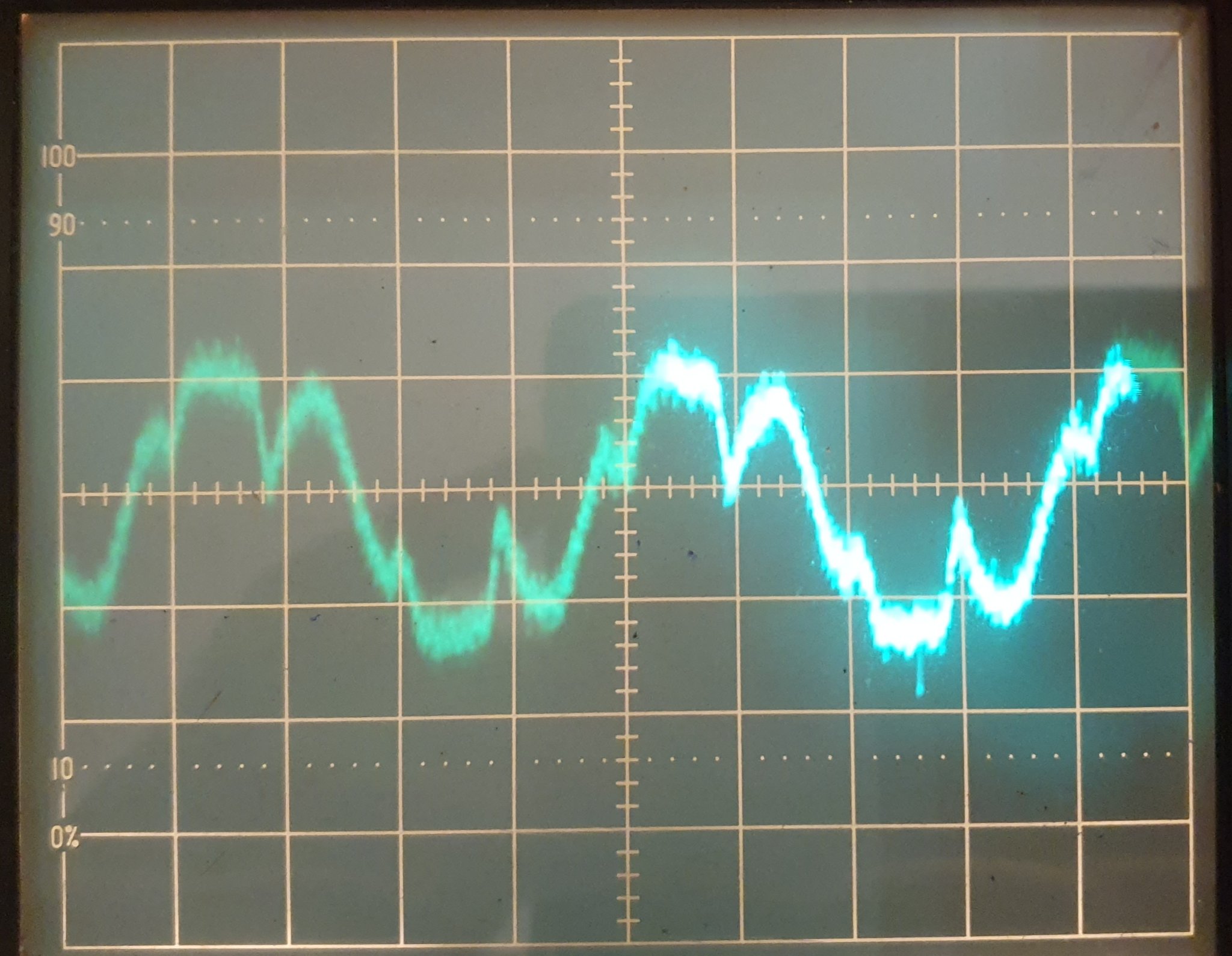

Yes, 100 Hz noise hints at a supply issue, not ground loop.
To be sure can you show a scope screen capture ?
This is the AA 501 function output, when the generator output is OFF.
400 Hz filter off, SG 505 output GNDED.
Oscilloscope horizontal 5 ms/div. It looks like 50 Hz.
Strange is that if I connect the analyzer's GND post to the generator's GND post there is no change in the waveform (as it should be). However, if I connect the analyzer's GND post to the outer metal part of the BNC cable connecting them together, the hum drops. Note the generator's output common is grounded (GNDED pushbutton is in).

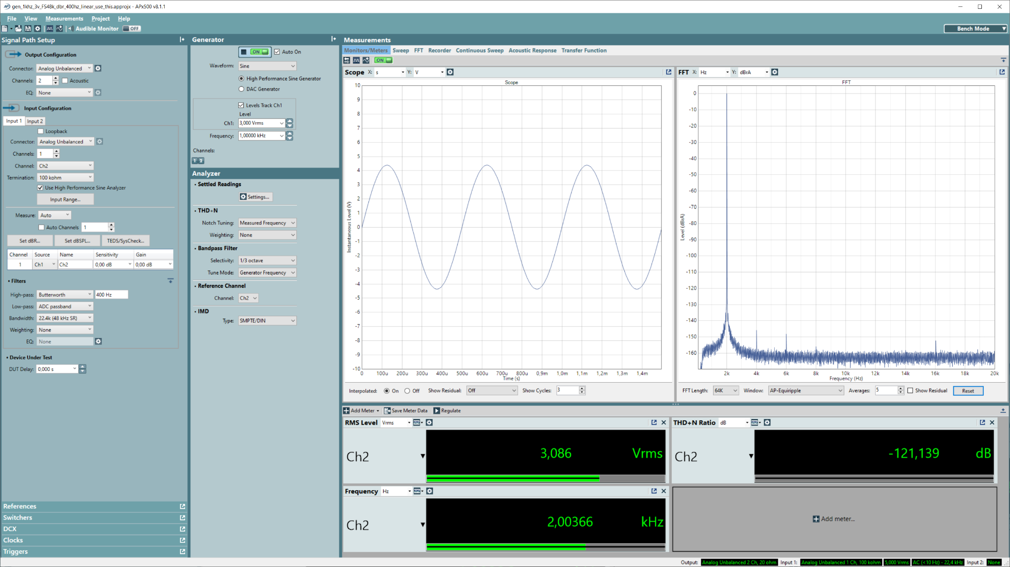

Hello,
in Germany the QA403 costs 800 euros and can be bought from elektor.de. I don't know why it's 30 percent more expensive here than in America. What the QA 403 lacks for precision measurements on high-end preamplifiers or similar is an analog sine generator and a notch filter in the analyzer section. Then you can also measure precisely below -140dB THD, which is necessary when designing analog circuits with OPA1612 or OPA1656. Otherwise you only measure the combined inherent THD of the DAC oscillator and analyzer. Since I also had this problem, I developed my own analog oscillators that have a THD of below -140dB. I then had this measured in a laboratory with an APX555 from Audio Precision. Here is a picture of my oscillator at 3V RMS and 2kHz. The other picture shows the loop-back of the APX 555.
Best regards
Helmut Sell

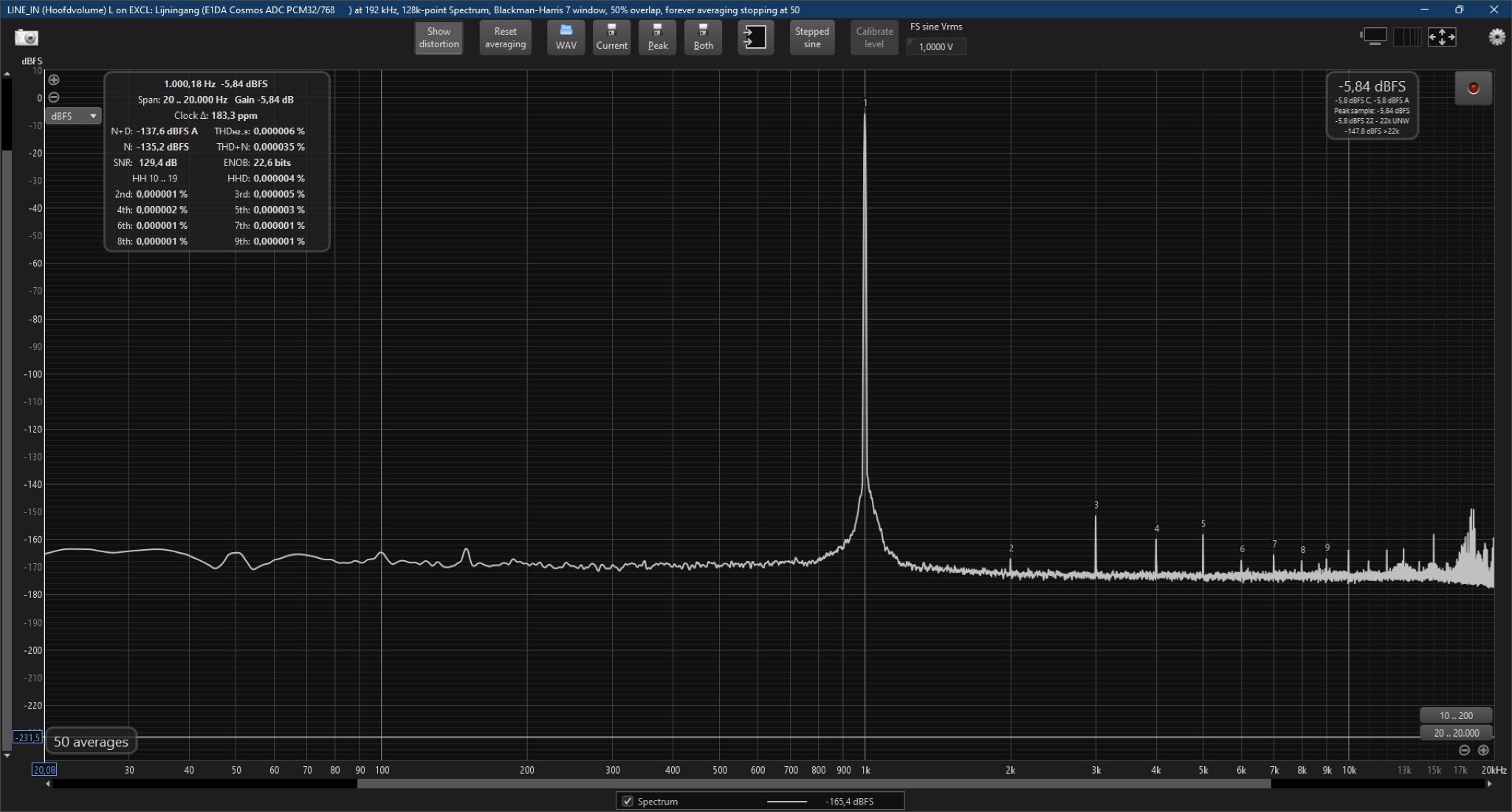

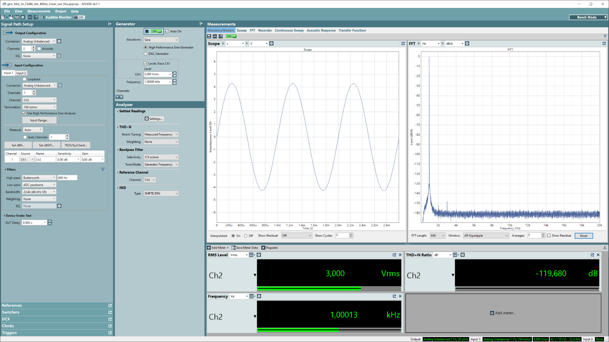

Hi Bob,
First of all, thank you very much for your very detailed answer. I agree with you that the QA403 is a very good and useful tool for testing power amps, etc. I bought a QA401 myself a few years ago. There was also a QA480 (analog 1kHz sine generator with twin-T notch filter). Unfortunately, I think only 25 units were built and the device is no longer available. I would pay significantly more than 250 EUR for it (price in Germany). But whatever, QA certainly had reasons for no longer producing the device.
That was also the reason why I developed the oscillators myself. I am an electrical engineer, but audio is just a hobby of mine. I will certainly never reach your skills in analog circuit technology. The project with the continuously tunable 5-stage SVO sounds very exciting...
I started building oscillators with 1kHz about 10 years ago. These were Wien bridges and then bridged-T oscillators, like the HP339A but only for 1kHz. I modified the amplitude control of the HP339A (different time constants for the integrator, etc.) and achieved a THD of around -140dB at 1kHz and 1-3V RMS output. Then I also used the state variable principle. The oscillator that I had measured with the APX555 has 4 fixed frequencies 1,2,3,5 kHz. So it is not continuously tunable. But I also built one that can be switched from 1-10kHz in 1kHz steps, with a similar performance of THD and THD+N.
In order to test my oscillators myself, I built a notch filter (state variable filter) where I can adjust the frequencies from 1kHz-20kHz in 0.5kHz steps using DIL switches. The notch filter has a Q of 1 and therefore suppresses the harmonics much less than a twin-T notch filter. An amplifier (OPA 1612) then amplifies the notch output by approx. 30dB. The attenuation at the resonance frequencies is approx. -80dB. With this filter and my R&S UPL, which then does the FFT, I can measure up to approx. -150dB THD.
