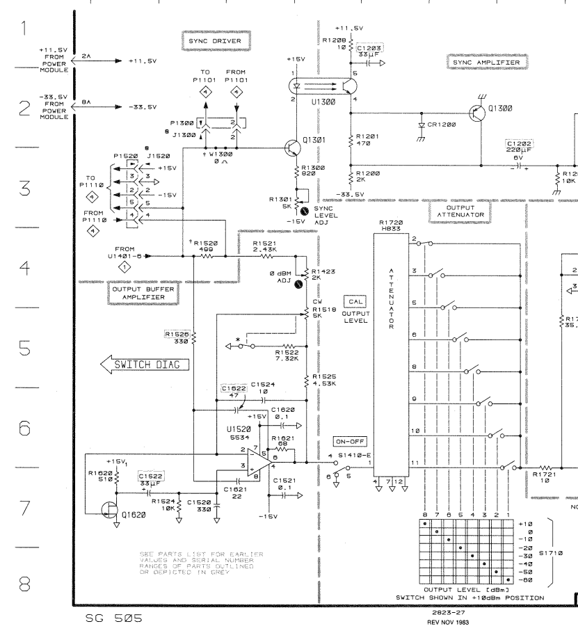

I need some help with a particular circuit used in the Tektronix SG505.
I'm currently working on a DIY rebuild of the SG505, as a fun project and learning experience.
The generator itself is working according to the specifications as far as I can tell, but the output amplifier is adding significant harmonic distortion. The amplifier uses a JET and the function of it is a mystery for me.
Can somebody out here explain that to me please?
The JFET is a Tek p/n 151-1025-00, originally an SPF3036. The recommended replacement is the 2N4416, and that can be replaced by a J111. I have tried several different JFET's in the circuit, but without significant changes. Even when I take the JFET out of it's socket, there is little change in the FFT.
Here is my blog with the project details: Blog
Here is the SG505 manual: SG505 manual
The output amplifier section is on page 63.
Below is a small section of the circuit diagram.
Many thanks in advance!
Paul

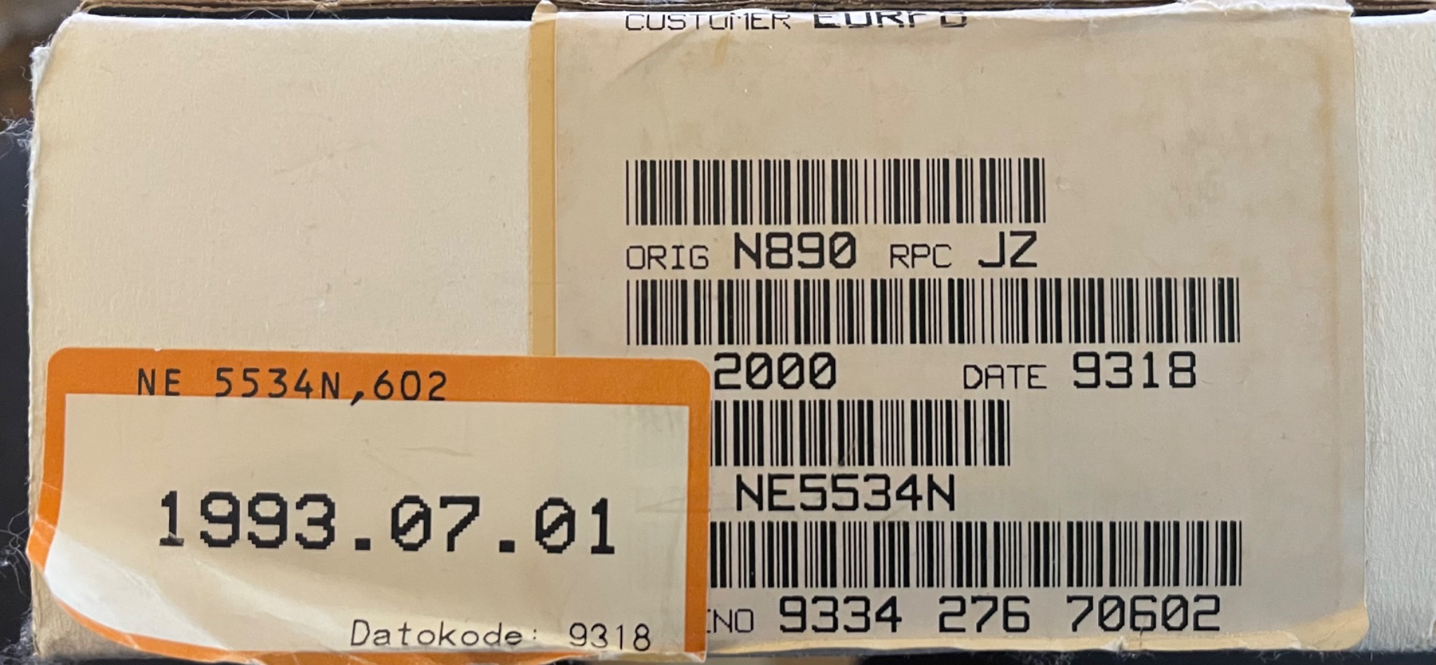

I think that the effect of the feed forward (C1621 and C1622) and FET (Q1620) depend on the internal circuit of the NE5534 used. So is going to depend on who the manufacturer is and the mask variant. It may even need some select on test or selection to work well. It's also going to depend on the FET transconductance when the gate source voltage is close to 0.
Maybe a simpler solution is to use a different operational amplifier such as an OPA1611 or similar?
It was mentioned earlier. Q1620 and U1520 form a low distortion composite amplifier as described in the US patent 4296381. A similar arrangement with opamps instead of a JFET was discussed by John D. Yewen in his article "High-precision composite op-amps", Electronics & Wireless World, February 1987.
Thank you, that helps.
I doubt however that Tek (Bruce) would build an instrument that would be so much dependent on components. They usually design ( and use conservative specs) so their instruments can be build over many years.
At this moment I want to see how close I can get with the original design, as I said for fun and learning. I first need to have a reference before even attemting to improve things.
Paulwv my explanation of the function of the FET, Q1620 in the Tektronix SG505 output amplifier is:-
To buffer and invert the error signal at the operational amplifier, U1520, inverting input (due to the finite loop gain of the operational amplifier) then AC couple via C1522 this signal to the non-inverting input of the operational amplifier. This increases the error signal between the inverting and non-inverting inputs increasing the loop gain so reducing the distortion.
The input to the non inverting input is attenuated beyond about 1 MHz by the low pass filter formed by the output impedance of the FET amplifier, R1620, and the capacitor C1520 to reduce the loop gain at high frequencies and hopefully prevent instability at high frequencies.
According to the data book that I am looking at (Siliconix Low-Power discretes 1994) the 2N4416 the saturation drain current, IDSS, is between 5 and 15 mA at VDS = 15 V and VGS = 0V).
Under the same conditions the J111 IDSS = 20mA min. The J112 looks to be a better match to the 2N4416 with IDSS = 5 mA min (if available).

Hi PChi,
Thank you for the elaborate explanation. It confirms what we already gathered from LTspice ourselves and the patent that @alexcp provided.
So it seems you are the lucky person that held on to their old data books. 😉 However, this datasheet is available online as well:
https://nl.mouser.com/datasheet/2/676/jfet_2n4416_2n4416a_interfet-2887738.pdf
Your JFET information is interesting. When I looked for suitable replacements for the 151-1025-00/SPF3036, I found a blog post about Tek products where they mentioned the Interfet 2N4416 as an "equivalent" replacement. DigiKey in turn shows the J111 as the replacement for the 2N4416. That's where I got it from.
I have the J112, J113 and tried them without much difference or improvements. I also ordered the J111, and will try that one too.
But I first need to do a better job looking at the harmonic differences, and need to upgrade my Twin-T with improved shielding.
I'm also going to try the Viktor 1KHz oscillator with the SG505 output amp to see what it does. There's something fishy with the way I put this amp together, but I don't know what yet. It seems to work really well, but adds a lot of harmonics to the clean generator.

When substituting Q1620, one thing to watch for is the stability of the composite amp. Since the J111 has a higher transconductance vs. the 2N4416, the bandwidth of the integrator Q1620 R1620 C1520 will be somewhat higher and may be a little too high for the composite. Test the composite on a low amplitude, fast rise square wave. If the overshoot is not aperiodic, try increasing C1520. Also, the amp will work without Q1520 - it will be just a normal inverting opamp.
