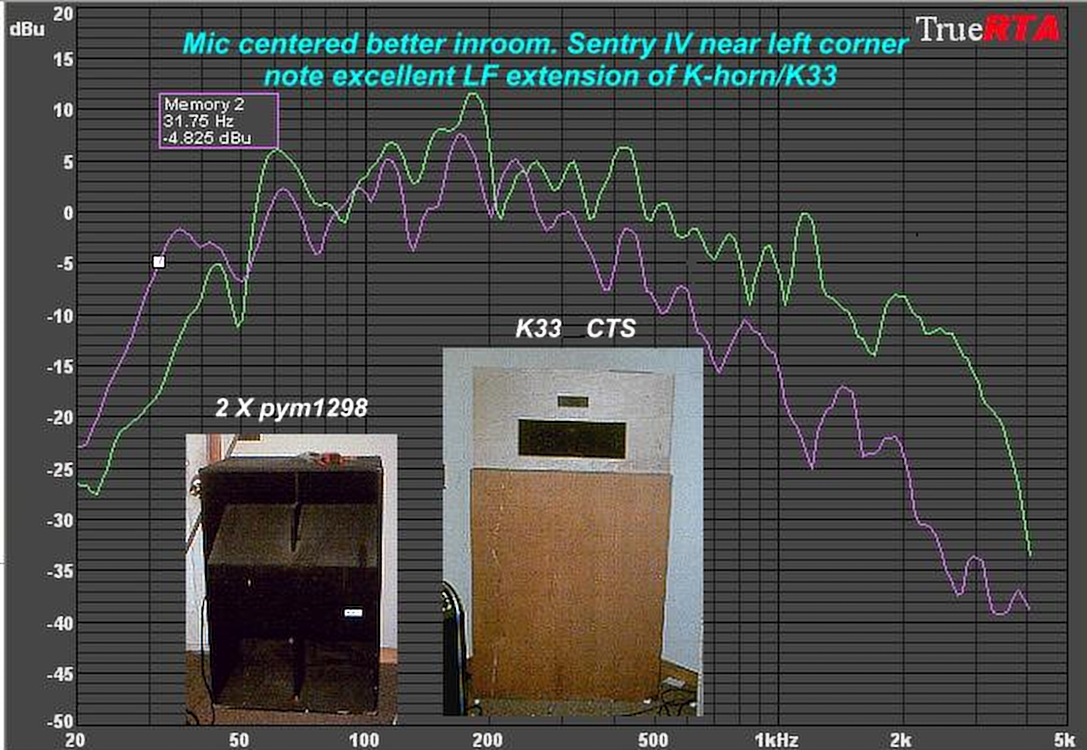

here's one of my Sentry IV w. paralleled 8ohm Pyle pym1298 (~ like Kappa12a) vs my 3rd and older Khorn with CTS K33.
Hi freddi,
The low end on the K-horn is surprisingly good. I would not have expected output down at 35 Hz. 🙂
Jim.

I did corner-horn simulation with AJ so far. I notice 2 deviations from these here, where my measures fit better to AJ simulation:
1. HR simulates at least 1 more top octave. While my corner measures decline above 350Hz. How much volume for cone did you assume? I took 8 liters. And that fits well to 350Hz lowpass behavior.
2. The 40-50 cycles area seems to be the horn cutoff. When I measure mic-in-mouth it starts response at 45 too, but climbs up apprx 9db towards 90 cycles and then remains linear >300. However, as I diverge the room modes come up and lift the 50-100 zone. Still it means that below 90 the excursion climbs, especially when equalized. Do you have experience over distance? Can you simulate mic closer to mouth (e.g. 1 inch)
3. AJ simulation is more even than real measures. Edgar Bruce mentioned that real-world walls and floor are slightly absorbing, and as a consequence one shouldn't calculate with 8th-PI but max 4-PI in the corner. The smaller mouth would explain more ripples. How is the deviation in HR sim. with quarter or 8th PI ?
cheers
Josh

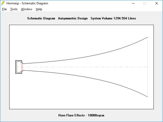

Generic Horn Size Analysis - KHorn Emphasis
This is a study of various exponential horns of various mouth sizes. The objective is to understand how the mouth size affects the fc and resultant ripple of a corner horn with a nominal fc of 38 Hz.
Below is one of the horns from the study.
Jim.

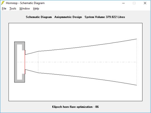

Corner Horn Flare Optimization
It has been said that corner horns, and the K-horn in particular, benefit from having an initial flare rate greater than the nominal flare, for the first portion of expansion. This high initial flare has been said to be 100 Hz.
This study is to determine if this high initial flare rate allows for shorter overall acoustic path, and thus makes for a smaller volume horn.
The horn below is one of the shapes examined.
Jim.
