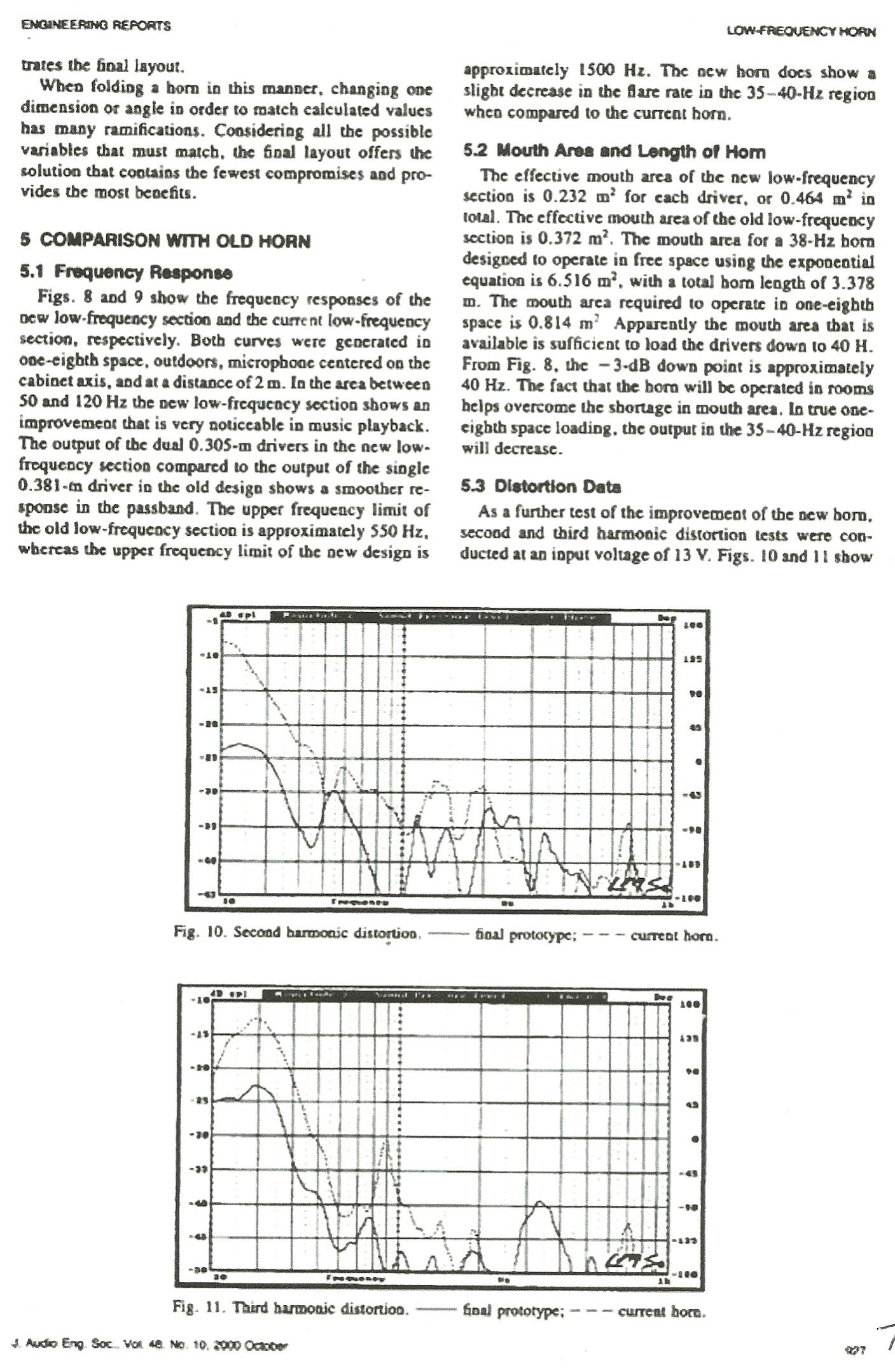

Attached are: EV DL12X EDS.pdf, Klipsch K-31 specs from internet, and scans of pages 3 and 4 from the AES paper vol 48 #10 from Oct 2000. The scans have the T/S requirements for the Jubilee woofers.

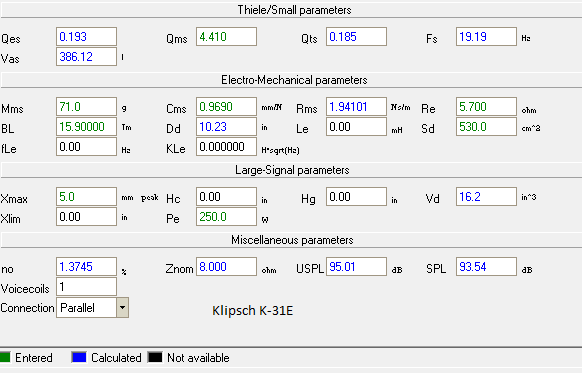

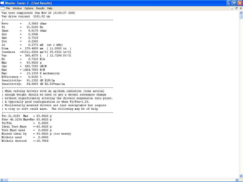

No mass was added for the Vas measurement, I don't think the related numbers are valid?
Hello NEO Dan, yes it seems you are correct. The same question came up on the forum that had the #s in question. I attached an update from:
Klipsch Woofer Thiele/Small Parameters v2.1 - Technical/Modifications - The Klipsch Audio Community
Thanks...chris
edit - It looks like these T/S #s were copied from the page 4 AES paper of what to look for in a woofer, rather than what a K-31E tested as.

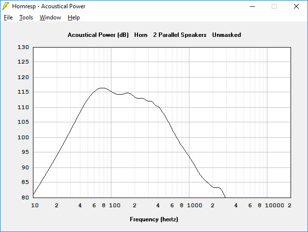

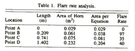

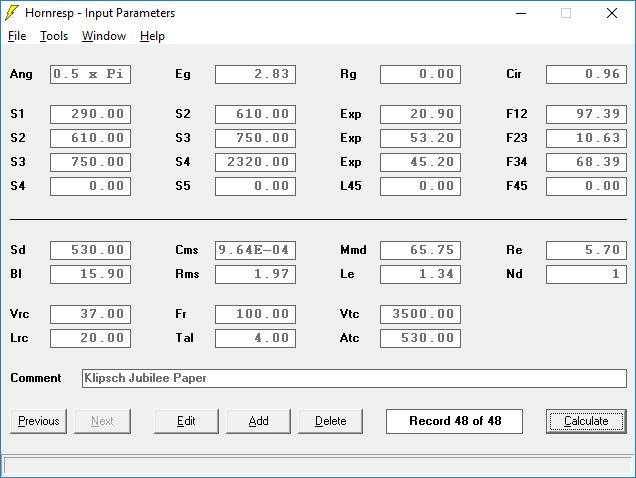

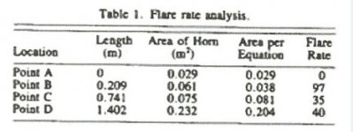

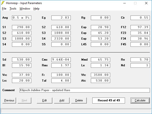

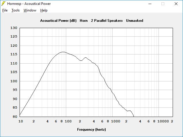

Chris,
Thanks so much for the attachments.
OK, this is the part where I could use some help.
The attachment called Jubilee Flare Rate Table has a portion of attachment that you posted, and I scratched my head for some time trying to work out the distance-and-areas for corresponding flare sections of the horn. My only conclusions are: 1) either I am misreading the table, or 2) the table has a typo.
When I model the horn flare rate from the table, one can see the resulting sections in Hornresp, and the flare does not look right (see 10 and 11.jpg).
After modifying the shape to get essentially the same flare rates as listed in the table, then section distances and areas are different than those listed in the table.
Modeling either case, shows a very poor SPL response. Notice no low end close to 40 Hz? I expect that the low fs of the driver is primarily responsible. Maybe some other DIY's can shed some light on this.
Jim.
this was based on other's analysis of expansion (see i forgot to use lossy Le on the K33)
this was based on other's analysis of expansion (see i forgot to use lossy Le on the K33)....
Hi freddi,
Thanks for the info. The Jubilee curves that you posted do seem similar to the second one that I posted. It does seem to confirm that the low response does not go flat to 45Hz like the Klipschorn.
Jim.
Hmm, with a 'rubber' throat + expo there's normally basically just two flare frequencies, so 97+[35/40] is near enough.
In a compression horn, Fs is normally near/at the flare frequency, then tuned up to whatever Fc is desired, so if Fs = 21 Hz, then combined with a 40 Hz expo + conical corner flare that's about right with an Fc in the 47-58 Hz range based on the specs in post 62.

Hello Jim, The AES paper is not a plan for building, but the idea of how the Jubilee might better the Klipschorn . The construction plans are not available.
I am attaching the other pages of the AES paper vol 48 #10, 2000 Oct.
You have page 3&4 already,page 1 is the cover sheet, 8 & 9 are acknowledgments and irrelevant.
have fun...chris
have fun...chris
The table lifted from the Jubilee paper is for half of the horn. Double all areas to sim the full horn in hornresp.
Very nice thread by the way. No matter how often the Khorn is discussed, there is always new old information brought up. And each new round of reverse engineering and simulating illustrates other interesting characteristics. Thanks for starting it and doing this work.
LOL! 😀 GIGO applies!
The paper is kind of confusing. Typical engineer logic. The horn is symmetrical, we get all we need by measuring half, we only report what we actually do, so we print a table with half the horn. It's all logical and correct, just not intuitive.
I admit I've never read it or many papers/docs posted, just respond to specific queries, so my $0.02 sometimes leaves a lot to be desired. Frankly, didn't know it was dual driver or would have had a better idea of where the problem lay since the driver/flare specs lined up nicely in one case.
GM
Good catch. 🙂
I did model 1/2 half of the Jubilee using a 12 inch driver, so now I just need to select multiple drivers in parallel.
Jim.
