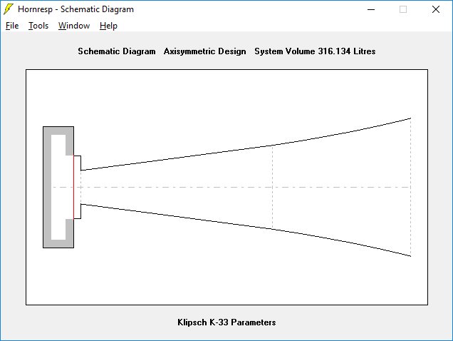

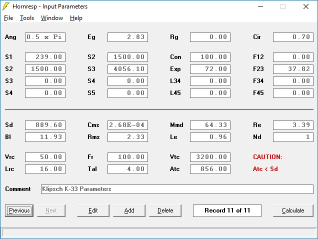

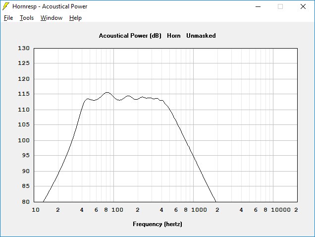

K-horn Improvements
It seems that the standard K-horn flare rate can be improved by the flare changes presented here. The changes made were based on DM's original K-33 parameters, which were modeled with HR in the first post.
I have not done an exhaustive modeling analysis, but did find that removing the rubber throat and going with a long section of conical flare, and ending with an exponential flare does flatten the low end and remove the high end droop of the standard Klipsch flare.
Note that the rear chamber volume has been reduced from 81L to 50L in this example.
It would be interesting to hear if others have tried other acoustic channel shapes to improve the stock flares. 🙂
Jim.
Jim.

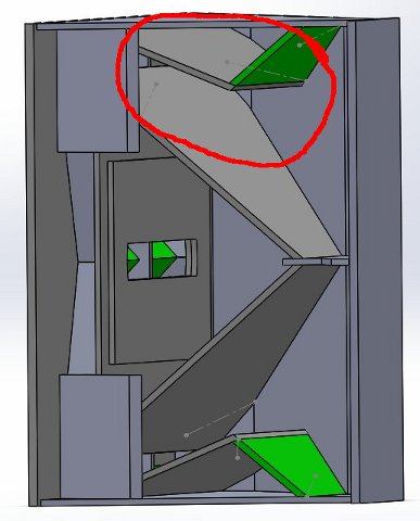

Pat IV is a Scaled Klipsch Design
to accommodate an 18" driver.
In Part 2, item 10, green shaded in your drawing, is shown in assembly sketch below Item 10 & 11 details. It has a span of 7-1/8" and is inclined at a 40° angle. WHG
Hi whgeiger,
Thanks for the drawings. I looked at all three sheets, and did not see a cross sectional view that shows the expansion from the side view after the signal makes the bend at the top and bottom of the front panel. See the attachment for the area in question.
The overall design looks very similar to the Klipsch though.
Jim.

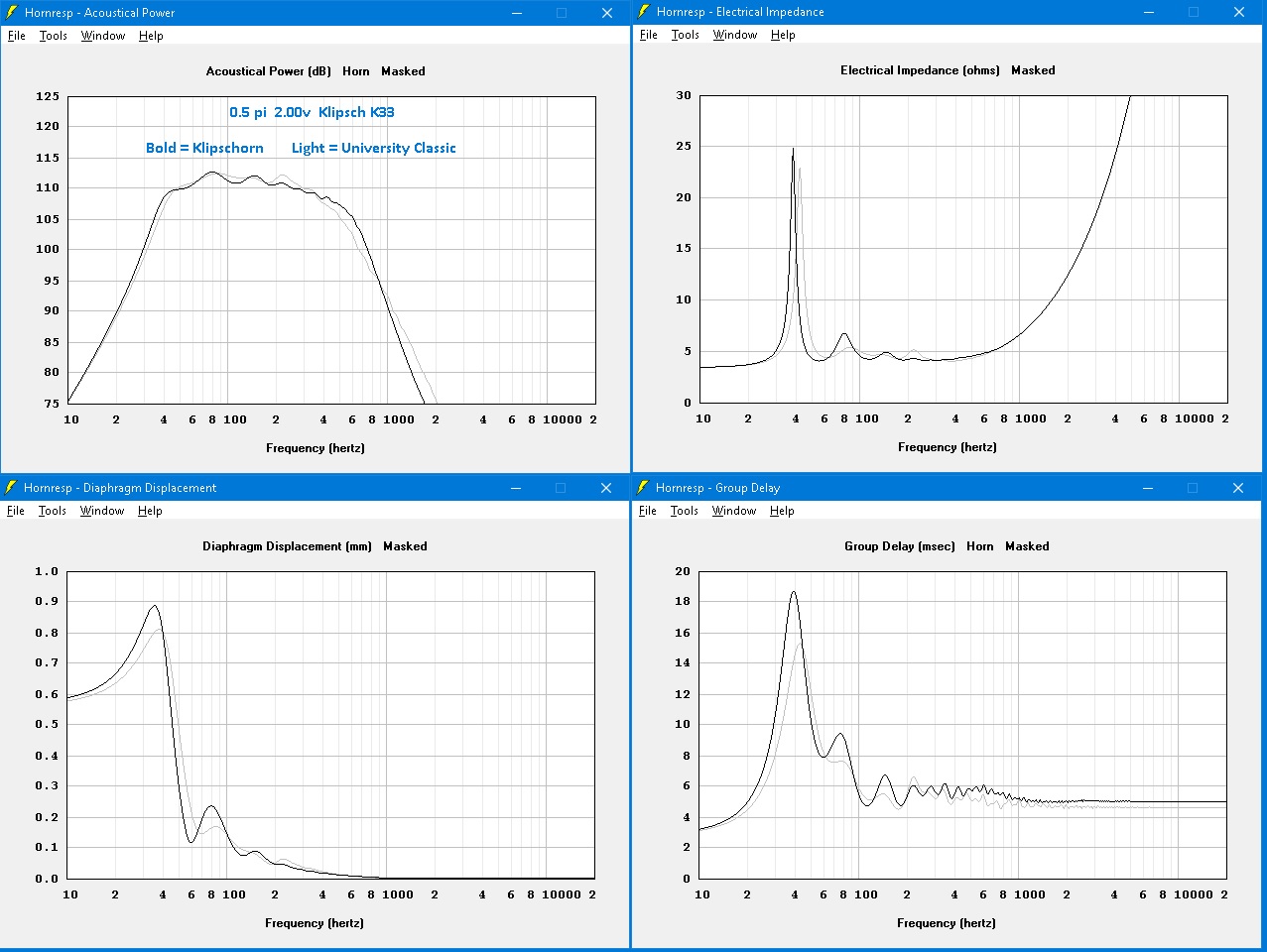

both the K-horn and Classic have almost the same exact back chamber volume.
hornresp says the Classic is working harder at 50Hz.

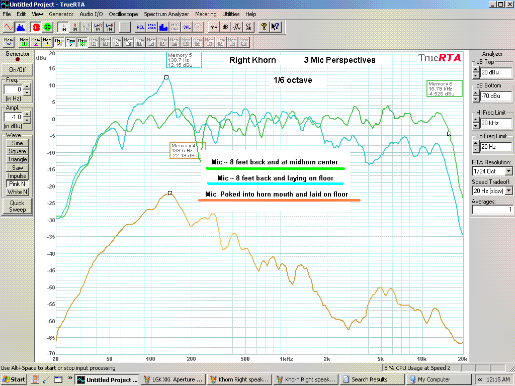

here's how my right K-horn measured (type A network - battery biased with KBG caps) - what specifically was the mic seeing at 138Hz for the floor plane and poked in the mouth - at floor traces ?
IIRC, there used to be pictures of listeners sitting on the floor listening to their K-horn. The mic on floor and back 8 feet response looked pretty good for that position.

....here's how my right K-horn measured (type A network - battery biased with KBG caps) - what specifically was the mic seeing
at 138Hz for the floor plane and poked in the mouth - at floor traces ?....
Looking at your frequency response measurements, there seems to be a room resonance close to 130Hz. When the mike was placed on the floor, the peak occurred, and this was the case where the mike was close to the horn mouth, or further away. Not sure the cause.
Jim.

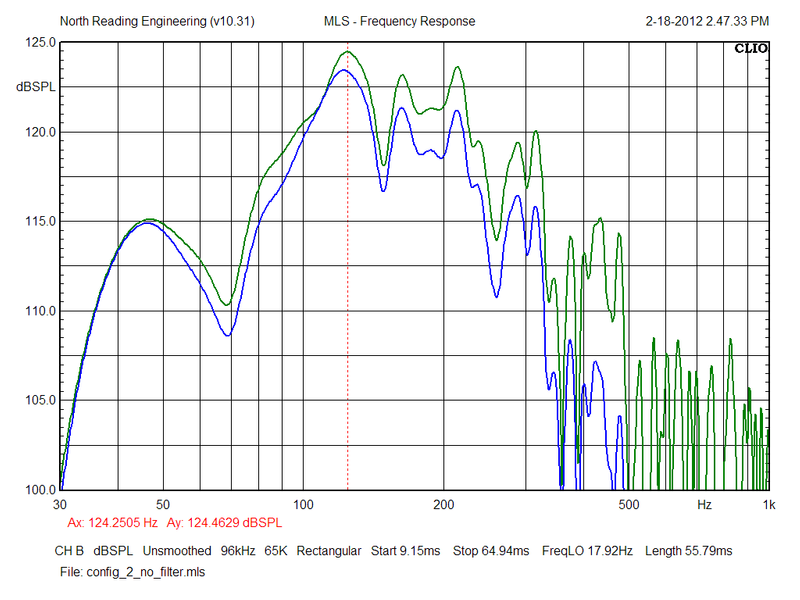

North Reading published a notch filter for the Klipschorn bass section - here's the response without and with that filter. (I tried similar but subjective results weren't improved as my walls resonate badly and for a long time - even a harpsichord recording will set my walls into a booommmmmm)
North Reading's K-horn graph
notch filter
vs my crude in-room graph
notch filter

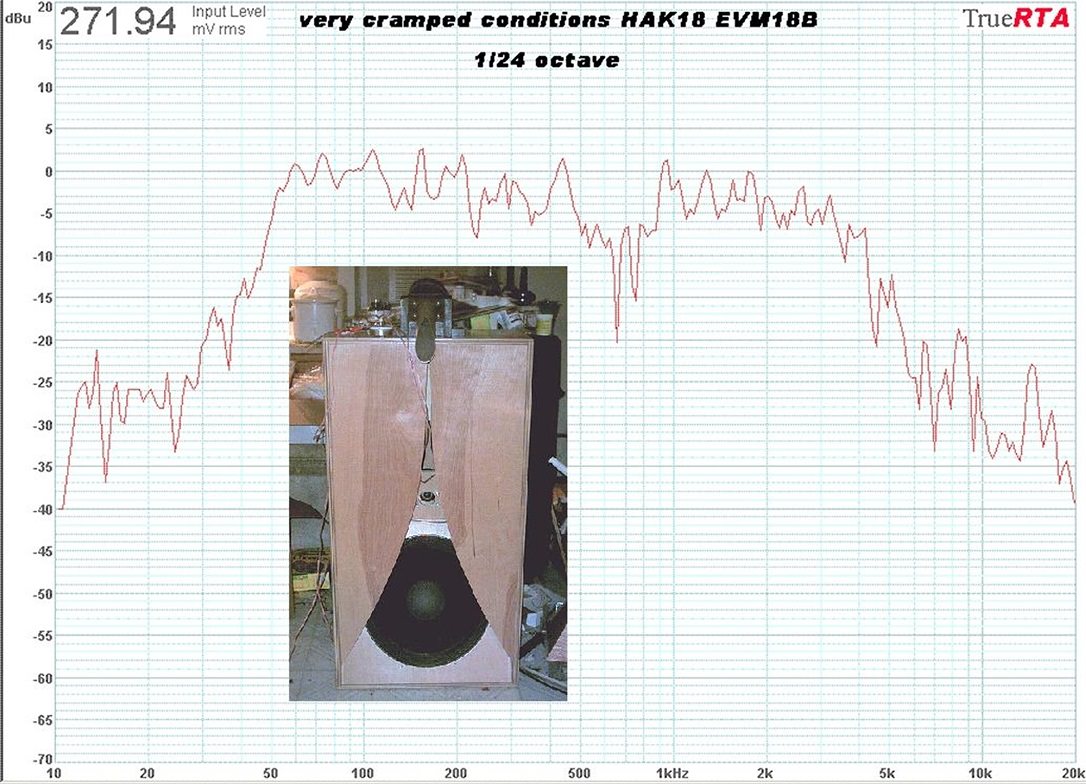

I've got EV Sentry IV, Peavey FH1, a couple of custom FLH (both "midbass") and 3-K-horn (one not in service - no space - lol). Although it cuts off pretty high, I think Ray Newman's Sentry horn is pretty good but not played with it for years. (I used to have a drawing of his little bifurcated midbass horn whose cabinet shape matched that of the "Great White" horns)
fwiw I still have fun with the crazy Ks - the K18 below had an EVM18B (~65g mms) for that graph. Its better in ways than some horns its bulk - but does not "go low" - but it does rattle out to 4K - on axis 😀 The reflector is curved. Subjective cone motion seems very small.
Wolf von Langa who appeared enthusiastic over K-tubes (and K) I believe, has given up on K. I think he figures they would be difficult to market. The slotted pipe sounds "good enough" when mounted "in" the front chamber. A baffle at the compression driver's exit plane if a tube is used on the top might help on the tweeter's low end.
