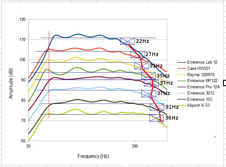

Klipsch K-Horn Driver Analysis
A driver analysis is presented here for a K-horn type folded corner horn. I was curious of just how good of a job that Klipsch staff did while developing the K-33 driver.
Also, if one wanted to fold a new K-horn similar to the Jubilee, then (2) 12 inch drivers would hopefully make the folding process easier, so those drivers are ones I focused on for this analysis.
A study is presented here to show the relative performance these drivers compared to the K-33.
The graph below is a summary of the SPL graphs for the drivers found on-line. Each graph curve is shifted by 5dB.
If you happen to model any of these or other drivers using the Klipsch fold dimensions, I would be interested in your feedback. Further if you know of another driver that may compete with the K-33, please update me on this. I would be glad to model the driver and update the analysis.
Jim.

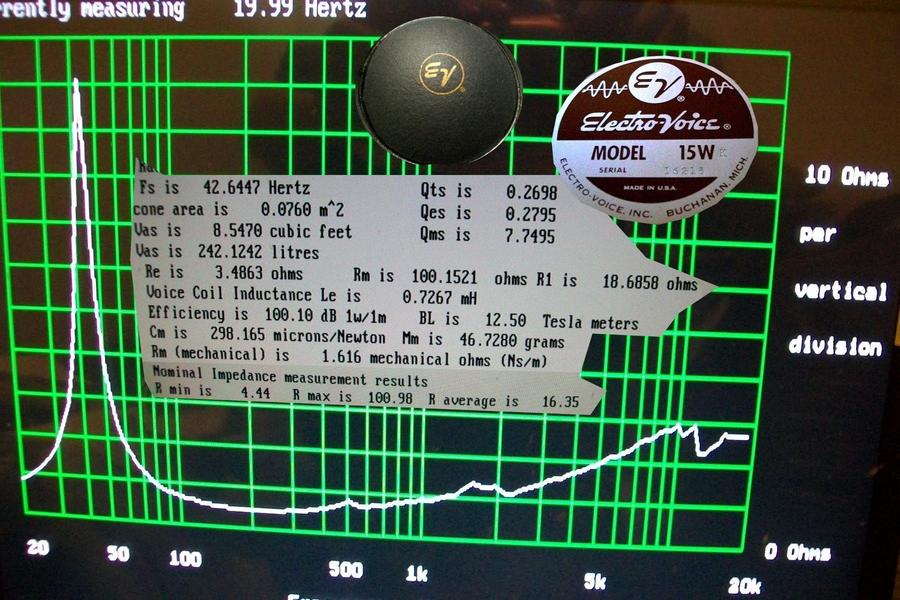

EV 15WK
Hello again Jim, thanks for the EV 15L update. I am happy to be using this driver! The EV and PWK combinations would not complete without the alnico EV 15WK motor. This was a 16 ohm 15W made to PWK 4 ohm specs using the (6x13) filter slot as original construction.
EV 15WK: Fs=42.6447Hz, Vas=8.5470cu ft, Re=3.4863ohms, Le=0.7267mH, Bl=12.50Tm, Qts=0.2698, Qes=0.2795, Qms=7.7495, Efficiency=101.10 dB 1w/1m.
thanks...chris
