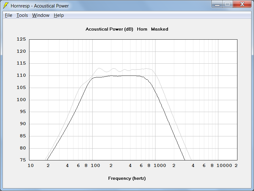

How would Hornresp model a single path Klipschorn? All things being equal (and of course they are not), wouldn't you have only a 3 dB loss in acoustic power output?
Correct me if I'm wrong, but don't the horn equations used by Olson, Beranek, Keele, Leach for their examples are counting on a single pathway with predictable area vs. horn length?
The Klipschorn's woofer doesn't "see" a a single path of exponential area expansion with a mathematically predictable output.

Upon reflection, just blocking the upper or lower acoustic path at the splitter wouldn't create a single path horn. You'd have to block the rear of the horn
so that the area & volume for calculations would be correct.
So, let's say you modeled the (now modified Klipschorn bass cabinet) as a single path horn with the 3" x 12.5" throat opening and a mouth dimension of 13" x 18.5". Would the Hornresp model be different than trying to model a bifurcated horn?
Bifurcated: The woofer "sees" a path with an expansion rate double that calculated using traditional formulas.
Single Path: The woofer "sees" a path that expands in a manner consistent with calculations.
Are there horn formulas that allow for a bifurcated path?

Sl0 = (St1 + St2)*e^(ml/2) = St0*e^(ml/2) where St0= St1+St2 (the bifurcated throats). Here [m] and [e] are constants, so the flare rate is the same. Also bifurcation is acoustically transparent except at high enough frequencies where the un-joined bifurcated mouths behave as dual sources. WHG

Hornresp doesn't know or care if a horn system is bifurcated - it makes no difference to the analysis.
For the reasons given in Post #179, the only way to accurately simulate a Klipschorn, or any other single-driver bifurcated bass horn loudspeaker for that matter, is to consider the complete system, not just one half of it.
A simple exercise in Hornresp clearly demonstrates this. The attachment compares the response of a Klipschorn-type loudspeaker radiating into 1.0 x Pi space (black trace) to that of one half of the system with the same driver, radiating into 0.5 x Pi space (grey trace).
Hi Jim,
A Klipschorn bass corner horn should be modelled in Hornresp full-size. If only one half of the system is considered, the driver parameter values need to be altered and the solid radiation angle specified as 0.25 x Pi steradians (sixteenth space) to obtain the correct results. Even if adjusted driver parameter values can be determined, the required Ang value is not supported by the program.

I hope that post #135 shows that I used the full size of the K-horn when modeling the optimum horn shape.
