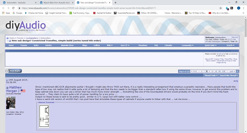

FYI, FWIW: Ron E graciously shared his DVC wiring and driver modeler Excel SS with us many moons ago to resolve this seeming ~universal dilemma 😉:
https://www.diyaudio.com/forums/sub...ple-build-series-tuned-6th-8.html#post4034171
GM

Hi GM,
Did you include the link as a source to Ron E Excell SS? I looked through the posts in close proximity your link and did not see a post by Ron E.
Jim.
???? My link takes you right to the post [one of mine] with the zip files.
GM
Hi GM,
The link....
diyaudio.com\forums\subwoofers\259509-sub-design-constricted-transflex-simple-build-series-tuned-6th-8.html#post4034171
.....takes me to the location above.
I changed the slashes to backslashes so that I could post this without having the link scrambled.
If I hover over your link, it shows the same location on DIYaudio, as listed above.
Jim.

Scrambled? Copy/pasting a link doesn't scramble it. Anyway, when I use your link I see the two attached zip files in my post, so what are you seeing?
GM
.....so what are you seeing?....GM
I see a post from Matthew Morgan, as below, and no zip files.
Jim
Interesting! AFAIK I've never messed with changing anything WRT viewing, etc., or if I even can, but on my pg. 8 my post is #392! Also, I've done these kinds of linking plenty of times without any issues, so wonder why yours is hundreds away.
Sure would like to know why.......
Anyway, might as well post them here too or are these 'buggered'/bogus too?:
https://www.diyaudio.com/forums/att...x-simple-build-series-tuned-6th-dvcpublic-zip
https://www.diyaudio.com/forums/att...build-series-tuned-6th-drivermodel_public-zip
GM

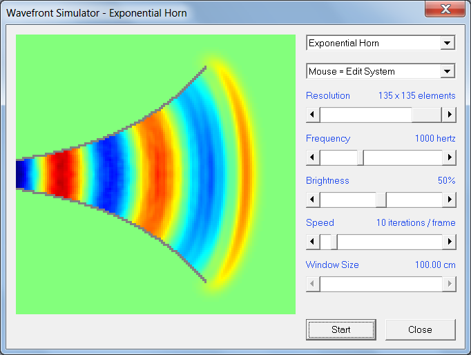

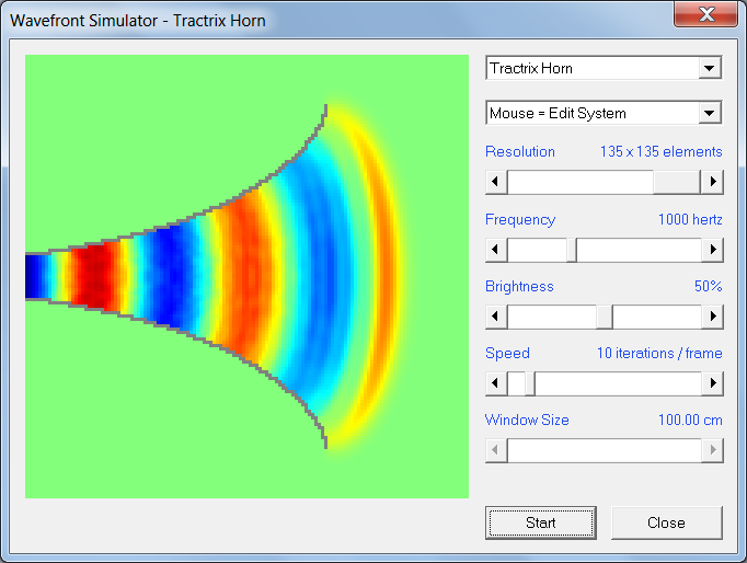

Articulate yes, but not strictly correct in parts 🙂.
For example, to quote from the article:
"When the plane waves travel down to the end of the mouth of an exponential horn, suddenly there is a bulge where they exit into space, and that bulge is essentially a discontinuity. So you have reflections at the mouth, which travel back to the throat and set up a quarter-wavelength resonance condition. With the Tractrix horn, since the waves are spherical going through the horn, they exit the mouth with very few reflections."
The wavefronts in an exponential horn are curved, not planar, and the reflections from the mouth are much the same for both the exponential and tractrix profiles.
Attachment 1 shows the wavefronts in a full-mouth (90 degrees) tractrix horn.
Attachment 2 shows the wavefronts in an equivalent-sized exponential horn.
The reason given in the article for choosing the tractrix profile over the exponential profile, would seem to be based on a false premise...
....Anyway, might as well post them here too or are these 'buggered'/bogus too?:.....GM
Hi GM,
Hey, those links worked!
Thanks for the files. 🙂
Jim.
....The reason given in the article for choosing the tractrix profile over the exponential profile, would seem to be based on a false premise...
Hi David,
Thanks for the clarification! The two graphs do show that the exponential and tractrix shapes are very close indeed.🙂
Jim.
Mixed Metaphors
Horn design for low frequency horns has an entirely different priority set than that of their high frequency counterparts. Here we a dealing with the former.
1) Neither of these horns emit 1-p spherical waves. This is not a particularly relevant fact nor are these designs by themselves, optimal.
2) The well organized forward propagation shown, becomes modularly chaotic in a frequency dependent manner, when back waves resulting from mouth reflectance are superimposed. In a properly designed corner horn, this is a trivial issue as well.
3) Never the less, in this regard, the tractrix horn, of the same overall dimensions, will exhibit slightly less reflectance. But so what, we are radiating out of a room corner which is the only approach that works for any LF horn that can be moved through a reasonably sized domestic doorway.
4) For corner horns, adjoining room boundary conditions must be included in the simulation if you want some modicum of accuracy in the resulting performance prediction.
5) In this setting, the junction between the horn body and the room should be treated as a discontinuity in the acoustic pathway(s).
6) If the horn body extends from floor to ceiling in a typical room corner, then waves traveling away from it may be considered 1-p and of circular cylindrical shape. This is about as ideal as it is going to get and only if two room corners are available to meet crossover requirements to the complimentary HF horn units.
WHG

Horn design for low frequency horns has an entirely different priority set than that of their high frequency counterparts. Here we a dealing with the former....WHG
Hi Bill,
I understand a portion of what you are saying by your points above, and know that this thread is primarily about low frequency corner horns.
I still appreciated David's comments above about the closeness in acoustic response of a large exponential compared to a large tractrix. I find the discussion of horns fascinating, and I have been interested in them for many years. Obviously, the horns that David is referring to are meant for some type of mid-range application, and not applicable to a bass horn. A corner bass horn mouth size is always smaller than one wavelength, and most of the time, smaller than 1/4 wavelength.
Jim.
