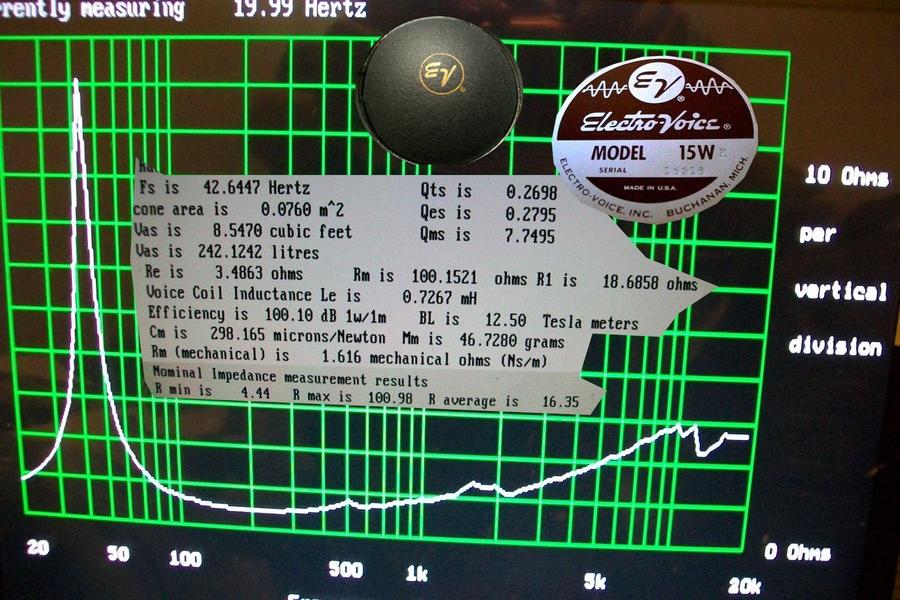

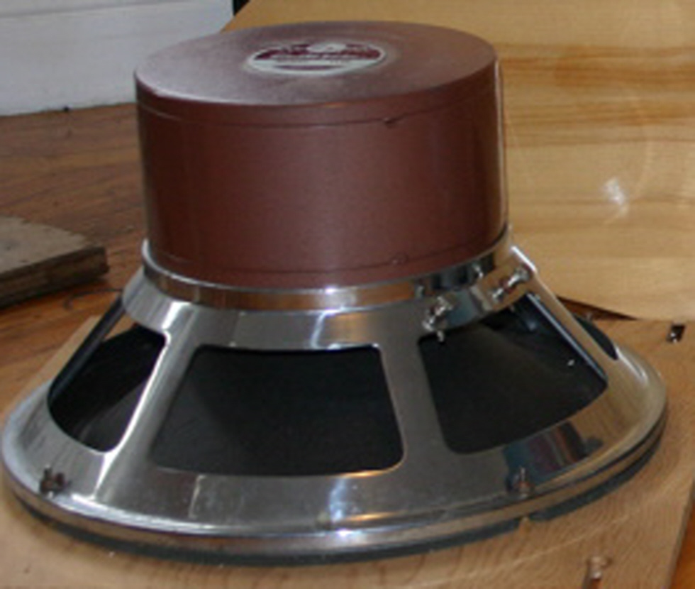

freddi;5705171... got a better model ?...[/QUOTE said:I was interested where you obtained dimensions for the sims. The old EV 15W has a floppy loose cone (perhaps 1 inch travel) vs the EV 15WK a tight non compliant cone.
For your interest my moniker "the Glyph" is for the Meyer creation I saw in the updated Last Whole Earth Catalog 1971. pg 326 looks like an altec 811B hanging above the small 15 in driver bass horn. Some larger units had a 21 in motor.
oh - I vaguely remember that catalog - more than a half a lifetime ago for me 😱 🙂 - in this thread I used Jim's hornresp input. Previously I've used a couple of hornresp inputs posted at the Klipsch Technical & Modifications forum. That's very interesting that ~ an "air suspension" type woofer was made by EV for PWK. What would be its moving mass, etc? Does it have advantages over the K33 CTS and Eminence spec ?

Hello freddi... As far as the EV 15WK - I use the EV EVM 15L, sounds better -
I've seen pictures of the 15" Karlson with the large potted alnico motor - also, the 12" version fits the little Karlson 12. I have one EVM15L plus two SP15A whizzer speakers which had ~"6 ohm" coils and qes raised with a series two ohm resistor hidden under a frame spoke. Would you know if the SP15A which superficially looks like the EV15L/EVM15L, can work with a 15L cone kit? I hate to throw the SP15A out. Does EVL15 play well in the Khorn? (I ran 2220H and that was a mixed bag vs K33)
... Does EVL15 play well in the Khorn? (I ran 2220H and that was a mixed bag vs K33)

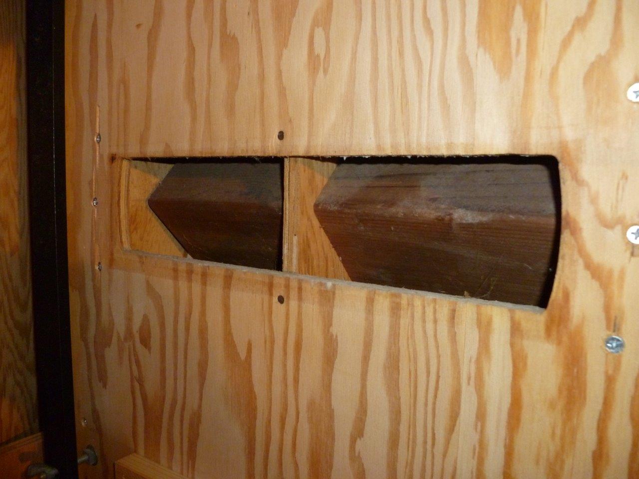

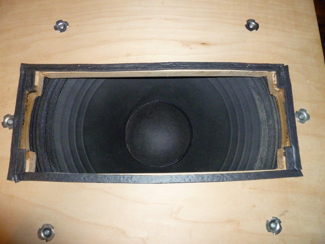

The K33 variety woofers use the 3 x 13 filter, all others could use the wide open 6 x 13 filter. Actually from the equations I posted earlier in this thread, for the EV 15L the filter I use is 5.25 x 13 about 68 sq in. The throat is still 2 x 3 x13, or 78 sq in. This is why folks don't have much luck changing out the K33. The EV15L sounds great, although I do have a 20 cu ft subwoofer horn cabinet with a EV DL18MT woofer for the bottom.
OK about the recone kits I have 5 EV15L and 4 EV15B woofers, I have purchased kits and have reconed one of each myself. The kits were not OEM, but do work properly. So I just called the supplier and asked about a kit for the SP15A 2 1/2 coil 8 ohm sans wizzer, and EV15WK 2 1/2 in coil 4 ohm. He will call me back with possible availability and price. Sorry to walk over Jims thread...chris
Its my fault to mess up this thread - I sure appreciate your help. It might be cheaper just to ditch the SP15A frames then find EV15L in good shape used. The motorboard should remove so the larger filter can be used - ? My Khorns IIRC are 1 bare plywood unit from ~1977 (one lost in a fire) and 2 - lumbercore/walnut veneer from 1981.
... The motorboard should remove so the larger filter can be used - ?
Be patient I have not heard back about the recones. Yes the motorboard comes out, but Klipsch also reduced the opening in the body in front of the motorboard. I might ask your goal? Per PWK, the floppy K33 has more bandwidth than any alternatives, but a tight high Bl driver will sound better, go louder and need a subwoofer. Consider the K44 driver in the TSCM and CP-1 pro, the K44E.

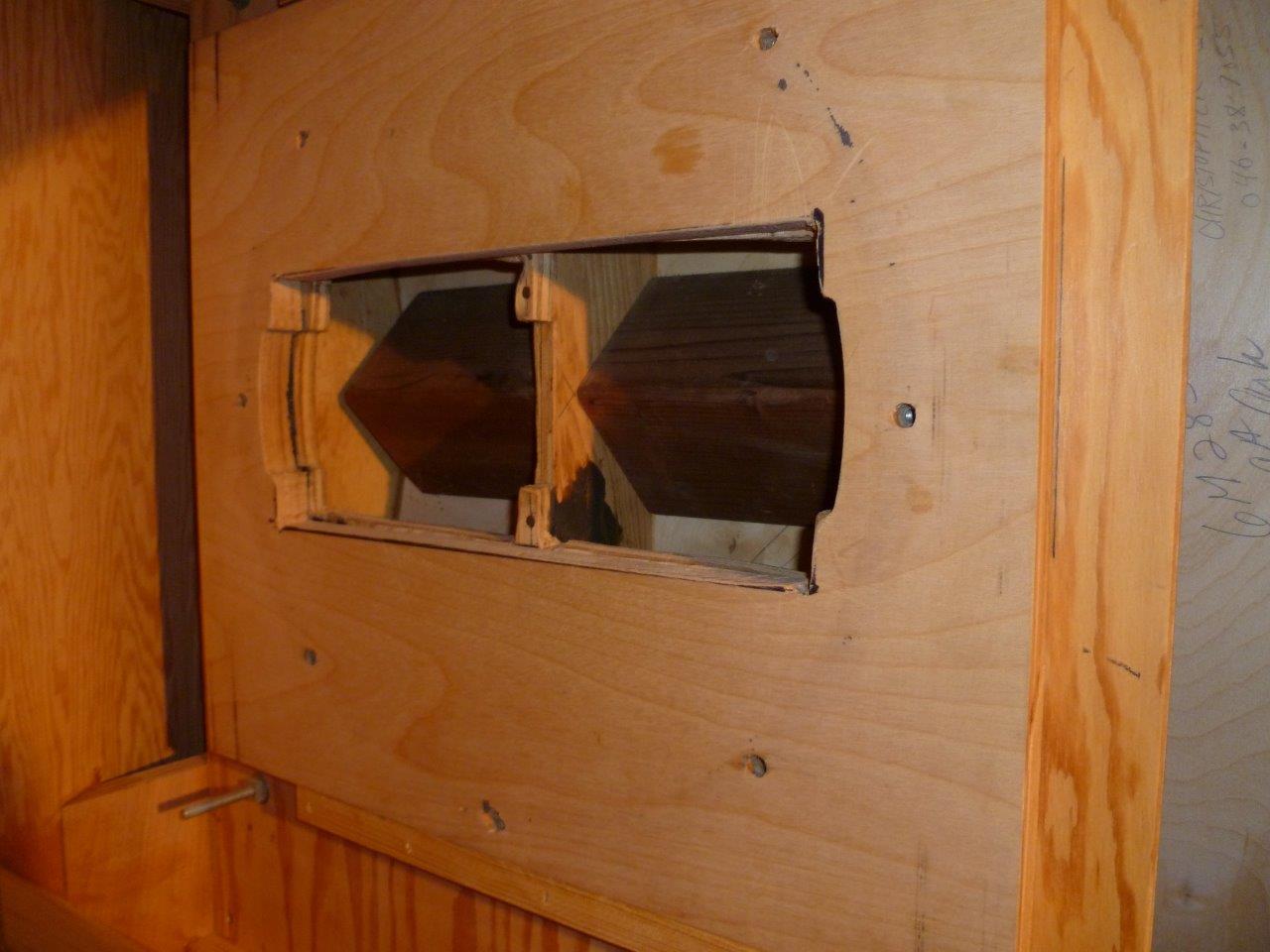

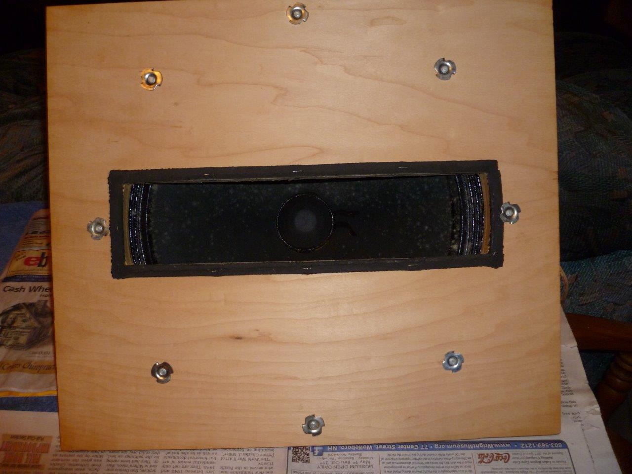

As for the older Klipschorn with the removable motorboard. To enlarge the filter slot you need to figure out the filter slot size for your 15 in woofer then enlarge the motorboard and bass bin body to match, (between 39 and 78 sq inches).
Attached are my before and after filter slot modifications. I have left and right front Khorns, a center channel LaScala, and rear surround Belle Klipsch all modified to the same 5.25 x 13 (68 sq in) acoustic filter dimensions.
I'm getting old with some health problems and so a motorboard, etc. modification is academic at this point - it would have been great to do 25+ years ago. Its good info for those concerned with getting the best quality sound from the Kliipschorn.
