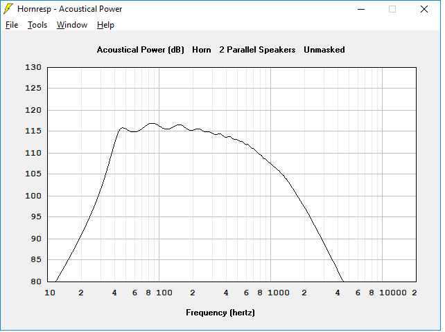

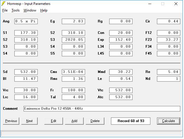

Hi freddi,
Something looks off in your sim. The final flare should be exponential. The length at 152.4 should have EXP next to it. You can double click on EXP to change to that setting.
attachment.php
Also, since there are two 12 inch woofers, the simulation needs to include this as well. Note that the sim below shows that two woofers have been selected and are connected in parallel.
attachment.php
Regarding the complexity of the build, I would think that this build would be more labor intensive than a typical K-horn cabinet, as I intent to produce somewhat rounded corners in the bends inside the cabinet. This will need to be researched and/or modeled before proceeding with any kind of build.
Just curious; why did you simulate a 2pi space? A corner horn would always be mounted in a 0.5pi environment, as this makes the use of a bass horn feasible in homes, size wise.
Jim.

it was late - so missed the EXP part. Regarding 2 pi just curious as have been looking at the old "Dean cornerless cornerhorn".
so the finished speaker could be something like the Jubilee - what's the easiest way in hornresp to get both halves simulated?
To sim two 12 inch speakers, display the SPL curve data
Click on Tools | Multiple Speakers.
Then select Parallel and number of speakers, in this case two.
The SPL graph will be rerendered with the updated speaker setup.
The setup information will be displayed at the top of the SPL graph.
Jim.
