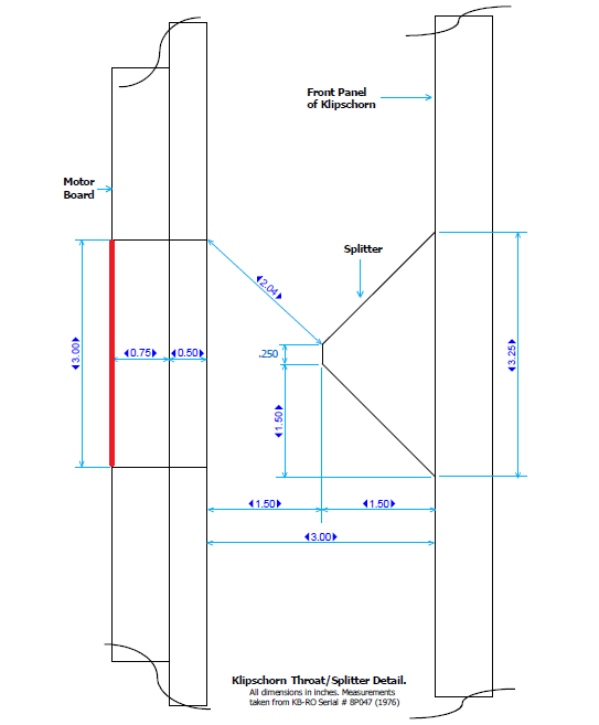

Klipschorn throat location quiz
In keeping with Jim's thread title, Klipsch Bass Horn Acoustic Analysis, I submit a couple of drawings of the innards of my 1976 Klipchorns and also pose a question as to the location of the Klipschorn's throat(s)..
What I'd like to know is which (if any) of the "throat" locations I've identified is the actual & verifiable Klipschorn throat? Be prepared to argue your selection!
The literature (papers, books, articles) seems to gloss over the throat location issue when it comes to bifurcated acoustic paths. The K-33E outfitted as a compression driver is feeding two horns of equal length. It seems to me the classic exponential horn equations are (like speed limit signs) only a suggestion to the experimenter as how to go about designing and building a bifurcated/folded horn.
While it's true you only pick one of the two paths to model/measure, when it comes to mouth area, some (including PWK) count both mouth areas in their design explanation, not just one as I think it should be.
So, which labeled throat do you say is the correct one(s) to choose?
Admittedly, T1 & T2 are real close with each having an area of 12.5" x 13", not the more cited 3" x 13"; (Don't forget the 1/2" vertical partition splitting the 3" x 13" opening.)
T3 is a somewhat logical choice (at 1.5" x 12.5") as it is at the confluence of the two horn paths and the splitter acts as the first area expansion.
T4a & T4b as well as T5a & T5b could be considered as well.
The attachments are full scale and drawn as a vertical section thru the motor board to the front panel. Again, the measurements are of my Klipschorn. Splitter sizes and woofer slots have varied over the years.

Two possible explanations come to mind for throat variances addressed here and they are not necessarily mutual exclusive nor do they lead to making an immediate choice regarding superiority of a particular configuration:
1) Over the production life of this enclosure, which has certainly been protracted, I am sure the parameters of the driver used have undergone changes that have required modification of horn acoustics that are easily implemented by alteration of throat dimensions. Thus, to make the right choice requires specification of a particular set of driver parameters and their tolerances only known to the folks at Klipsch.
2) These minor differences may also be due to individual voicing of each unit before final assembly, base on measured driver parameters of the specific unit to be married to a standard horn body by using different throat sub-assemblies to achieve a superior match.
WHG

Hi Lee,
I agree with you, since the K-horn is split in two halves, that the throat size should really be split in half when modeling the shape.
When I modeled the twin (12) drivers, I split the throat into 1/4 of it's full size.
Right now I favor a "phasing plug" for each 12 inch driver and the acoustic paths will be separated physically. The intent of this will hopefully keep the phasing mismatches smaller when the acoustic signal moves from the cone to the horn path.
Jim.
The throat is as shown by the red line in the attachment. Behind it is the throat chamber, and in front of it are the horn segments, the first of which is cylindrical (being the port tube opening through the motor board and half-inch thick panel).

Hi Jim,
A Klipschorn bass corner horn should be modelled in Hornresp full-size. If only one half of the system is considered, the driver parameter values need to be altered and the solid radiation angle specified as 0.25 x Pi steradians (sixteenth space) to obtain the correct results. Even if adjusted driver parameter values can be determined, the required Ang value is not supported by the program.
Kind regards,
David
It is one thing, one horn design. Why split it? I understand there are two pathways along which the sound waves travel, but they originate with the same driver, they exit fairly close together. The separate waves recombine at lower frequencies, the pathlength difference causes comb filtering at higher frequencies. Other than that, it's a single horn.
I don't have a reference to a paper ready, but remember reading at least a reference to a paper that concluded splitting a horn into multiple equivalent pathways is irrelevant for basic horn function.
I know a friend noticed subjective dynamic losses when he split a horn in four or more pathways. I think he concluded that the relative amount of horn wall was increased, causing more friction losses. But that wasn't a scientific conclusion.
