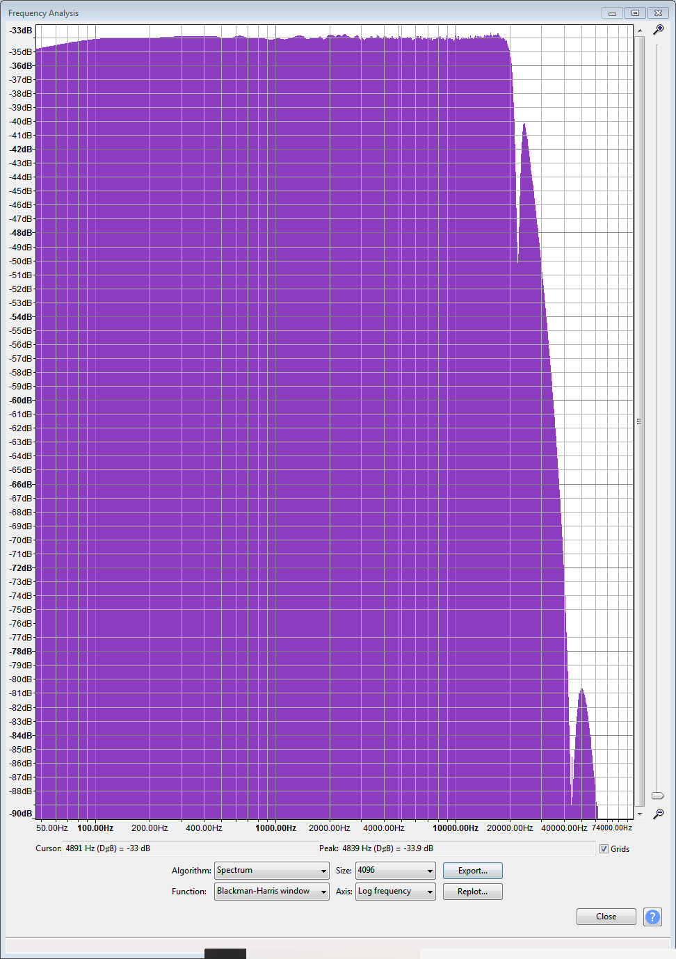

Having been crouched over multiple alpha-builds with soldering iron at the ready for about a week I figure I'm about done with component tweaking 😀 I've decided to keep the EP17s for the first released version but I was able to obtain some thinner wire for the secondary (we're now down to 0.04mm diameter) which raises the inductance and hence gives better flatness in the bass. The I/V resistors are down from 5k6 to 2k meaning there's almost 3X less signal level at the output of the EP17s - but 1VRMS is probably enough from a DAC for many. 2VRMS can be reached by making the OPTs a 1:2 ratio - going higher than 2X gives too high an output impedance with the cheap RM10 cores I'm using. Some of the signal level is made up by reducing the step-up ratio of the EP17s - its about 1:27 now.
Having gotten the distortion into the acceptable range I then found my simulation results for the FR were astray so the filter's been tweaked too, along with the RC networks on the DAC board. The end result isn't ruler-flat but it is an improvement on the unfiltered NOS DACs out there in the top couple of octaves - Audacity plot attached.
I agree. There is no reason to follow Red Book 2V RMS requirements. This plot is quite good in low frequency. Once distortion issue is sorted out, it looks like the project will be finished in two or three months. I can't wait any longer. 🙂

What do you mean 'project finished in two or three months' ? Projects never get finished, they just get put aside for other more interesting avenues to explore 🙂 I think I will get to release this one into the wild sooner than that though, I just need to build a stock of parts and create the BOM, schematic. Oh and re-spin the PCB. So hopefully before the end of Jan - which here is Chinese New Year.
Interesting that you think the low frequency is quite good, that's the part I am wondering where some measurement artifact has affected the results. I need to investigate further but the plot is showing -1dB @50Hz which seems too soon for the roll-off, at least compared to my sims which were showing (from memory) no more than -0.25dB there.
