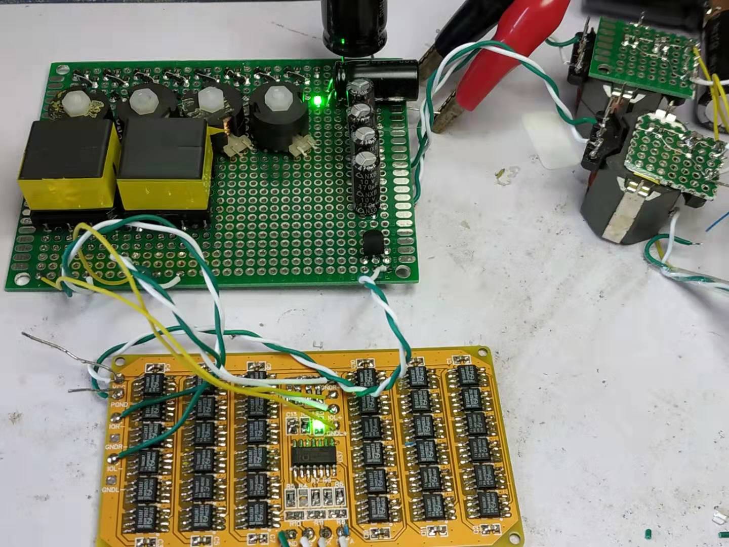

Lower complexity design - Q-gross DAC
Since soldering up four DAC boards and interconnecting them is really only for the true hair-shirt brigade of multibit die-hards (myself very definitely included) I was wondering if it would be possible to design a 'gateway DAC' based on this model but which called for far fewer DAC chips. Turns out, it is and I have the first prototype playing into my ears as I type. This will eventually allow a DAC to be built using just two PCBs - as soon as the PCB layout for the analog board gets done, anyway 🙂
The lower number of DAC chips comes at a price as there are no free lunches and its paid in terms of the output compliance voltage at the DAC chips. The trafo of the Q-gross (quarter-gross) DAC has only a 1:25 step up ratio so ~40mVRMS exists at those pins, whereas on the 4 PCB design, that's down to ~10mVRMS as the transformer gives 100X voltage gain. The analog PCB is agnostic towards the number of DAC chips used, the difference will just be in the winding details of the EP17 trafos used. In theory its possible to accommodate even more than 144 TDA1387s although I've yet to figure out a way of fitting the thicker wire on the transformer's bobbin. There has to be some way though.....😀
In the photo, the analog board containing CLC filters, trafos and buffers is at the rear - it feeds into RM10 cores (rear right) wound as output bal-SE trafos. The DACs themselves are fed from a TL431 shunt at 4V and the whole is powered from a single 6V rail.

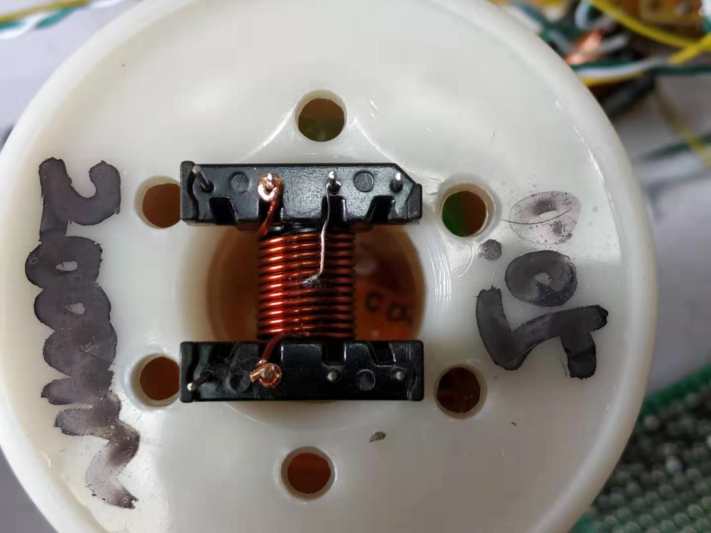

I came up with a way to get fewer turns on the transformer - add the CT later with thinner wire. Here I have 6+6 T for the primary (0.62mm) and there's enough room left for 4000T of wire for the secondary (0.05mm). This gives an impedance ratio of ~111k meaning an 11k I/V resistor on the secondary represents 0.1ohm to the DAC array. Initial listening indicates a slight improvement in LF - the price is the need for a lot more DAC chips - at least 128.

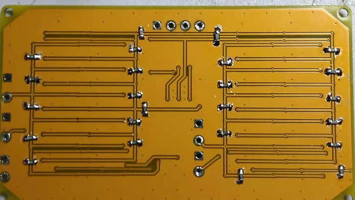

From building up stacks of the DAC boards I found there was some very low-level hiss when listening at low digital volumes (its masked at higher volume settings). I eventually tracked this hiss down to less than perfect grounding - the groundfill is a bit too contorted to give a low enough impedance for the DACs. The remedy on the existing PCBs is to attach some 0603 0ohm links as straps to give lower ground impedance. Picture attached - I've used a couple of dozen 0 ohm links (one is 0805, all others 0603) soldered where the soldermask is scratched away with a craft knife.
A new set of PCBs with the grounding fixed will be along within a week, but if you're going to build a DAC with the gerbers I've already published you'll want to consider adding some 0 ohm straps. I didn't notice any hissing effects on a single PCB, it became apparent on a stack of 3 and gets worse with more boards added beyond that.
